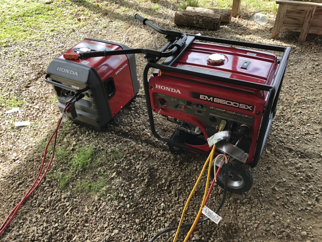

This February, we had a freak snowstorm and our entire county was without power. The biggest town was down 3 days, but most were out 4-10 days. We were out for 17! Some others were out for a month. We were just fine with a couple of Hondas. I’ve contemplated getting a 10-15KW diesel genny, but after this experience, I don’t have any fear that we couldn’t make do with these little gassers.

Honda makes very dependable generators.I have the small honda 2000is gen.Been rock solid for 8 plus years.The main house has a 17 kw propane whole house unit made by generac.
