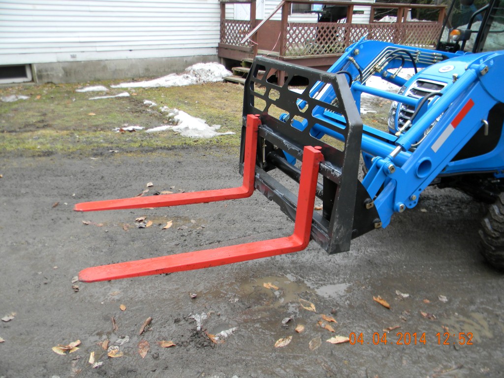

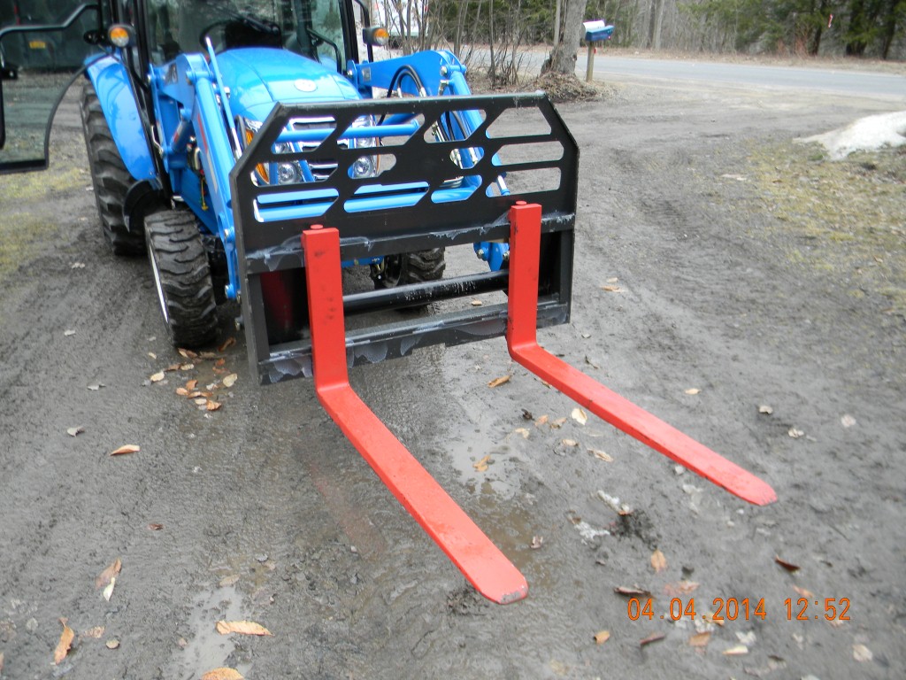

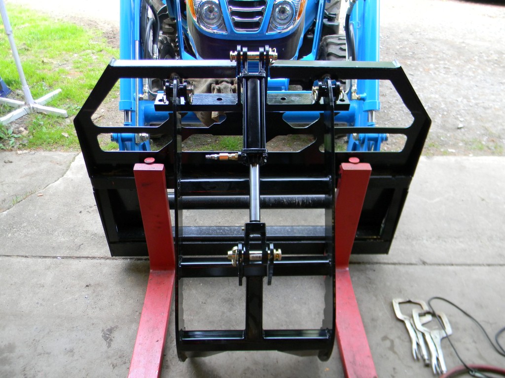

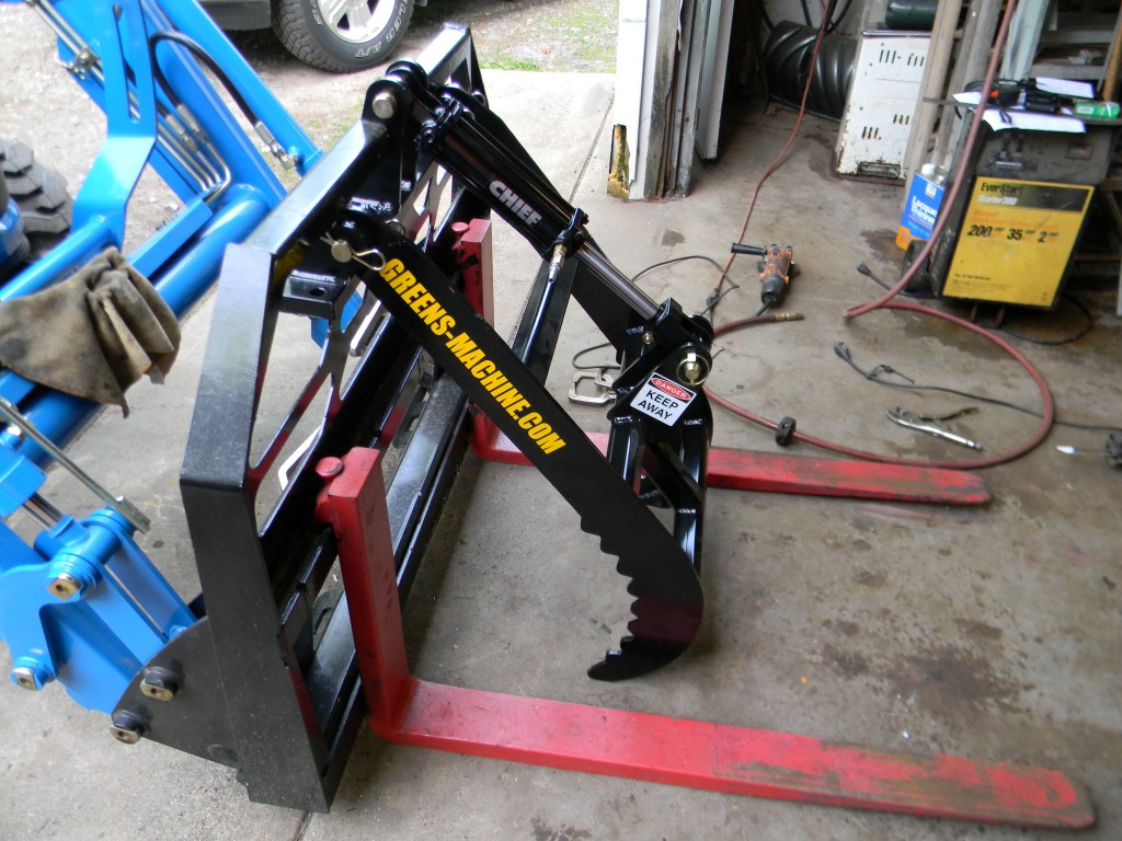

I almost bought the Titan brand forks but found a new set locally for the same price. ($524. incl. tax). The Titan forks are on Ebay or Amazon and I don't see any problem buying them. Quite a few guys here have them. Here's some pics of mine. I recently added a hydraulic thumb for using on my forks and bucket.

I have the Titan 48" on my 4041 and I have been logging, clearing brush, digging stumps, and maxing the loader with them and haven't bent anything yet. I am going to mount a thumb on mine just like George. :)
eBay puts a new set up for auction every Mon night, I watched the price for several weeks a got the 48" for $586. With free ship. No complaints here.:thumbsup:
