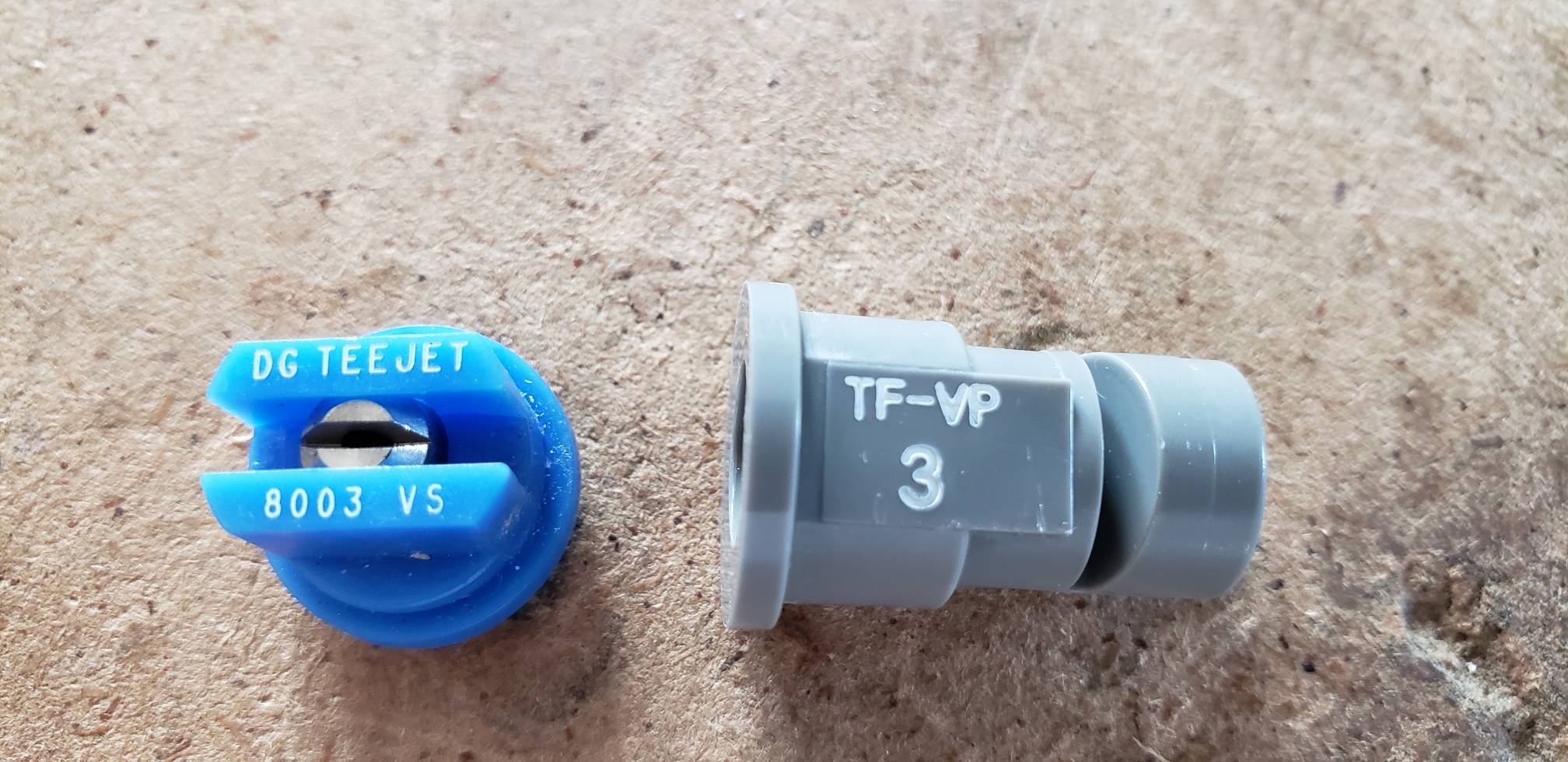

I want to change tips on my 25 gallon boom & spot sprayer to a larger size orifice. I have 2 sets to choose from in my junk box.
But I have forgotten which one of these sprayer tips produces a large/course droplet and which one makes a small/fine droplet.
Any ideas?
edit: oops, I forgot the pic.

Whichever of the two sets that has the larger hole size will give you lower pressure and larger droplet size. The smaller the orifice the higher the pressure and consequently the finer and smaller the droplet size

I let it go as fast as it can, which iirc is about 45 psi.
Currently I am using the TF-VP3. My boom has 5 tips.

I would only worry about drift with 2,4D - If you're spraying RoundUp... I would not worry as much (you need good spray coverage, a little drift isn't as bad).

Most herbicides work best with corse spray, large droplets and a good surfactant, like MSO. Drift or not, herbicides are a large droplet chemical for best results
