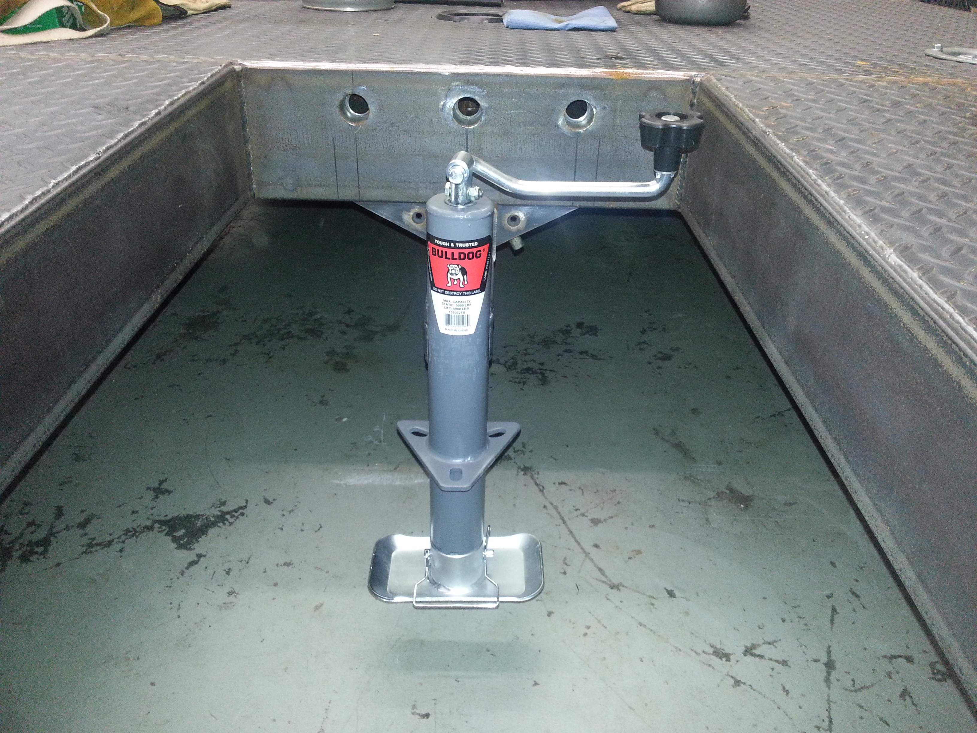

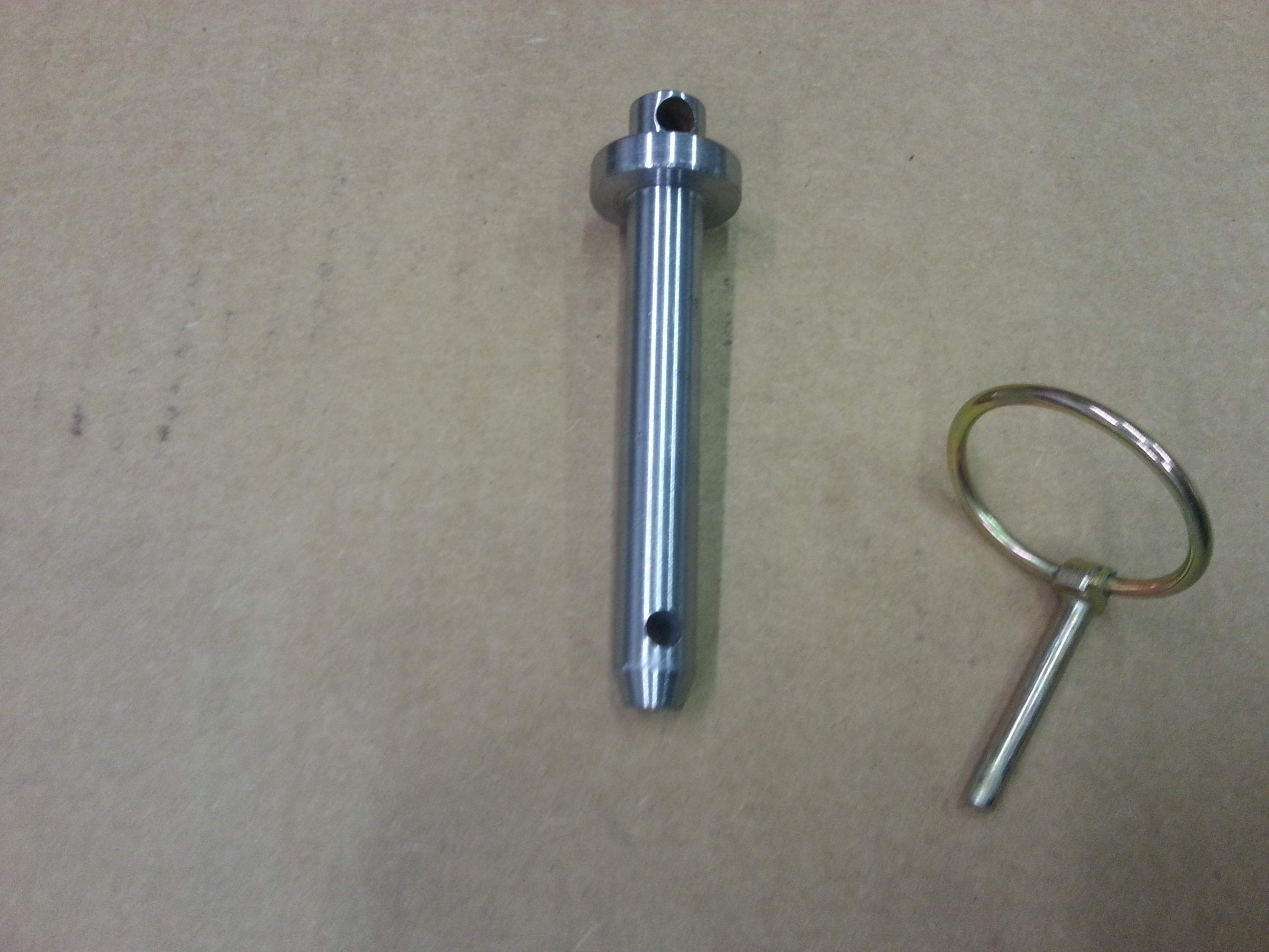

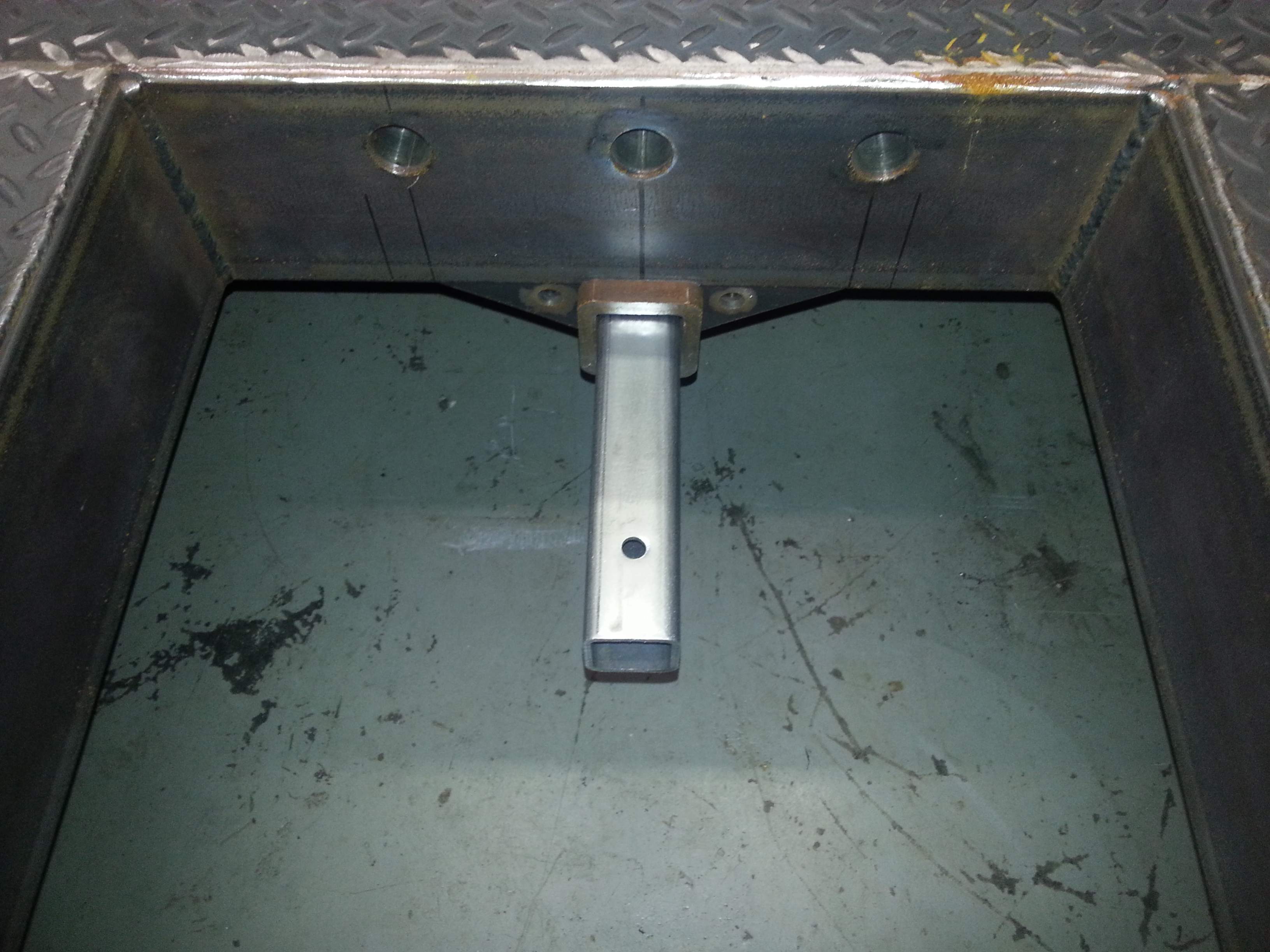

I've also been working on a removable stabilizer jack for the rear. I modified a 5000lb tongue jack, i'm not sure if it will work or not, but thought i'd give it a try. I wanted to extend it out from the back of the trailer to make it as stable as possible sense i'm using just one. Here's the extension and a pin I turned for the jack.

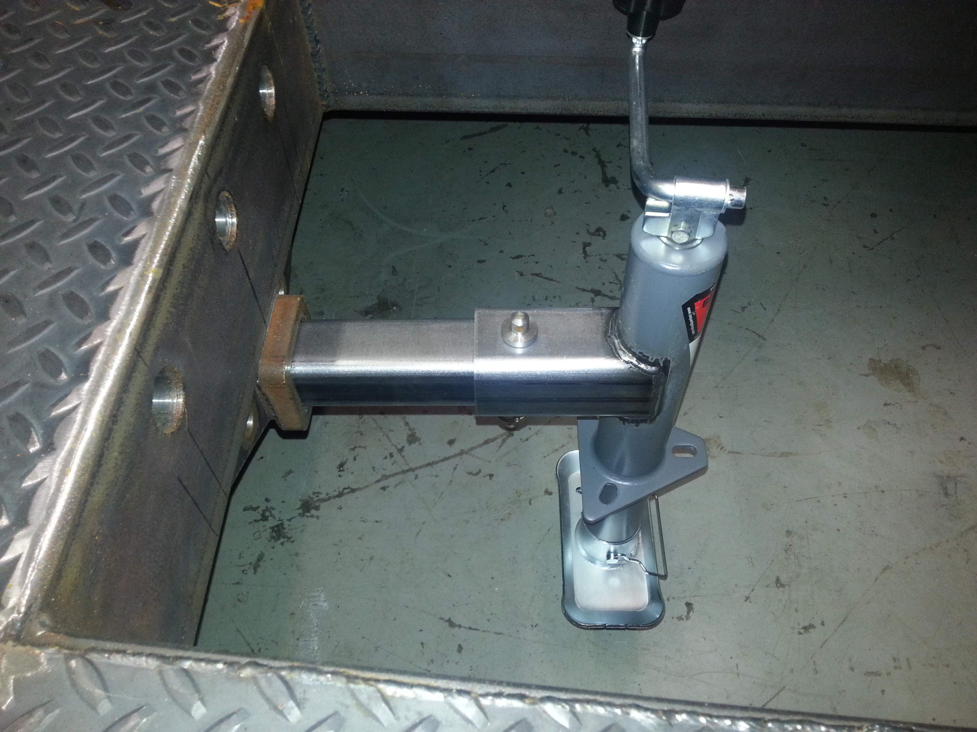

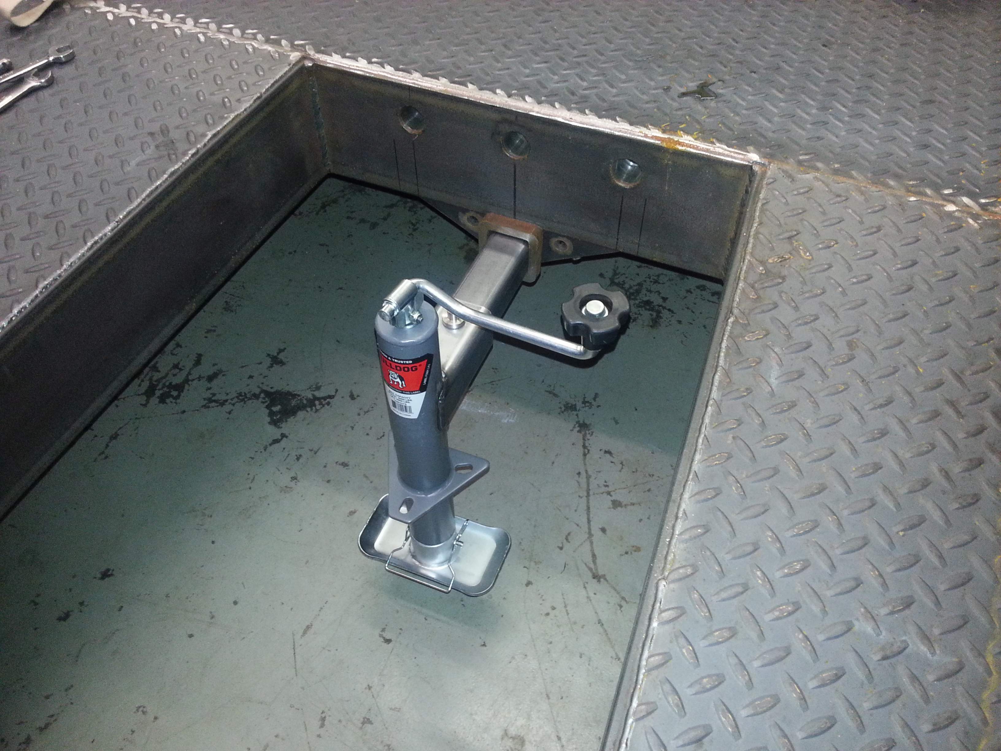

Here's the jack. I had to cut-off about 8 inches from the bottom and weld on a receiver plate to mount it. It still needs a little TLC, but I think it might just work. I think I can mount the roller (for the winch cable) to the new receiver without too much work if needed.

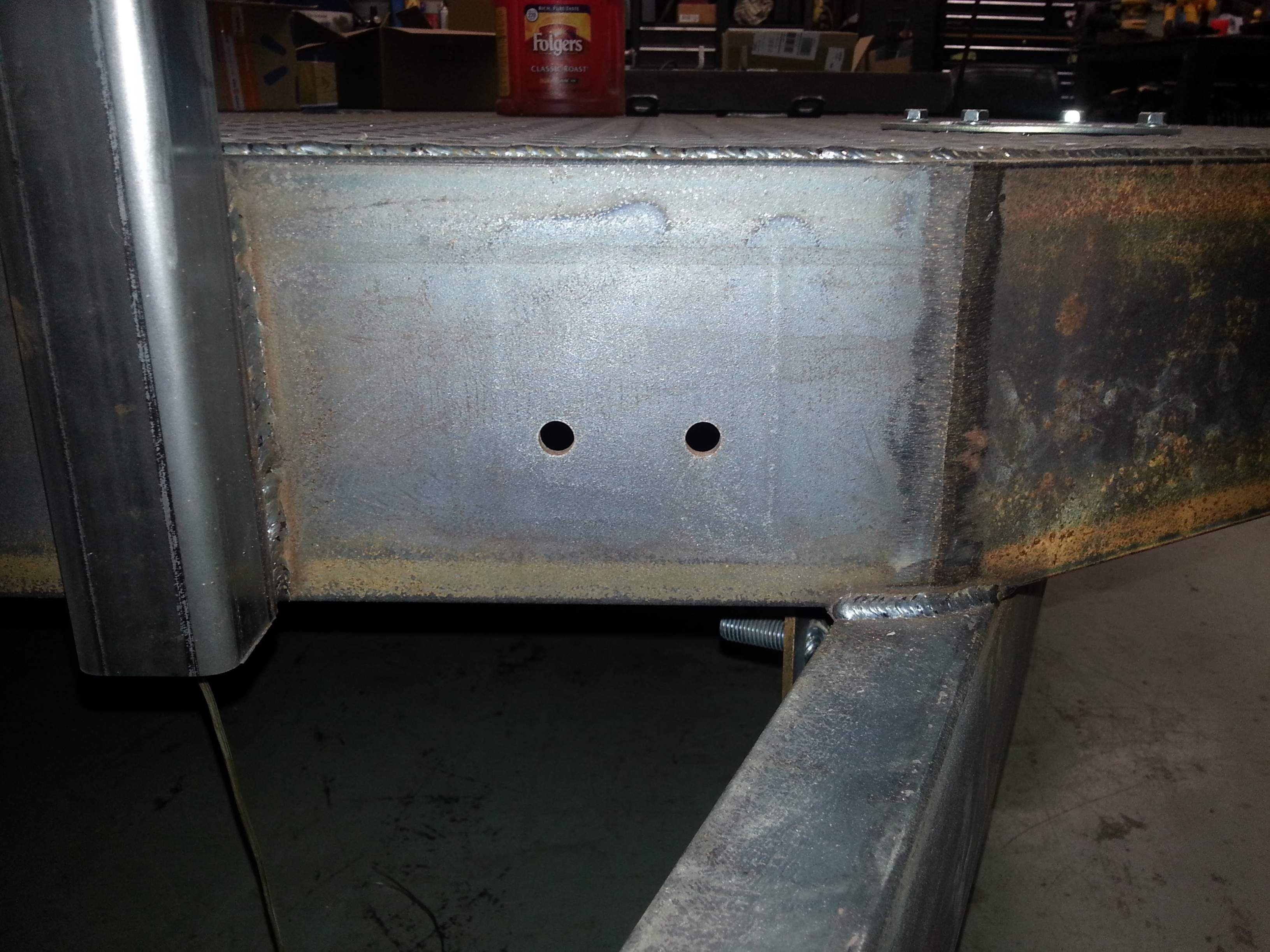

Holes for the toggle switches for the winch and bed lights.

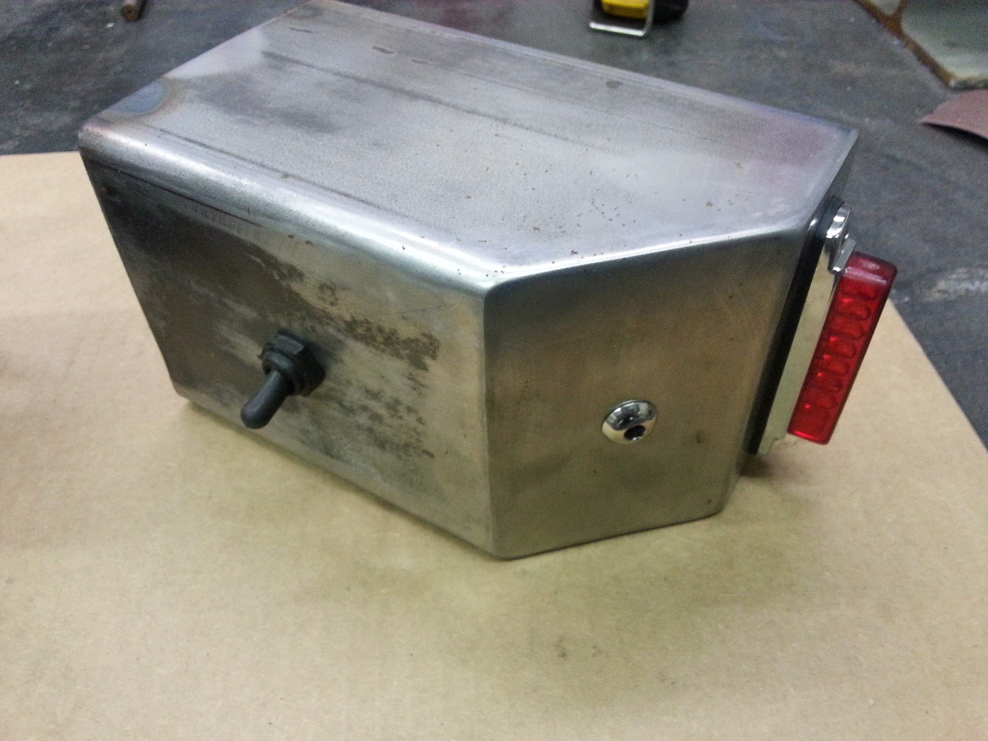

Toggle switch on the back of driver's side tail light for the ramp lights. All three of these "switched" lights will be wired to the onboard battery.

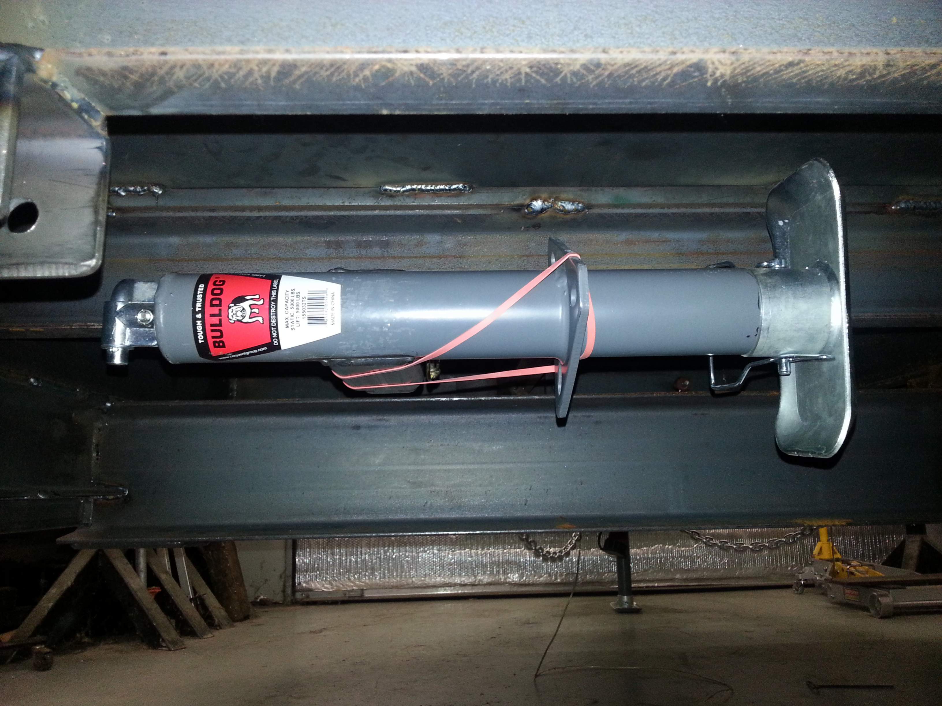

Mount to store the jack underneath trailer when not in use. The rubber band is to keep the handle from flopping around. It uses the same pin as when its in use.

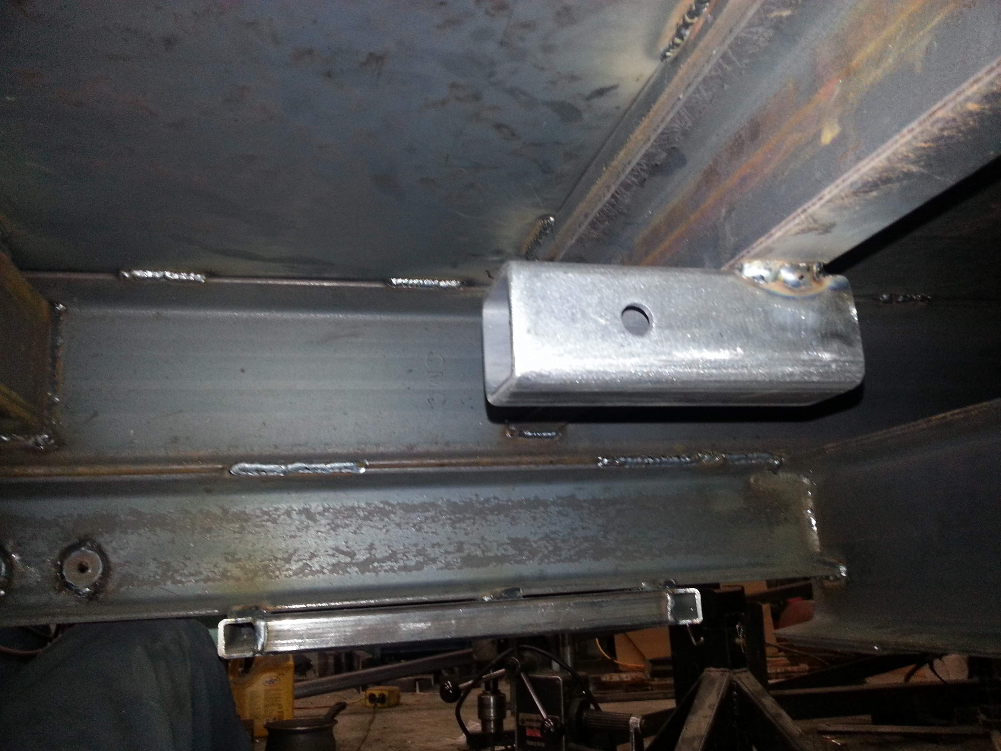

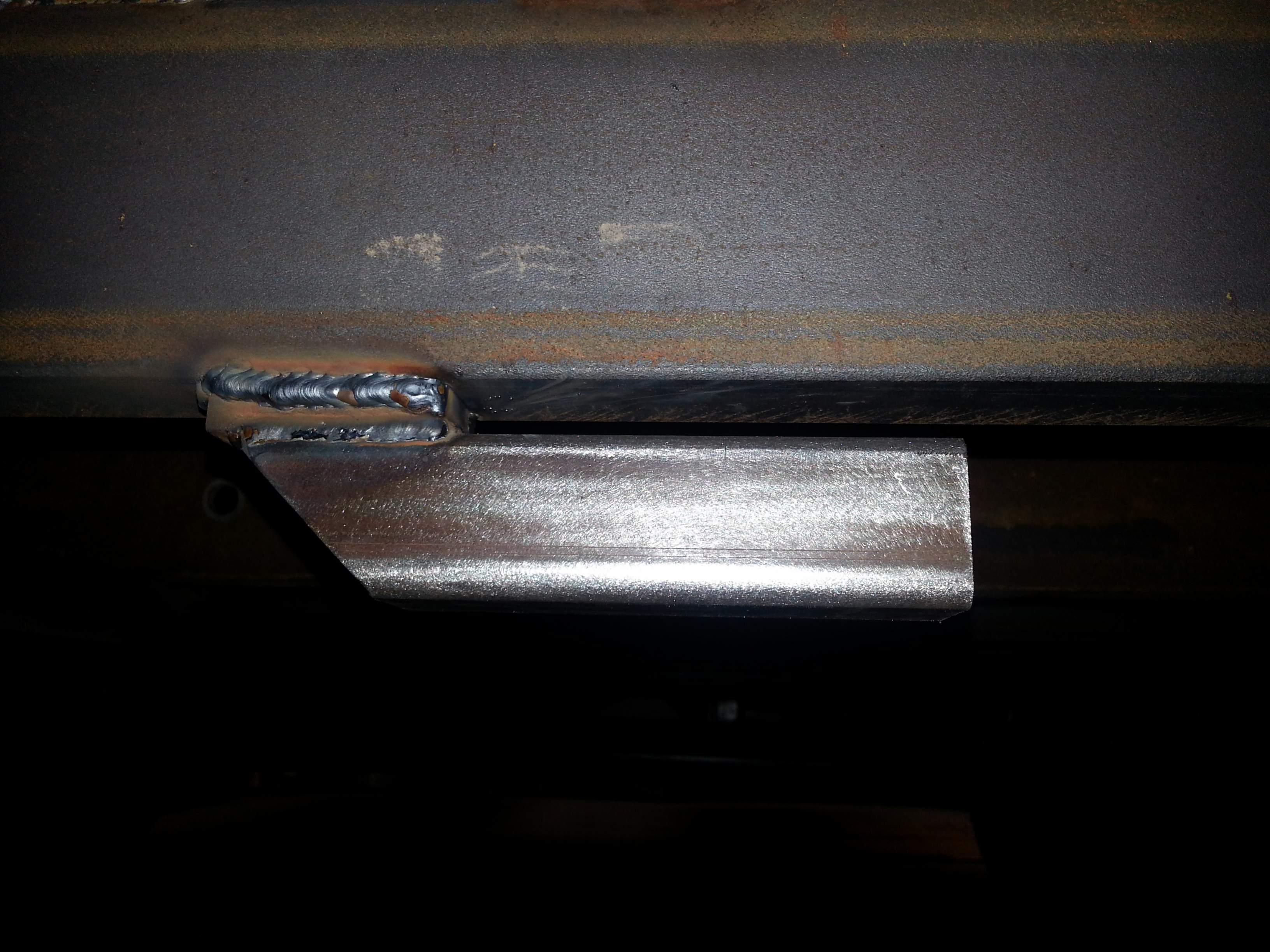

Mount and pin I made for the short jack extension.

I hate welding upside down and it shows. I got one of those little fireball marbles down the back of my coveralls so I like it a lot less now.

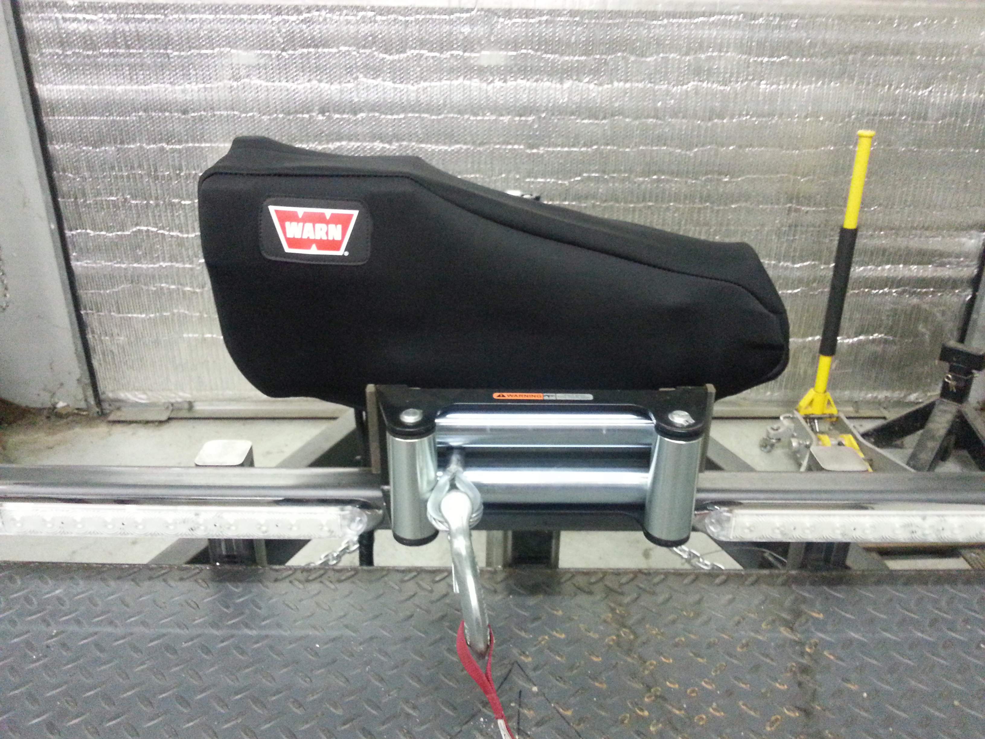

The winch cover I ordered came in.
