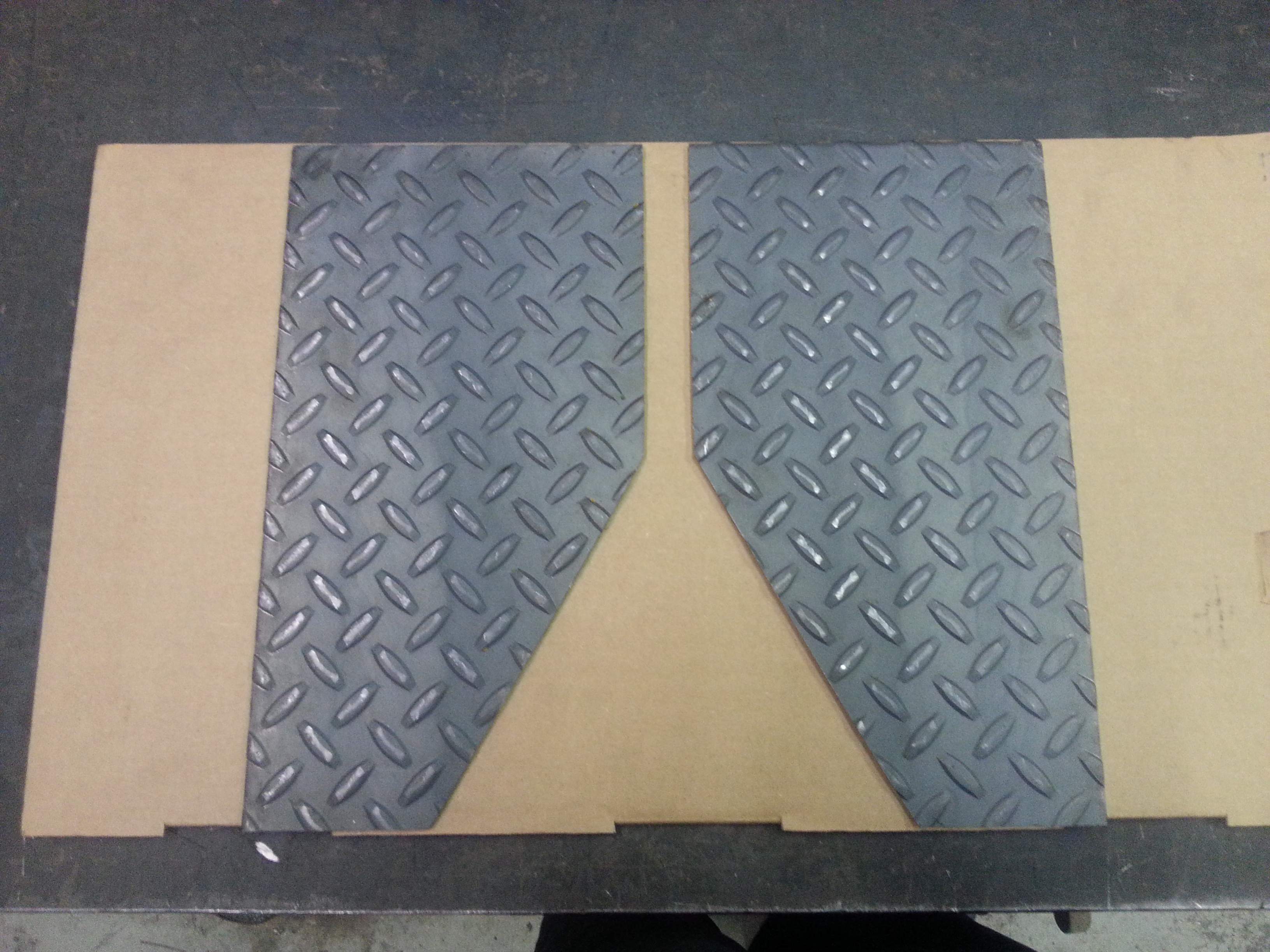

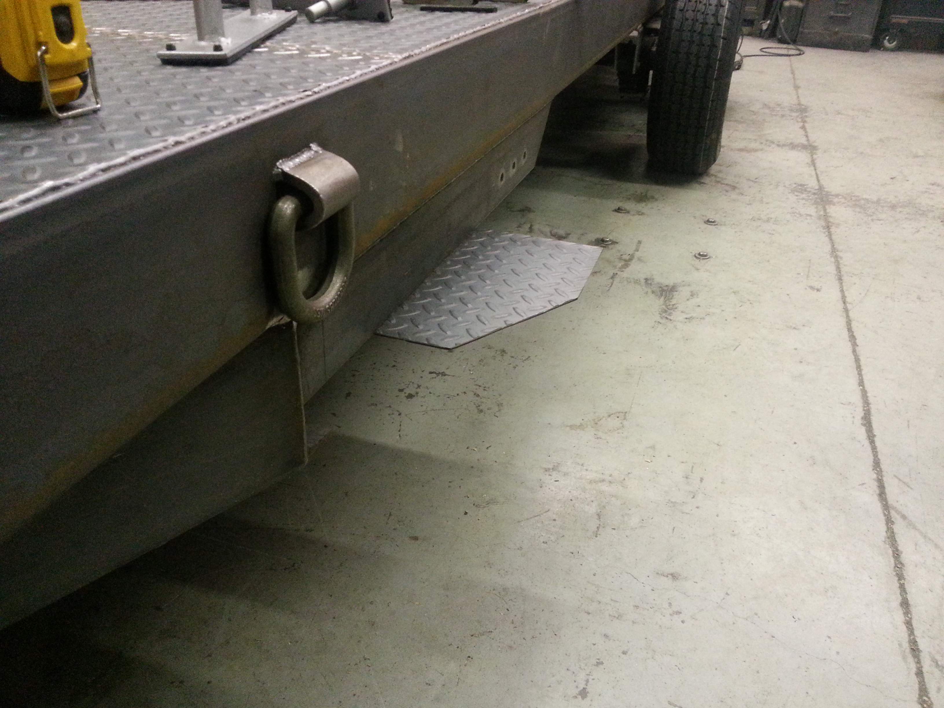

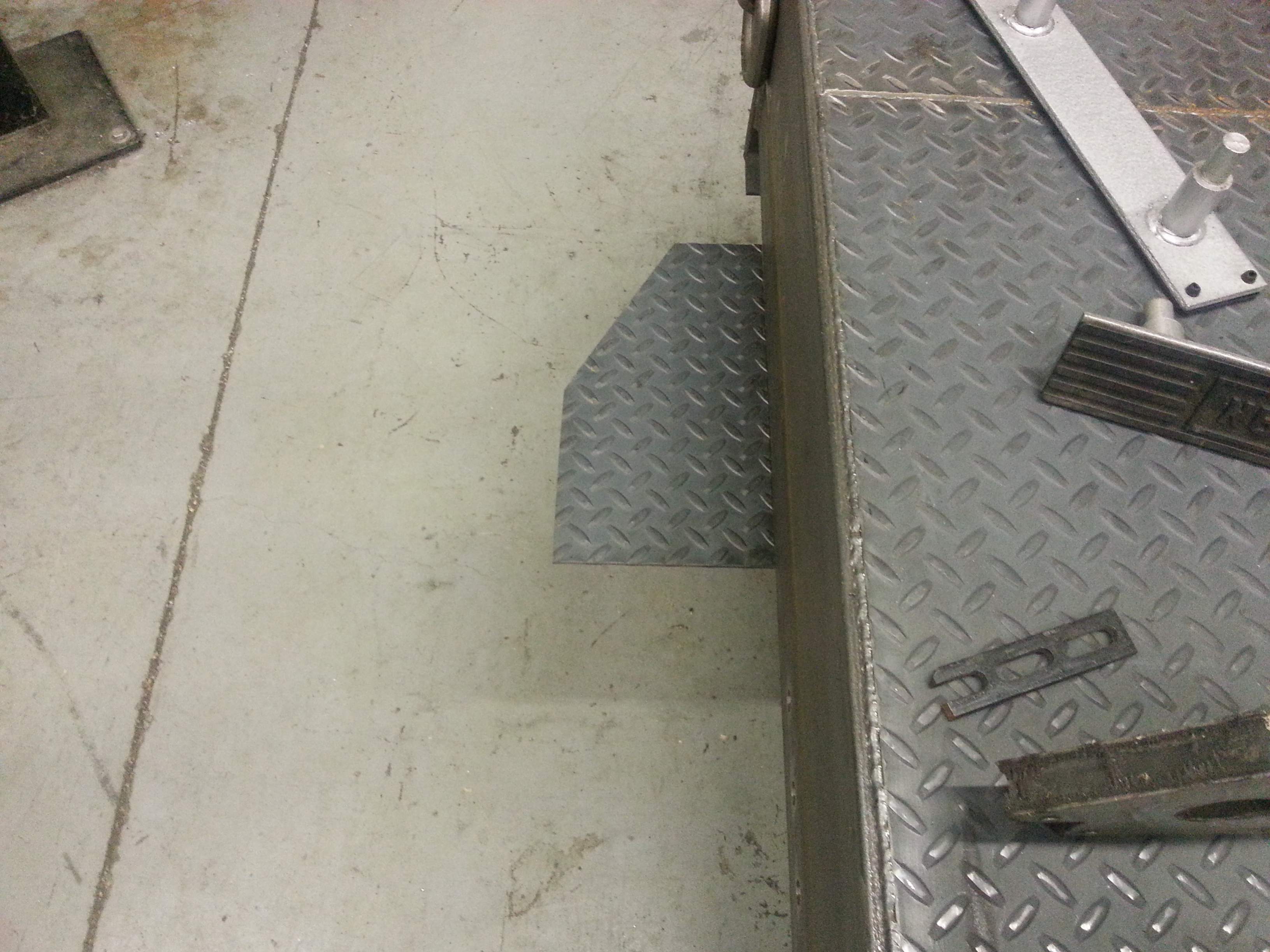

I've been working on some steps, not sure if I like them or not. I think i'll make them bolt-on so I can take them off if I don't like them. I cut the tread-plate with a cut-off wheel. I started working on the frame for them, but ran out of shielding gas.

If you decide to leave those steps on, I'd recommend clipping those rear corners off at a 45* angle - I know what MY shins would look like the first time I walked from the rear of the trailer forward carrying anything :eek:...Steve
/ Split-dovetail car hauler trailer #124
Very nice looking trailer there Buggyman1. I don't think you will like the steps or at least your shins won't. Other then that great job!!

Thanks, i'm still not sure on the steps. I'm still gonna go ahead and make them just to see how they'll look.
I think you're right.

I like the step idea, .....at the front corners of the trailer where you could brace yourself via your hand on the trailer "head rack". I would weld steel pipe around the bottom perimeter or better top, to prevent the step from cutting you, and to secure a muddy boot from slipping off the step.
Trailer looks great so far!

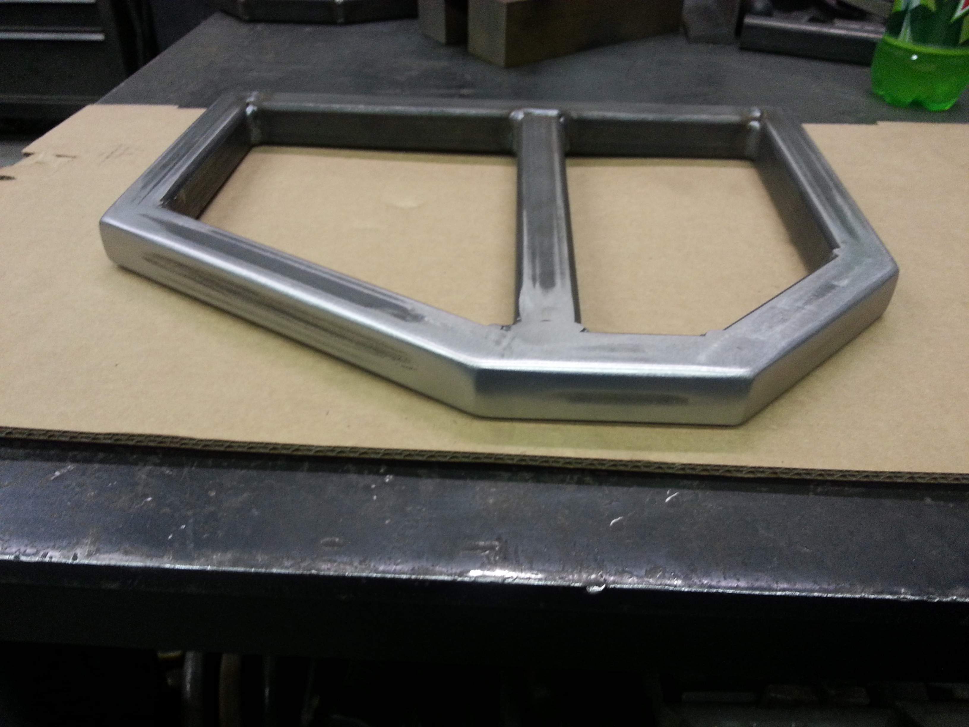

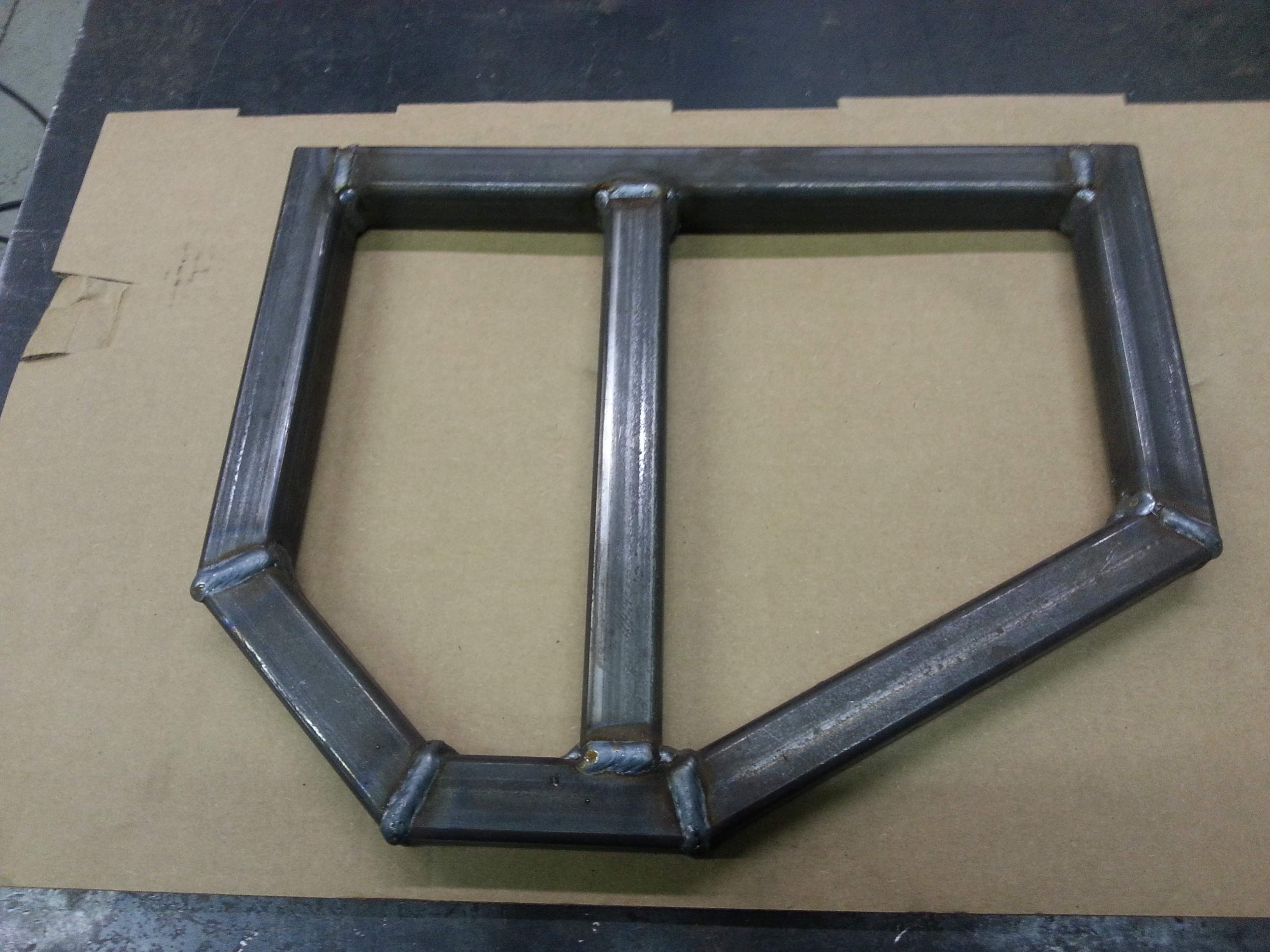

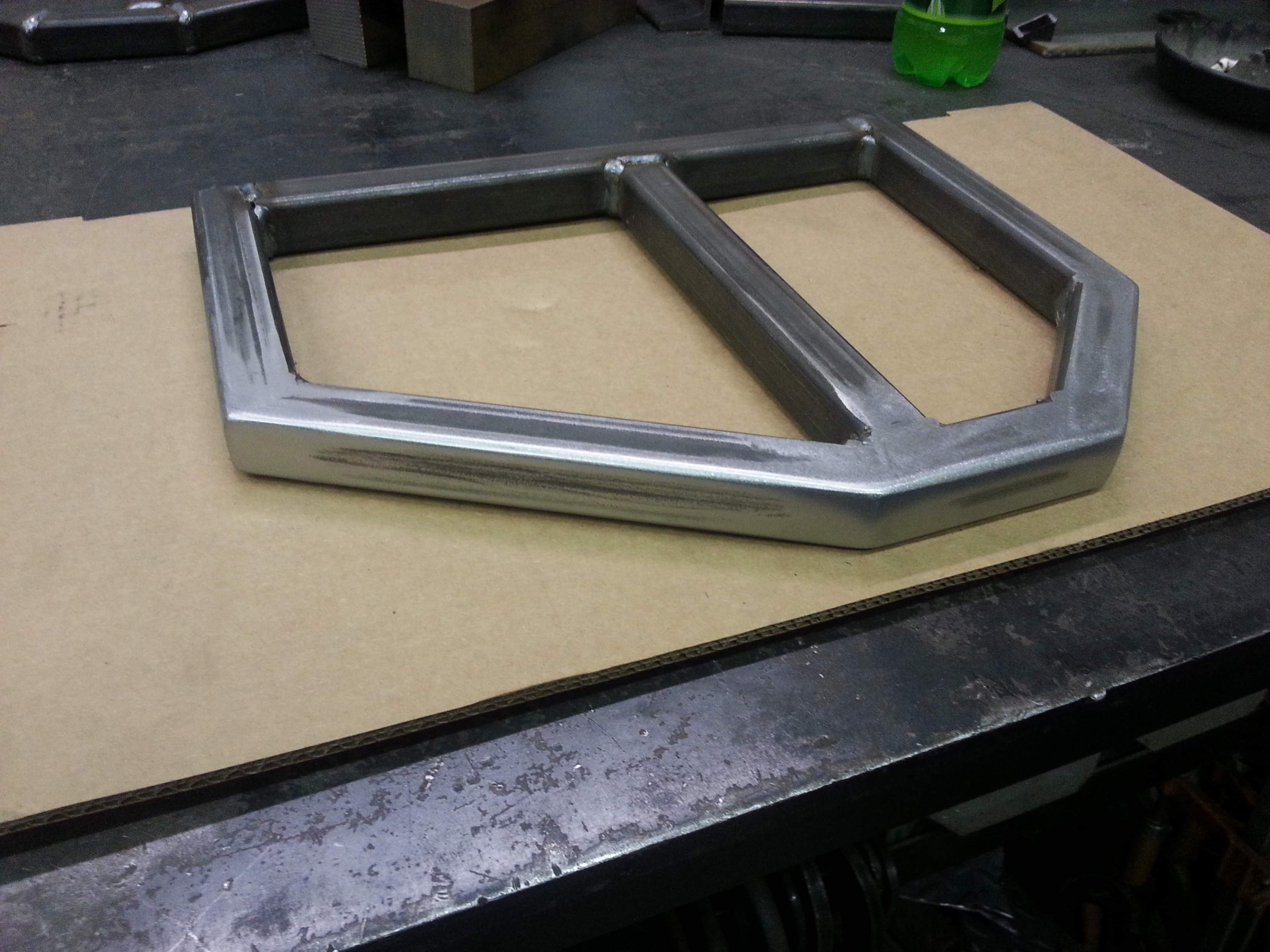

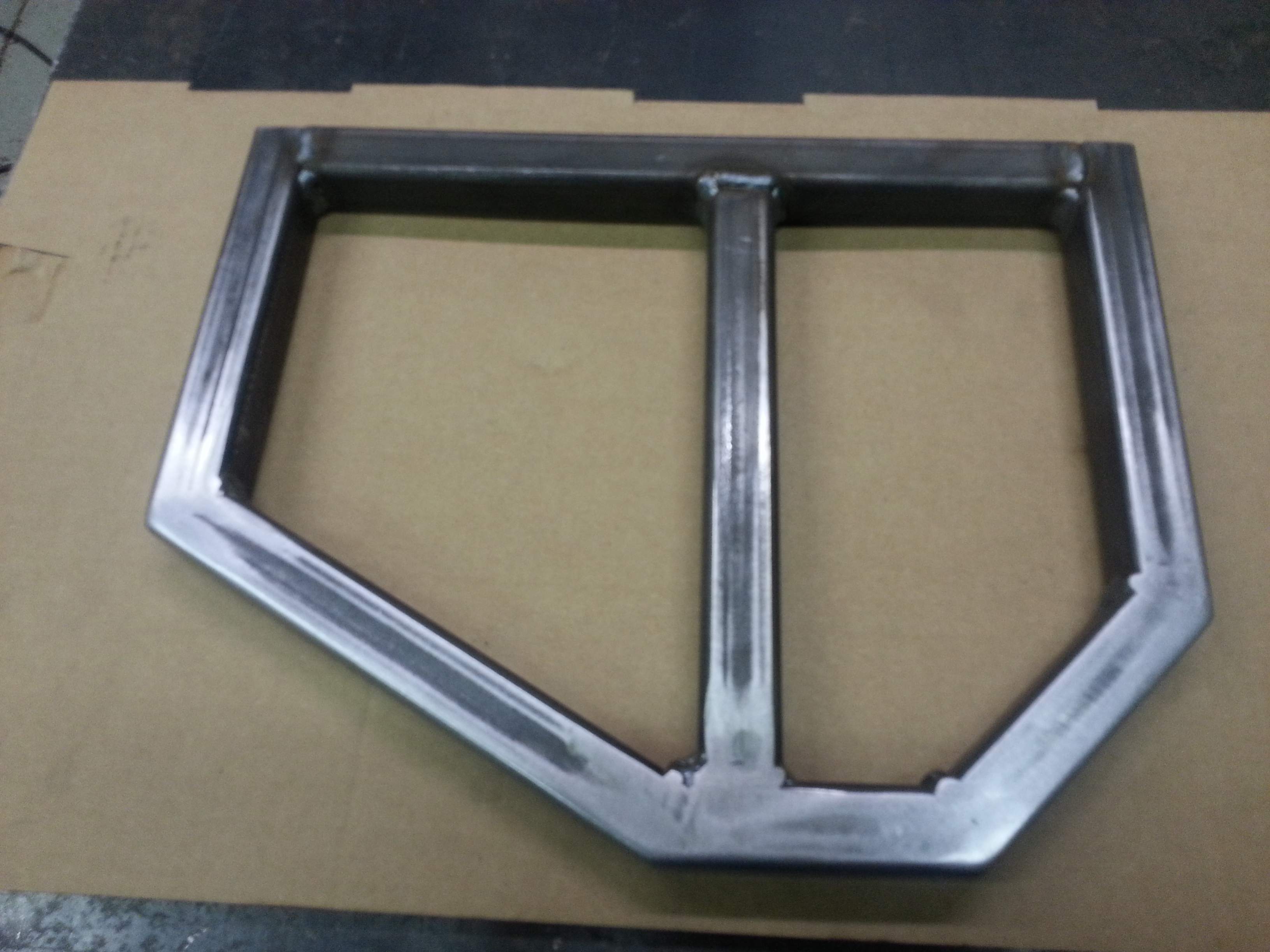

I got some more shielding gas, been working on the frame for the steps tonight. I took everyone's advice and cut a 45 on the shin getter. Problem is it created some fun angles to cut. Here's the frame welded-up.

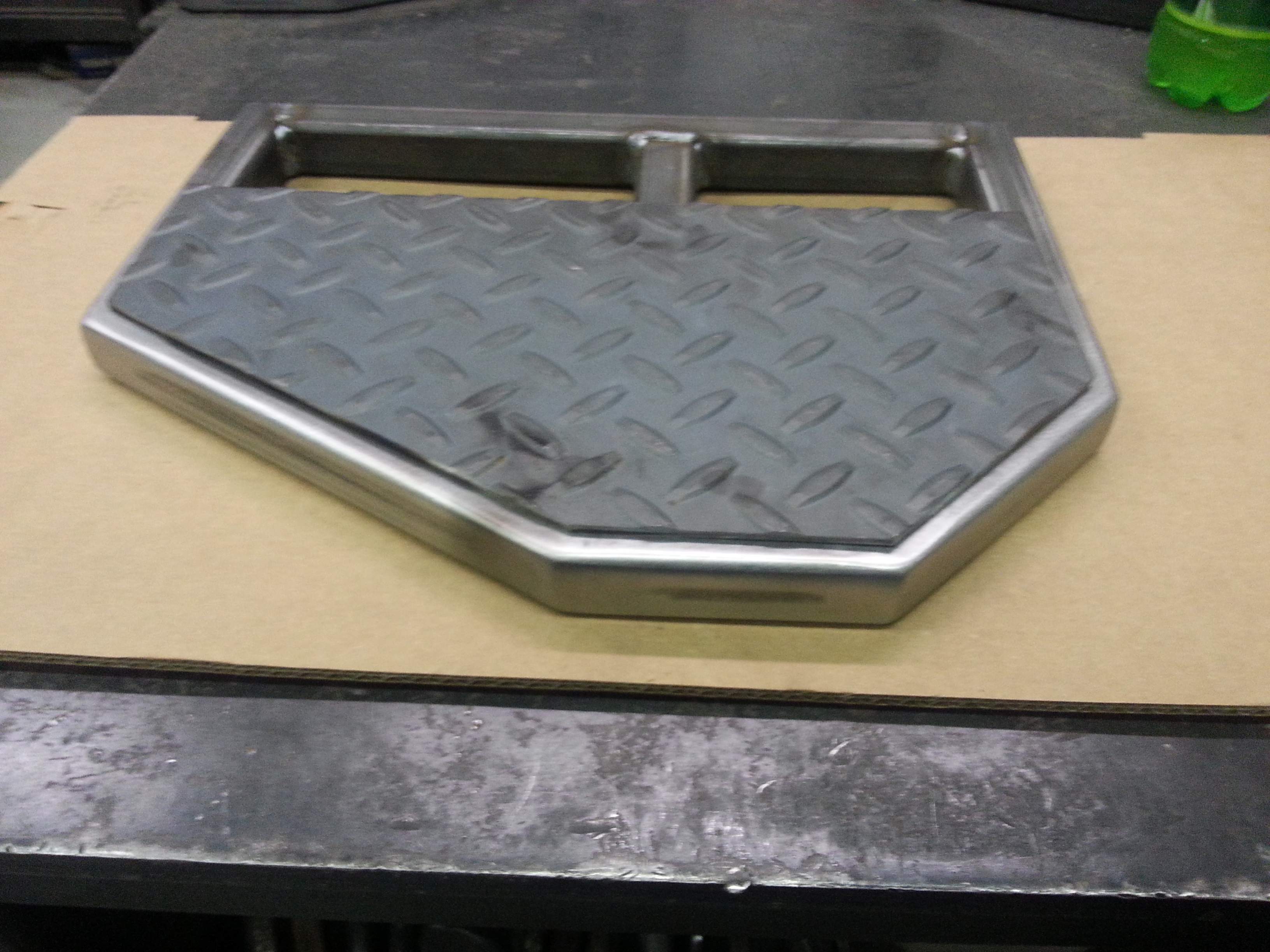

Frame after a little persuasion from my grinder and sander.

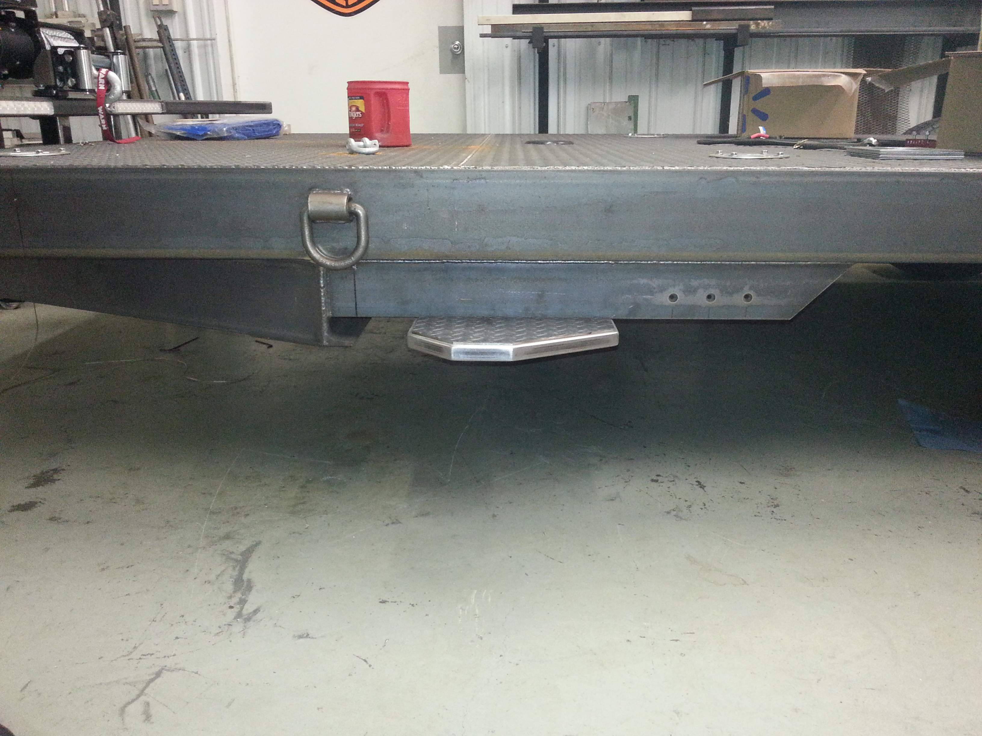

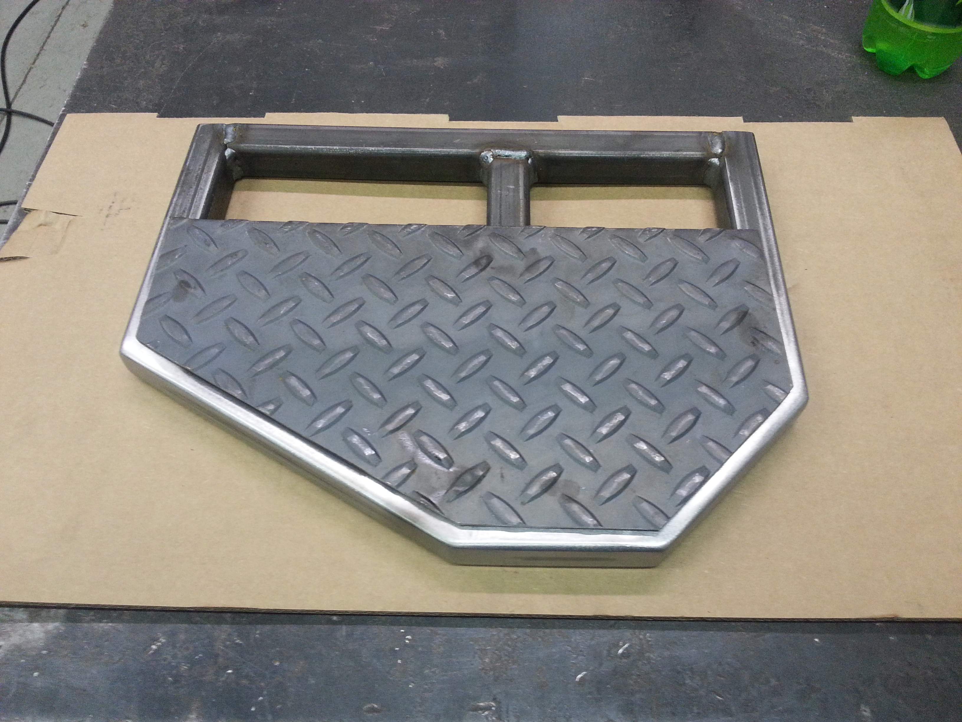

Tread-plate welded to the frame. Next time i'll make the frame, "then" cut the tread to fit. I welded the tread from the bottom to get a clean look. Problem# 2, not sure which way to turn them now! I kinda like the look (both ways), I think after the game i'll finish them up and weld them on.

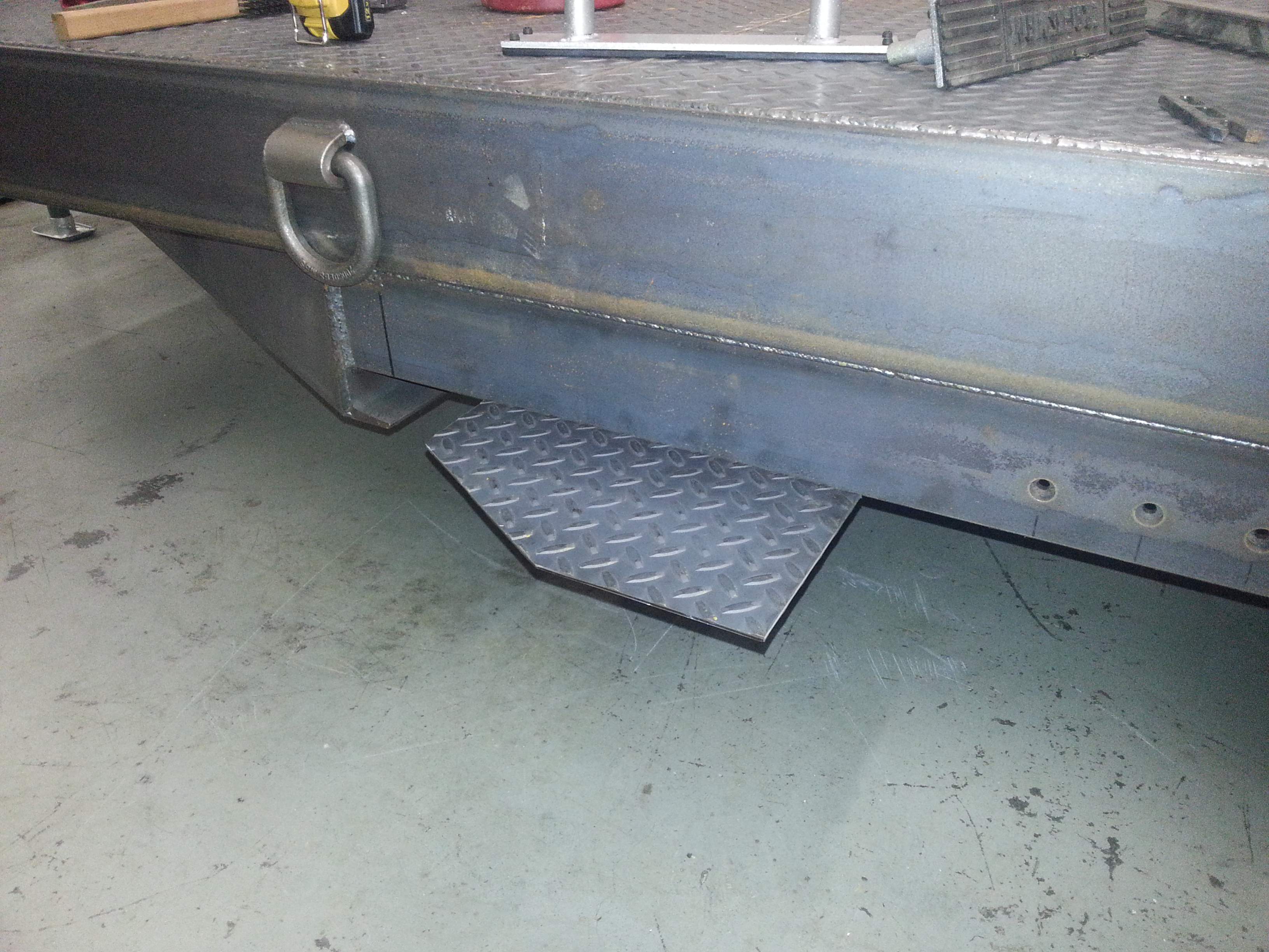

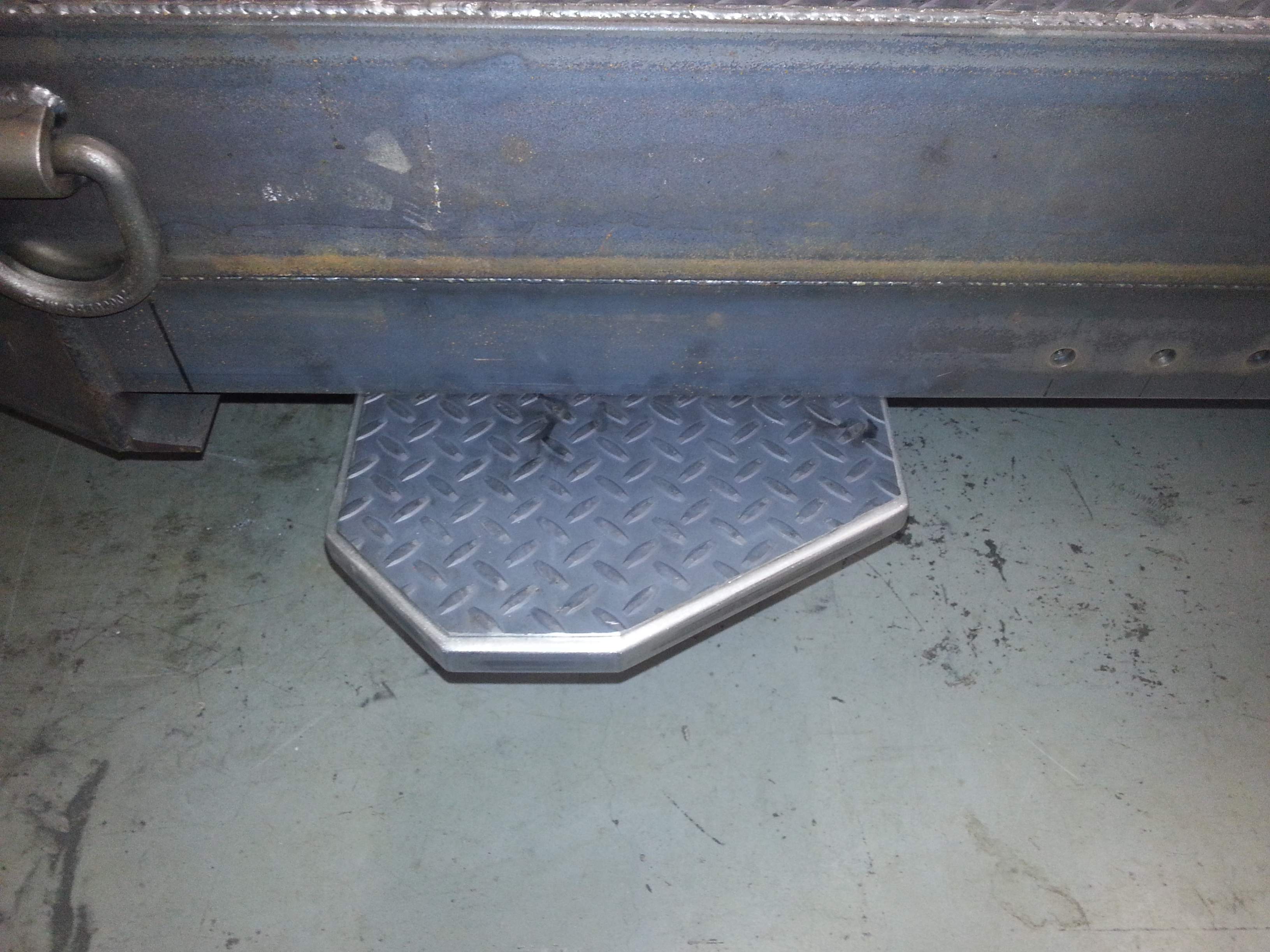

I got both steps done last night, just too tired to post any pics. After a lot of thought, I decided to turn them around. I liked them so well, I went ahead and welded them on.

Size 10 boot, to give you an idea of how big they are.

A few more pics. I'm really happy with how they turned out. I'm going to put a small running light on the outside edge and call them done.
