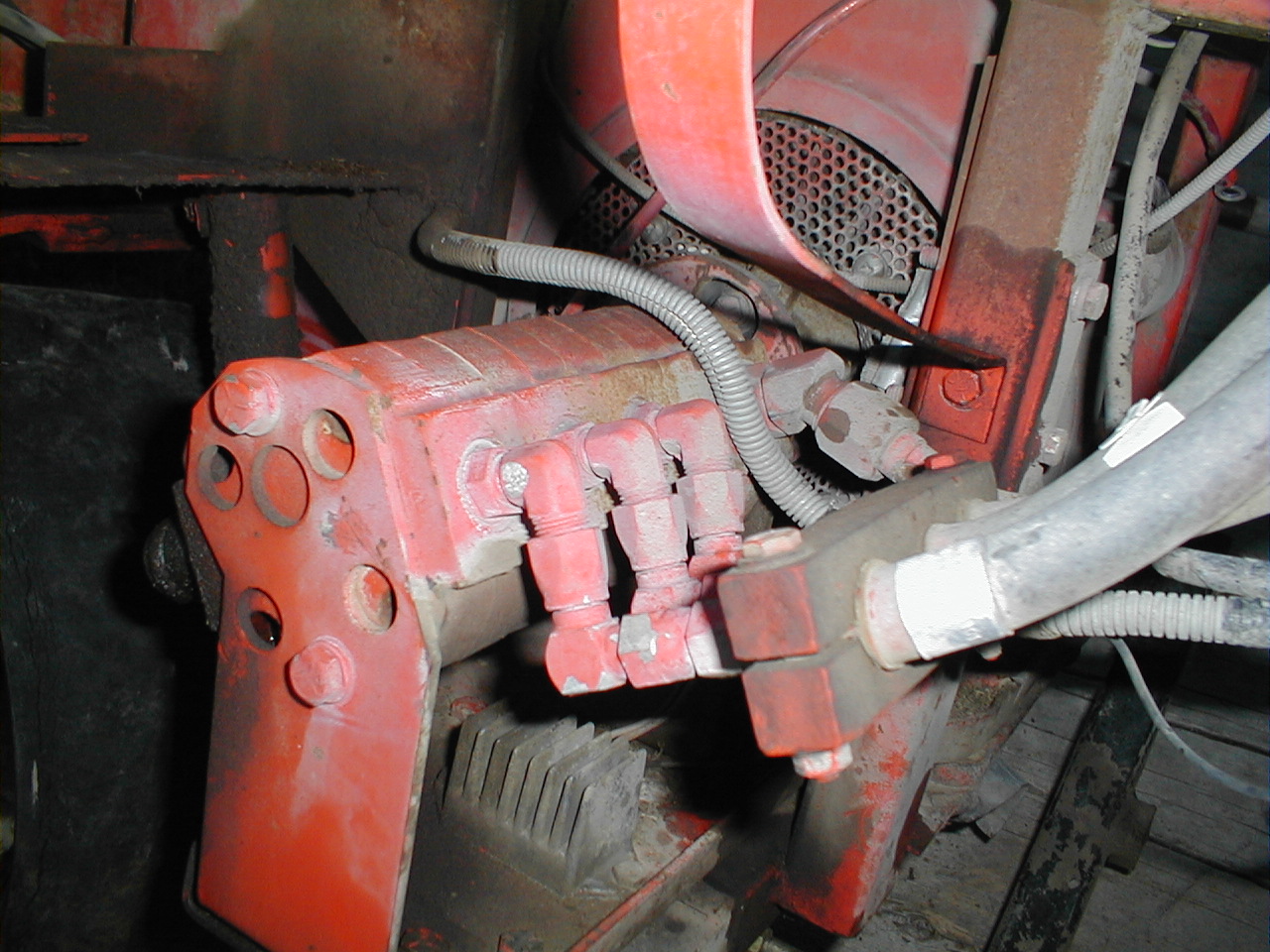

Thanks for the link. I went there, but I don't think that's what this pump is. I attached some pictures below. Take a look and tell me what you think.

Those pumps look like the ones used to power the hydraulic motors on greens cutting equipment. The hydraulic motors turn the reel mowers. I have seen them on Ebay.
Try the maintenance dept at golf courses.

That's exactly what this pump is. I poached an old greens mower that a local scrap guy had picked up for other parts. I got the pump, both motors for the drive wheels, and a 5 spool gresen valve along with the chassis.
I'm planning to use the two motors to drive the separate sides of a tracked vehicle. I'm just trying to get some idea of what it will put out so that I don't end up taking off at 30 mph on the maiden voyage.

I general, a 16 HP engine can support an 8 GPM pump, at 3000 psi. What your pump looks like to me is the large pump drives the wheel motors, and the smaller piggyback pumps drive the reel mowers on the greens cutter. You could probably use it as a log splitter pump. You may be able to separate those extra pumps off and put a cover plate on the one pump.
If you were to use a 4 in bore with 2 in shaft, then you could expect about 18.5 ton of force from that engine and pump.
If you check around at some of the golf course maintenance facility, they might still have manuals and schematics on the mower.

Just to update this thread. I came across another project which happened to be a towable backhoe. I tried a different pump but that one needed more power then the 12hp Wisconsin could put out. I decided to try the Barnes pump. I took it apart and put the gears and the woodruff key out of the three unneeded sections. It works like a charm. I'm still surprised at how easy it was to pull the thing apart.
