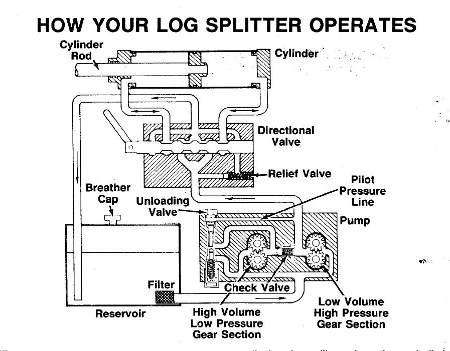

I am probably telling you stuff you already know but others will read this and may benefit.
The control valve for the splitter will have a relief valve for the splitter and the pump depends upon this relief valve for protection.
Theoretically the pump can develop high enough pressure to split its case as occurs when someone dead heads a pump which is blocking its discharge without a relief valve.
The splitter system will be Open Center which means continuous low pressure flow from the reservoir, through the pump, through the valve and back to the reservoir.
Pressure only builds up to high levels when directed into a cylinder and the cylinder reaches the end of its stroke.
Your gauge could be Tee'd into either cylinder line. You will be reading the relief valve pressure if the pump is working properly.

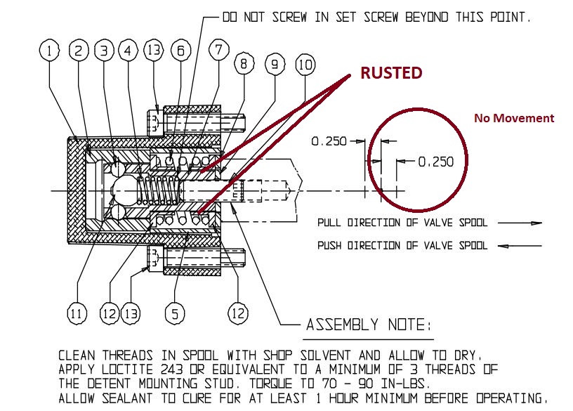

Curiosity started when I was trying to operate 3 way valve and it would not go to extend position but would go to retract position.... Being the fiddler I am I looked up how the 3 way valve operated and
researched to a point that IF I did not disassemble it I would not know what was going on (sad to say I had to resort to YOU TUBE to get visual on detent assembly) ...Took detent assembly apart and discovered that it had sat for so long the detent end of valve had rusted to a spring retainer and was frozen so it would not move into extend position but valve would compress spring into retract position...
Completely cleaned up/removal of rust and polished all sliding surfaces in detent side (no I did not remove main shaft from control body as it seemed free) a bit of grease and all is good with detent body (control valve) ...
This provoked me to inquire what the pressure values were in system and the manual I have (with matching model number) did not really state how to test or adjust pressure other then in part list said "Control Valve - 3000 PSI)... Using the 3000 psi figure from parts list and fact it has 4 inch diameter cylinder does not exactly calculate out to tonnage on cylinder badge (22 ton) or statement in manual (20 ton)...
Dale

I would put a tee between the pump and the valve and put your gauge there.
That way you can see pressures for extending or retracting.
