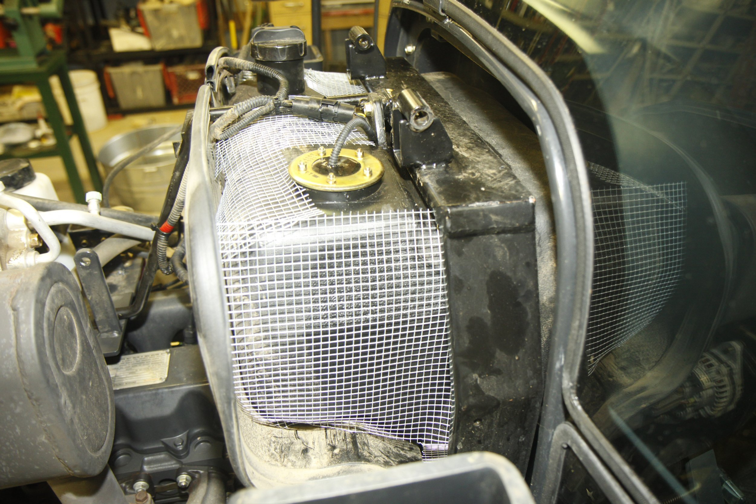

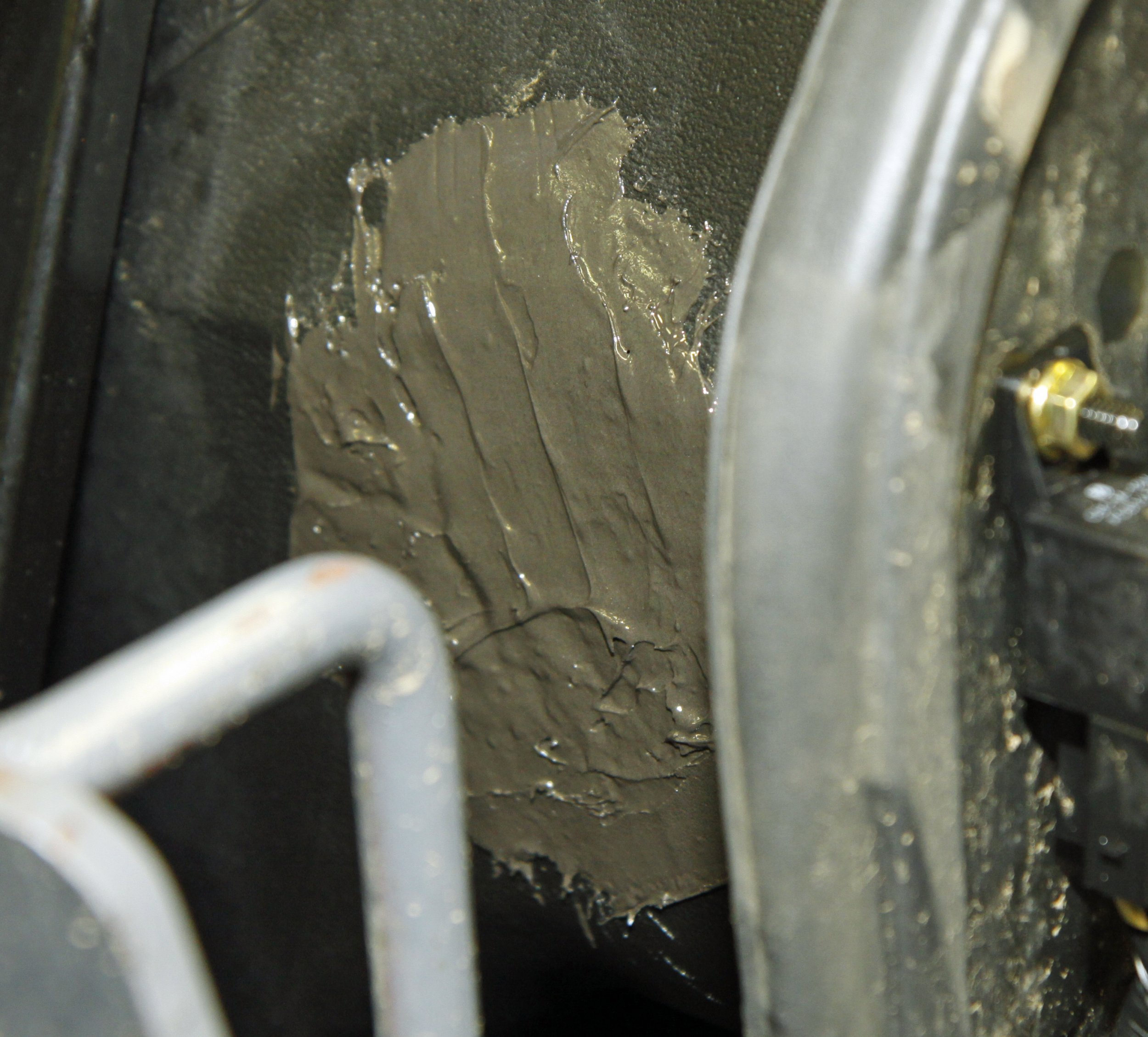

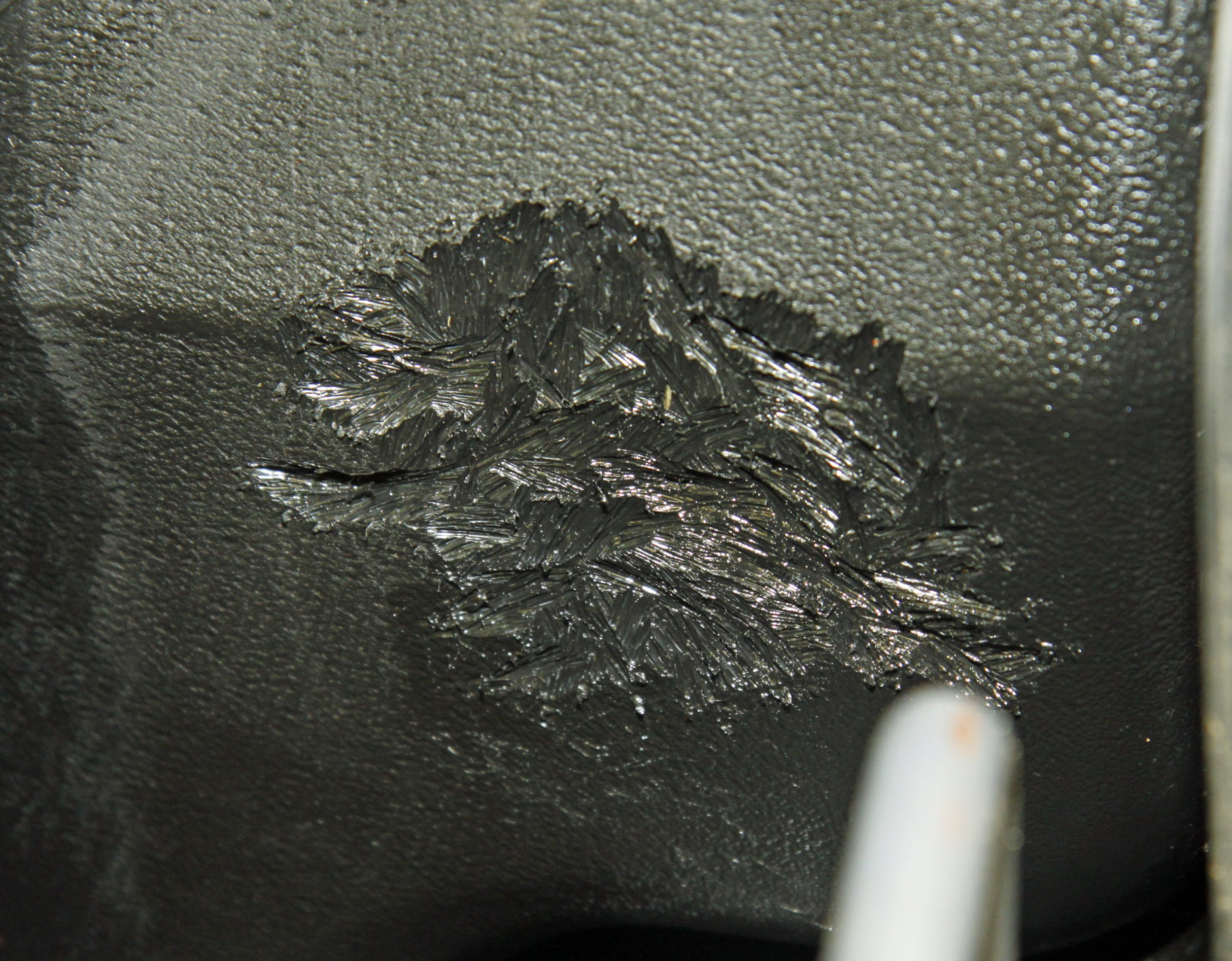

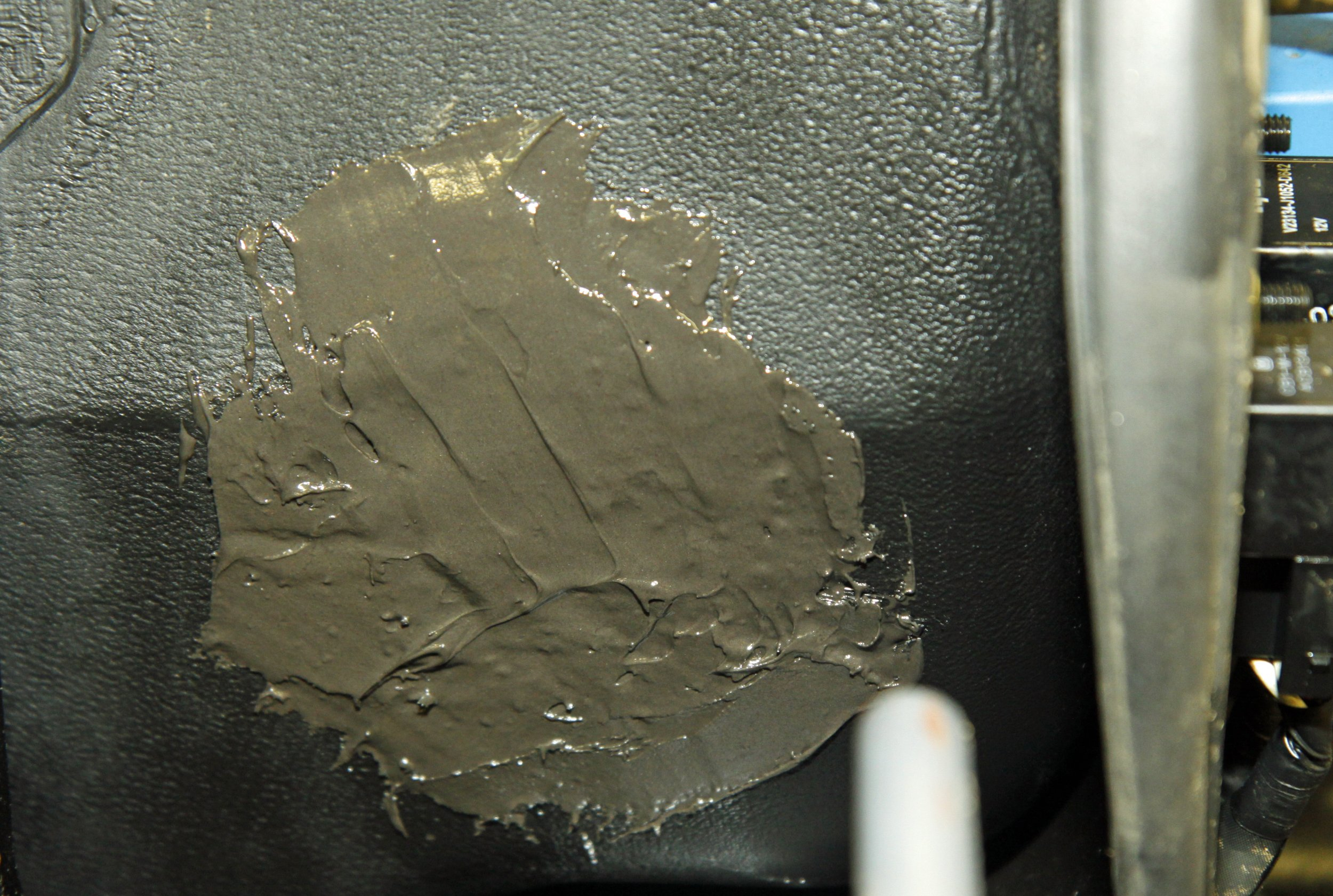

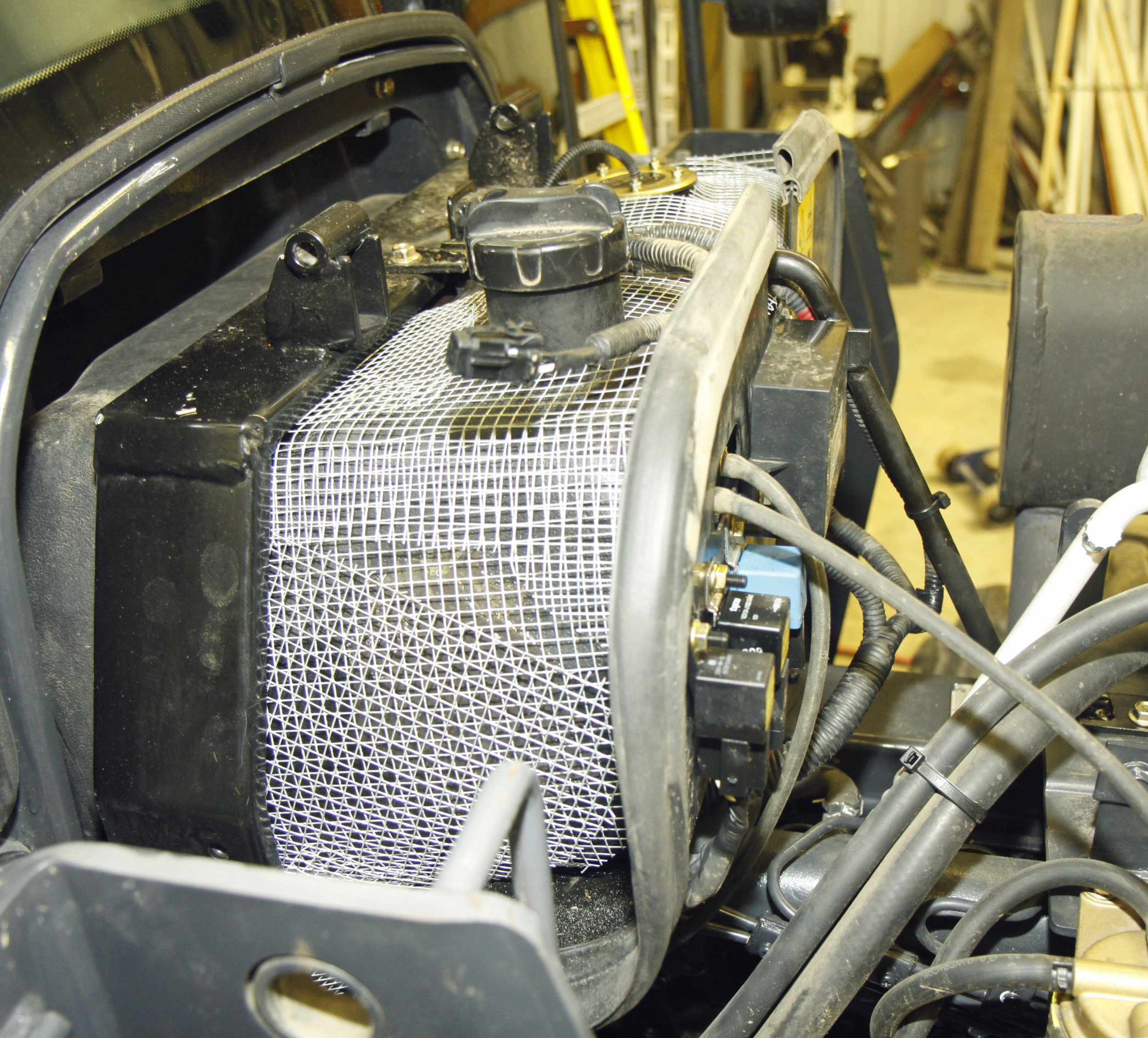

i had a critter of some kind chew thru my fuel tank on my DK45. you could see the teeth marks. i ordered a new tank, but in the mean time i used JB weld gas tank repair kit. my damage was near bottom of tank.
that was about 9 years ago. i still have new tank sitting in my shop. the repaired tank is still in tractor. i also added a screen over tank to discourage critters.
some day i may take 4 hours and install new tank......but i doubt it.

That's a new one for me! Good thinking on the wire mesh.
   / Sometimes you just want to flip off the universe... #35
I just hope the critter enjoyed their mouthfull of diesel.
damn rodents
the screen worked…..if not, i was going to wrap it in 16g steel.
