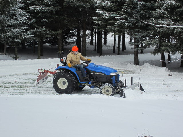

I would also question what RPM the folks with tractors are running. My dealer told me that I should run the RPM right up to 3000 . . . but I think I recall someone else saying that they run their sno-blower at 2000 . . .
What rpm do you run to achieve 540 rear pto speed? I would run that speed at a minimum.
Rated engine speed for that model is 3200rpm

I don't know about ' rear PTO speed ' because I don't have any implements which utilize the rear PTO. My sno-blower is front-mounted and operates from the mid PTO. The book sez that @ 3200 RPM engine speed, the mid PTO speed would be 2100 RPM which is the proper speed for this sno-blower. However, 2100 RPM is NOT the impeller speed because there is a reduction ( unknown ratio ) from the drive chain sprocket in the sno-blower to the driven chain sprocket which is attached to the impeller shaft ( which also operates a worm-gear drive that rotates the augers ). The whole drive train for the sno-blower ' seems ' unnecessarily complicated, but I'm not enough of a mechanical engineer to see how it could be simplified and yet maintain the compatibility with the other interchangeable implements . . .
With pretty much any implement, the manufacturer will design it such that it operates best at a specific PTO speed. For rear implements this is usually 540. For mid-pto it varies more, but 2100 to 2300 seem typical. The tractor manual should tell you what engine RPM to use to achieve the expected PTO speed. In the case of my tractor there are markings on the tachometer so you can line up the needle with the 'PTO' and away you go. Many people will report they like to run it at a lower PTO speed for whatever reason. Highly doubt you'd damage the equipment by running it at a lower speed. If someone said they liked to run it lower, I would just ask why -- if they explain what they got out of it you may find out if that same thing would help you or not.

I can't agree with this. The impeller running at 600 rpm has a lot more kinetic energy than one running at 300 rpm independent of the power of the engine that runs it. Now, if the snow was heavy enough to bog down the engine, this would make some sense but that doesn't happen. I've got 18 hp at the PTO and the engine rpms never vary when snow blowing. 100 hp would not put more energy into the snow that's being moved.
/ some thoughts on my snow removal options #32
It depends on what you are disagreeing with. If you are talking about VOLUME of snow, then yes. The chute has a specific diameter, like a water pipe. There is a limit on how much snow will be able to pass through, aka flow rate. Once this flow rate is reached, it won't matter how much pressure/force you put behind it, the flow rate will not increase. Assuming that 18 hp will have sufficient pressure to max it out, then doubling the HP would have no effect.
If an engineer is building a snow blower designed for a 50 hp PTO, chances are they are going to add a bigger auger, wider chute, etc versus one designed for 18 hp. The impeller may run at a slower RPM however it will move more snow volume not because of its power but because of the flow rate of it being larger. It will need more power to move the larger amount of snow at once.
Don't believe it? Here would be the proof. If you set up an experiment where you took a snow blower designed for an 18 hp tractor and hooked it up to a 50 hp tractor, the volume of snow moved would not increase by much. That is of course assuming that the manufacturer who built it made sure that 18 hp was enough to maximize the flow rate.

You can move more snow at 300 rpm and more horsepower than 600 rpm and lower horsepower... but not with the same snowblower. The amount of snow is based on the volume displaced by the impeller and the distance thrown is based on the tip speed of the impeller, so to take advantage of the high horsepower at low speed you would need a much larger diameter impeller.
If you look at an 8 foot wide blower compared to a 5 foot wide blower you will see a much larger impeller. As impellers get bigger, eventually you would have to slow them down because of high tip speeds but I think most of the commercially available 3 point blowers are designed for 540 rpm. The bottom line is that if you can run at rated speed without bogging down the engine with a given snowblower, more horsepower would not make a difference.
As a Mechanical Engineer who did his masters work in fluid dynamics and design of rotating machinery, I'm sure the engineer at the implement company was correct that a blower could be designed to deliver more flow at lower speeds but it seems to not be a practical point.
If you want to move snow and already have a snowblower, run it as fast as you can.
