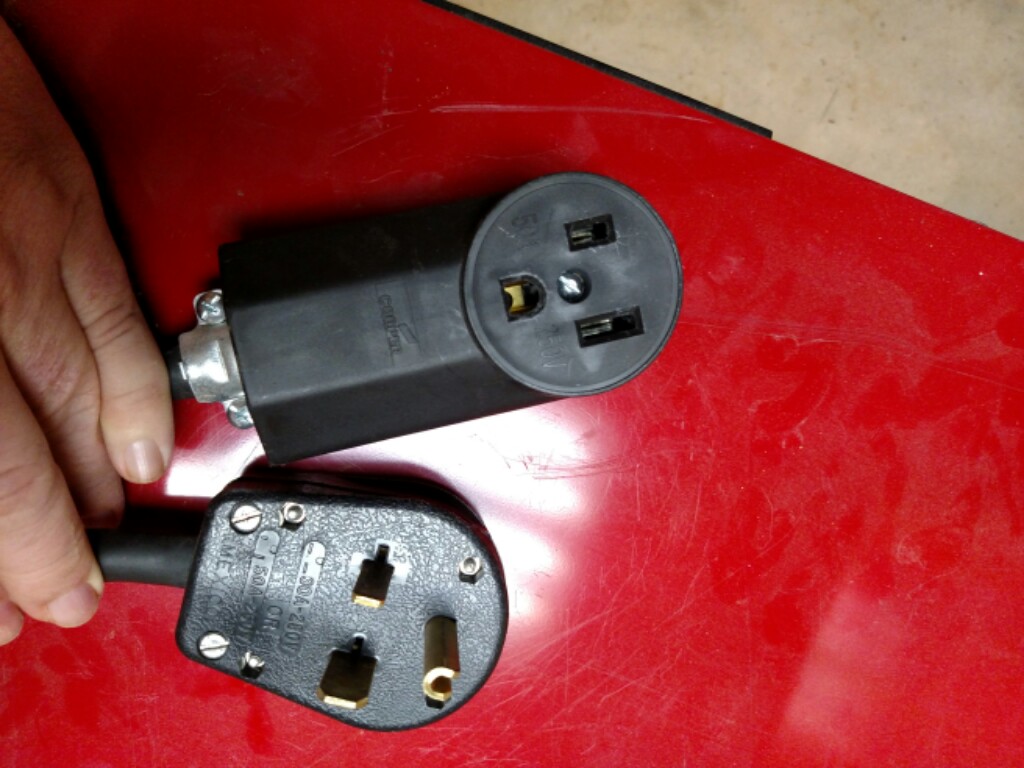

Home Depot sells this extension cord :
It's Rigid brand. 100ft 10/3 for $139.00 or 50ft for 99. It's soft and easily bendable rubber and works great. I have the 100ft and have used it on my 240v welder.
It's cheaper than their SOJ cord but also have ends on it.
I made a 240v adapter so I didn't have to cut the ends off.
