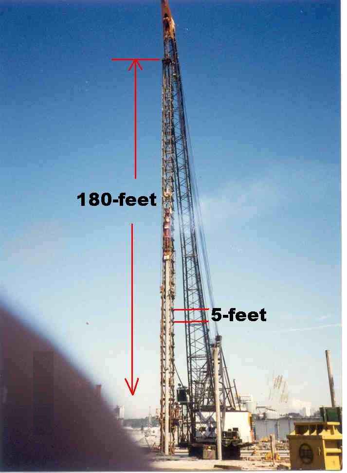

Stick welding has a few advantages over Mig / wire feed. Welding exotic metals for one. Jumping around a lot, or working real high. But I've had the crane operator take a wire feed up to the top of pile driving leads on the headache ball for me to repair them.

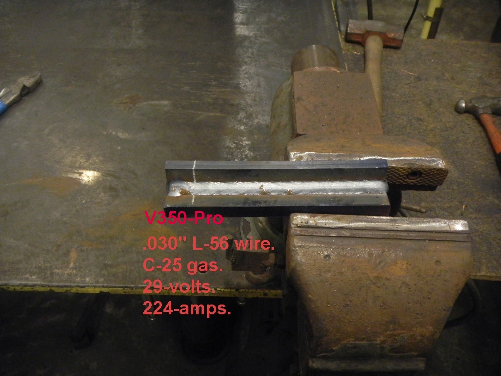

When it comes to Mig welding, there is no substitute for power! :thumbsup:

No. I've seen some experiments with MIG machines welding, but it really isn't possible to do well or right as is. Keeping it simple, it is because MIG uses a constant voltage power source, and stick a constant current power source. These are the names given as they loosely describe what is happening while the power source is operating. There are changes in voltage in MIG, and current in stick, but these changes are minimal compared to the changes in amps while MIG welding and volts while stick welding. Basically, voltage goes down the closer the arc is held while stick welding. In MIG, the amperage is controlled by the wire feed speed, but it falls when the wire touches the puddle.
Anyway a unit has to be designed to perform both type processes, though a stick unit can be used to power a voltage sensing wire feeder. Shield Arc can tell you all about those.
