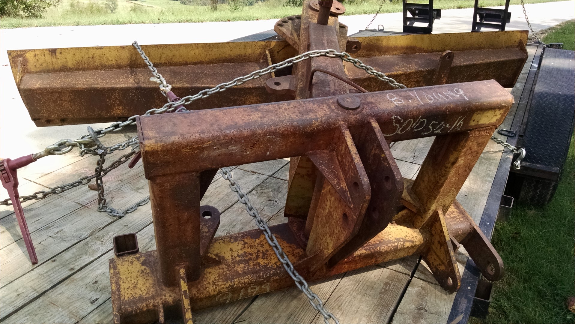

I currently have a Lincoln Sp-175 Plus 220 VAC-only MIG welder. I've had it since the late '90's and love it to death. But now I'm retired and live on a farm and now will need to start welding farm-type stuff (read: thick). Also, my first welder was a Lincoln AC-225 stick/buzz box.
For example, I'll need to weld Cat I ears on this +1200 lb blade scraper I got a month or so ago (see pic). This is just one example.
I want a new welder that will complement but not overlap or replicate the SP-175 capabilities too much. I can use the SP for the sheet metal to 1/4" stuff; the new welder needs to be able to do the +3/8" and up.
TIG would be nice but not a requirement. Budget is less than $1k, so I think a larger MIG is out. I have power to burn: My home and shop are on their own transformer and the shop has plenty of 220 VAC open spaces; so I'm good all they way up to 220 VAC at 100 amps. 120 VAC convertibility not required nor wanted.
Based on comments by other users and notable weldors (SA for one), I'm thinking the Everlast Powerarc 300ST (see link below). However, I'm open to other ideas and products. One thing that bothers me about the 300 is the lack of foot pedal and the ability to add one; I thought you needed a foot pedal for TIG, yes/no?

Honestly, for welding old, rusty steel, it's hard to beat a plain old stick welder. A lot of very big stuff has been built with stick welders. I would look at a TIG more for stainless, aluminum or precision welding. You could do what you want to that implement with the welder you have if you bevel things and make multiple passes.

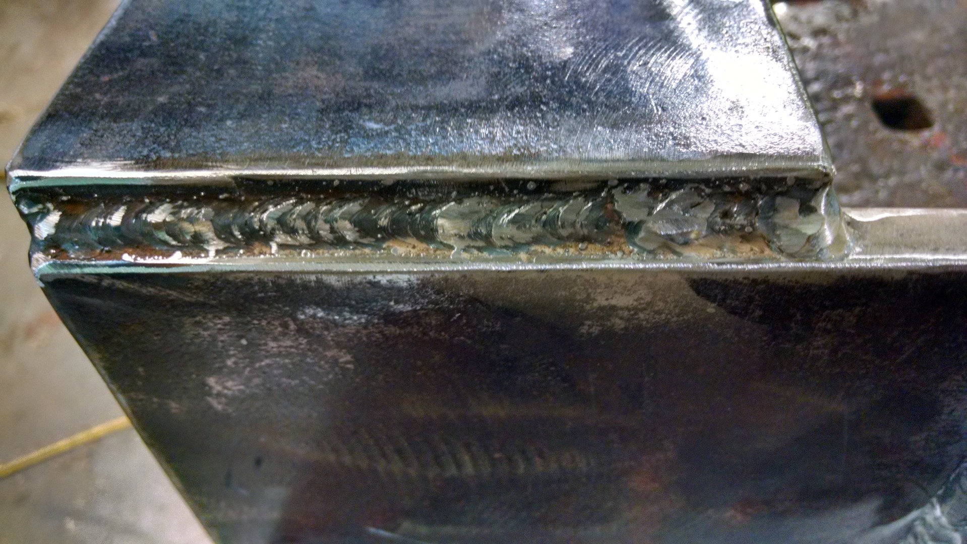

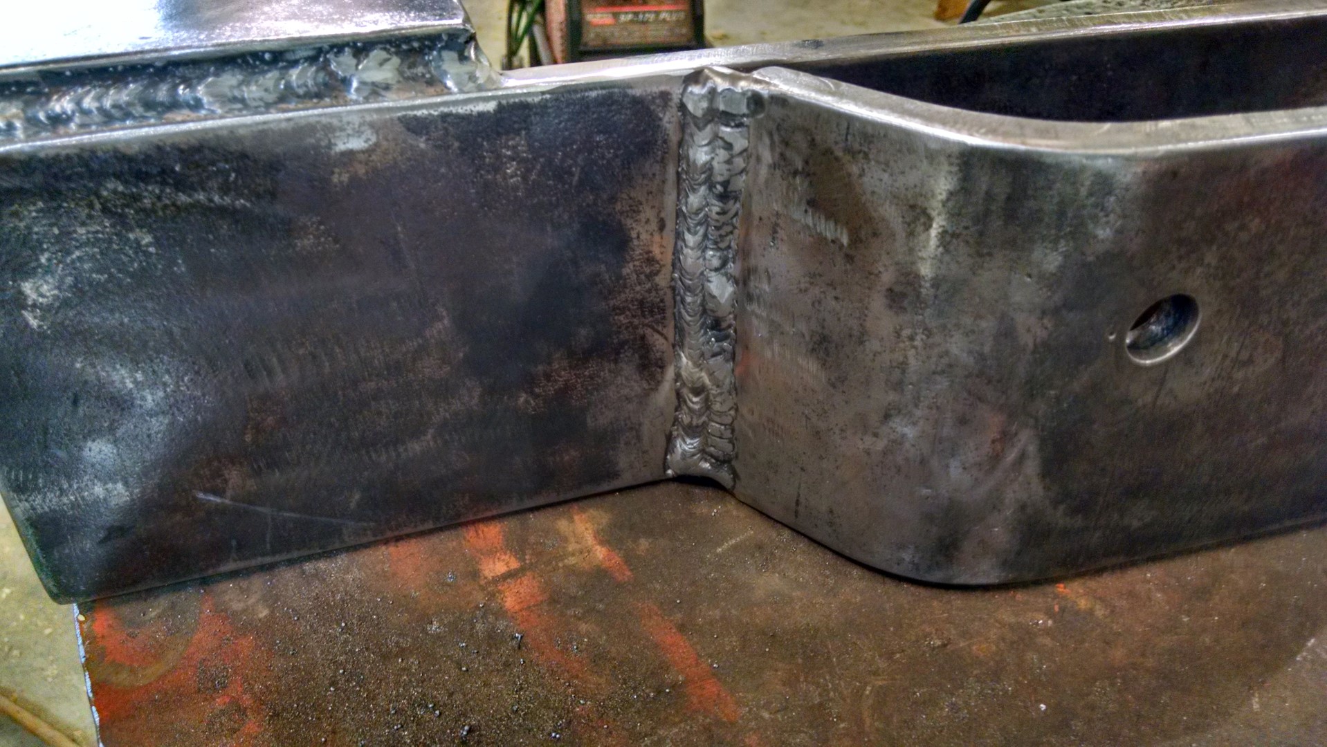

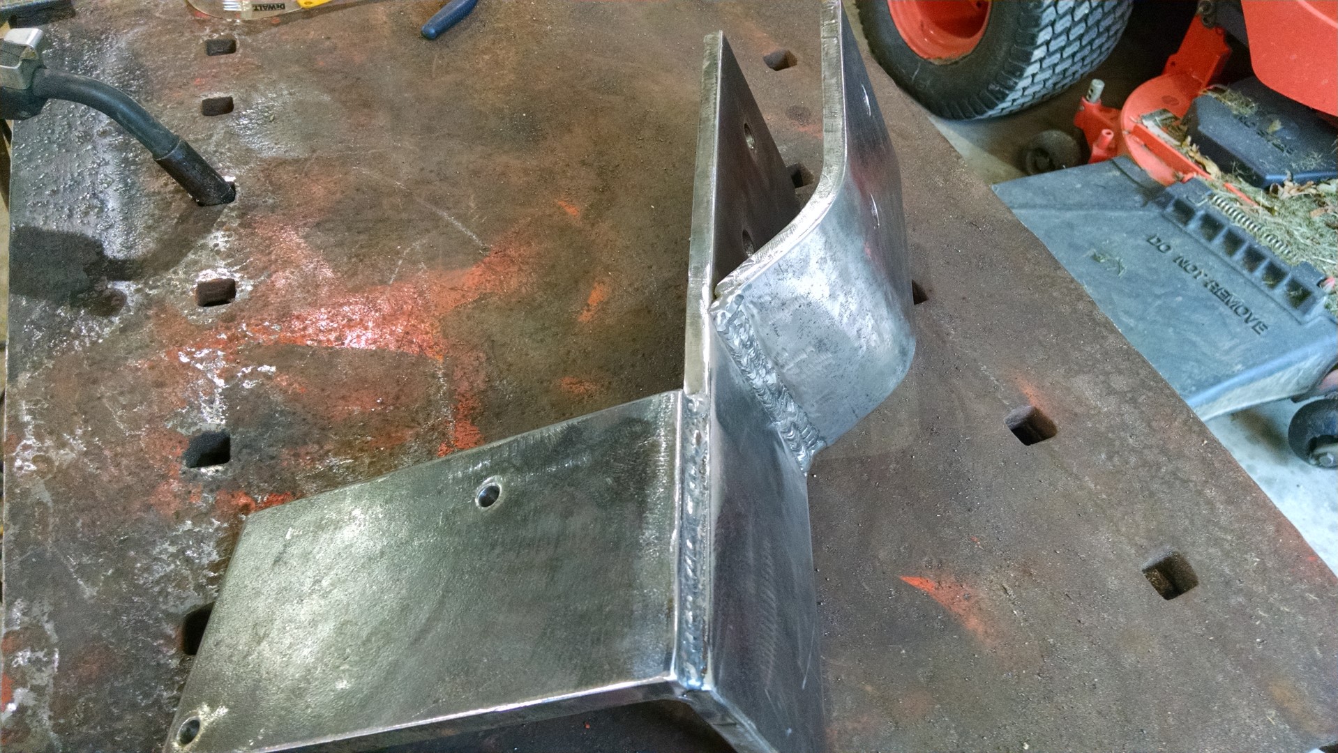

I've never needed to welded on SS or AL before, not sure I'd ever need to though.
Carbon steel = armor plate (AR-500) etc? "Arc force"? You'll have to use baby words for me to understand.
"Xray quality welds" HaHaHa! That's pretty funny! My biggest welding goal for the last 25 years has been to graduate from bird****-quality welds. See pics for latest example. 1/2" steel on 1/2" steel; looks like crap, but will *probably* hold since the application forces are low. The Cat I ears on the scraper blade is another matter - I need to stack the deck in my favor as much as possible.

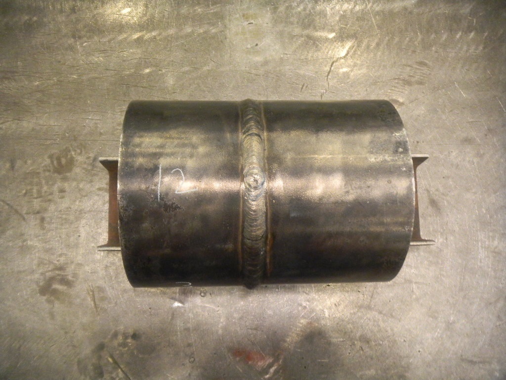

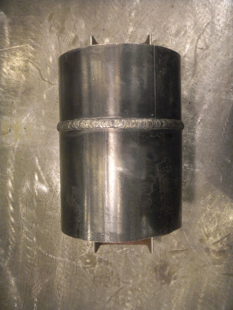

Here is what the PowerArc 200ST can do with 6010, and 7018.
