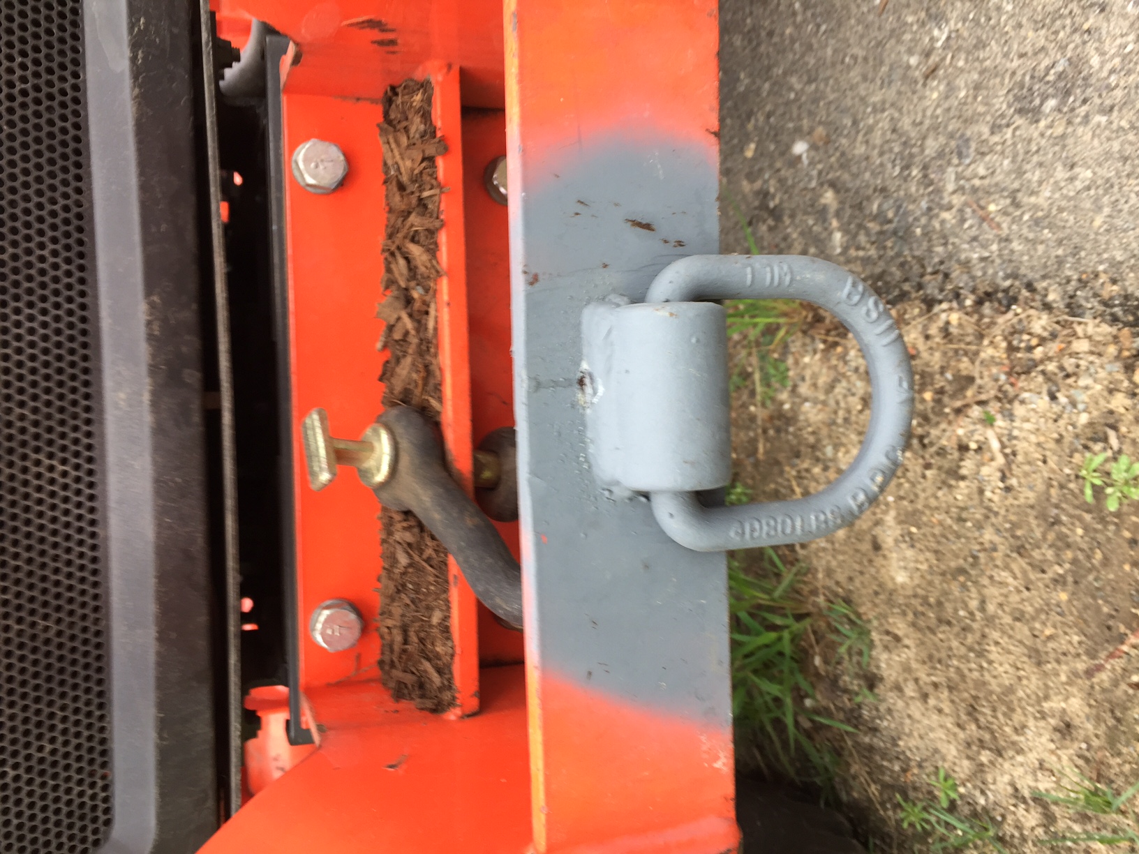

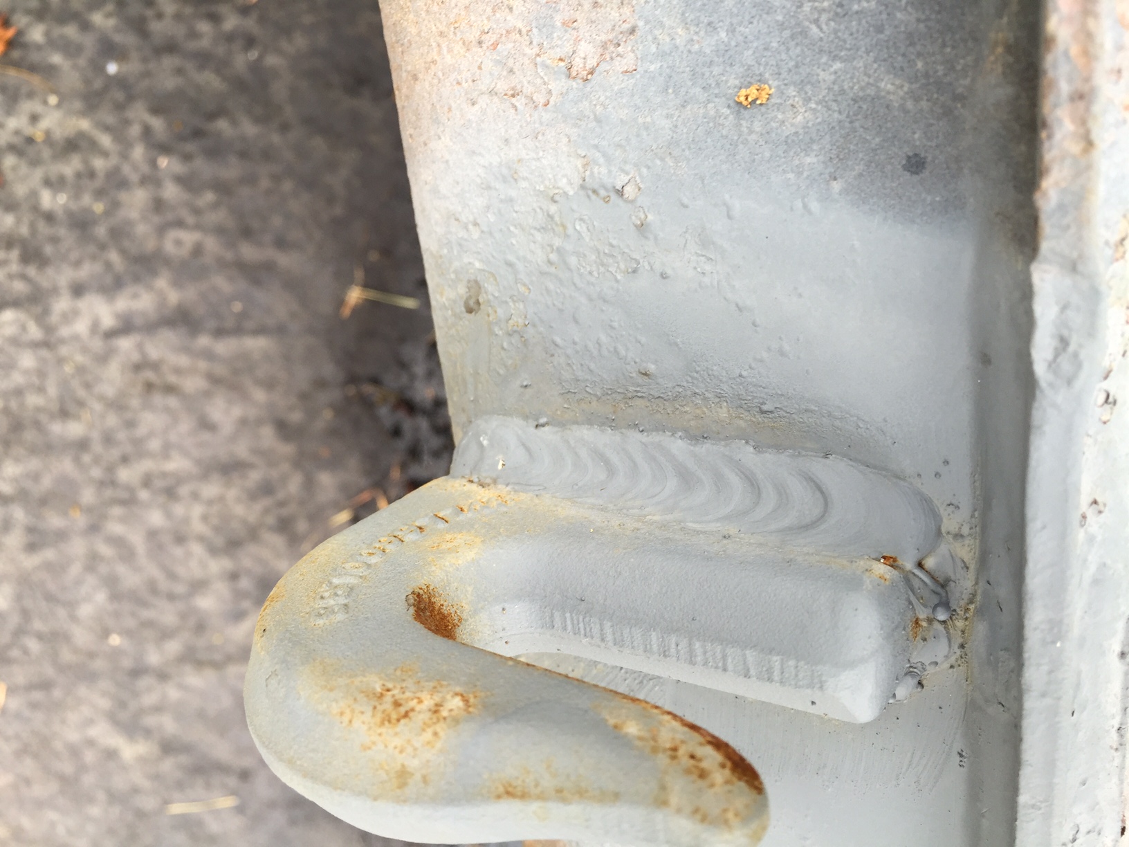

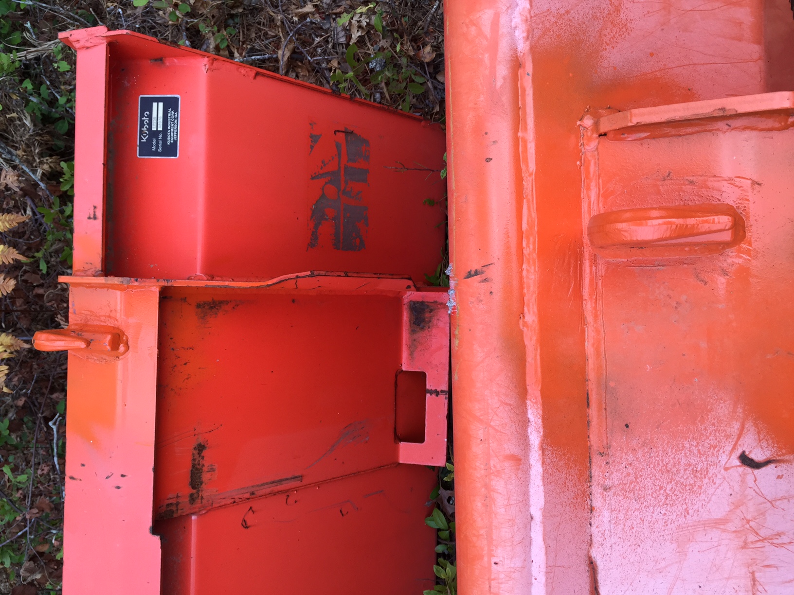

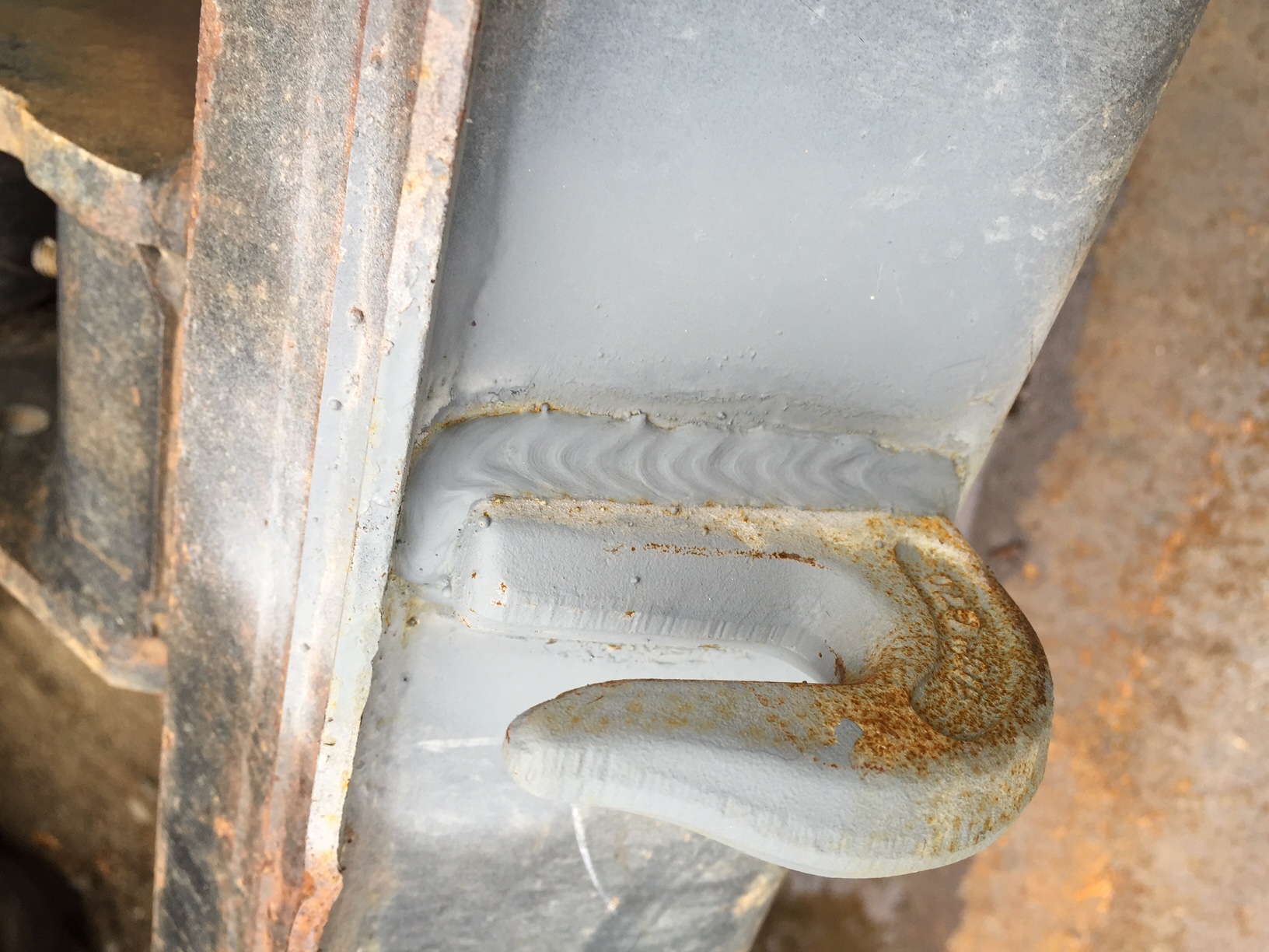

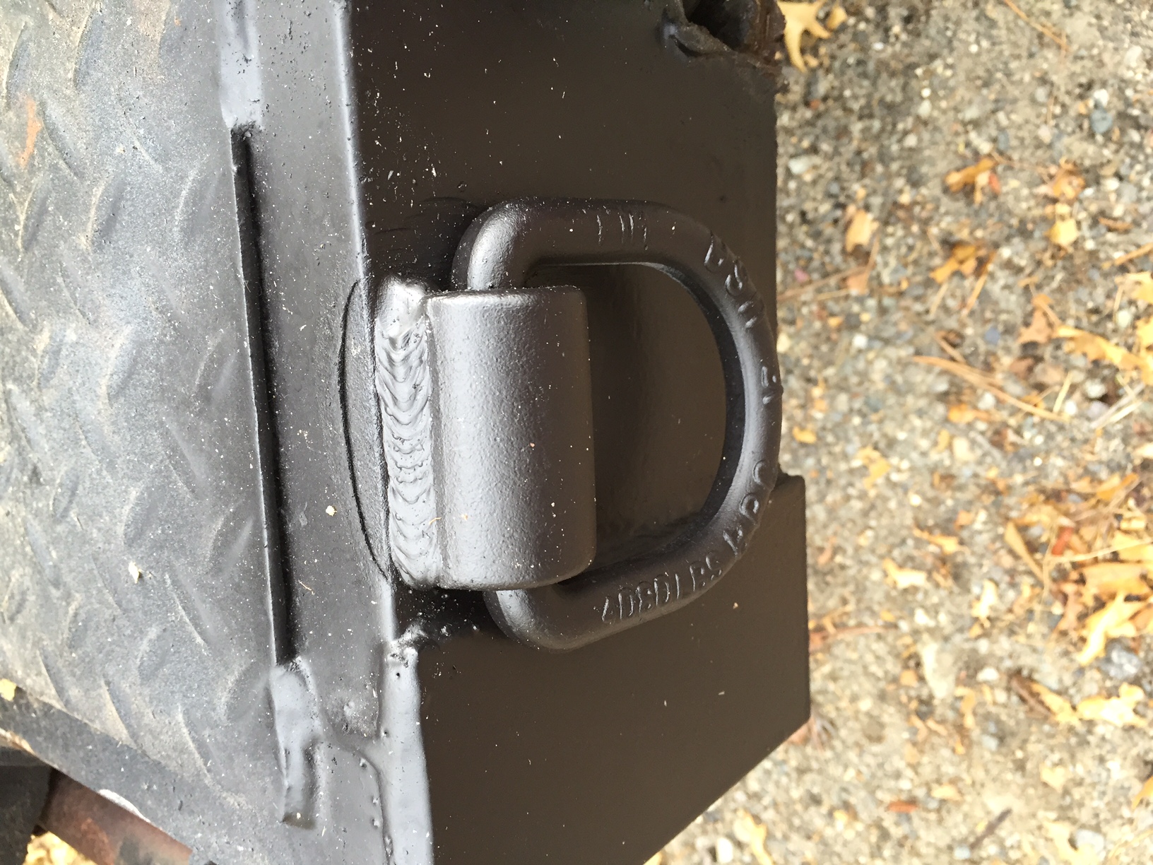

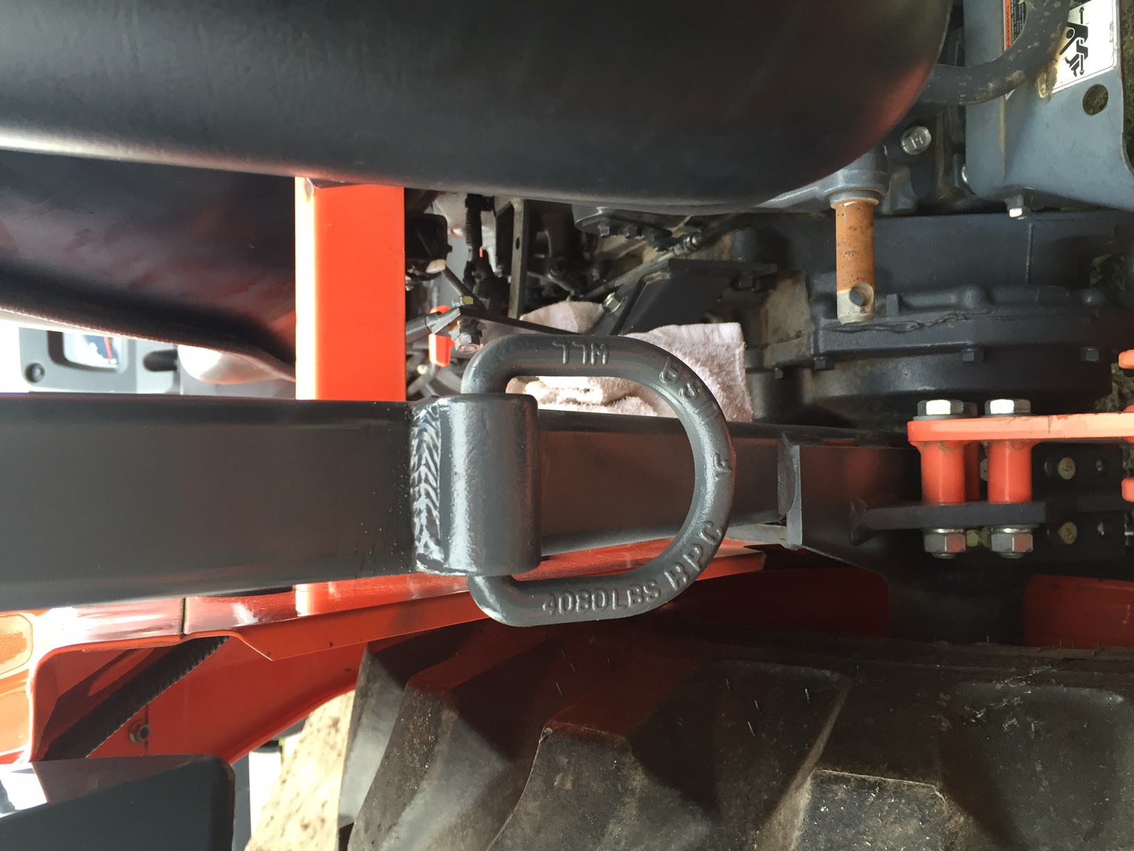

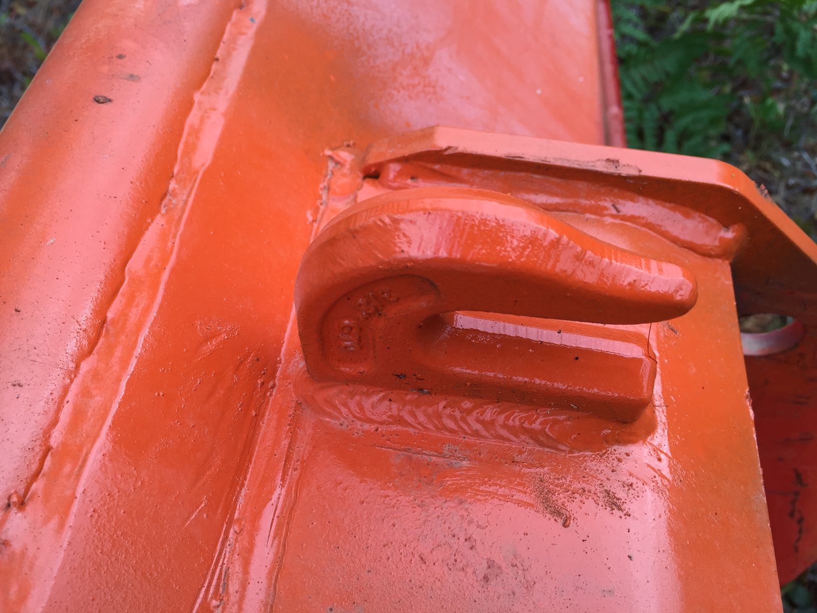

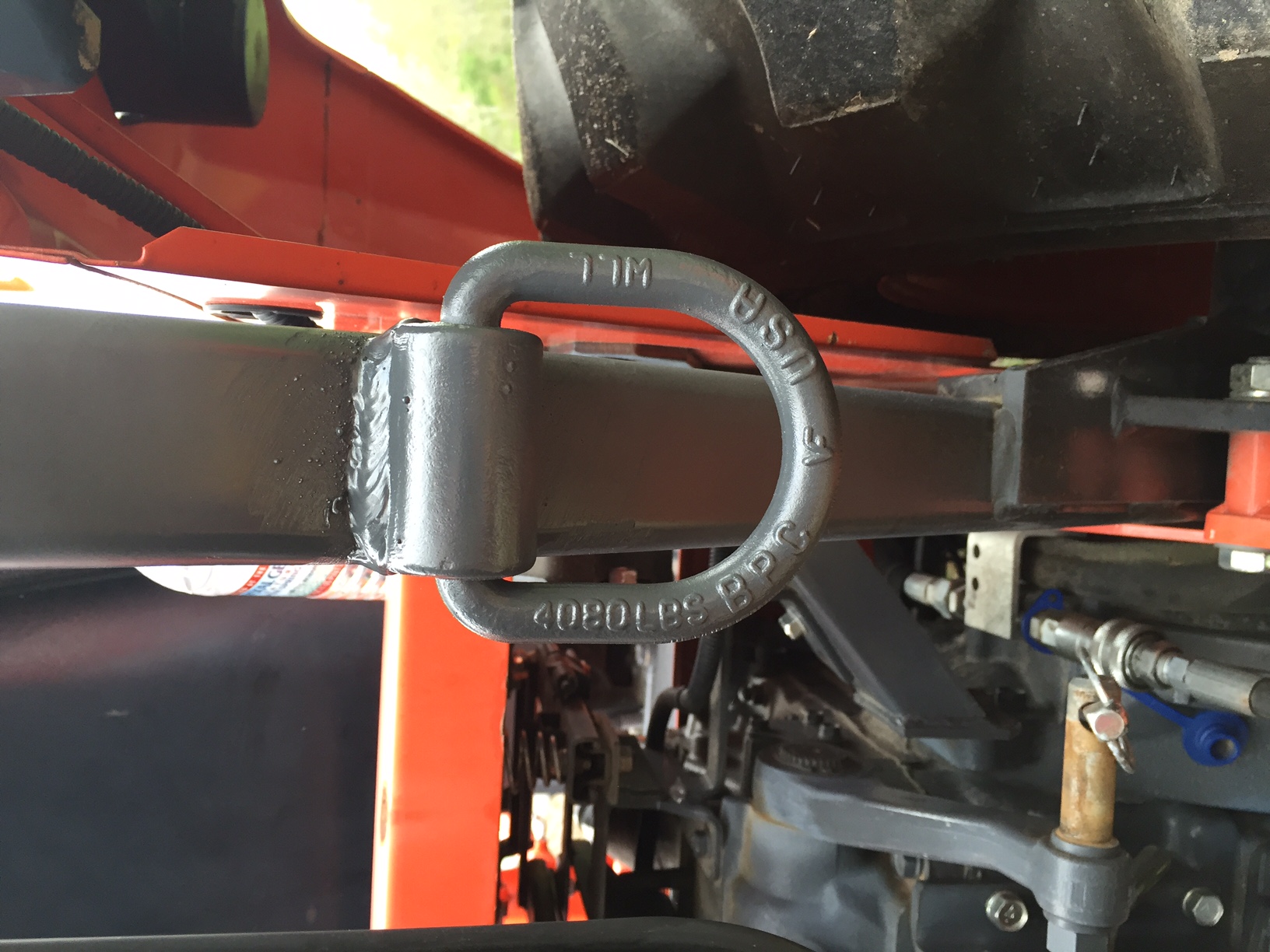

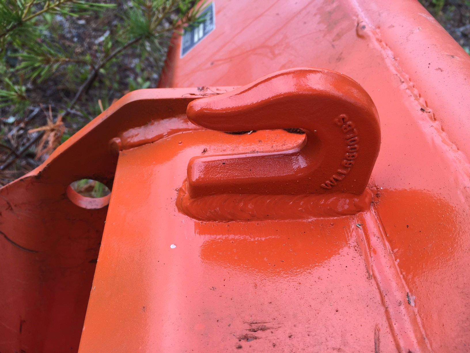

Added hooks to some buckets and D rings to the tractor to make it easier to tie down on the trailer. image.jpegimage.jpegimage.jpegimage.jpegimage.jpegimage.jpegimage.jpegimage.jpegimage.jpegimage.jpegimage.jpegimage.jpegimage.jpegimage.jpegimage.jpegimage.jpegimage.jpegimage.jpeg

Do the d-rings mounted on the tractor rattle much when using the tractor? I have thought about putting some on my equipment but worried about a constant clanking.

I actually gave a good bit of thought to that very issue. The rings on the rear ( on the ROPS ) hang straight down and are mounted where the bar goes at a angle, And no metal to metal = no clanging. The one in the front is not a issue because all I can hear is the engine anyway.

Sweet. It all looks very functional and some nice welds.
