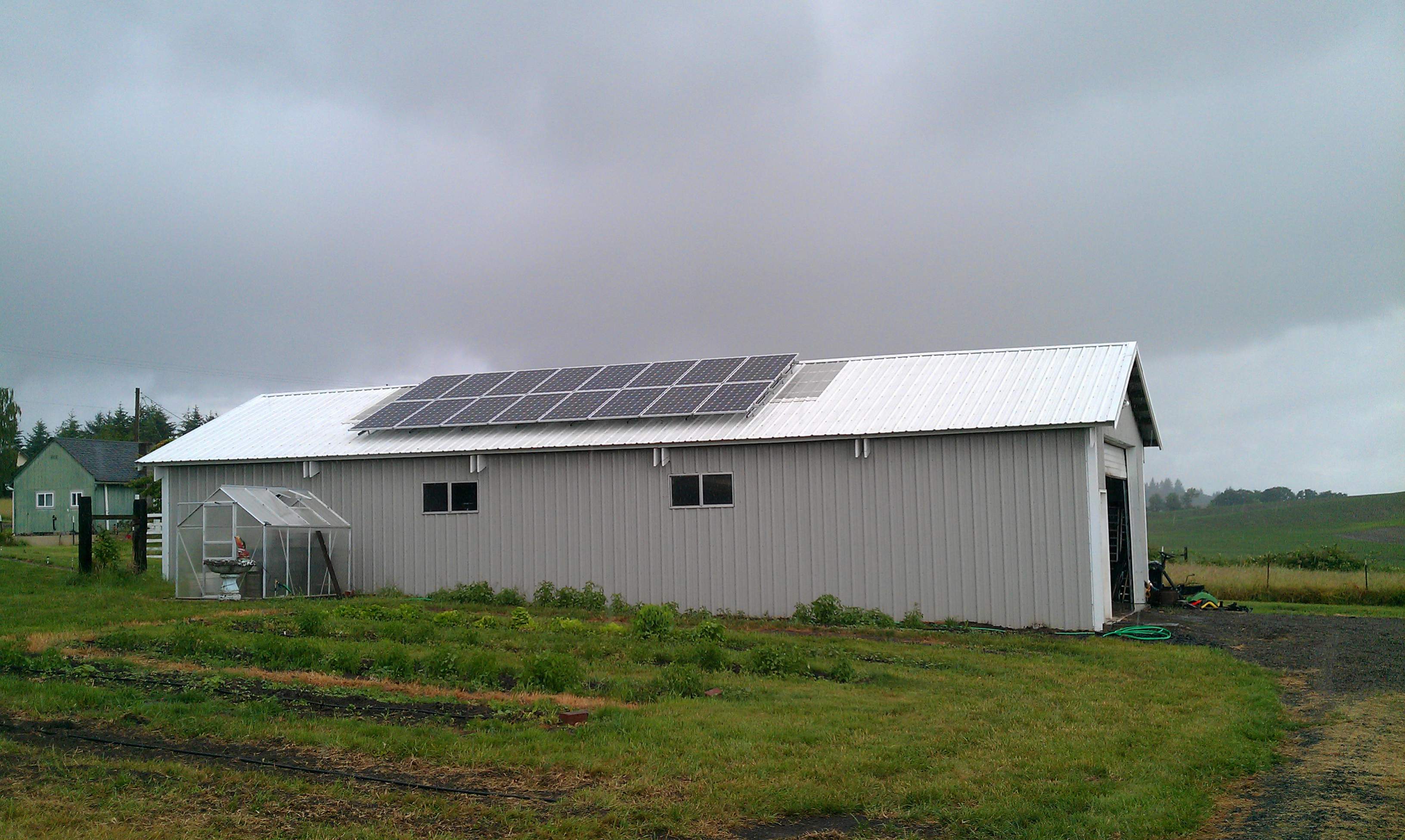

I installed 8 205 watt panels on my barn after learning that my electric supplier wanted almost 6k to bring in a meter from my neighbors transformer as my barn that sits back away from my house 600 feet
The neighbors transformer is only about 50 ft from my barn
they also wanted to charge me commercial rates (.38/kw) because my lot already had a residential meter
I picked up 10)205 watt evergreen panels with an Outback MX80 charge controller going into 32)91 amp/hr 12 volt batteries with a 6000 watt inverter
I run all my light in both barns LED 12 volt and have a 12 volt pump that I empty water troughs when ever it rains into 2 275 gal tanks
when the troughs are low I pump it back from the tanks to the troughs
with only running 12 volt you don't need to run wiring in conduit
the only conduit I had to run was from my inverter to my trough heaters and bucket heaters
also to a couple of outlets that run my hay elevator and my daughters radio
I use 12 volt LED tractor lights for floods outside and in the barns
I use 12 volt LED rope light in all the stalls and it looks like Christmas in the barn when I have everything on
I did this all with no previous experience at a cost of about $5500. 3 years ago and not a single bill from my electric supplier
I looked into the costs of ditching from the house and that was going to cost me about 5k doing everything myself and only yielding maybe 30 amps in the barns
just get on the internet and you'll find plenty of people willing to help
If you want I can give you some pointers and pictures of my set-up
heres the only picture I have here at work today and its actually of my daughters gator
