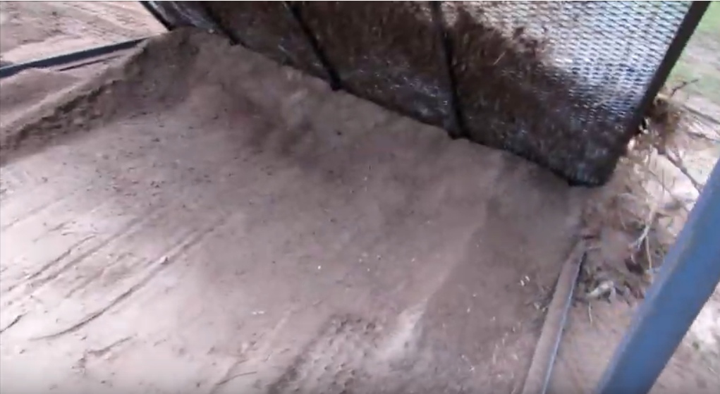

Got it put together. First test looks promising. I welded a couple of cut up chain hooks to the underside to move it with. I carried it real slow but it seemed stable enough during transport to the back of the property.
Only dumped 3 buckets through it before a storm threatened so I high tailed it back to the house. I forgot to pick it up and clear the screen before taking the photo but I can rock it straight up and get most of the debris to fall off. I imagine I will have to pick up the debris side and dump it through again but a good amount of dirt fell on the clean side.

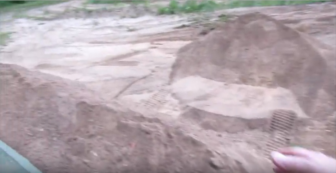

It looks like it screens real well. But how do you get all the screened material out when the screen goes all the way to the ground and have a pile of big stuff at the lower end? You should at least put it up on something so the bucket has room to scoop the good stuff up. You could also push the big stuff 90* and get almost all of it if the containment wall is high enough.
/ Soil Screener
#17
If I put it up any higher I probably couldn't get the bucket over the top to dump. The idea behind the design is to have a long sharp angle surface rather than have to build a vibrating mechanism.
These are not very good pictures since I took screen shots from the end of the video but it shows how much I scooped out from under the screen and the second photo shows where I piled the sifted soil. I have two hooks welded to the underside that I use to pick it up with the loader for transport and I can easily move it when I need to sort the dirty side.
