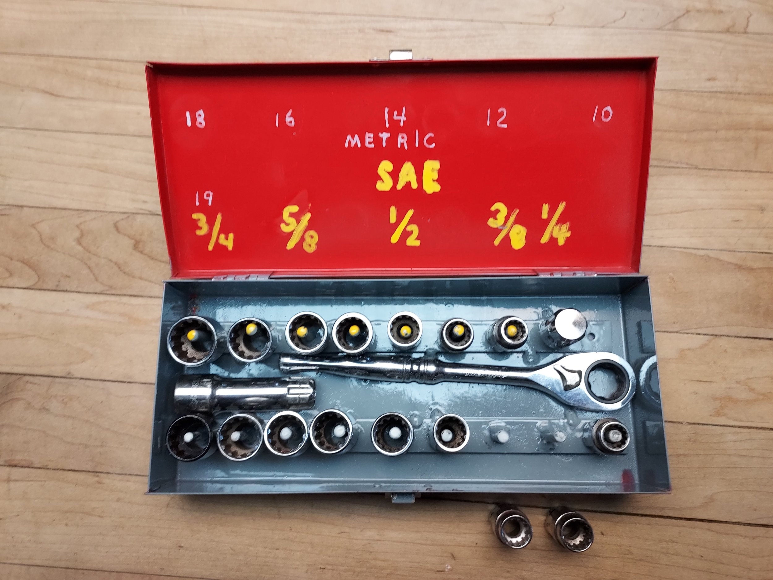

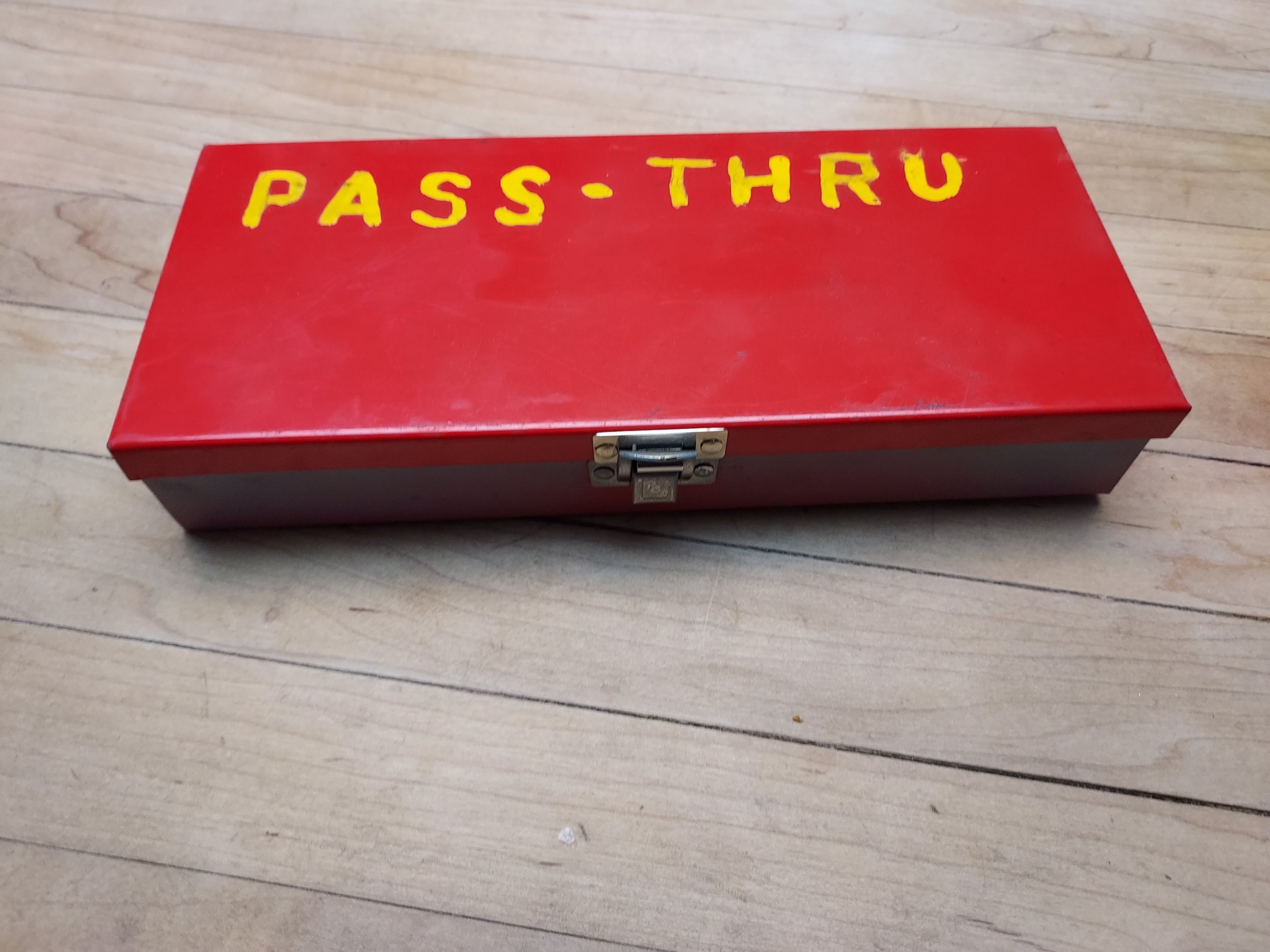

Tekton makes an organizer for 3/8 sockets that holds the sockets with a quarter turn that impressed me. The SAE holds 15 sizes from 1/4” to 1” , one row of standard and 1 row of deep; the metric is similar with 19, 6mm to 24mm. Each holder is about 4” wide x 20” long, fine on the workshop wall, but too large to carry to the worksite. Also a typical job usually requires only a few sizes. When I get a round tuit, I will weld a half-dozen steel pegs to a metal tote tray to carry those sockets I need for a particular job.
My pass-thru ratchet set came with an over-sized, molded plastic display rack with illegibly marked round pegs that did not hold the sockets securely. I bought a 1-1/2” x 4-1/2” x 10-1/2” steel case on Amazon, welded pegs in 2 rows, color coded the pegs and marked the sizes legibly. When the lid of the case is latched, the sockets are secure. Photos below.

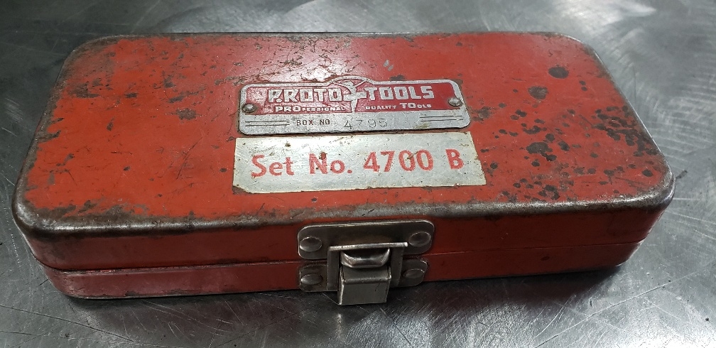

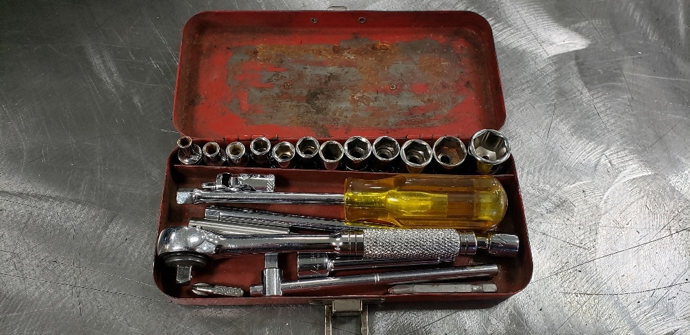

I sure miss the old metal socket sets. They fit anywhere and can hold a few extras.
