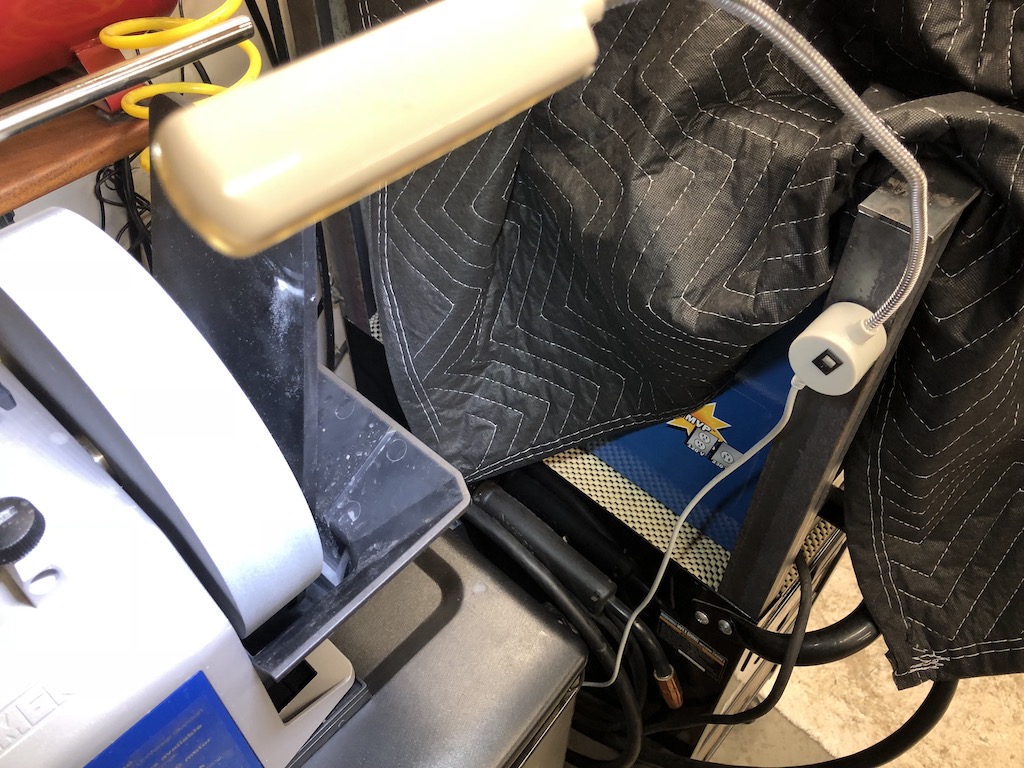

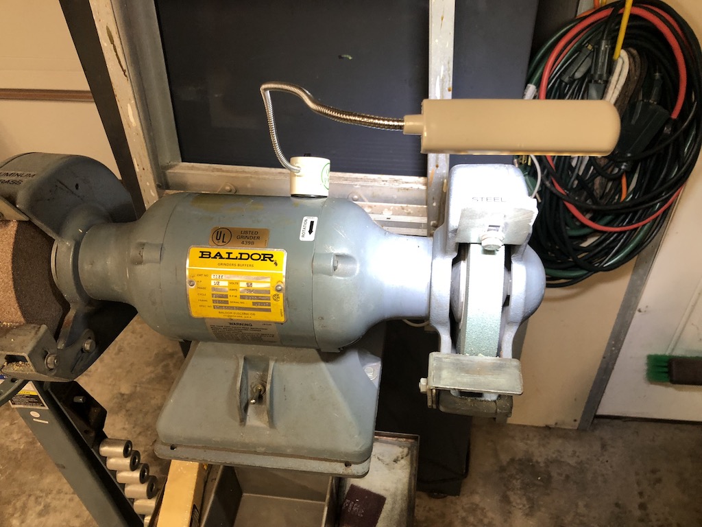

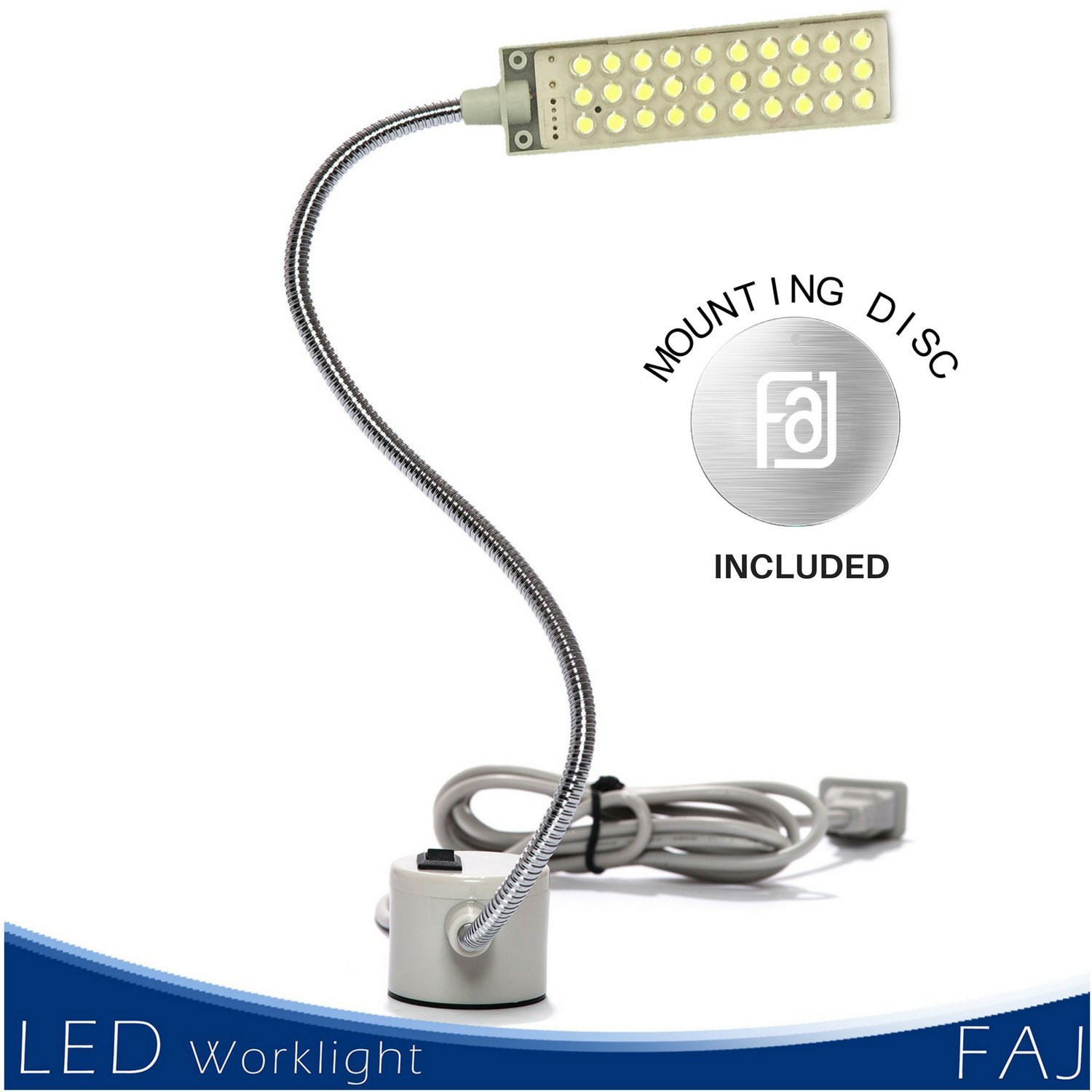

Don't forget you can put in spotlights to illuminate corners, workstations, etc... to augment your standard lighting.
Yep, don't discount spot lighting on specific work areas. I bought a couple of these versatile LED portable lights and they are great to put on tools where you need some precision lighting. Magnetic so you can easily move and position exactly how you want and plenty bright! Here, lighting up my knife sharpener and grinder.
