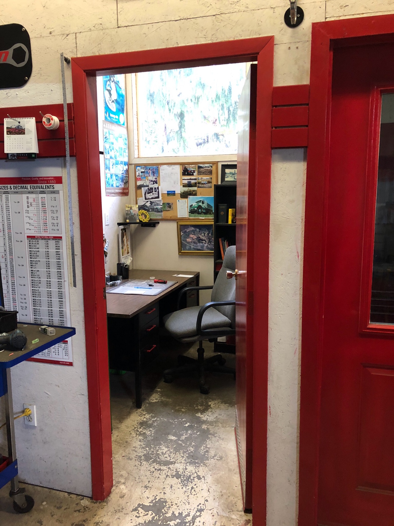

A couple other things come to mind in the shop design and creature comforts department.
B. John
If possible leave room for an office/lounge area. You can always finish it at a later date.
I built mine at one end of the parts room. It's about 400 sq ft.
My smaller 6'x8' office with operator and shop manuals is in the main shop area.
