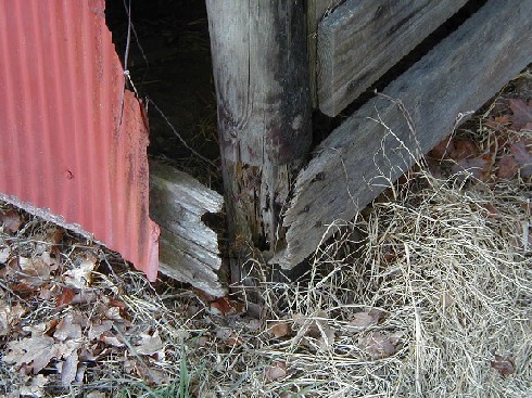

So I went out and checked out the poles and roof supports. With one or two exceptions, the poles seem to be in good shape. The ones in the lean-to are all old telephone poles that look like they were treated with creosote or some other dark brown substance. A couple of posts on the other side of the barn have been replaced in the past, one not too far in the past as it is a 6x6 pressure treated piece with asphalt shingles wrapped around the bottom.
The roof supports are another story. While most of them are sound, there are probably a dozen or so that have obvious insect damage, some of it severe. What's really interesting to me is that most of the scrap lumber sitting on or near the ground is untouched by bugs. The good news though is that I could probably salvage a lot of the scrap lumber to repair the bug eaten pieces. Is there some kind of paint that I could spray or brush over the exposed wood to protect it from insects in the future?

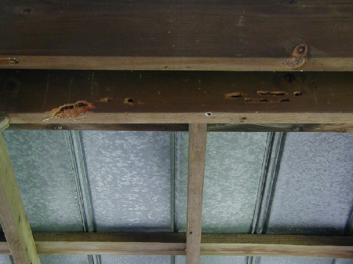

While old churches may have bats in their belfries, I have bugs in my rafters...

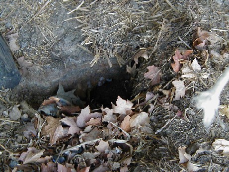

Some sizeable critter has dug a home for itself...

Looks like with a bit of work you could have a nice barn. The insect damage, you should call a local treatment company, barns have more options than houses for insecticides.
The outside corner looks like rot to me, common for untreated lumber near the ground.

Looks like bugs in the rafters that then got eaten by woodpeckers...
