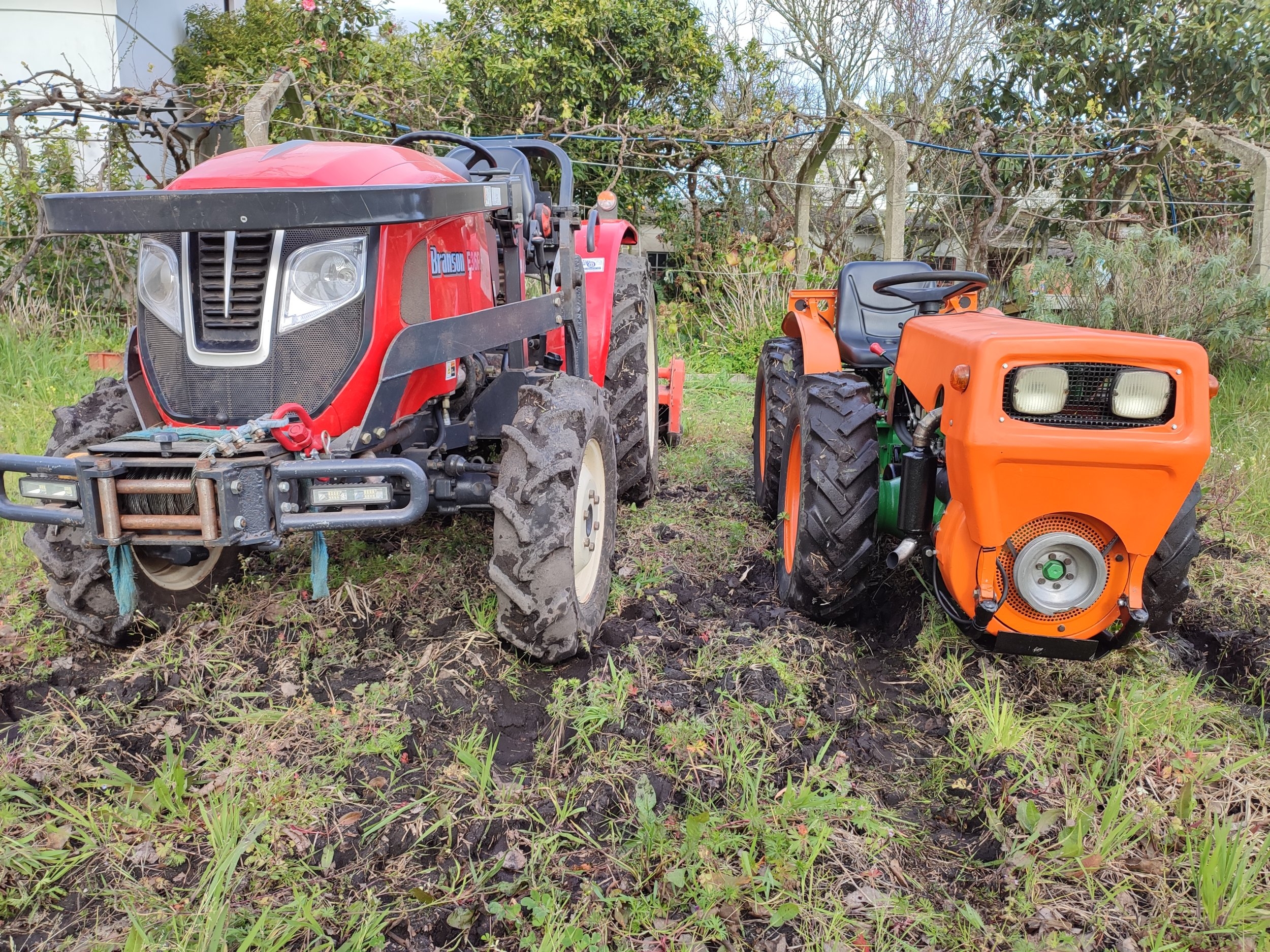

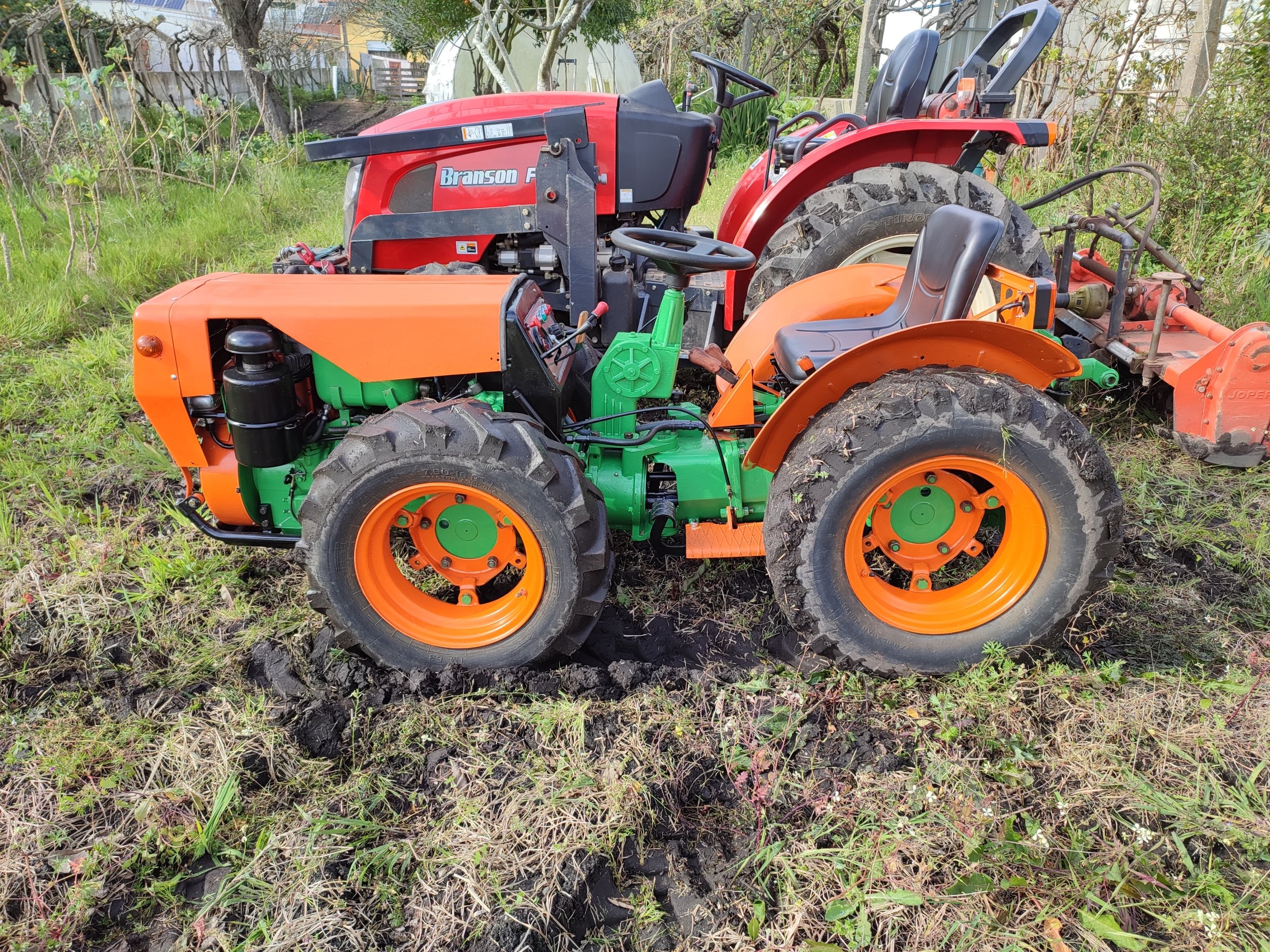

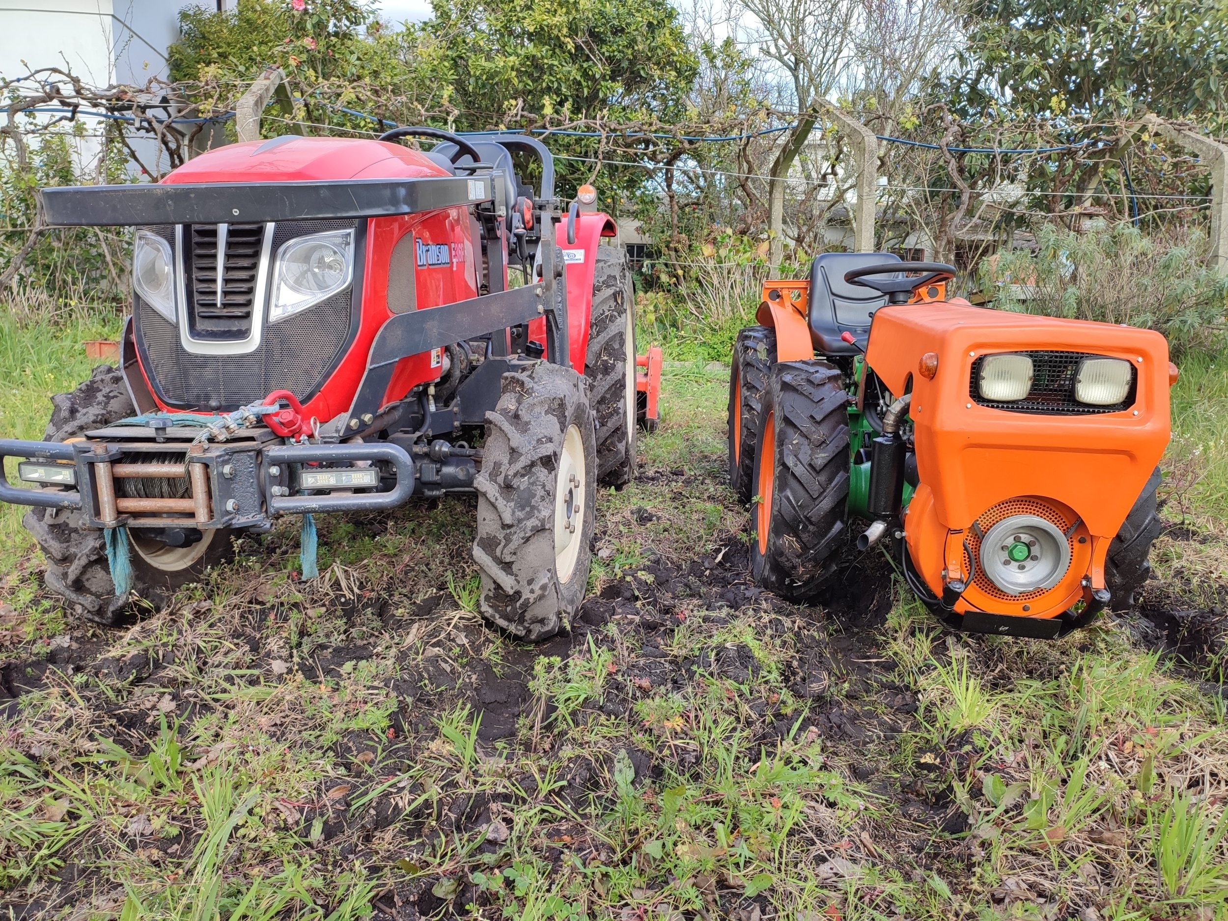

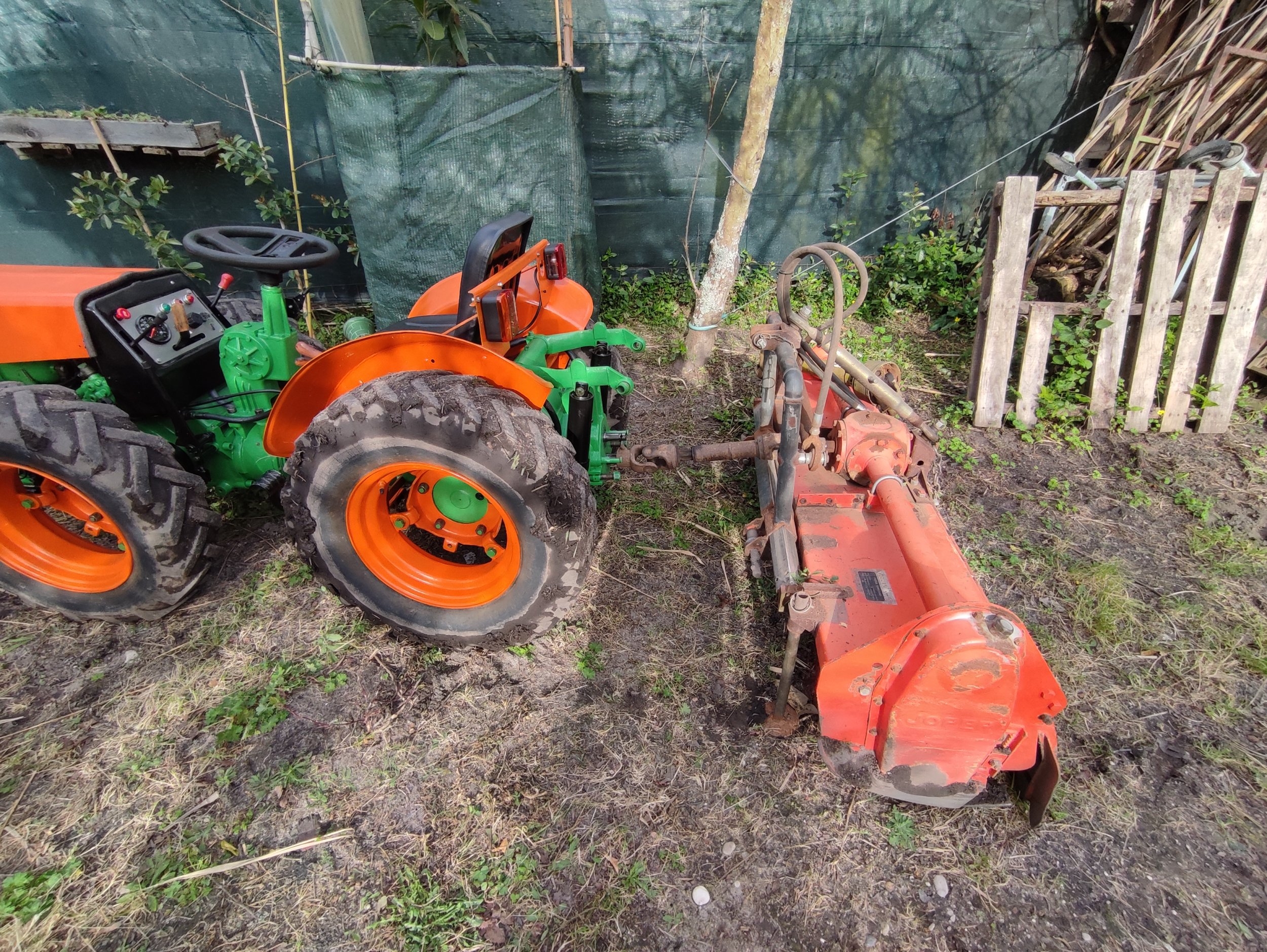

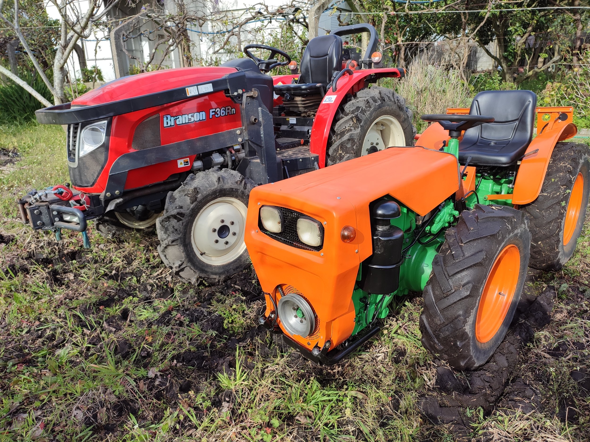

Got some side by side pictures of the Branson and the Agria.

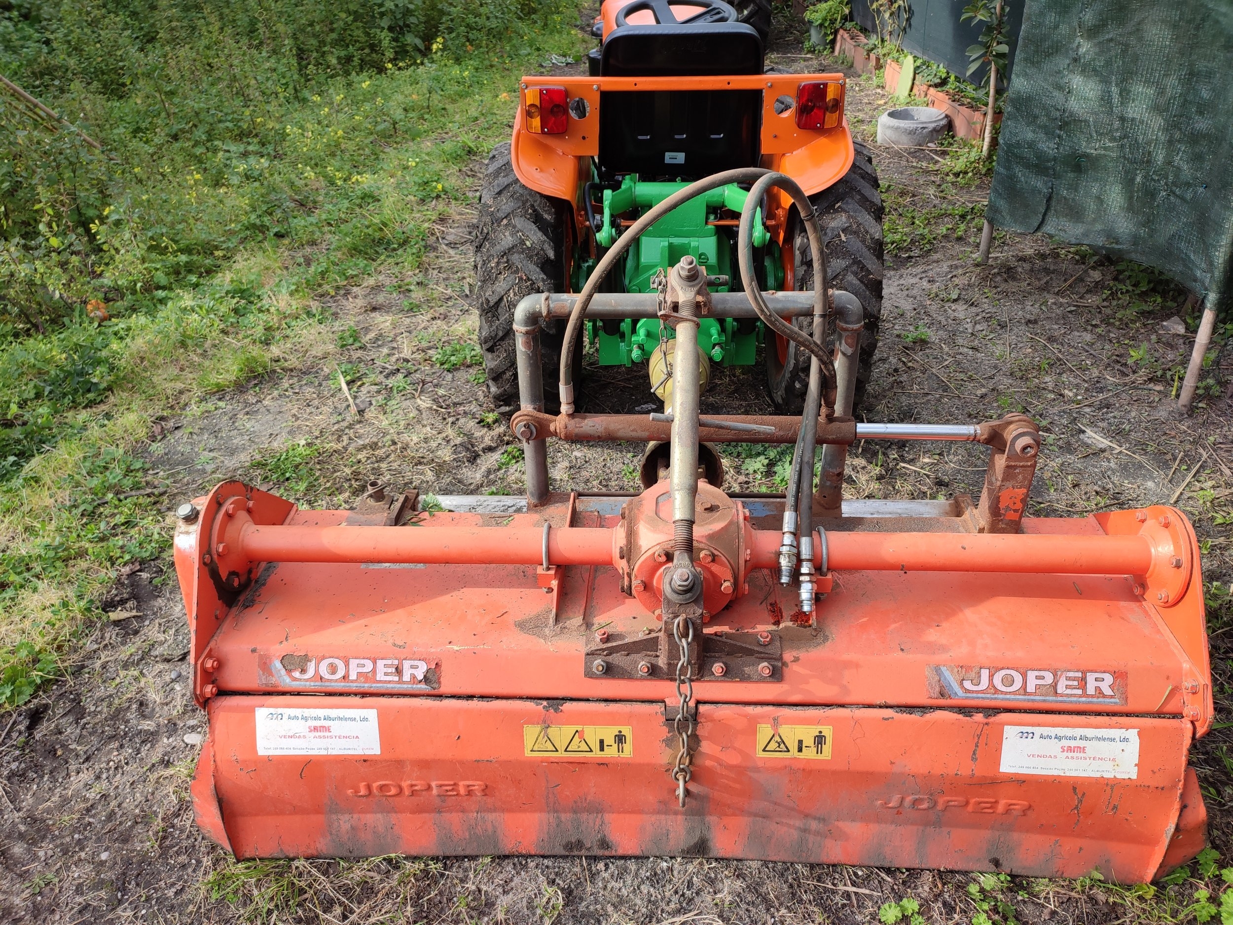

Also did a somewhat of a test fit on the tiller. It's way too wide for it but I think it can do it on this sandy soil. At least when it's dry.
This was mostly to take some measurements for the 3 pt linkage. I remember I had a shorter PTO shaft that came with one of the crawler tractors so I don't have to make the arms way too long nor I have to cut the one from the Branson.

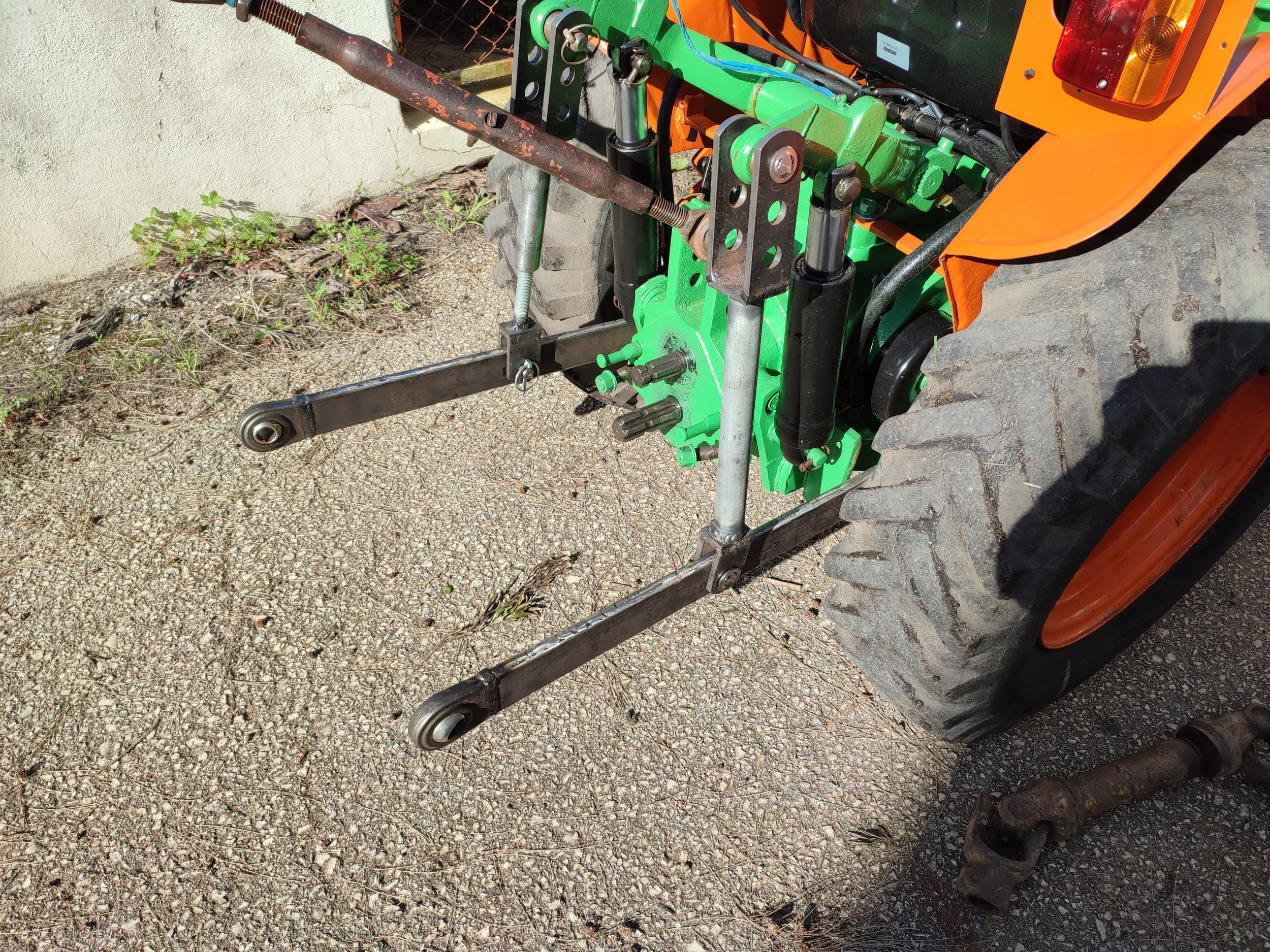

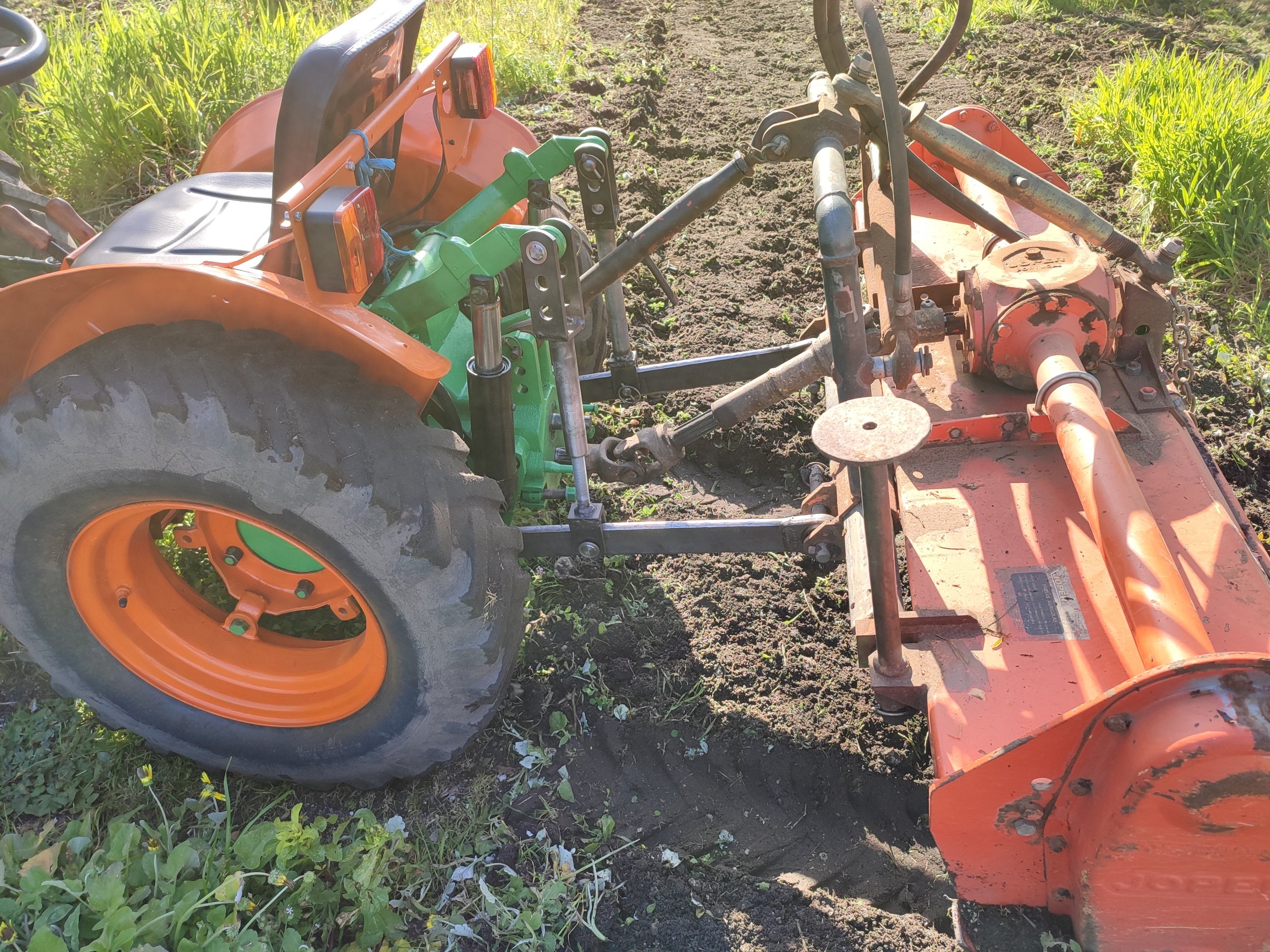

Got the 3 pt linkage done and also made a set of 5 mm shims that will work as stabilizers. I did run my big tiller without the shims and didn't feel the need for any of the shims, but I'll add it anyway to reduce some of the side to side play.
For the big tiller experience. I was really surprise how easily it handled this bigger tiller. Even though the ground is kinda sandy, it was very wet and compacted from not being tilled for a long time. It did gave the engine a workout looking how much paint got burned off the muffler.
It is quite loud so I'll definitely use some ear protection next time I till with it.
Between the belt slipping and the relief valve opening, this tiller its all it wants to lift. It's only 520 lbs but sticks way out as you can see. I'll probably drill another hole on the lower links for the side links to hook on so it gets a little bit more leverage.
Turning this thing while tilling is quite a chore!! Being articulated, it pushes the attachment in the back side ways, with the tiller buried in the ground, that's a big job on the steering. For sure. I think with the tiller it came with it, it will do a lot better.
Still a lot to learn about it. Specially steering. I keep missing all my tight turns since it's so different from a conventional tractor. I'll get it eventually. 🤣

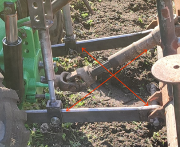

Is there any room that perhaps you could make a cross-linkage going diagonal from the end of each 3pt arm to near the beginning of the other?
What you're looking for is triangulation, any could help, though you'd need to be careful if lowering an implement that it doesn't hit the PTO shaft.
   / So I did a thing... Agria 8900D #160
Good idea that's what I suggested in post 131
