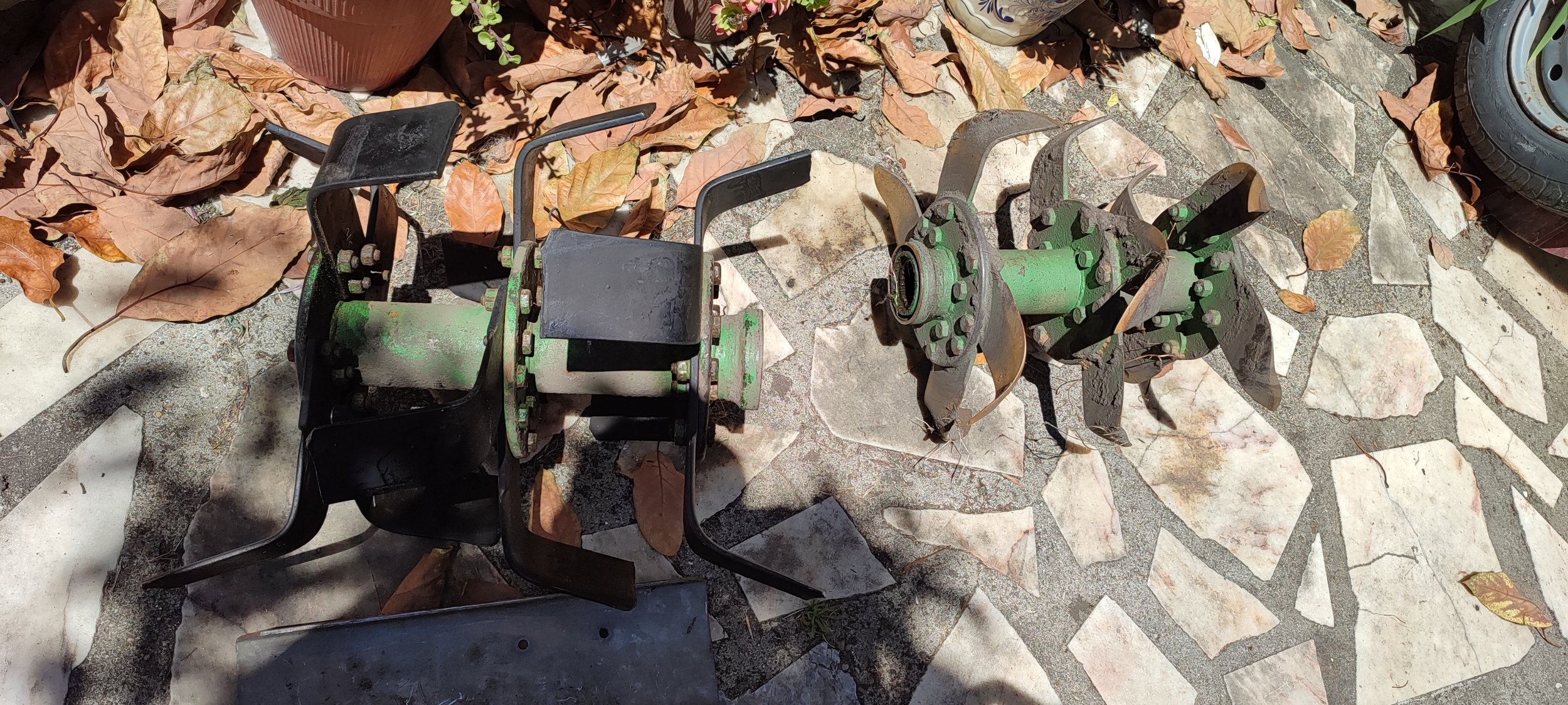

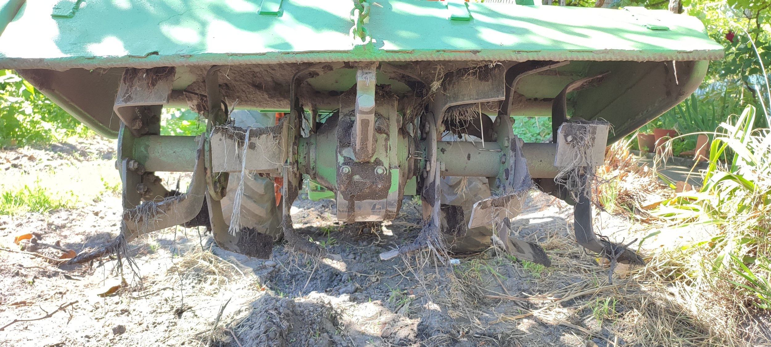

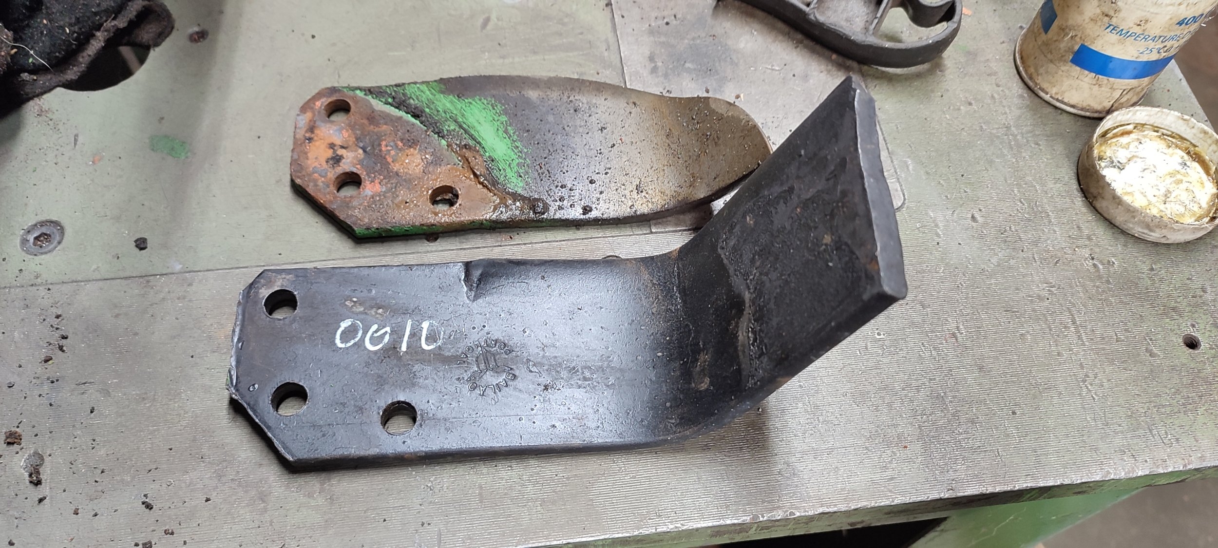

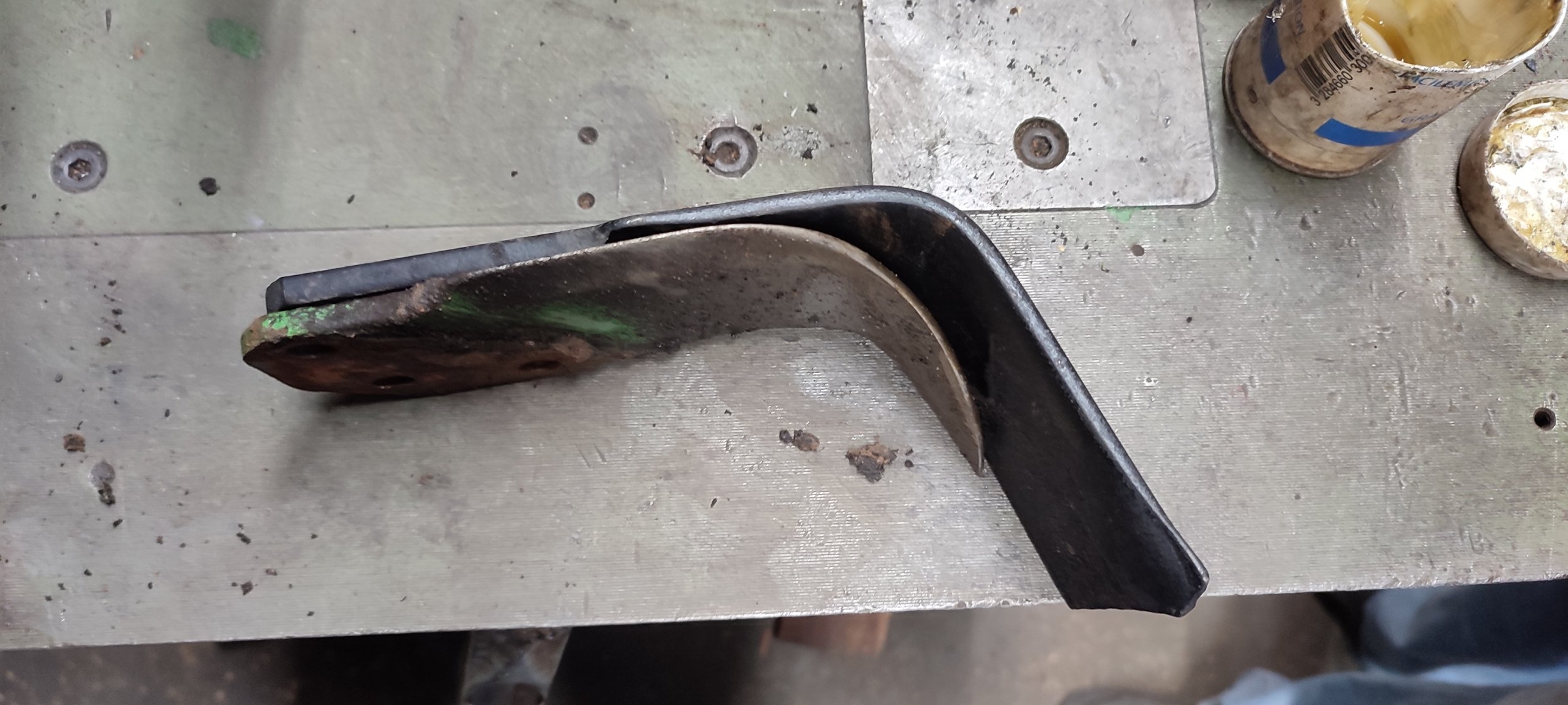

Got my new tines this week. As you can see from the pictures, the old ones were just barely broken in. 🙂 They were also the wrong length at 170 mm vs 205 mm for the correct ones.
These new tines kinda arose another issue, which is the missing skate under the gearbox. I'll need to build one now because it just goes too deep and causes the entire tractor to bounce constantly.
Regardless of this minor issue, it now tills super nice. I'm much happier with it now.

I don't know why you were so eager to replace those tines. I'm sure they had at least 5 minutes of use left. No sense in being wasteful, we gotta use everything to the utmost.
