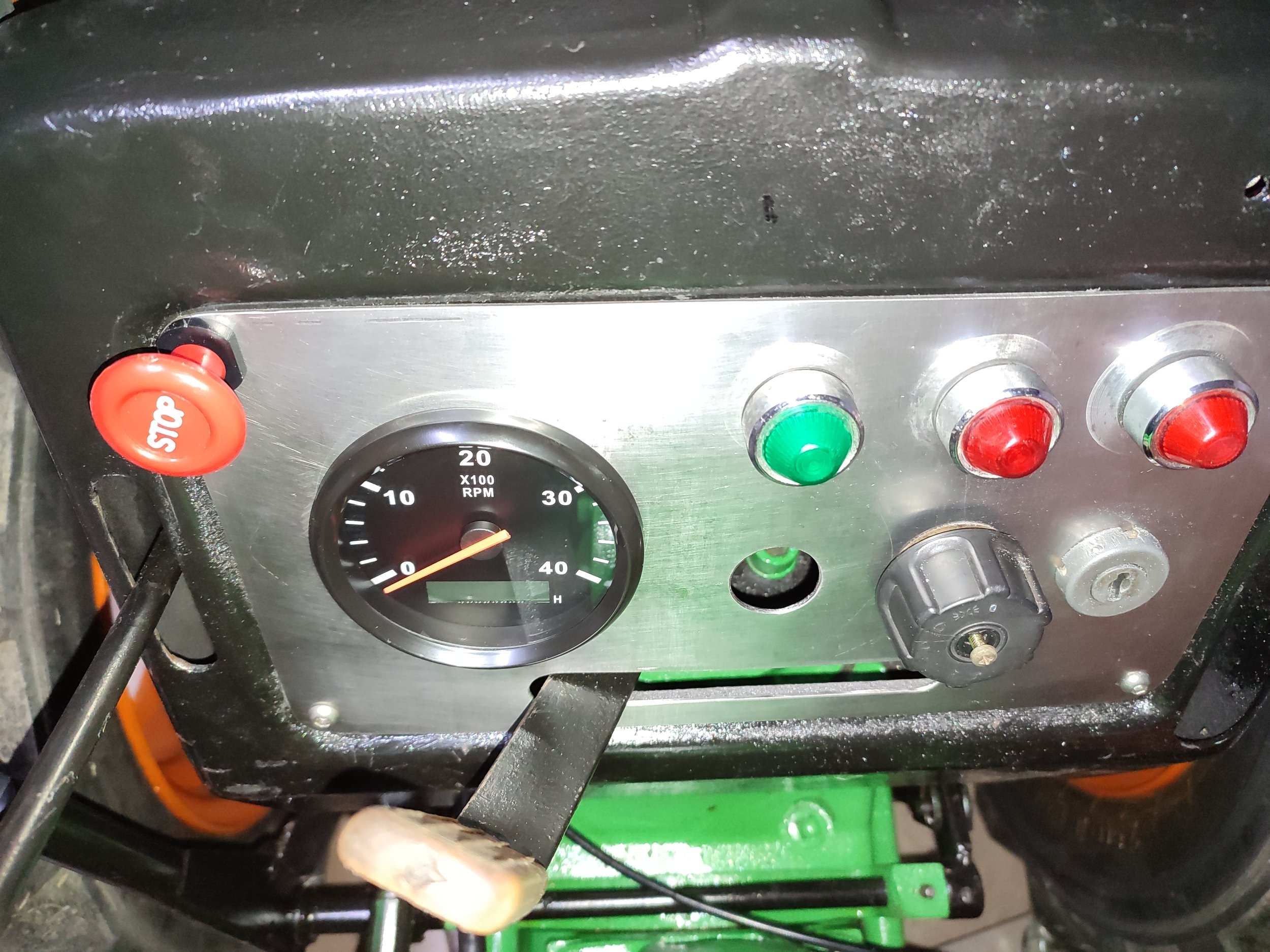

It bothers me a little bit, just not enough to change it.
The angle of that picture makes it look worse than it is. Looking from the seal, the handle only blocks a little bit at the bottom. I can still see the RPM easily.
Maybe turn the locker handle upside down?

Appreciate all the suggestions. I can't turn the lever down because the way it's built.
I did bent the handle down a little bit and it did help some more. I'll still keep it that way and it's not really an issue. All in all, the only lights I need to see are the oil pressure light and the charge light.
Speaking of charge light, is it required to have a diode between the ignition and the charge light? The reason I'm asking is because without the diode, the light will keep lit although, very very dim. If I rev up, it will become brighter. Checking with the multimeter, the alternator is charging very well.
The only way to make the light go out entirely is with the diode.
   / So I did a thing... Agria 8900D #146
When you put the diode in the circuit, does the light come on when the tractor is off and key on? If so, this is what you want. If it's not able to tell you when it's stopped charging, then I would look at a way to make that happen. What does the factory wiring show?
#147
Yes, the light turns On with the ignition On and will turn off once the engine is running and it's charging. With the diode it works as it should.
Checking some online diagrams, none refer to the diode, that's what made me wondering.
The factory wiring got mostly melted at one point and there was a some extra wires because this tractor came with the alternator mounted behind the flywheel and an external regulator. Then someone jerry rigged the alternator mounted on the fan shroud.
No wiring diagram anywhere to be found, so I'm doing everything from scratch.
   / So I did a thing... Agria 8900D #148
I do not see a problem with using a diode. Should work just fine.
   / So I did a thing... Agria 8900D #149
I'll second the diode being added to function correctly.
#150
And she is pretty much done. Just missing the 3 pt linkage. That will be the next step or maybe I'll tackle the tiller first. I want to try the tiller as is first.
The diode did the trick and it's working exactly as it should. Even as I shut down the engine, the charge light will turn on as the RPMs start dropping.
I did change the seat mounting. Added an hinge at the front so I can flip the seat up. I should've done that from the get go as it gives me so much more access. This also raised the seat slightly and now I can see the dashboard perfectly fine. The locker lever will only cover the "0" on the tachometer.
The electric part is all done. Front lights, rear marker lights, brake lights and left/right indicators front and back. Not technically necessary as this tractor doesn't have license plate and title, so it can't really drive legally on the roads but the lights do give a more completed look to the tractor.
Adjusted the fuel delivery plate to give more fuel as it was doing this kind of breaking up/missing at 2500+ RPM. The adjustment does seem to have fixed that.
