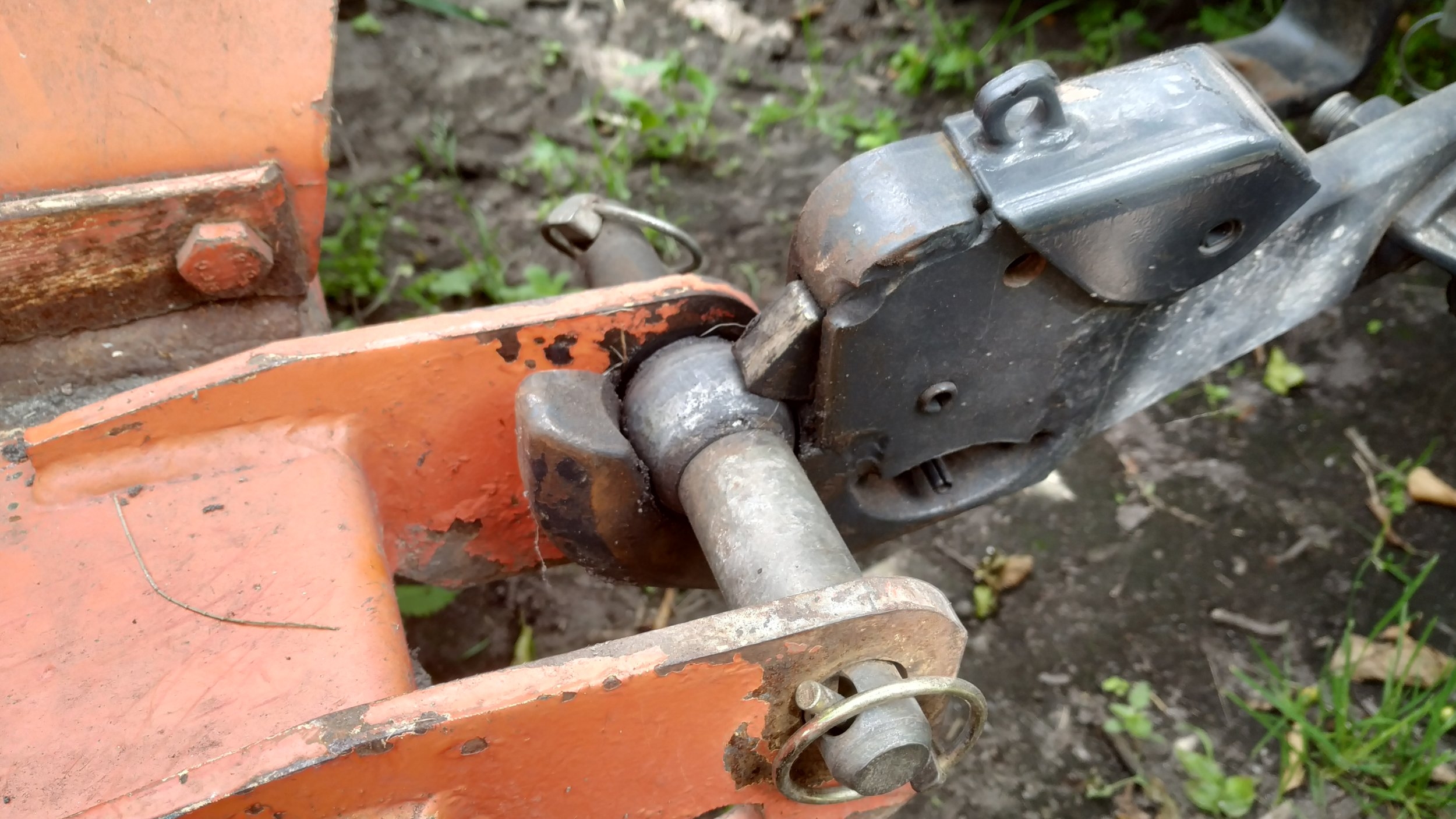

Another thought is making an adjustable chain or cable X assembly between the two lower 3pt arms maybe adjustable with turnbuckles to prevent racking of the arms similar to how it is done with a gate or lightweight construction like in the pic. This could be a minimal space solution
Edit: I suppose "racking" isn't the correct term here as the pivot points are fixed but I'm sure you get my meaning

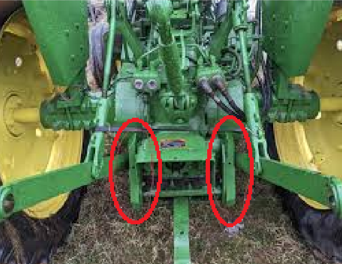

The vertical plate is your stabilizer. You could make additional lower arms with offsets to make the spacing narrower or wider.
This is how it is done on a John Deere 2640. You can invert the blocks to change the spacing.

You could also put a large bolt and locknut through the lower 3pt arms that rides on the edge of that vertical plate and could be adjusted for over width attachments
I was aware that some JD models had that. Mine are fixed though, no way to adjust, but you did game me an idea of either add shims on the inside of the arms or machine a wedge that slides back and forth to adjust for different spacing.

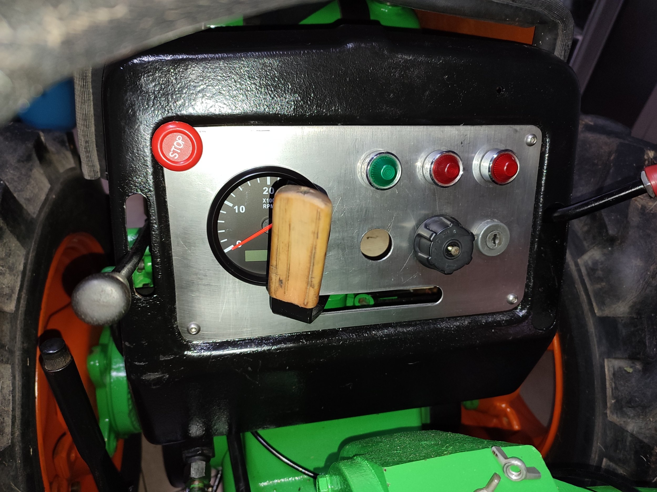

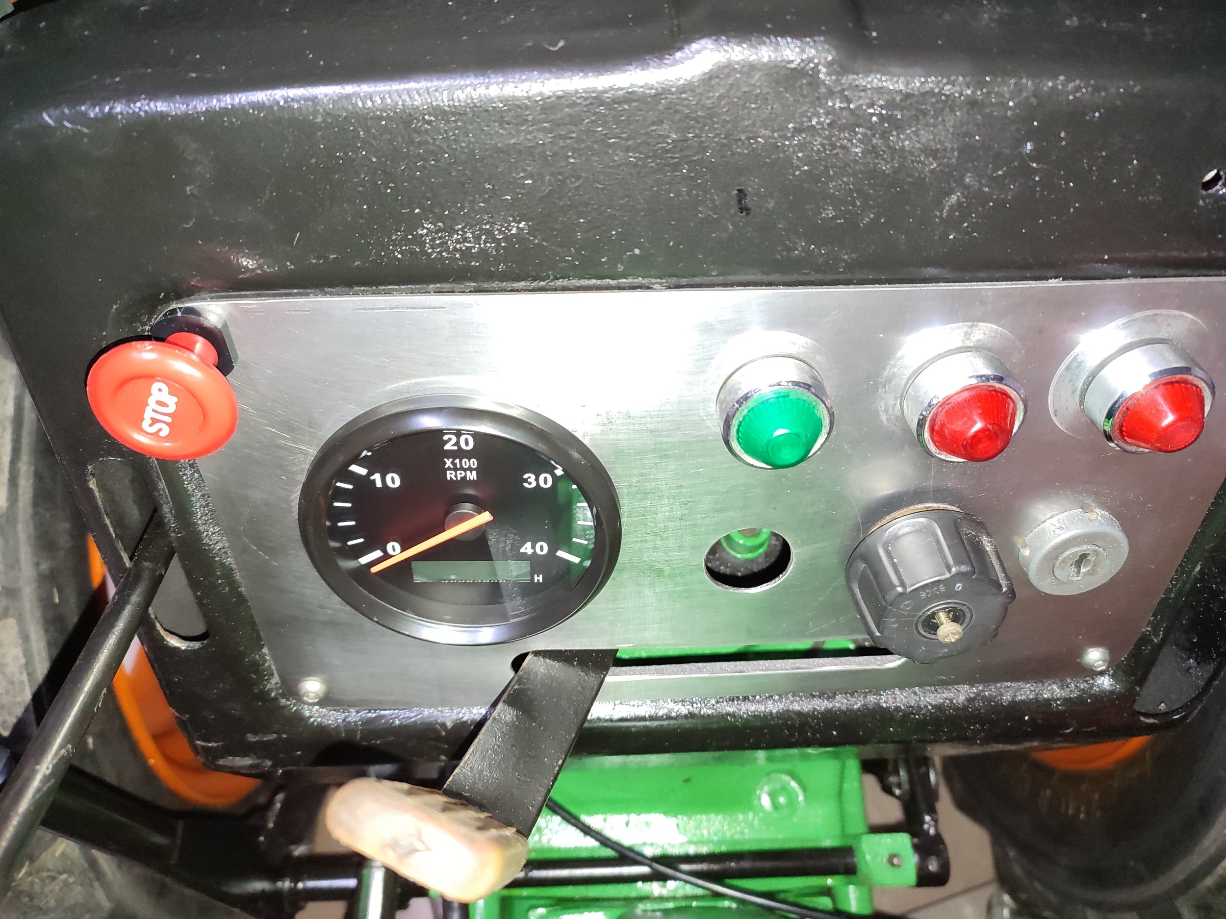

Preliminary stages of the dashboard, although, not much will change. Just missing the indicator switch in the middle. Need to machine a new lever for that as the plastic one was too brittle and broke.
Just ignore the fact that some idiot slapped the tachometer/hour meter behind the front locker lever. The very same idiot, in order to avoid breaking the key for the ignition, stored it so well that now can't find it anywhere. 🤦‍♂️

I can't believe that won't bug you enough to relocate the tach, lol.
   / So I did a thing... Agria 8900D
#140
It bothers me a little bit, just not enough to change it.
The angle of that picture makes it look worse than it is. Looking from the seal, the handle only blocks a little bit at the bottom. I can still see the RPM easily.
