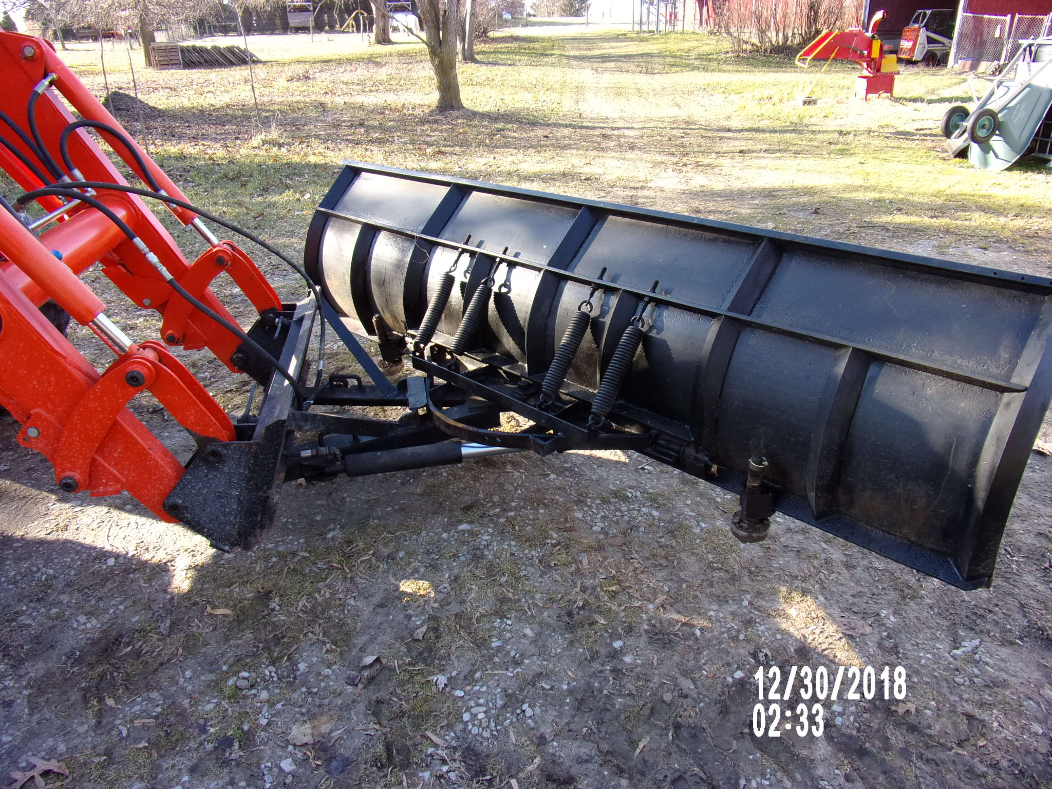

Just discovered that the configuration of my short driveway is difficult to plow with the FEL on my little Ford 1210. Just bought the blade and frame of a plow that came off a Ferg TO30. The frame can be modified easy enough to fit the tractor, but the hydraulics are simpler than anything I have previously encountered. I have never had a piston that wasn't two-way, and I need to know what to buy for a hydraulic valve. I am thinking single-acting, one spool, open center, ~20 gpm, no detent. I assume plumbing is just one line from manifold, one line return to manifold, and one line to cylinder--pressure out, gravity back. Web search shows these from $50 to $770, and are often called a directional control valve. What is the significance of 'directional control' ? So....what should I buy?

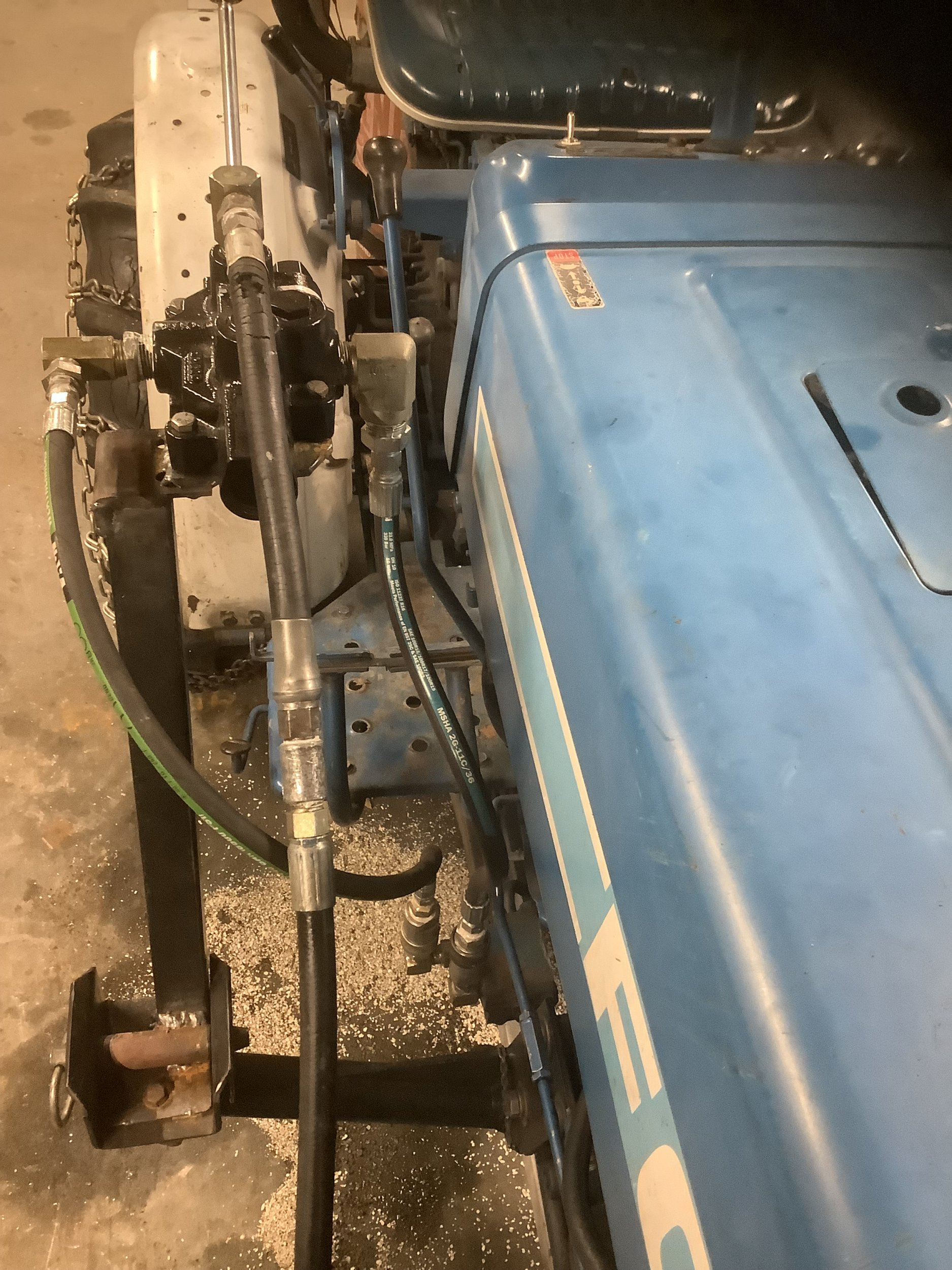

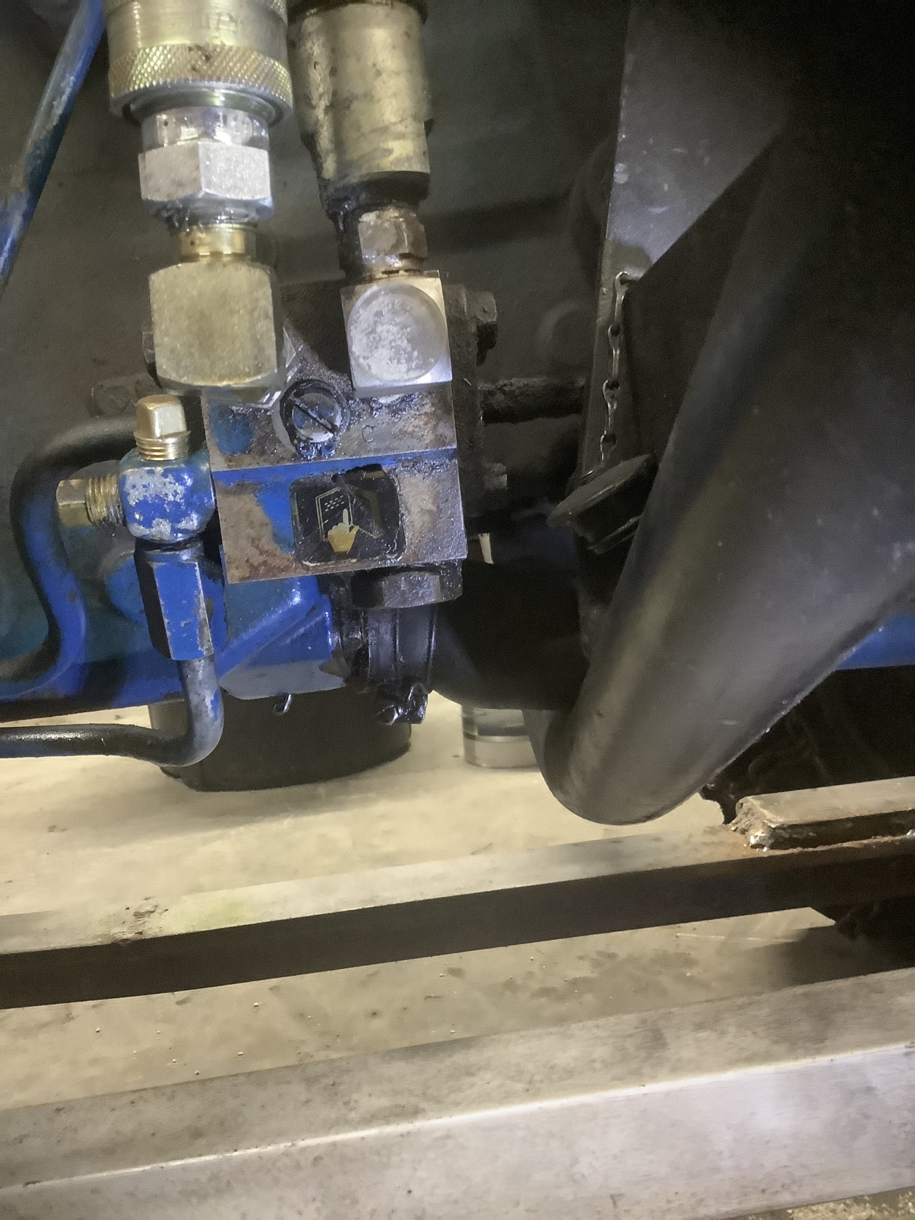

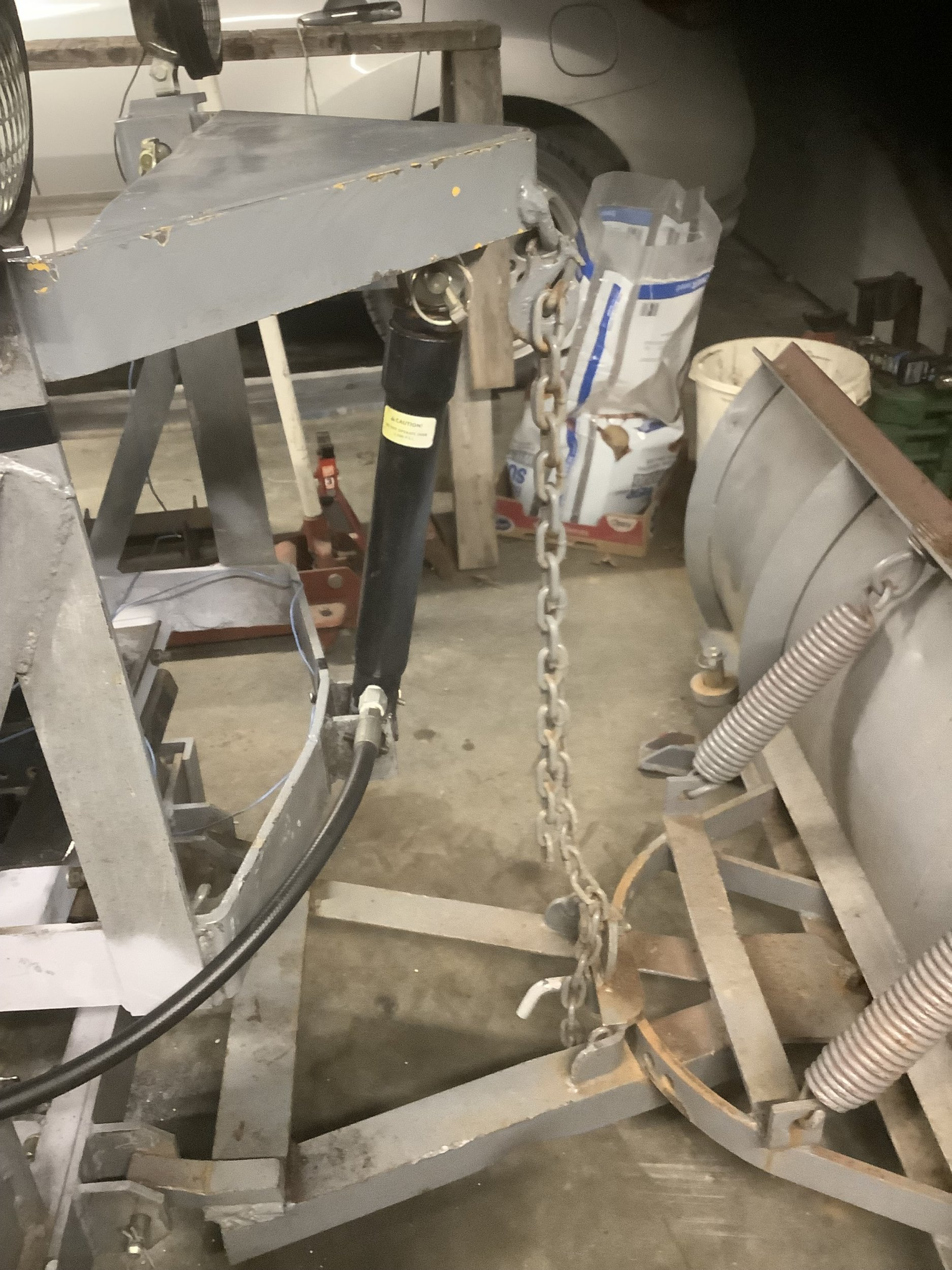

Update.2 Here are pics of valve and plumbing. The connector shown in #2 was previously a quick coupler, but it wasn't defective. As shown everything works, but cylinder still collapses slower than it should. Shut off engine, and it collapses quickly.

You've made this far more complicated than it needs to be. Get rid of the new valve. Simply swap the single acting cylinder for a double acting one.

I'm not sure how you have plumbed your valve, but I suspect that you have plumbed it as a power beyond.
This valve does not have that capability.
"Brand new PRINCE. RD2500 series. Hydraulic control valve for operating single acting cylinders. Monoblock high tensile strength gray cast iron body. Hard chrome plated spools. Open center with conversion plug for closed center applications. Load checks."
This valve can be used in an open center system, or a conversion plug added for a closed center system.
On your system which is open center the pressure feed needs to enter the valve at the Pressure port, then the return or T port must have unrestricted flow back to the tractors tank or reservoir the work port will go to your cylinder.
In normal operation all hydraulic flow will just pass through the valve from the pump to the tank with no restriction.
When the handle is operated to work the cylinder the valve piston is closing the flow through the valve and redirecting it to your cylinder.
When the handle is returned to neutral the flow is again directed to the tank and the fluid is locked to the cylinder. When the handle is operated to allow the cylinder to retract that flow is added to the flow that is passing through the valve from your pump.
The reason it will drop faster when the engine off is that you have no flow from the pump going through that small return line.
