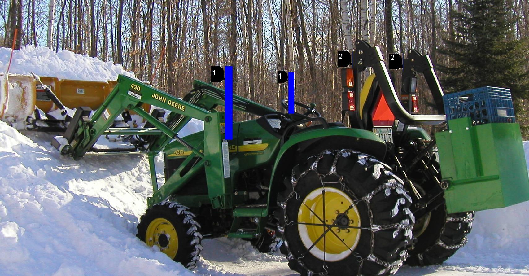

When I'm driving in the dark, the headlight beam is blocked by the snowplow when it's raised.
Has anyone installed lights to compensate for this? Either higher or lower?

Lots of people put lights on the rollbar. I put on two, that swivel on their brackets. I have one facing forward to light beyond the loader bucket, and the other is facing backwards. That combination works great for me, for moving snow around at night.

you might be able to put a pair of pieces of angle iron on your loader arms (the vertical part) and mount lights to them, then they would stick up 1-2' above your plow in most cases, and wouldn't blind you when you look back like the ROPS mounted ones tend to do.
Attached is a crude (5 minutes in paint) version of what I am talking about. The blue bars are 1" or so angle iron, and the black things are lights. Alternatively you could mount the lights where I put the second pair (with a #2) on the rops, however you would block them frequently when working (or at least ( would).
