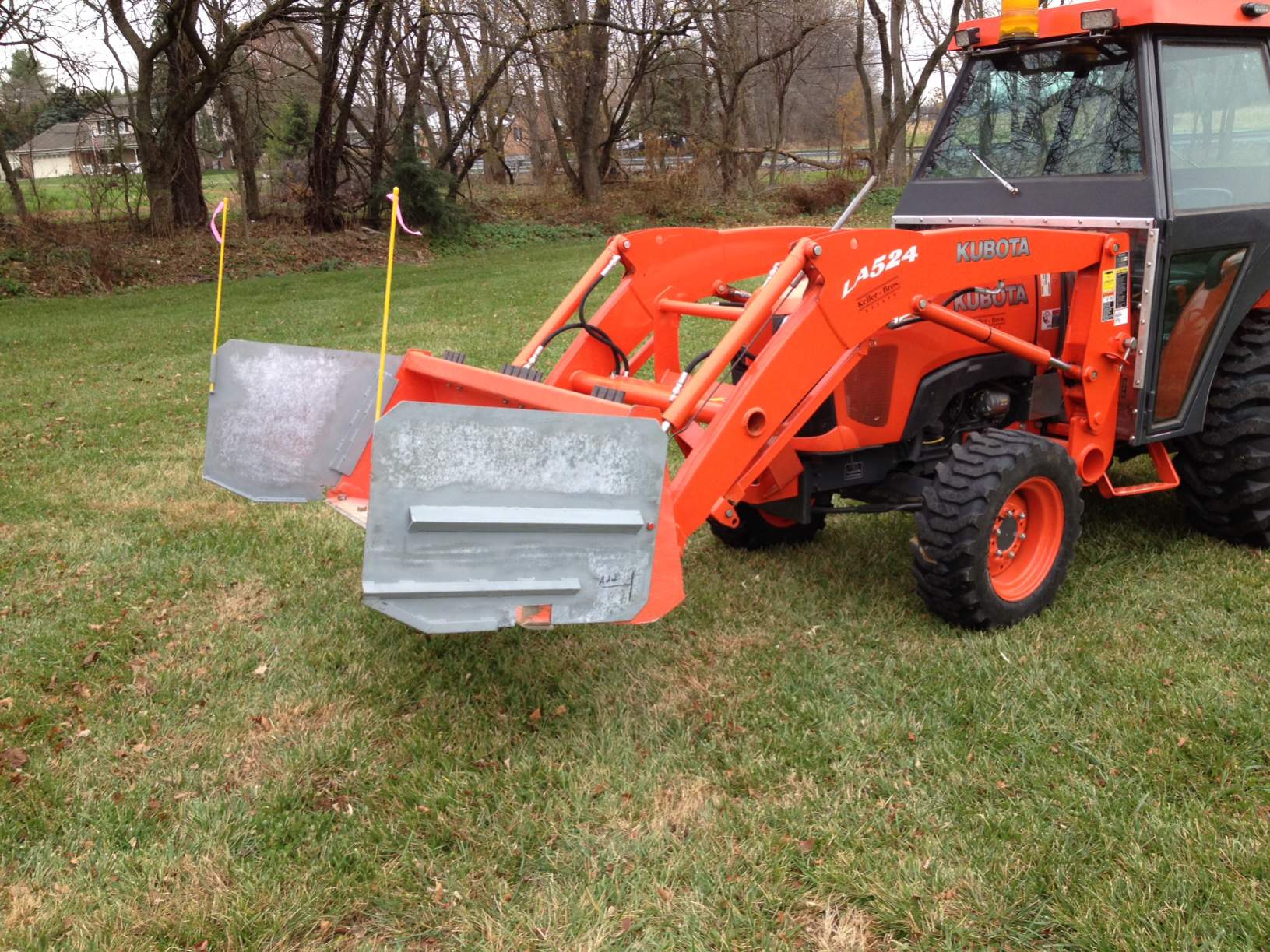

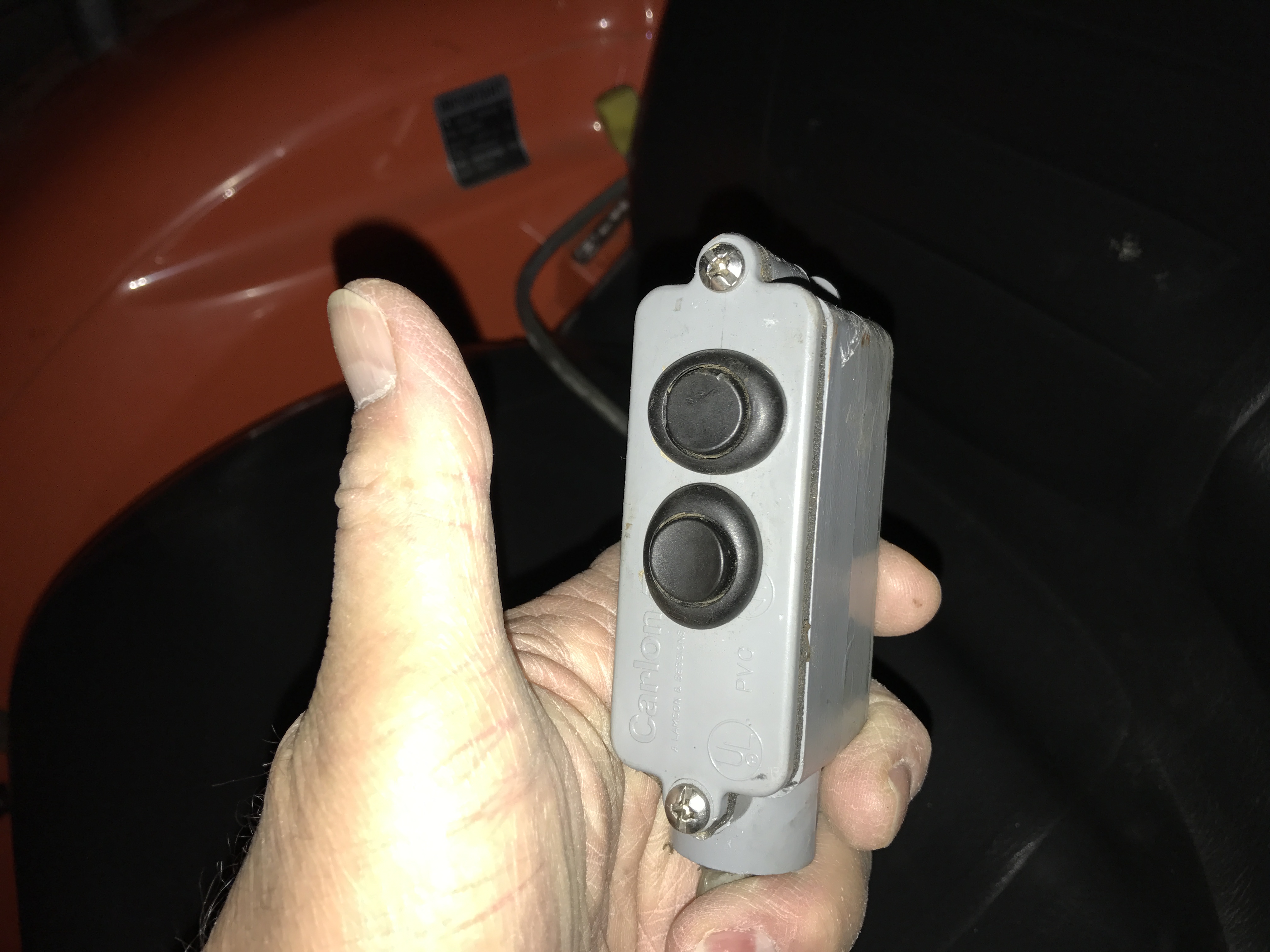

I added chute controls to the blower and side wings to the loader bucket. I wouldn't want to be without the wings when doing a big area. Next best thing to a box-type pusher.

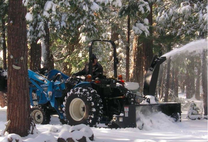

Blowing snow is like spreading manure, keep the tractor on the upwind side .
Nah, doesn't matter. Blowing snow falls under the same category as sitting by a campfire.
Campfire- no matter where you sit, the smoke blows in your face.
Blowing snow- no matter which direction you point the chute, it's into the wind and will blow back in your face.
:laughing:
