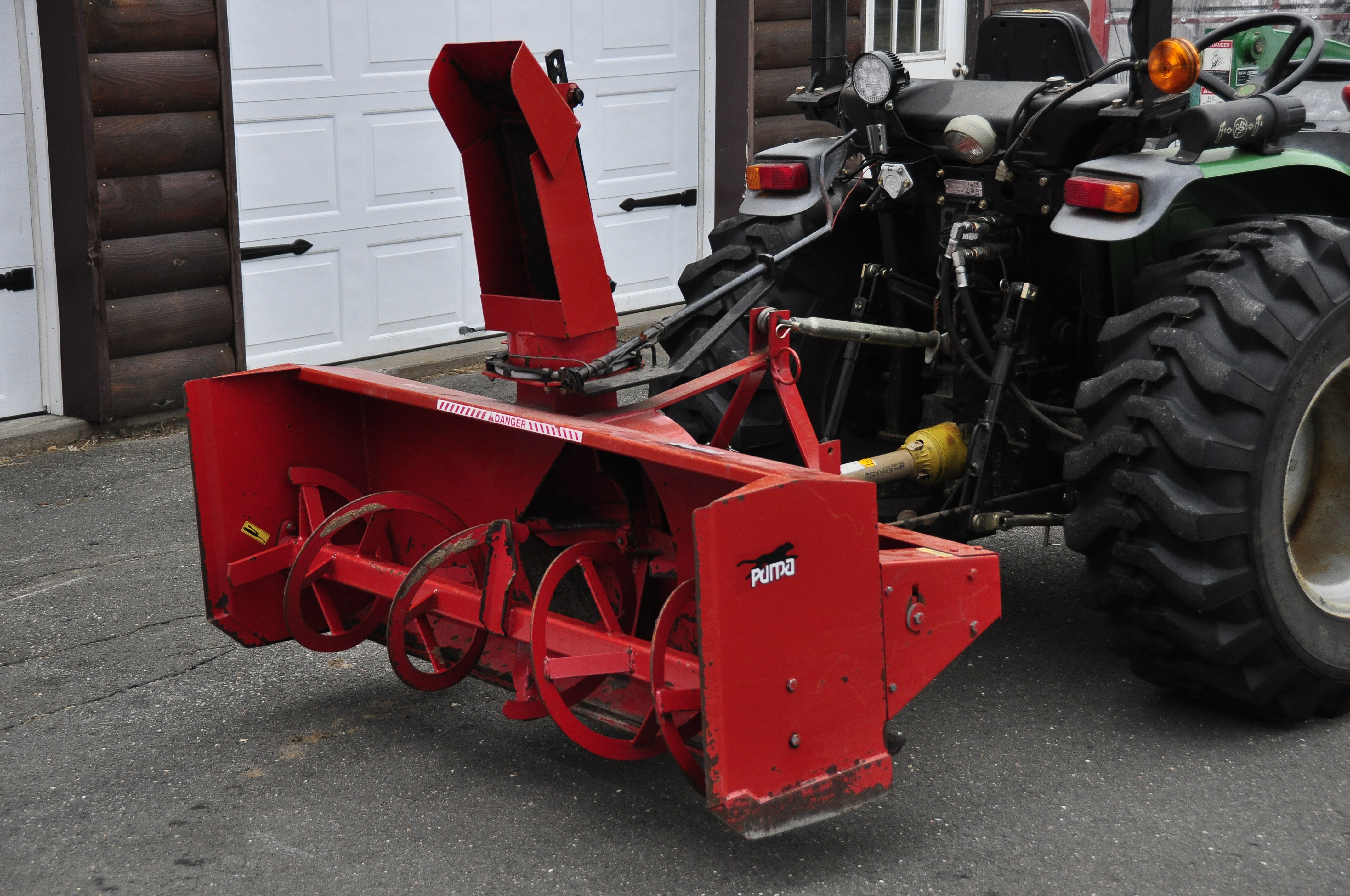

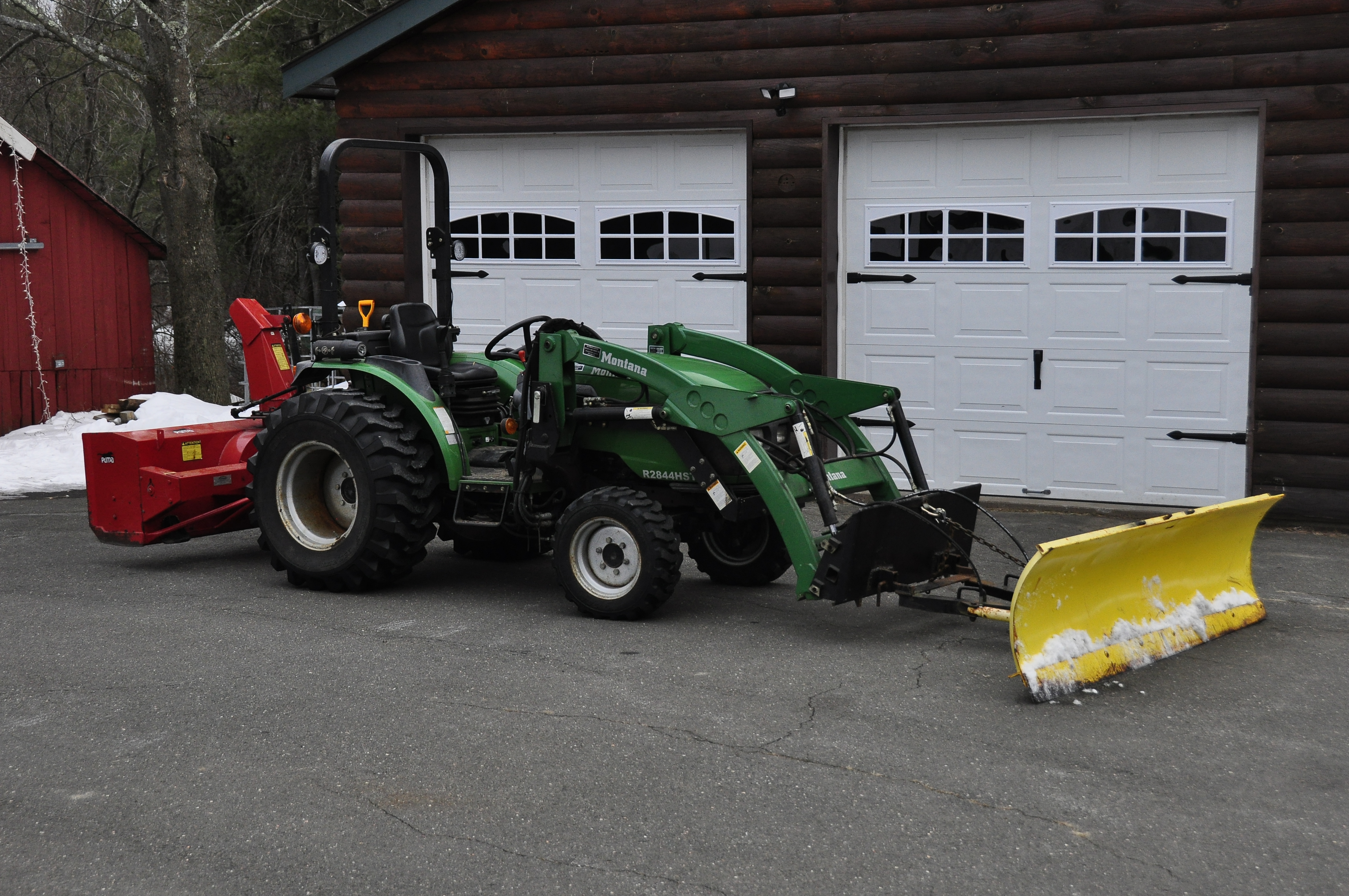

Just bought a used Pronovost Puma 64" snowblower. Get to use it for the first time tomorrow, we are expecting 8". I know you are supposed to blow at 540 rpm. On my Montana tractor, 540 rpm is at 2400 rpm. If I want more blowing power, can I run it higher than 2400rpm? I've never had it above 2400 but I am sure it can go higher. The tach goes up to 3000 rpm. Can the engine over-rev, or will the throttle lever stop at full speed, whatever RPM that is?
Engine is a Mitsubishi 4 cyl 1.5L diesel.

I never run any tractor over the PTO rated RPM and engine equivalent.
Also keep in mind most PTO driven equipment is designed to be operated at up to 540 RPMs. Augers and fans in snow blowers aren't precision balanced, if they are balanced at all. Driven at higher than designed speeds produce more wear and tear on equipment.
I think you will find that with the two stage snow blower you have, running the PTO at 540 RPMs will be more than enough to do the job you want. Just adjust your travel speed depending upon how dry or wet the snow is.
Let us know how you make out. I think you will be surprised.

Thanks for the responses. We struck out on the snow last night. Instead of 8" we got 1/2". I think we are done for the winter, so I'll touch up the paint, change the oil and be ready for next winter! Was really looking forward to using it for the first time!

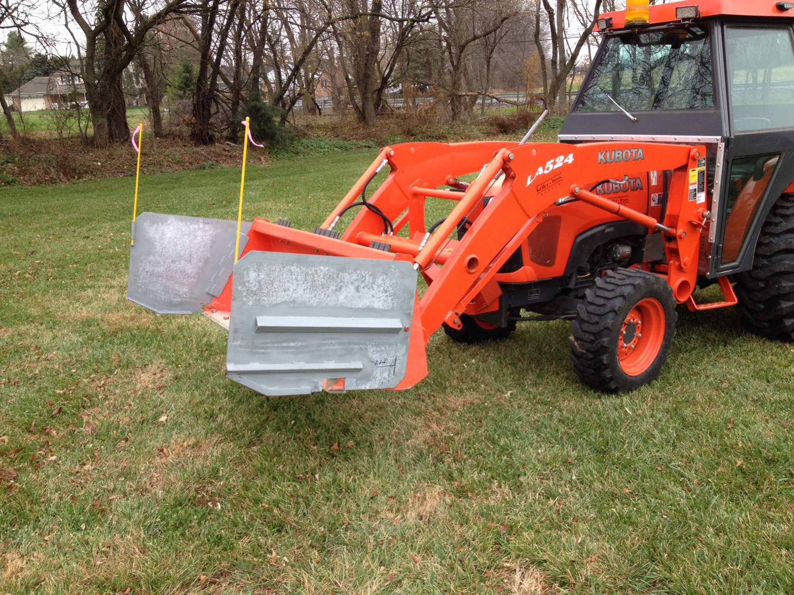

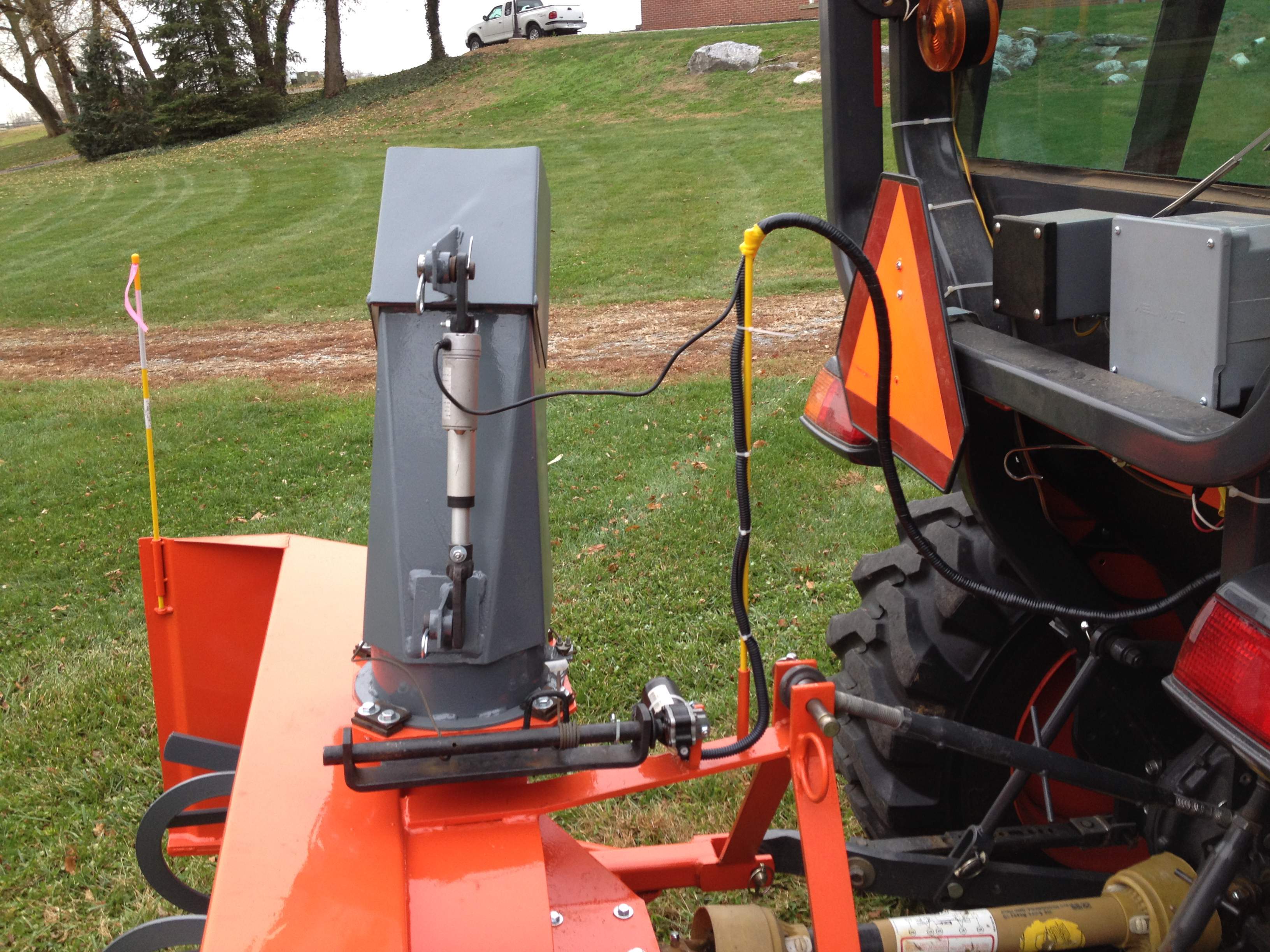

I have the same blower. Most of the time it gets run at 540, but I sometimes run it faster - depending on the consistency of the snow. It'll toss the snow around 25' or a bit farther. With around 12 or so inches of the fairly heavy snow we had Wednesday, there was no problem getting it well off the far side of parking areas that were about 20' wide. Here's a short clip doing a neighbor's driveway a couple years ago:
Shared album - Jim Miller - Google Photos

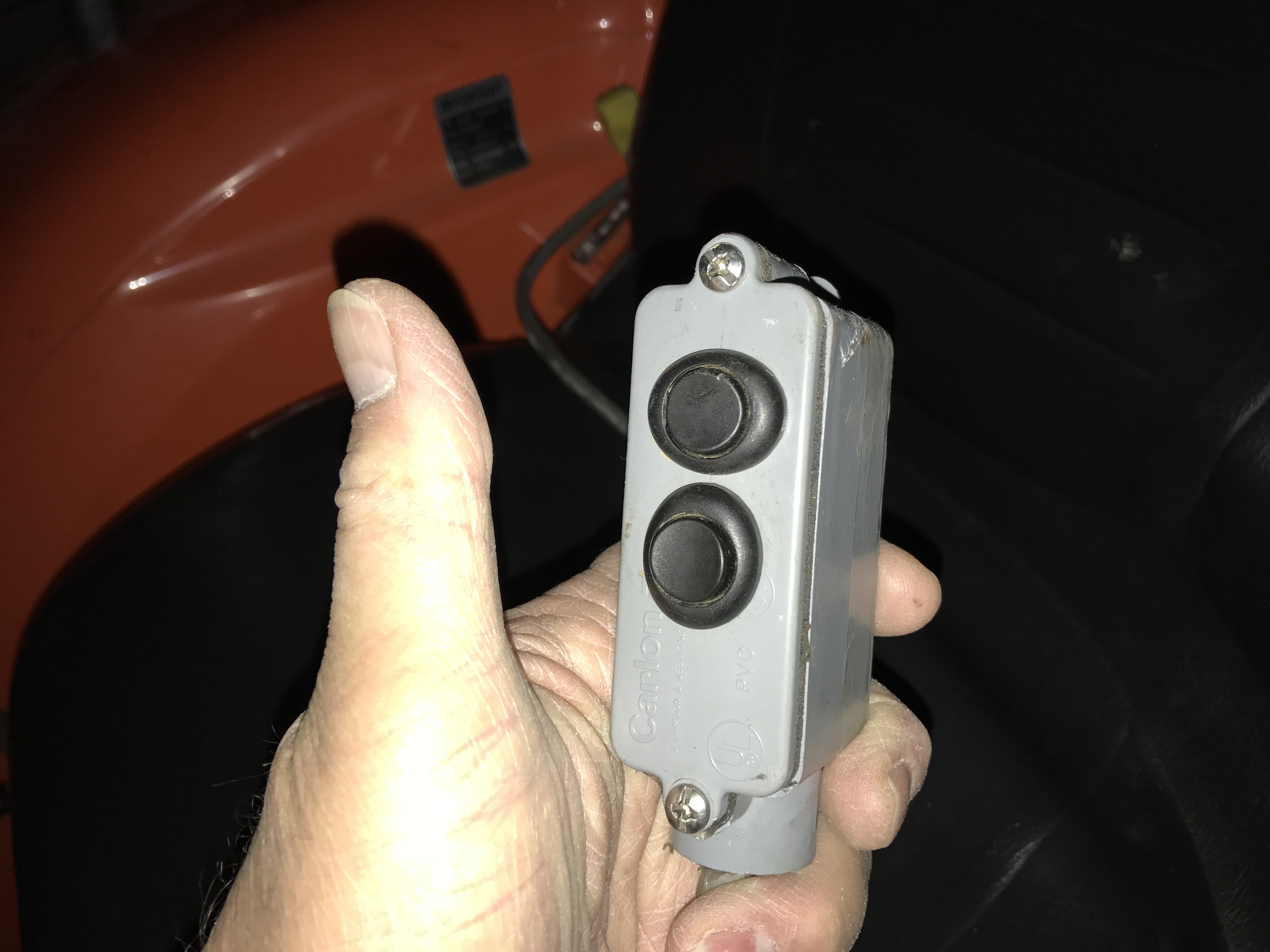

When I did the parking lots at the church on Wednesday, I made 5 or 6 passes down the length on one side with the blower to throw the snow off the left side of the lot. That gave me plenty of cleaned area to maneuver the tractor and line it up to push the rest off the right side of the lot.
I added chute controls to the blower and side wings to the loader bucket. I wouldn't want to be without the wings when doing a big area. Next best thing to a box-type pusher.
