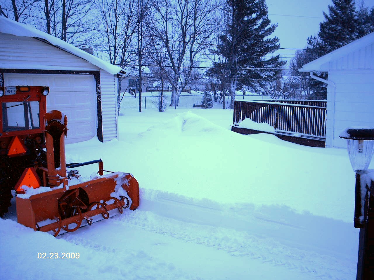

Can you explain that further?
What do you mean by "solid", and how could that help the OPer in selecting a blower?
I get the impression that it would control the flow of the snow better, but I can't quite see how. Would this make the difference between buying a 72" vs 84"?
Do you have a picture maybe?
Sure,
The Schmidt picture I have uploaded shows a single stage unit with
a gathering wing but the theory of operation is the same as the auger may
be used to operate that fast feeding the impeller but some experimenting would be needed to obtain the proper speeds for the snow caster auger to feed the impeller.
If you look in YouTube - Broadcast Yourself. for european snow casters you will eventually find snow clearers used for highways and there are a herd of them built and sold for Mercedes Unimogs which are single stage and the casting distance is huge.
The snow casting drum would not have to rotate that fast with a two stage unit but the casting distance would be just as far or further.
A solid auger is nothing more than a grain auger of sorts with
narrow flighting which is the distance between each section
of ribbon on an auger.
The key is having a large diameter drum that the ribbbon is welded
to which limits the amount of snow that can be metered to the impeller
with zero flooding and jamming.
A larger diameter drum and ribbon would be very easy to use and operate
with two stage or single stage rear mounted snow blowers.
If the flights were 10-15 degrees apart and 4 inches deep the snow removal
with a two stage or single stage snow caster would become a zero issue, but the snow caster would cost a bit more to build and purchase.
