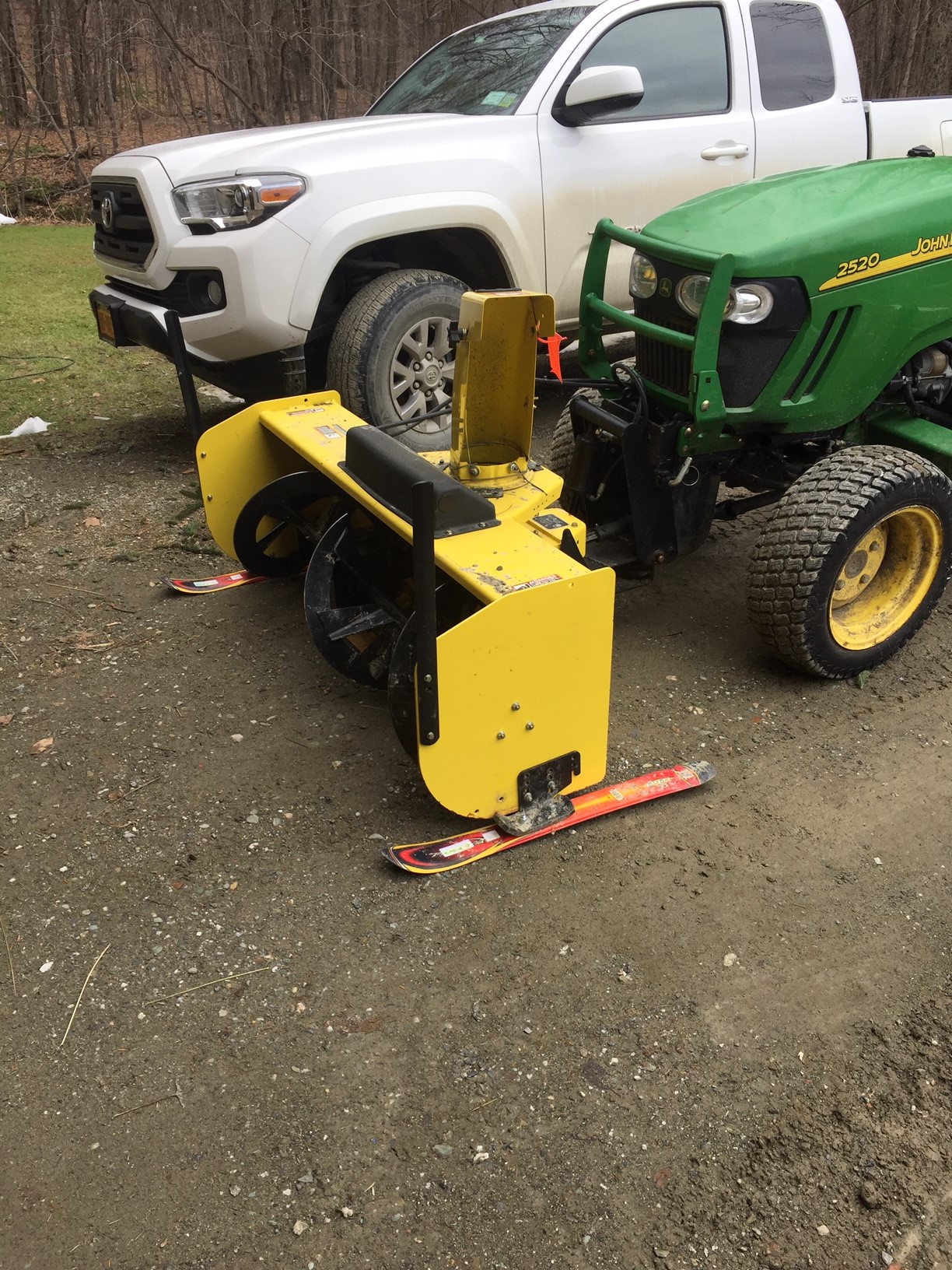

This is my first season using my 54" front mount snow blower on my John Deere 2520. we got almost 20" over 2 days here in upstate NY and I have a gravel driveway about 1000 feet long. After the first pass with the shoes down all the way I still caught gravel ( 1 rock as well so I changed my first shear pin as well ) so I was gifted a set of short snow skis from the local ski area and bolted them to the shoes. What a difference. The skis have metal inside yet are flexible as well. I used 3/8 carriage bolts and just bolted them on. No more digging in hence no more gravel.
/ Snowblower Snow Skids #15
And the skis were free.....about 18" long.

I have old cross country skis and I could definitely do that.
