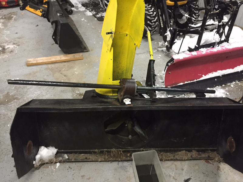

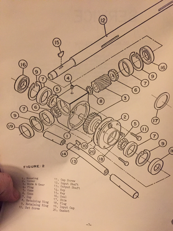

Well I got the augers off. The shaft that is left is a lot longer than I expected?here is a pic. Why in the parts breakdown does it show it in 3 pieces?
My next move is unbolt the cover and start taking all the guts out so I can remove the old broken shaft correct? This will be the part that I hope I don't screw anything up.in order to change all 3 seals everything has to be removed I assume. At least I have a service manual with the pics. I will be attempting this Sunday afternoon when I get home from work. If I am missing anything let me know. Thanks all

I am pretty sure they intended it to be seen as one shaft (hence the "serrated" edges of the sections).
Aaron Z
/ Snowblower gearbox #38
Sure thing, #13 is that one long shaft all one piece.(like 48/49" on a 48" blower)
Next you will need to dismantle the fan shaft in order to replace that.
Fan itself is easy, undo the fan sheer bolt and pull fan off.
On the tractor side, remove the bolt that holds U joint as well as a setscrew and yank the PTO shaft away.
Next will be 3 or 4 bolts that hold the bearing in place.
Probably the most difficult will be that flange that mates to the blower fan. Again a bolt and a key.
When you have the fan removed and 'in hand' you will notice 3 legs that support the 3 fan blades.
I have noticed that those legs (on mine) simply rotted to the point that they were crumpled (like compressed) from hard work and that my blades were twisted making for poor propulsion. I beat mine straight and replaced the legs or props with tougher ones which resulted in much better performance.
I simply did my best to make all three 'legs' as even as possible and welded in place.
Now I always blow at that 700 or so RPM and never noticed any vibration. (like 6 yrs or so now)
Were I to again need to dismantle I would also close up the gap between the blades and the fan drum.
If you have welding I'd close up the gap or at worst drill and add plastic or rubber flaps.

Thank you very much for the help and advice. I have heard and seen kits that close the gap between fan and drum. I have some thick rubber at work I might bolt to the end of blades. If I run into any other questions during repair(and I'm sure I will) I will be sure and ask.
