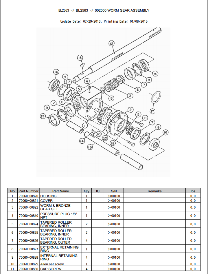

Here is where I am. The manual says to now pull the long shaft along with the gear out. Well I guess im missing something cause the shaft wiggles a bit but will not pull out. I can rotate it easily though. Last night I got the whole fan assembly disconnected.

Did you pull the circlip on the other side? If not, I would pull that to let you get the gear out of the gearbox,
If you dont need to remove that gear from the shaft, I wouldn't. One less thing to put back together.

Say, do you even need to pull that long shaft?
You are only needing to replace the short shaft that broke and I believe it can be persuaded out by prying while twisting (unscrewing motion). There might however be a circlip that holds the screw shaft in place, if so it would be located inside the bearing where the broken shaft enters the casting.

Say, do you even need to pull that long shaft? You are only needing to replace the short shaft that broke and I believe it can be persuaded out by prying while twisting (unscrewing motion). There might however be a circlip that holds the screw shaft in place, if so it would be located inside the bearing where the broken shaft enters the casting.
Yes there is a circlip holding it in place. According to repair manual the long shaft and big round gear have to come out before I can access the rest so I can remove the broken shaft.

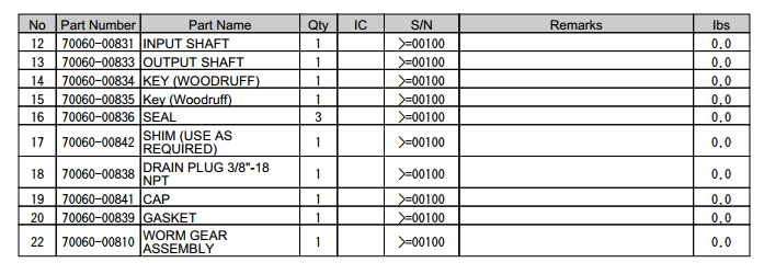

Here is a diagram of it.
Sent from my iPhone using TractorByNet

/ Snowblower gearbox #51
If you pull the #16 seal from the other side of the gearbox (right side when its on the tractor) will that let you pull the #9 circlip on that side and just slide the shaft out?

#52
Wow........... Finally gone it all done and up and running. Just got done with the testing. All went well. The parts didn't all come apart or go back together easily but it got done. Everything inside the gear box looked real good. So new shaft, all new seals, 1 new bearing and fresh gear oil and grease and almost $300.00 bucks and it should be good to go for a long time. It was a good thing I had my father in law to help the last 2 days. Thanks for all the help gentleman.

If you pull the #16 seal from the other side of the gearbox (right side when its on the tractor) will that let you pull the #9 circlip on that side and just slide the shaft out? Aaron Z
That's how we did finally get it out.
Yup that's how I eventually got it out.
