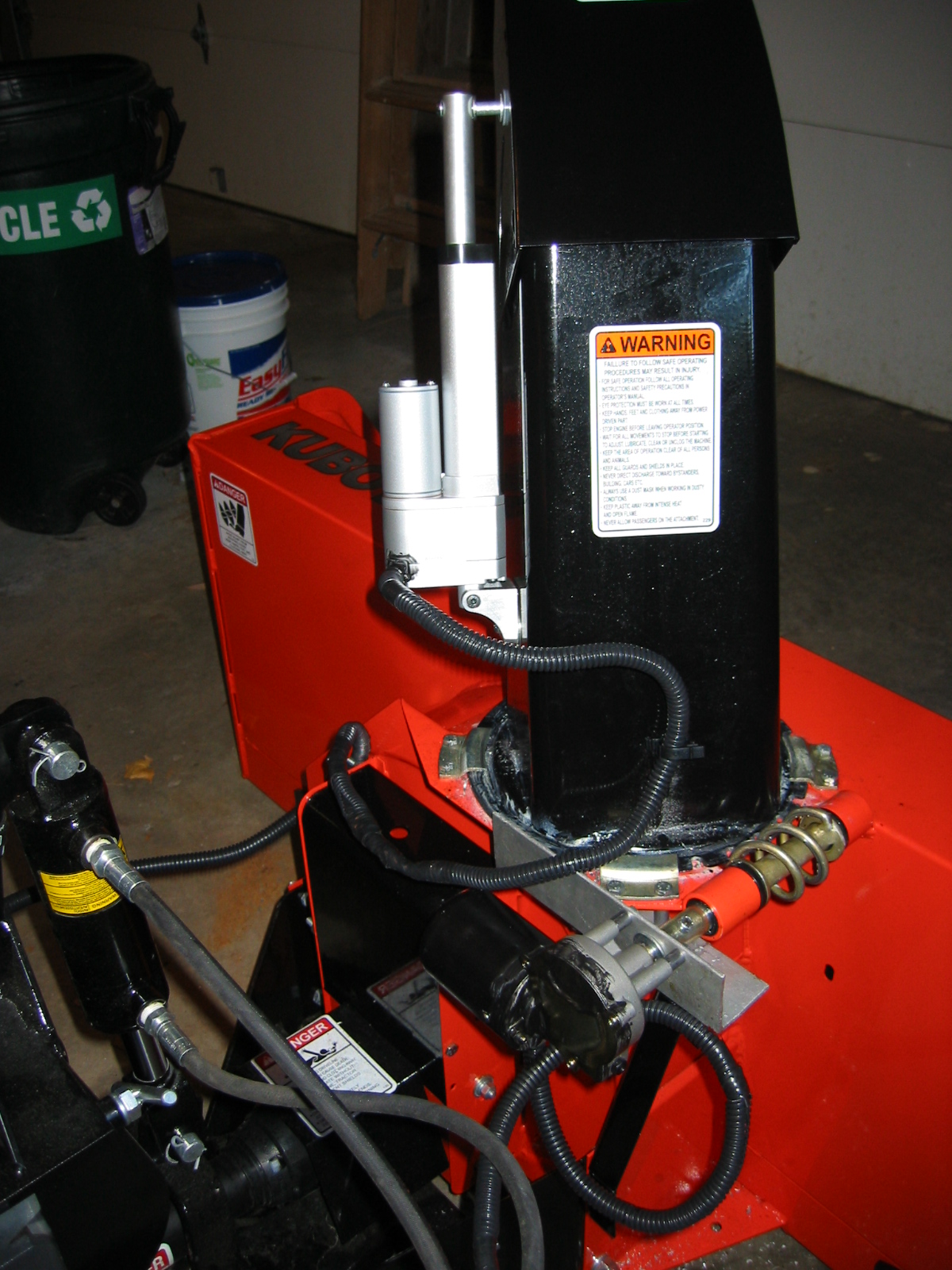

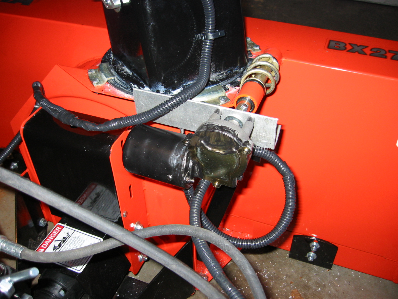

THIS IS MY SET UP AND IT COST WAS A LITTLE UNDER $200

Hey JWatt.... electric right? Looks great! Had a question regarding the shaft connection to the 'worm drive' of the chute. Did you use bushings or sleeve to fit the shaft(s) for the motor and the receiving part? Did you bore your own to fit? I've been having a hard time trying to find something that would marry the two together.
Otherwise I've got all the parts but that. I didn't even think about the chute deflector attachment. Cool idea.

I used a piece of the hand crank that slides into the larger piece of the crank.I just cut off a small piece,drilled a small hole in both the shaft and small piece and put a nut,bolt and lock washer.

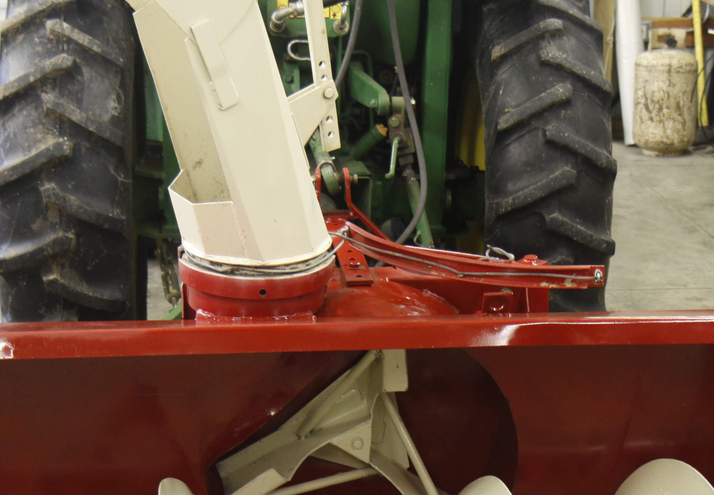

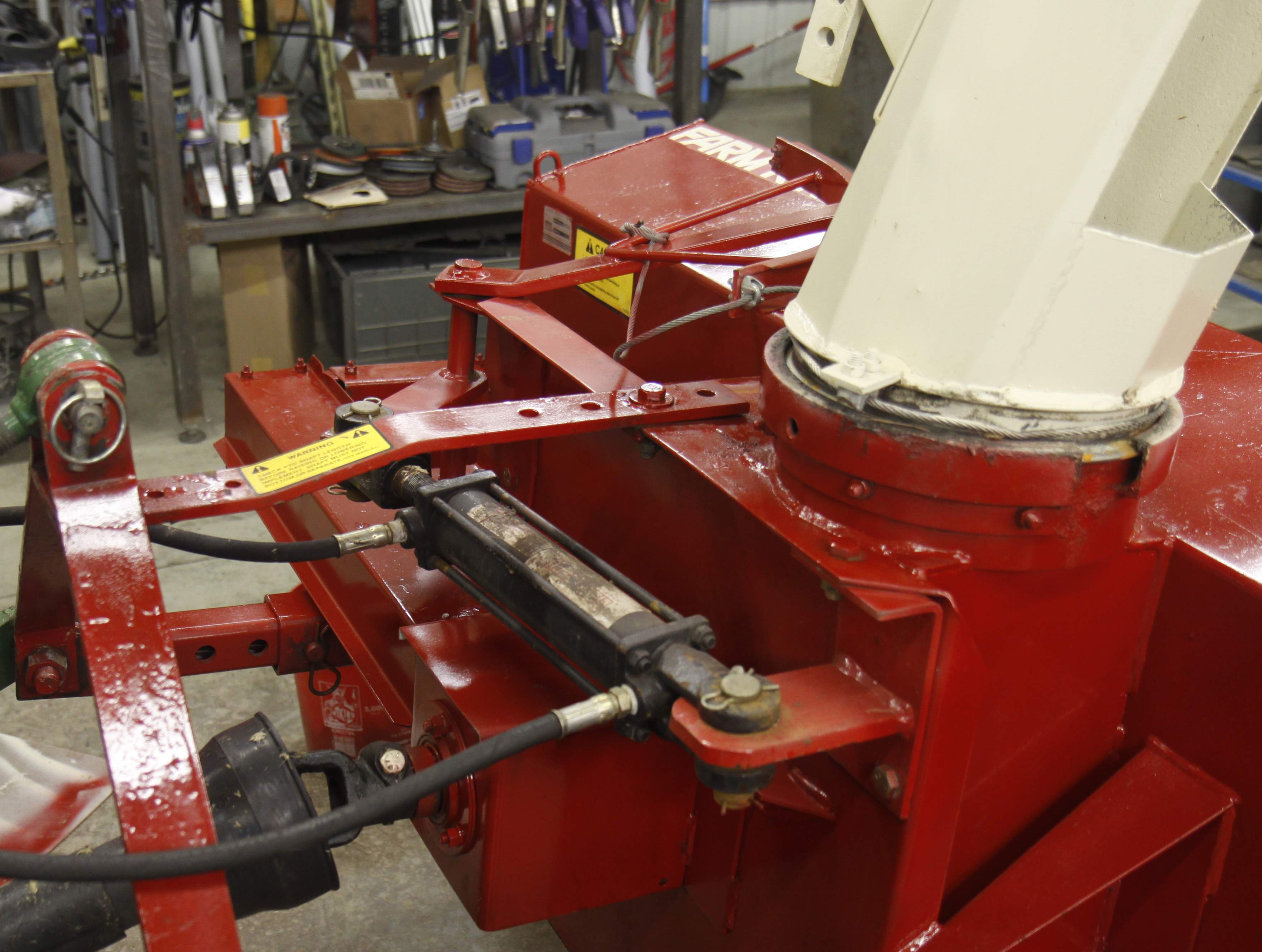

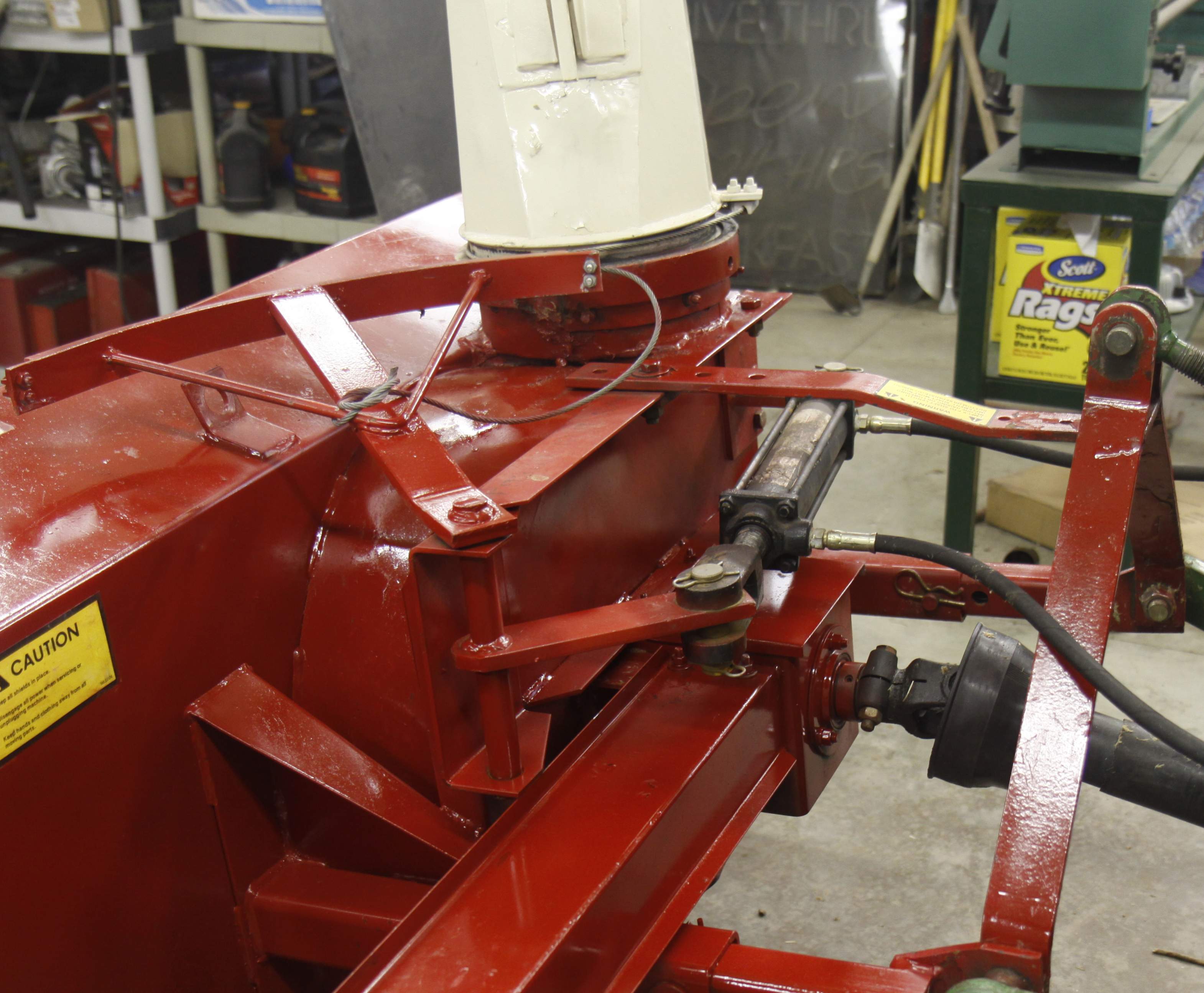

i have a FarmKing snowblower and its a simple cable pull system. has been working for 4-5 seasons now, and never freezes up. here are a few pics. its a double action 8" hydraulic cylinder. I set it to overshoot on one side, nearly hitting the tractor. this is to clear a vulnerable part of one of my buildings. you can set the cables to limit the stop at whatever angle you wish.
