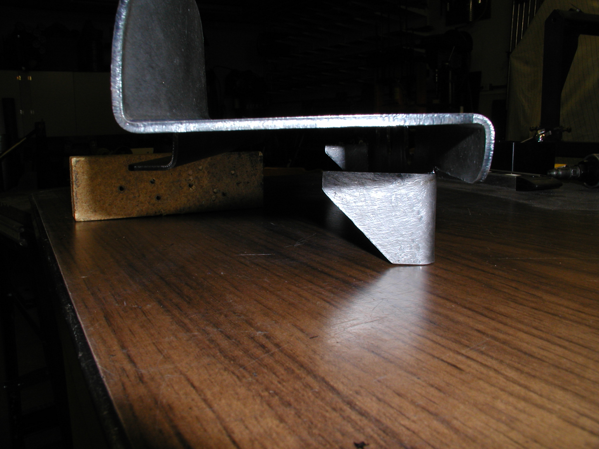

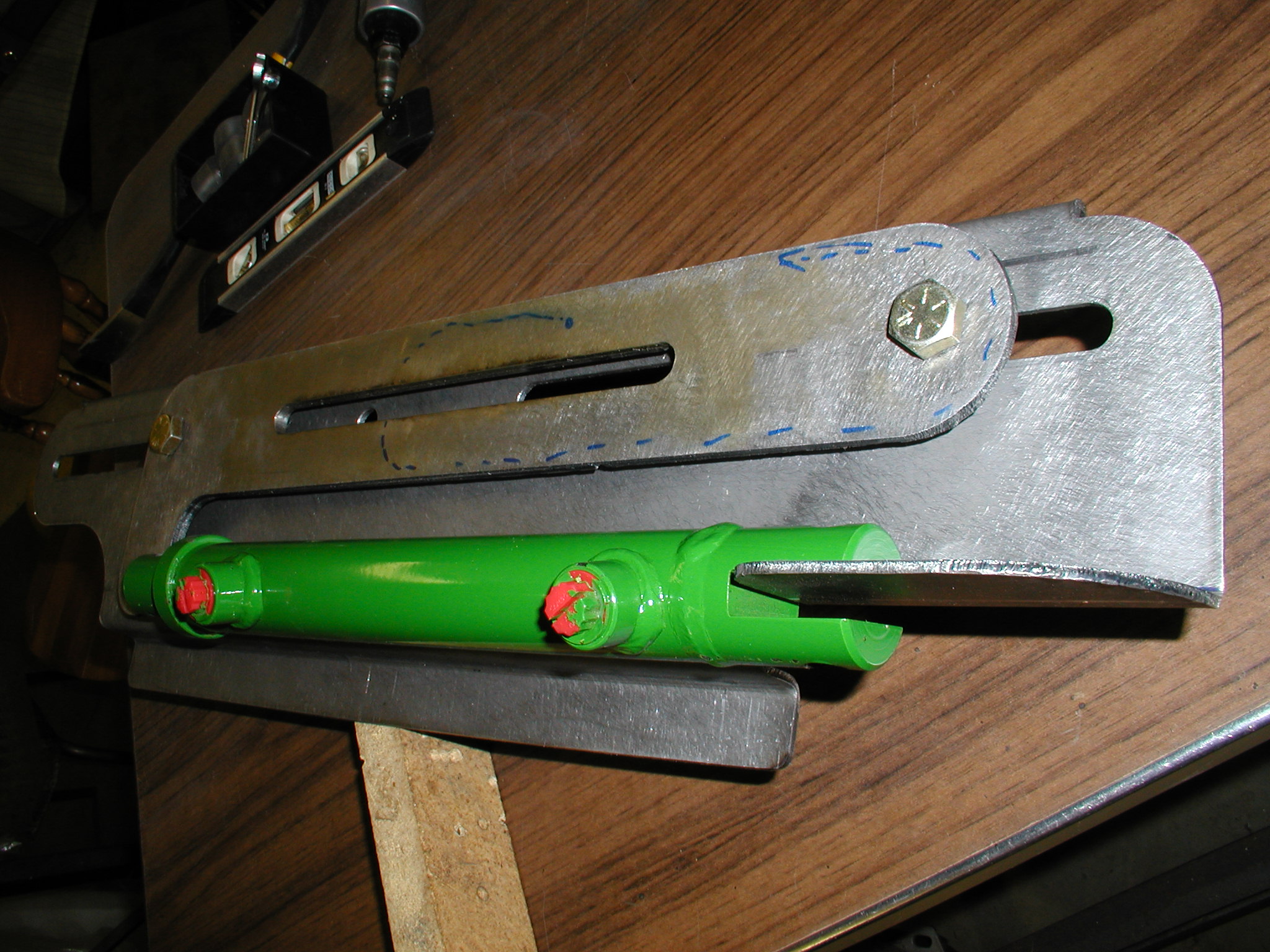

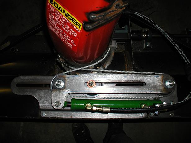

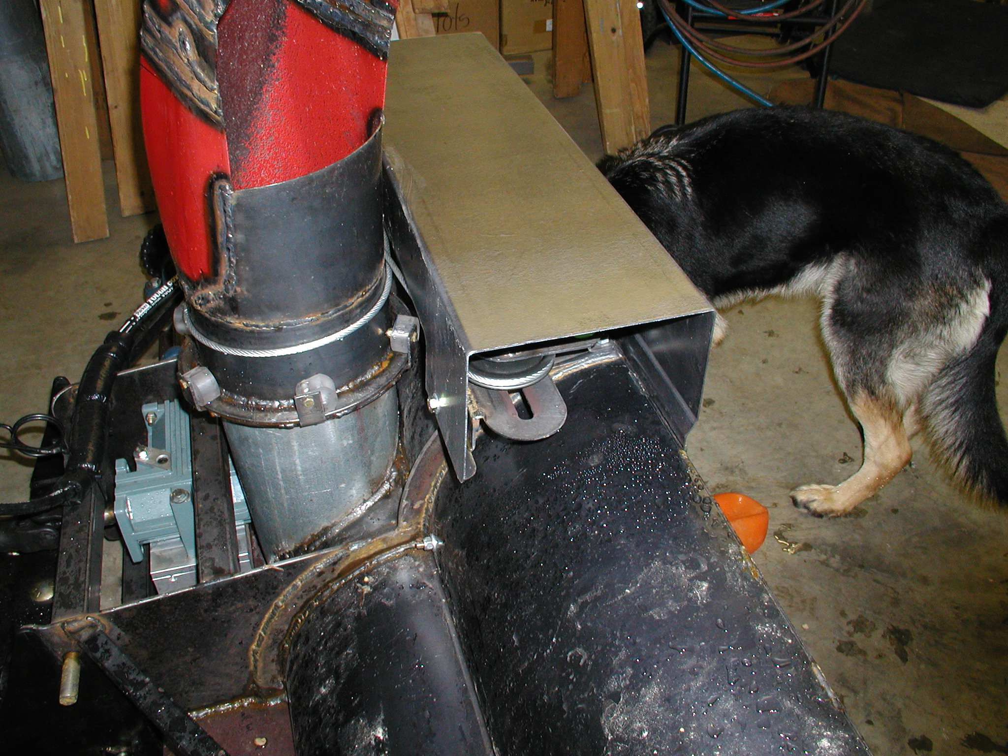

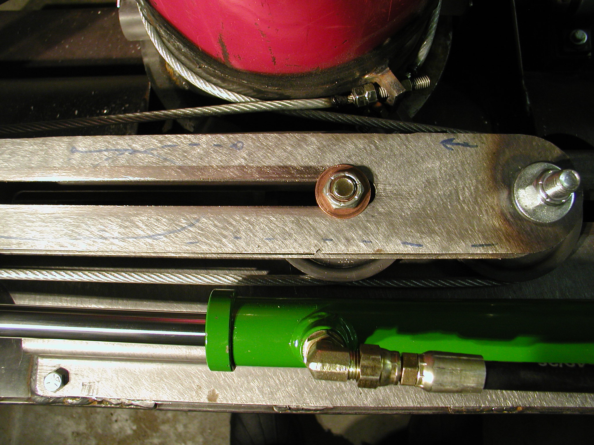

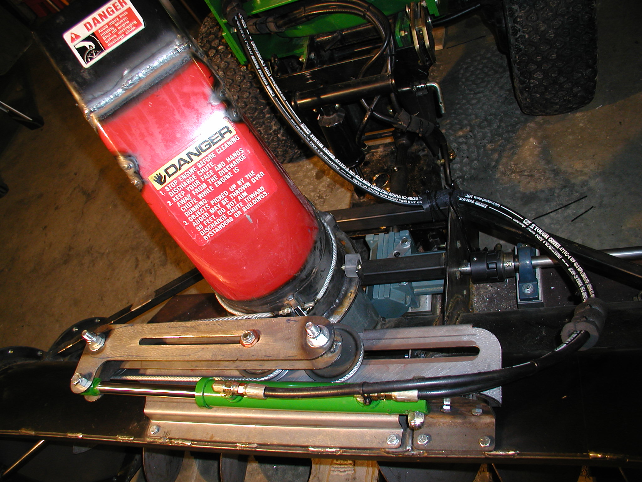

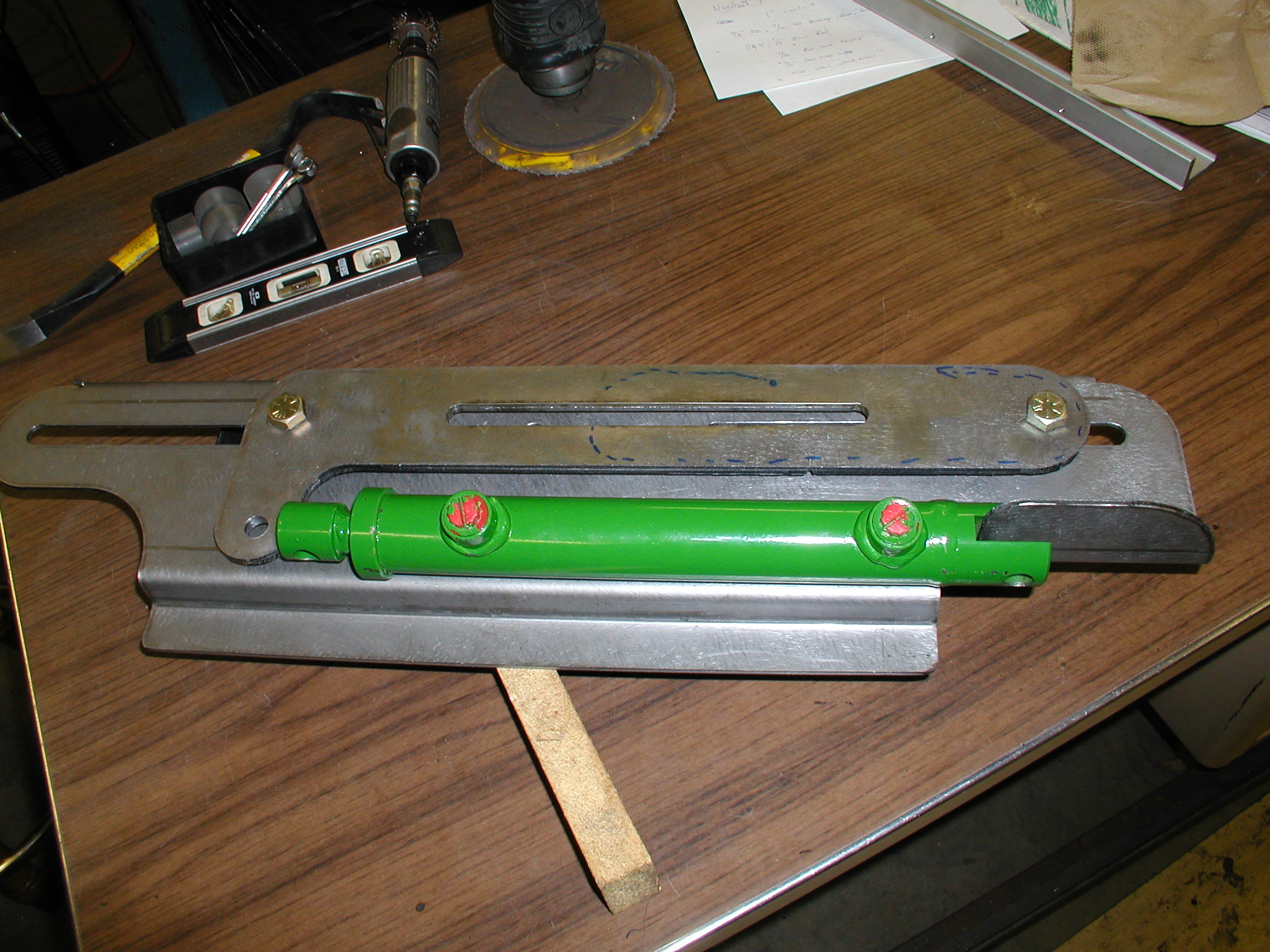

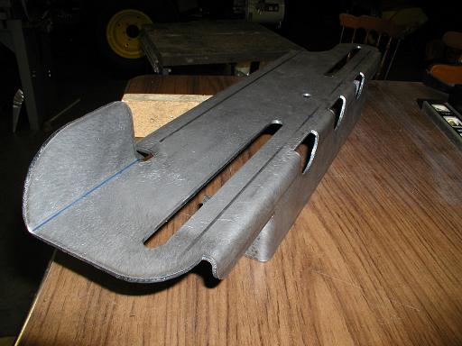

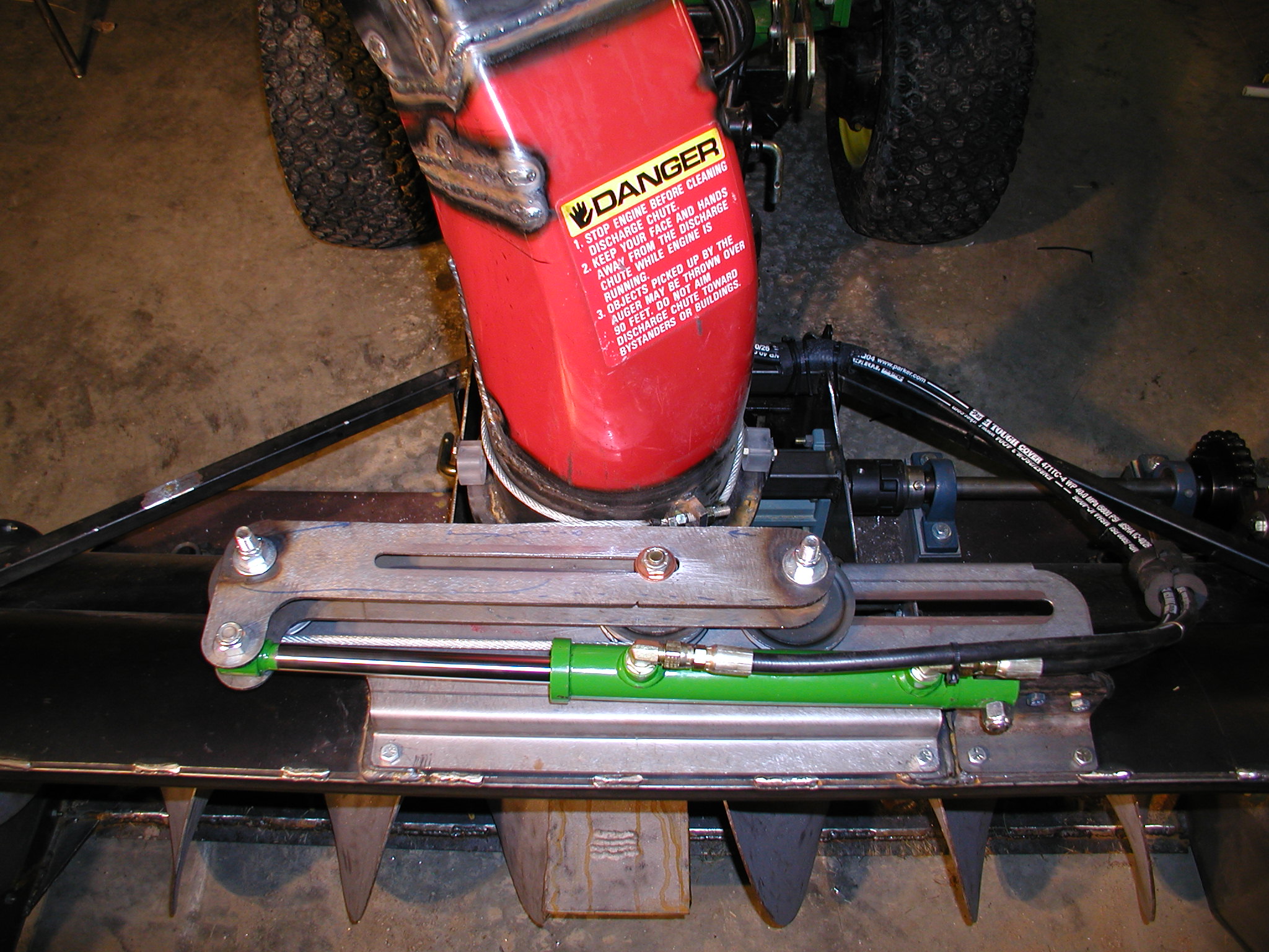

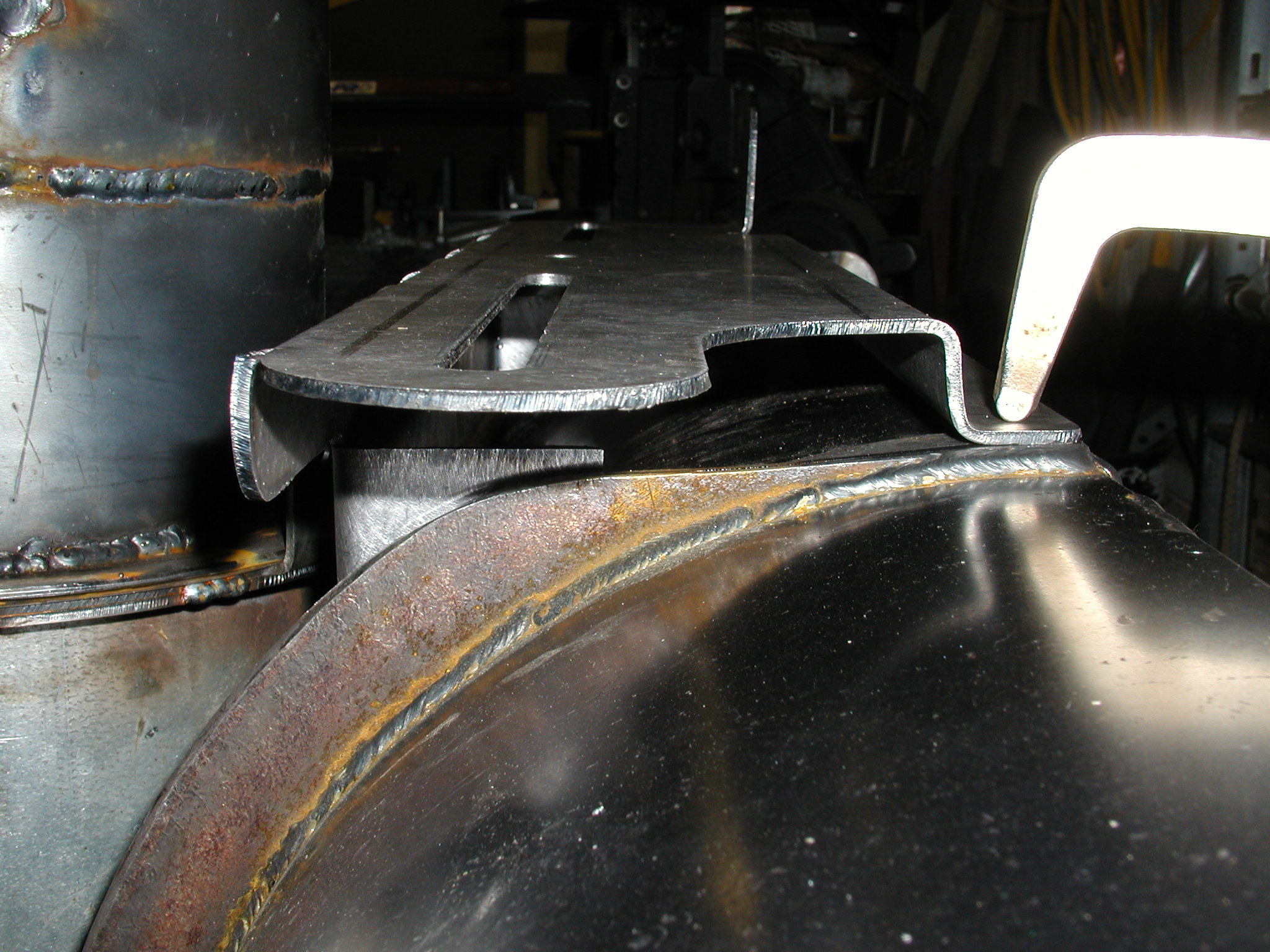

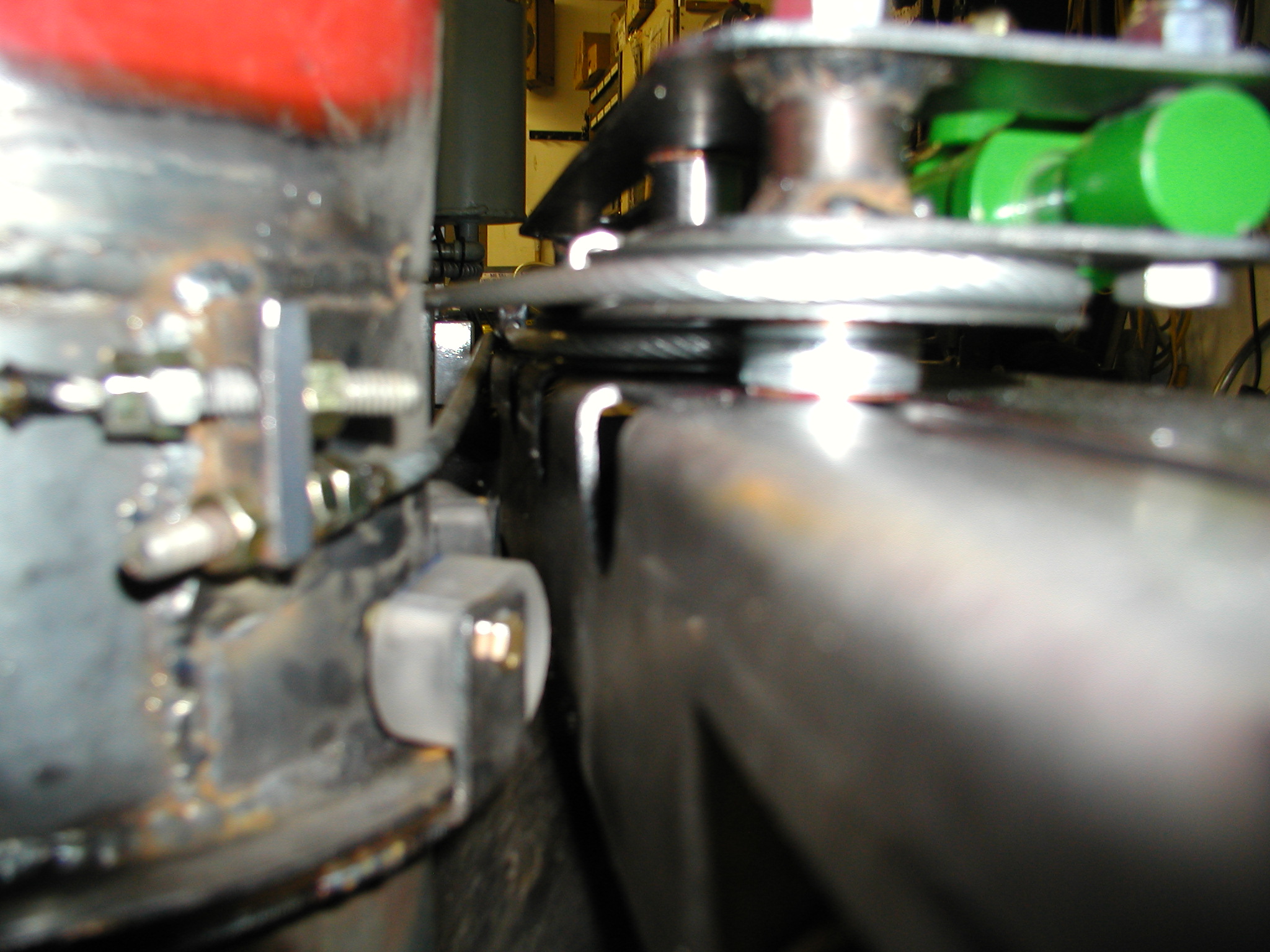

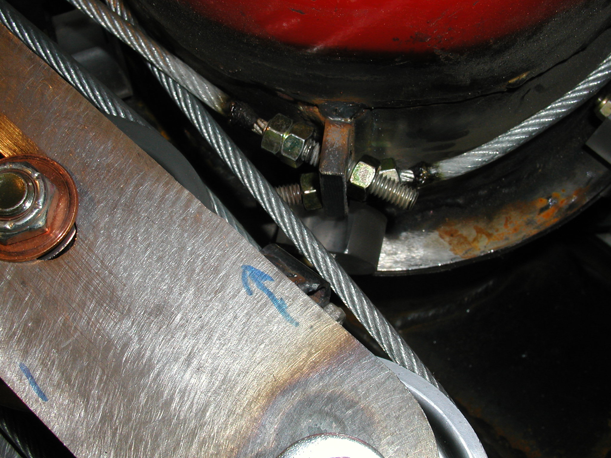

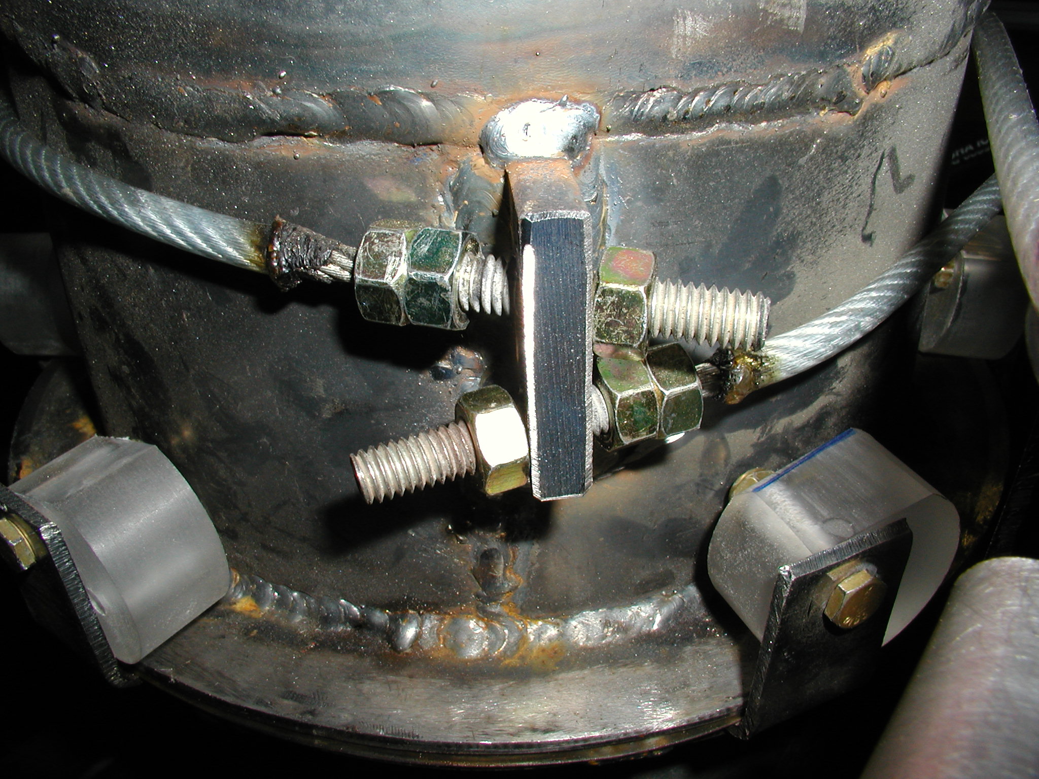

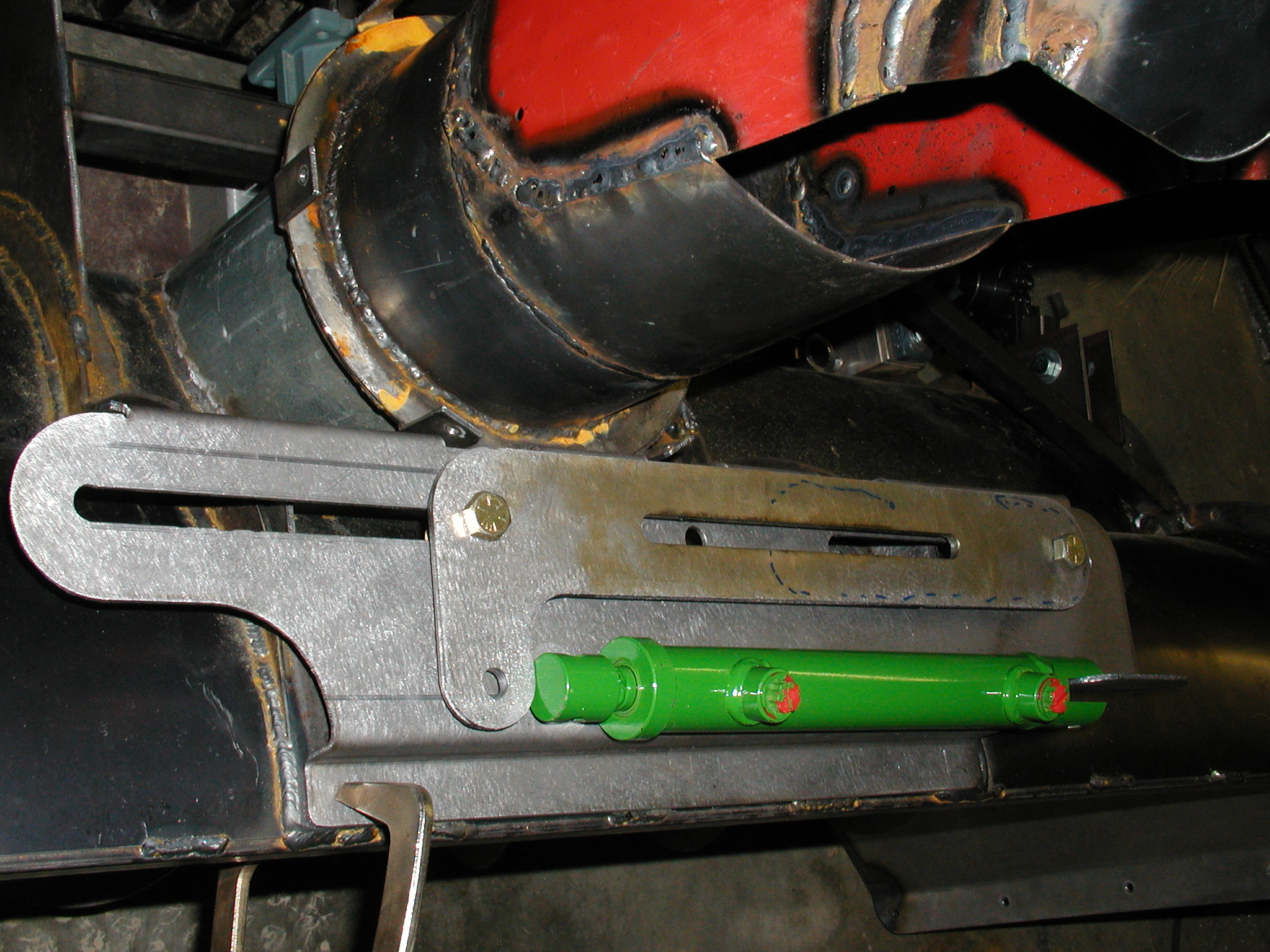

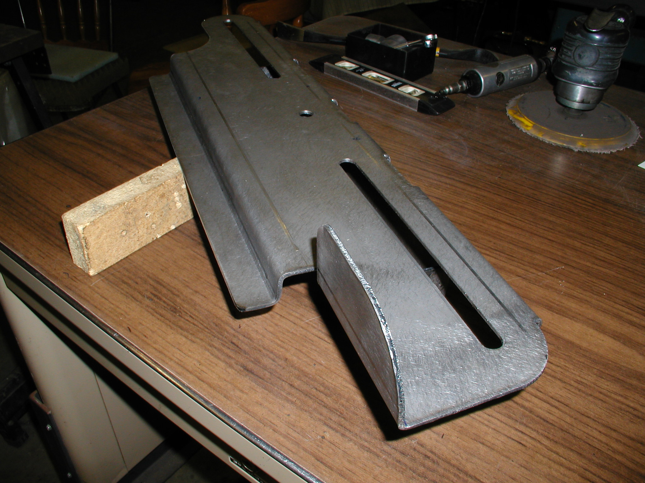

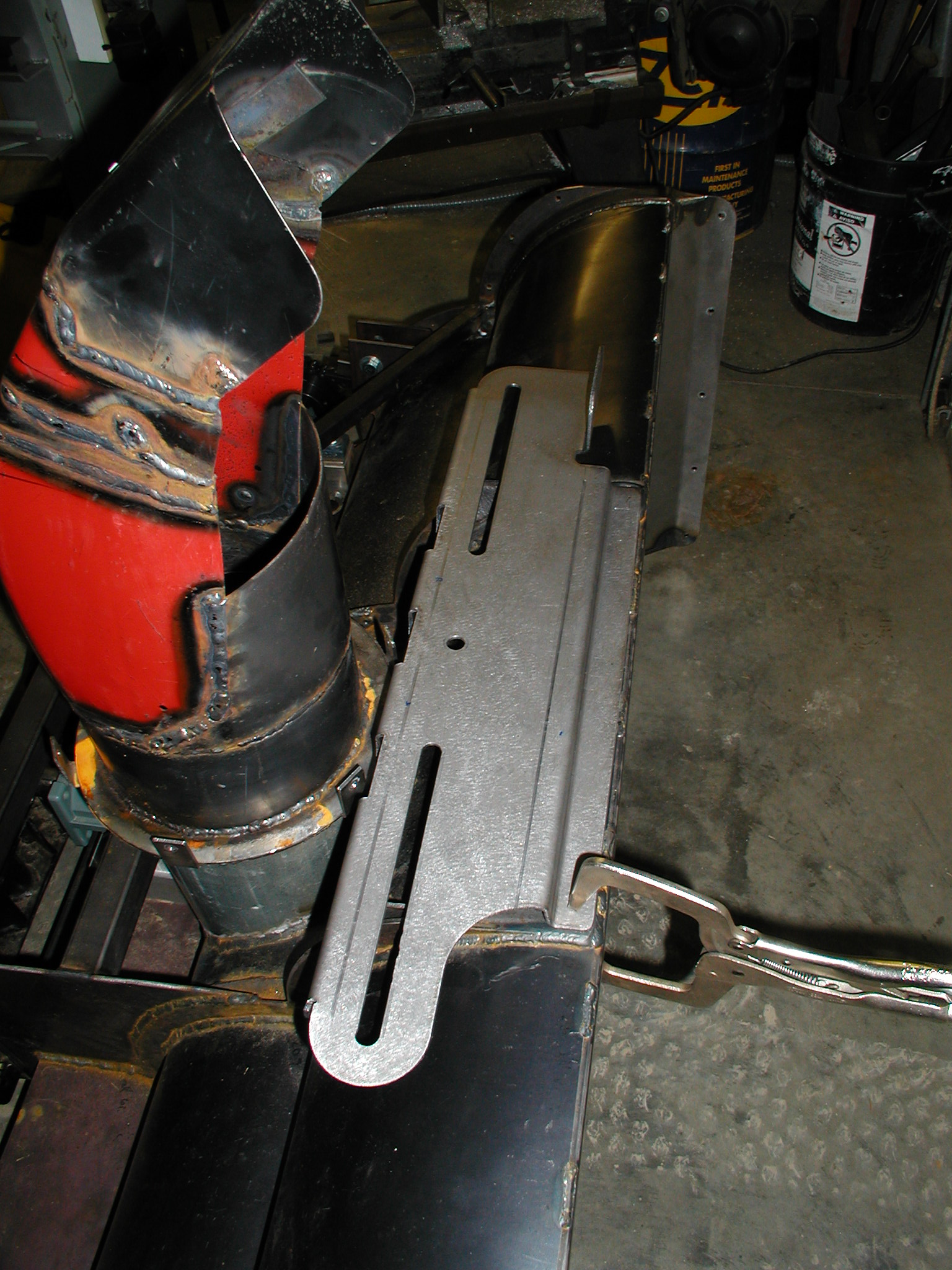

I built one. I got the basic concept from a 2 inch square picture in an owners manual of a JD snowblower. I copied the idea, assuming I understood it. I thought the cable system amplified the cylinder range about two to one. Actually it amplifies it three to one. Happy mistake, I got more range than I had planned for. I found some pictures of it all. Some of the more exotic parts were made on my nc plasma cutter. The pulley wheels came out of McMaster Carr. The cable was just some locally-sourced vinyl coated stuff. I took bolts, cut off the heads, bored into the shank, and silver soldered the cable into them for ends (see pics). If questions, please ask.

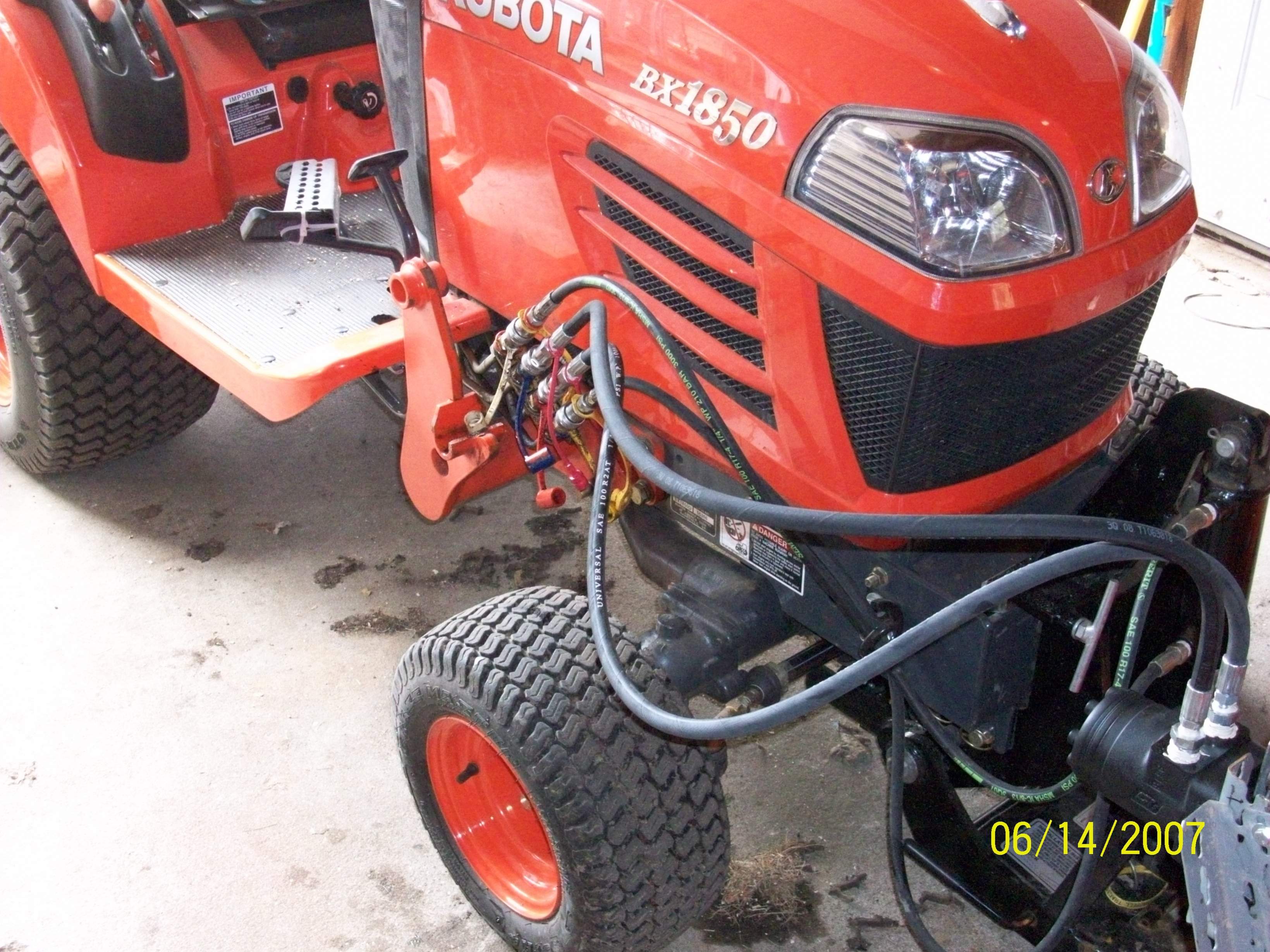

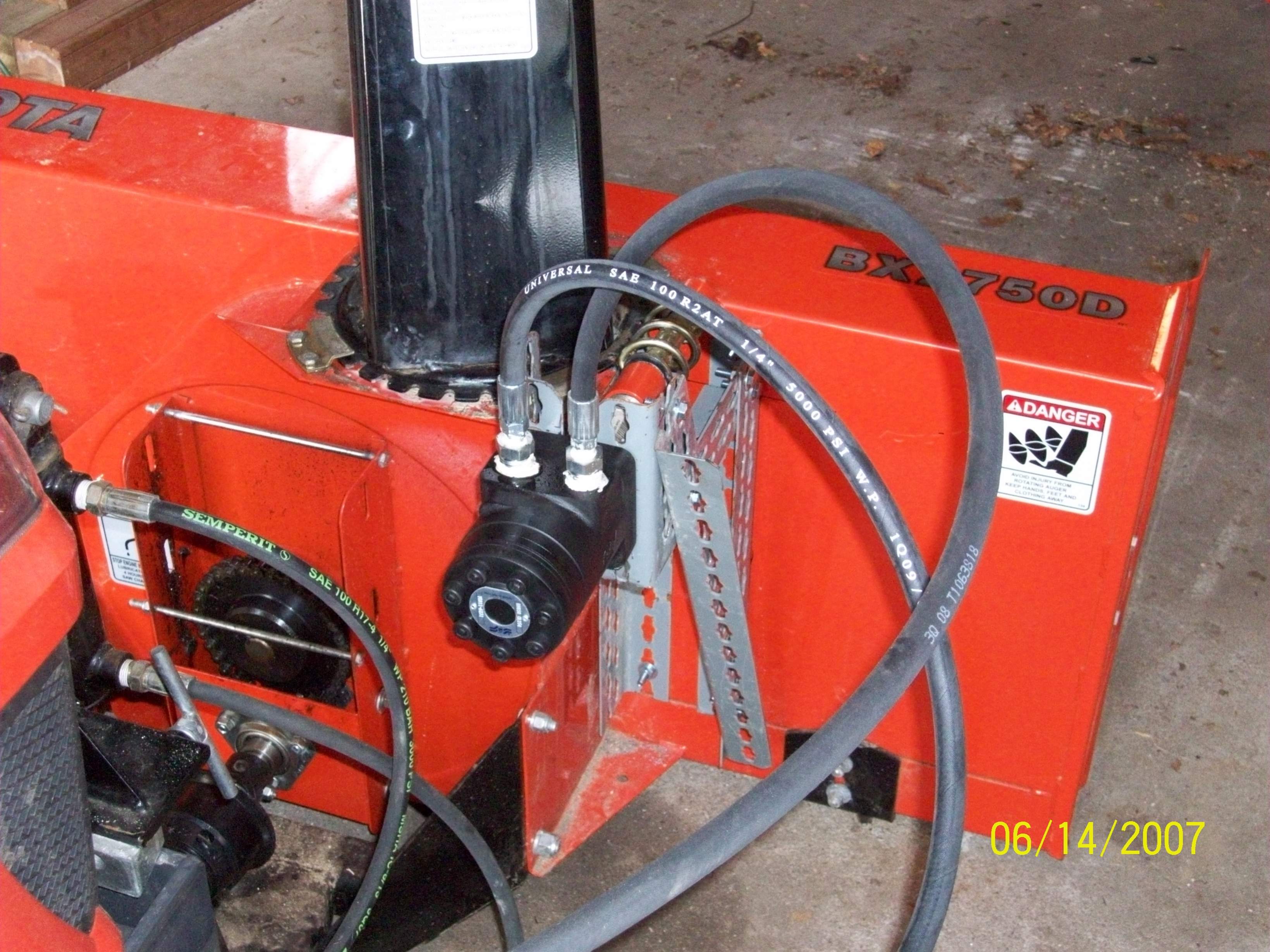

/ Snowblower chute rotator #16

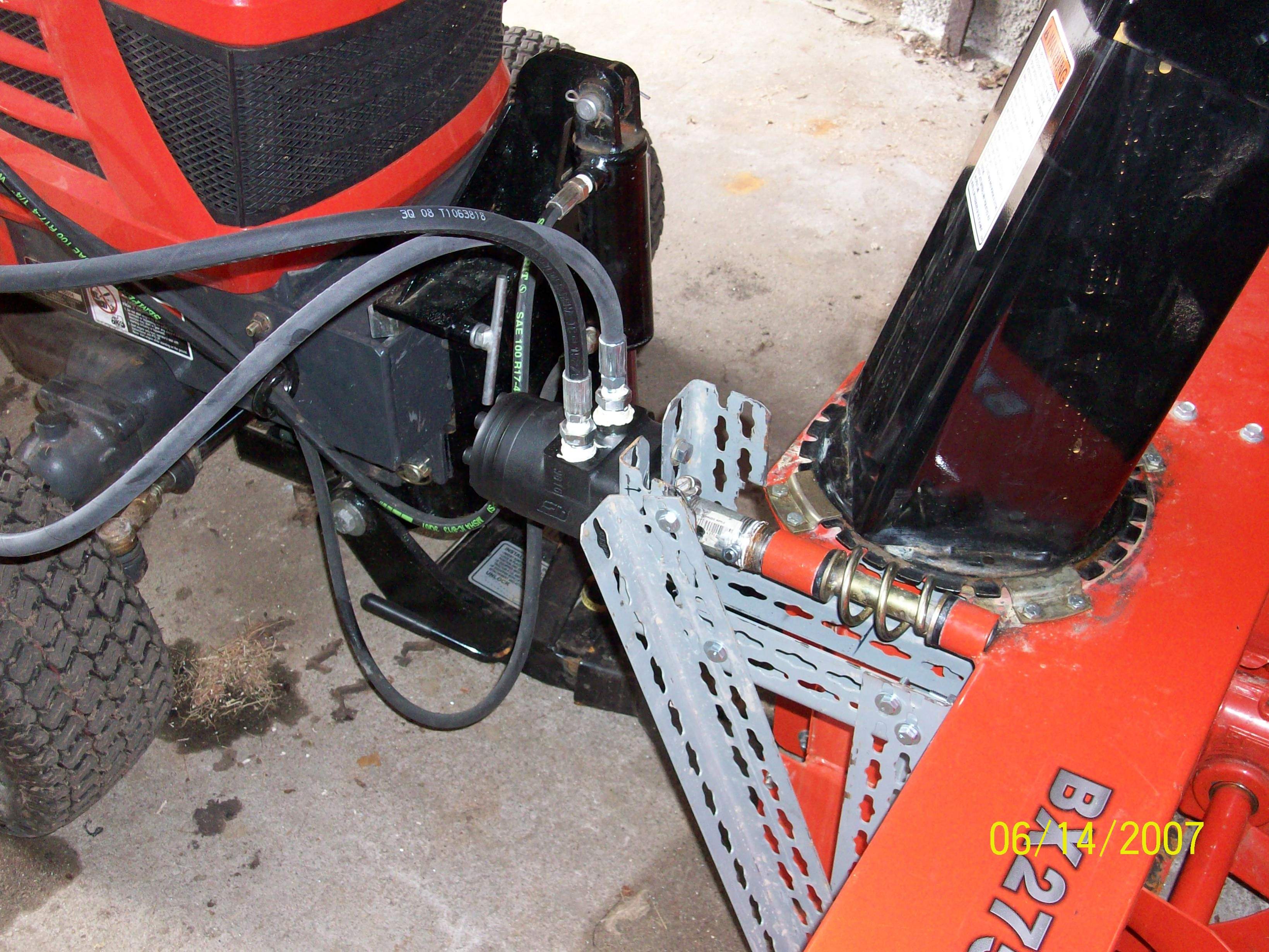

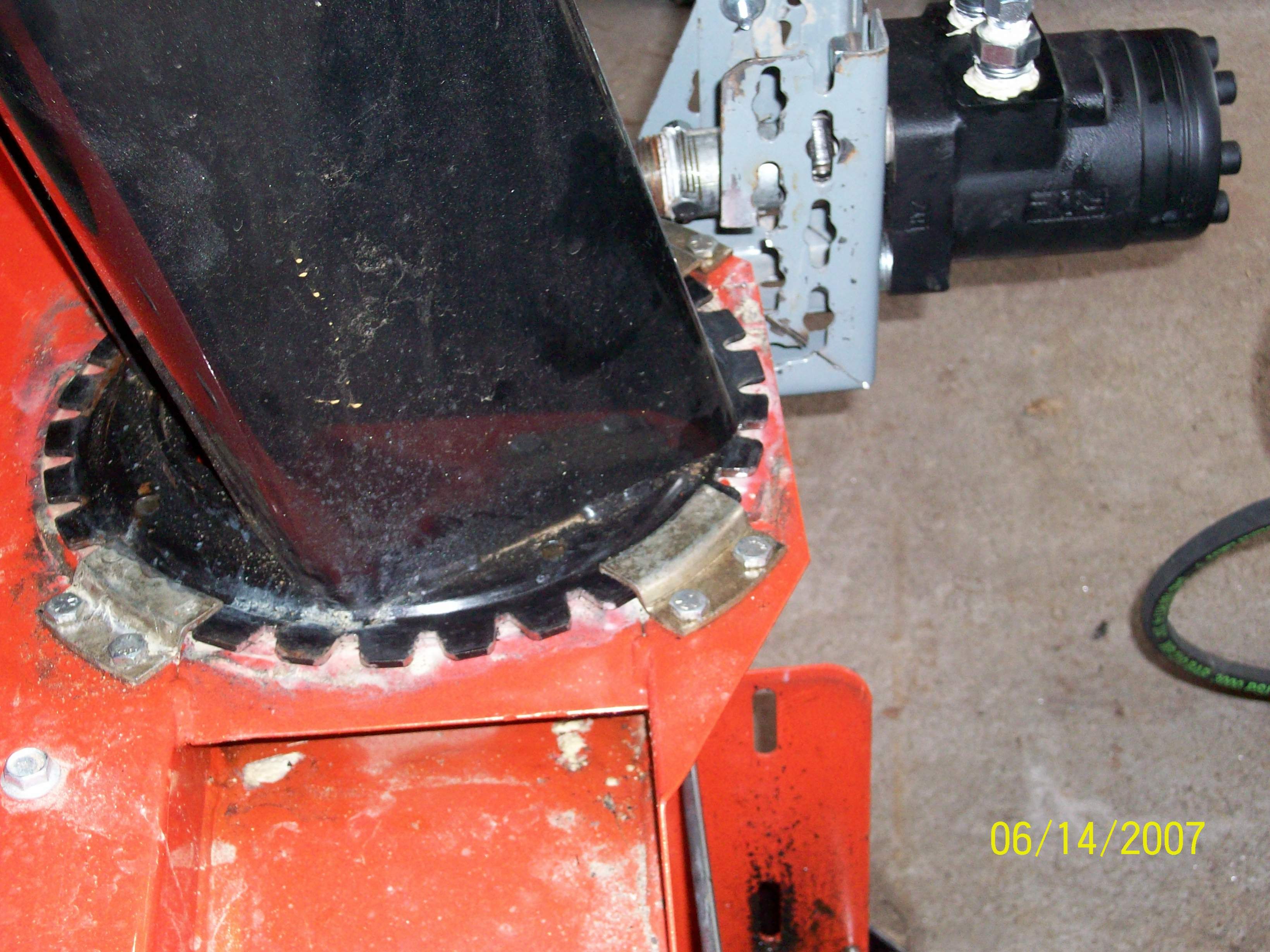

I built my own rotator this spring. I bought a hydraulic motor and a couple hoses and fittings on the internet, and built the framework with scraps I had. It uses the hydraulic connections for the bucket, and I connected the motor to the existing hand-crank mechanism, minus the shaft. It cost me $200, and wasn't that big a deal to do; it has worked great so far.

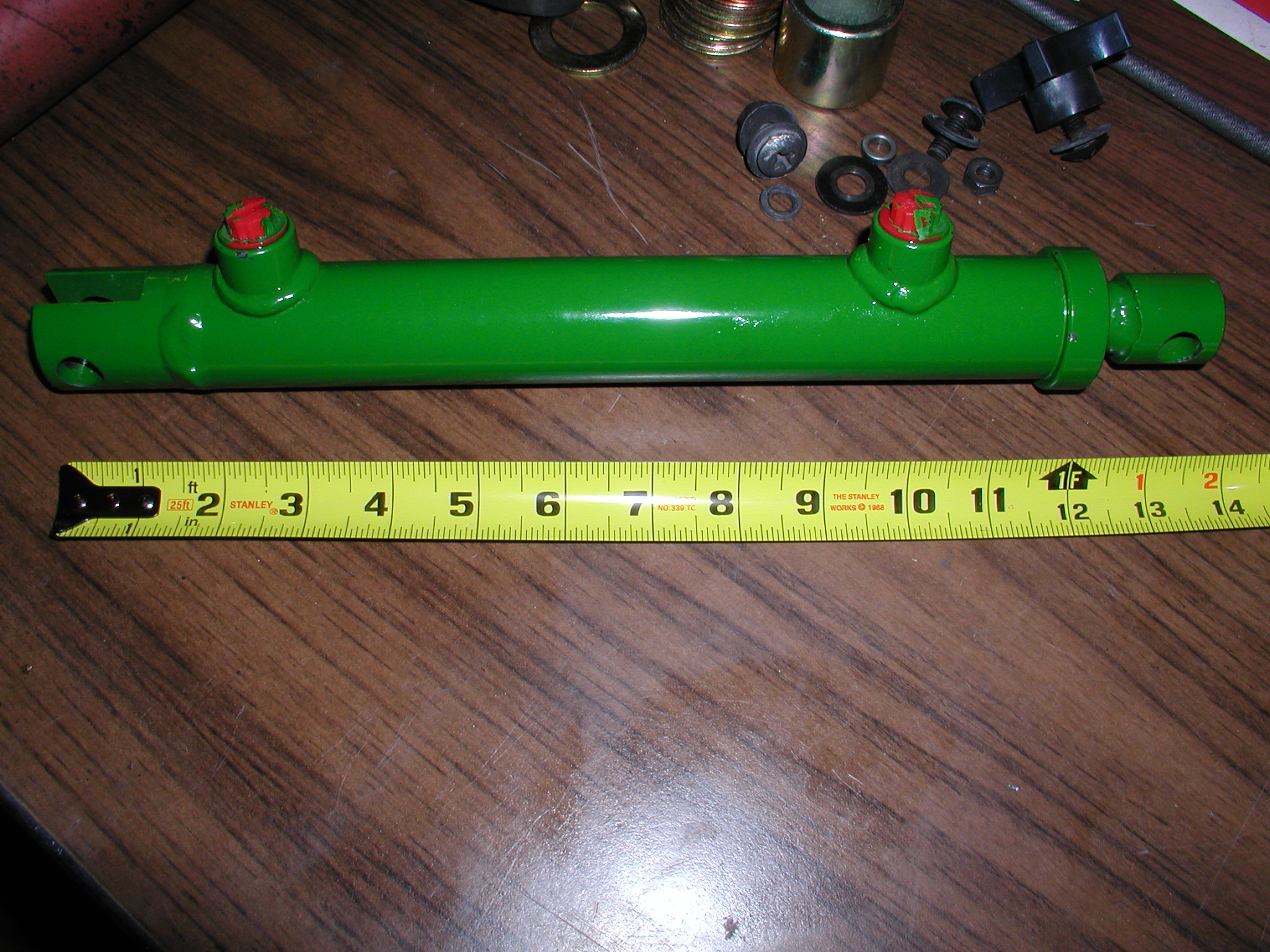

Well i kinda got delayed and side tracked. Dang work gets in the way everytime. Well i got the rotator arm installed and everything installed today. i used a 11" stroke 1" bore cylinder i got for 25 bucks. So i mocked up everything and test fitted it all up and it worked good. So i totaled it all up and im into it for about 100 bucks. But i think its worth it. I had the steel for the mount so it was free(bought a pile of good scrap for 40 bucks at a auction with lots of good stuff. Ill have to get some pictures up tommorow once i find my camera.

Here's my version I put together close to 20 years ago using a surplus cylinder and steel and cables I had lying around. The only parts I had to buy were the 2 pulleys and the hoses.
It has always worked great. On my previous tractor, I could rotate it well over 210*, but I had to reduce the rotation for the B7800 or the chute would hit the cab when the blower was raised. I did that by changing the pulley spacing.
The cable is a little sloppy now since I bent the cross bar the pulleys are mounted on by trying to rotate the chute when it was frozen up.:( (Snow had melted, water ran down to base of chute and froze chute to blower body.)
