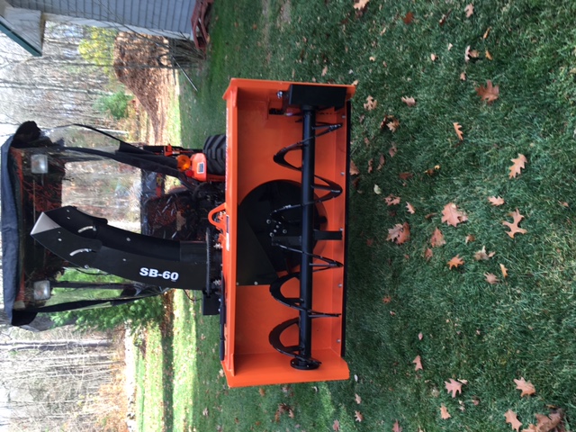

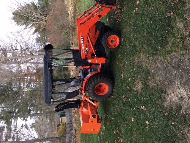

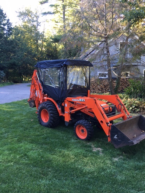

I used my FEL (also not removable) and a 6' rear blade for the last 15 years, and have been looking for a decent used PTO blower for last 3-4 years, but they all wanted $1500 for rusted/well used, to $2K for decent shape machines.
So I ended up ordering a Woodmaxx after reading reviews here, and looking into how they are built - they are very HD units, the 60" weighs 700 pounds, and are $2250 delivered with manual chute. I bit the bullet and got the electric option.
It's more blower than my B21 HP wise, but I will go slow instead - the driveway isn't long, but I do about 600' of clearing 200' driveway and the banks are the issue and if more than 12" I was using the walk behind SB following up with the tractor and blade.
The Woodmaxx in my opinion is about the best value for $ out there for a new unit. Oh, an added bonus is the steel frame they ship in I made a dolly for my BH and a dolly for the SB too for $50 of 4" casters! So roll the dolly under the BH and roll it off into the corner!
Carl
