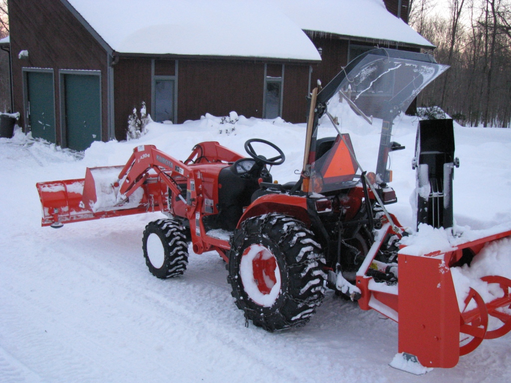

I have a 54" rear mount blower for my B7500 that works fine for my purposes .... BUT ..... I don't have the backhoe swap to deal with so my 3pt hitch is always available. I usually mount it about Halloween and leave it on attached until late April.
The nice part about a blower is that you don't have snow piles to deal with. The disadvantage to a 3pt blower is have to do the snow clearing in reverse.
