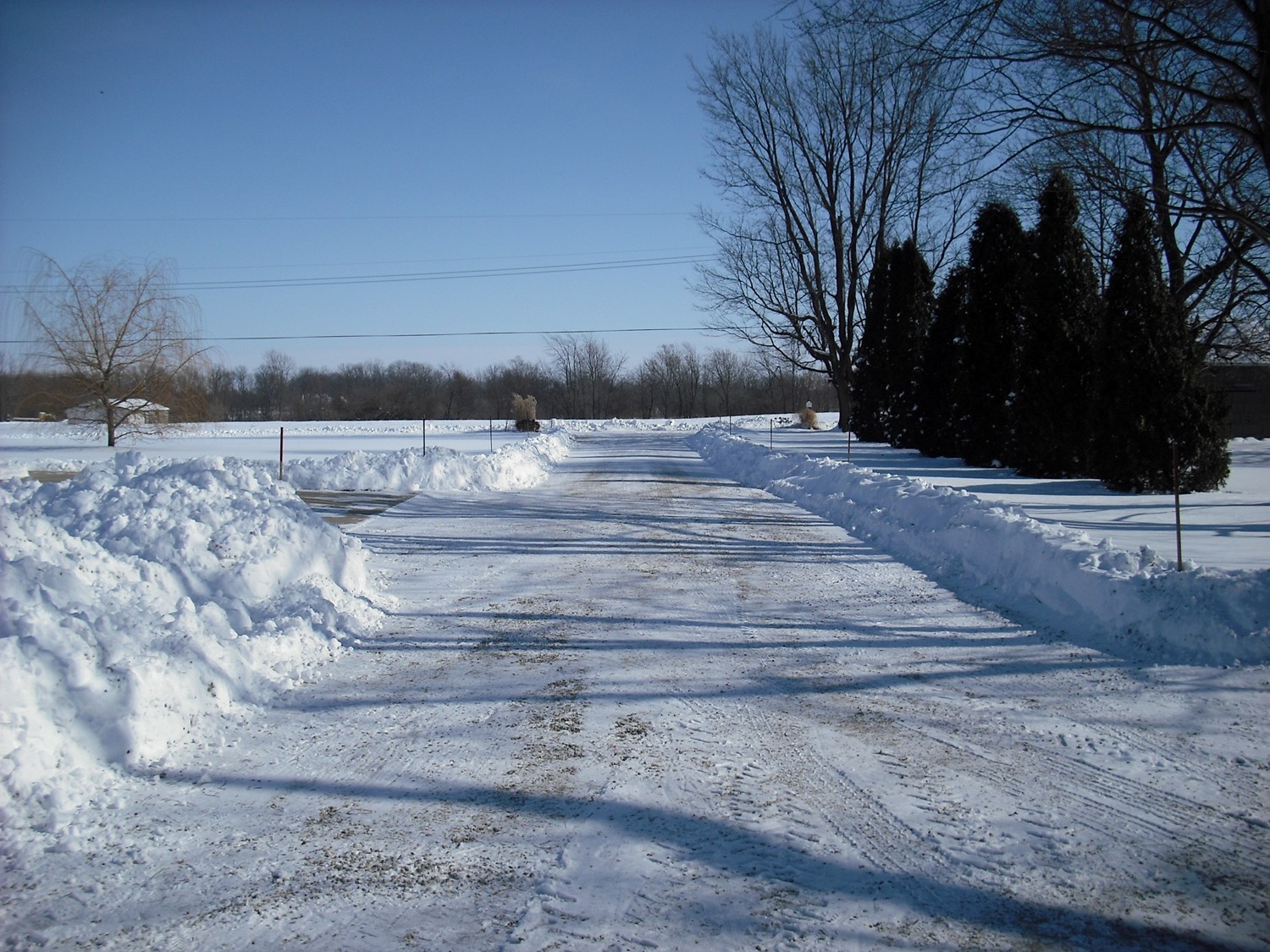

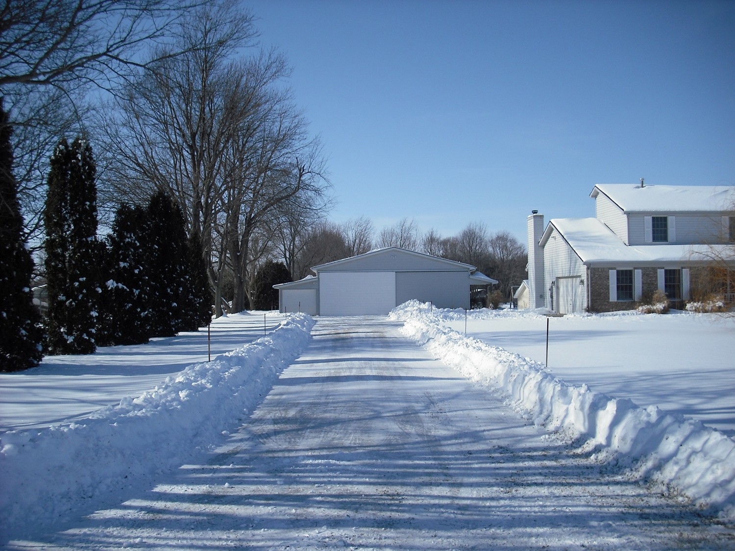

Like stated before it depends on the type of snow, surface you are plowing, type of tractor, weight of tractor, tires, ect, ect, ect. No real answer to the question. Another good question is where do you live? High elevations and cold areas like the Dakotas have snow that is very dry as compared to the snow on the mid-west like Kansas or even the eastern coast like New York or Jersey where the snow is usually very wet and heavy.
For example the last week we got 14" of snow and the guys with R4's did ok until today and it got upto about 45 deg. Last night though it was in the 20's with 35mph winds so major drifts to clean up. The guy down the road with a 35HP JD was having problems due to the wetness of the snow while my 28HP Jinma did not have nearly as much trouble. I have a FEL with a 5' bucket and a 7' Woods HD Rear Blade. My tractor also weighs about 5,200# with me on it so its a heavy little machine.
Here is a pic of my drive today, it was completely covered with 24" of drifted snow this morning. 4 passes and 5 minutes with the loader and I had all 280' of it opened 20' wide.
