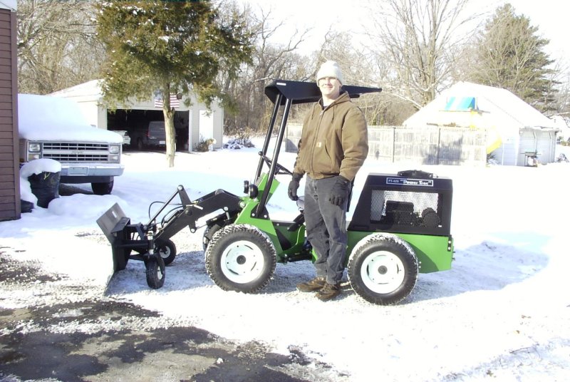

I bet this could move some snow.

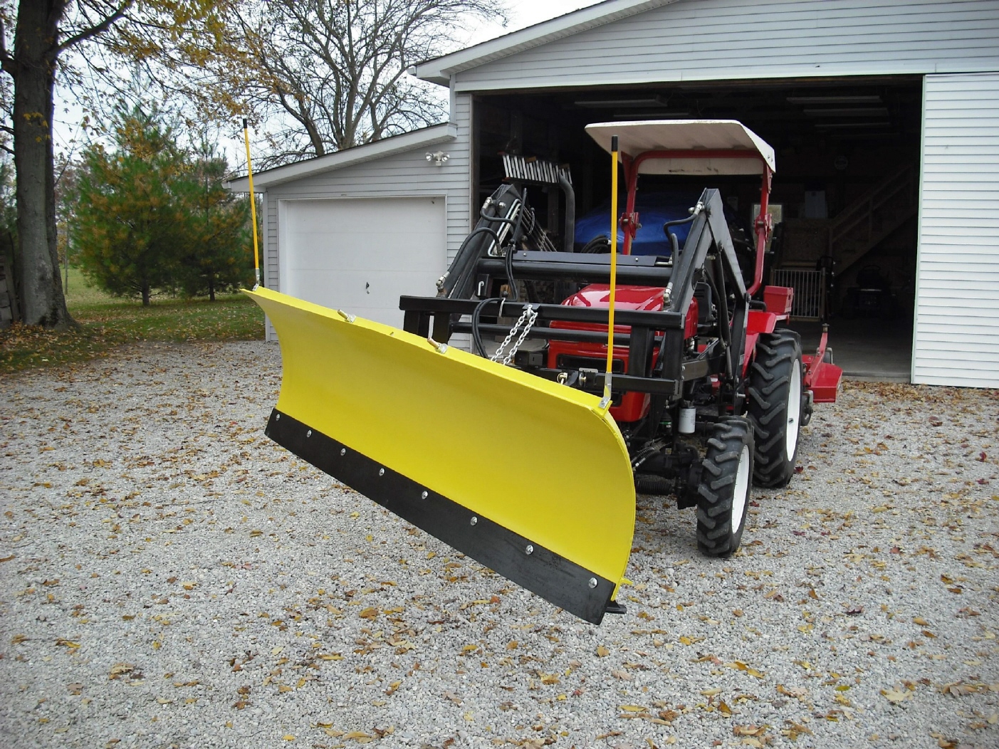

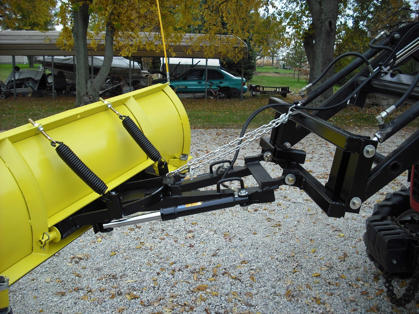

Here is what I use. Just rebuilt it this year. Used it last year as a piece of junk that the angle cylinders did not even work on. Just pined it to the right angle.

DP,
You might consider adding a hydraulic pressure-relief valve block into your system to eliminate pressure spikes from striking objects harder than snow, etc.

What a great idea. :cool:

Nice setup. I love my power angle and tilt plow on my FEL arms. Works great! :)
