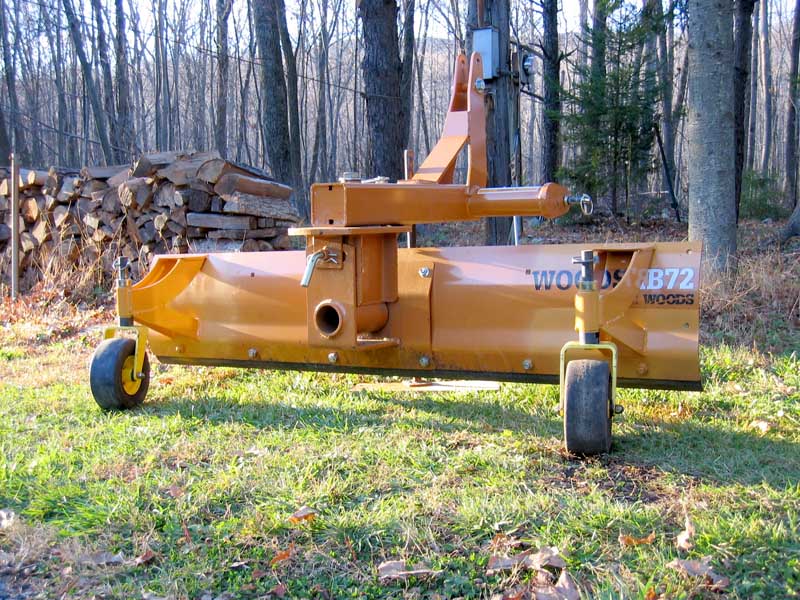

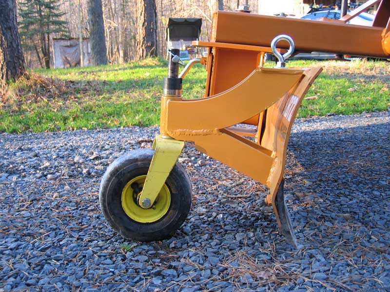

After hours of web-surfing, I have found what I think would work:
These were posted on this forum 12 years ago by a member who has not posted since March 2017. I have PM'd him but don't expect a reply.
This setup appears to be heavy duty - enough to handle the weight of the blade and FEL on float. But it is NOT a Woods accessory (per their tech support).
The curvature of the brackets seems way too precise (i.e. engineered) to simply be someone's fabrication. So, I am guessing that this is someone's accessory...but whose?
Does anyone recognize this assembly?

There’s another thread on here that discussed the use of trailer jacks as gauge wheels for a rear blade and the general consensus was they’re not strong enough, have skinny wheels with little floatation so would dig into soft surfaces, and the bearings would get easily contaminated. More robust Bush hog tail wheels or zero turn casters would work better.

I have been looking at bush hog tail wheels as they look quite stout. They tend to come in either 1-1/4" or 1-1/2" shafts. The skid shoe brackets on either side of my blade take a 1" shaft. It would be great if I could re-use these skid shoe brackets - item 13 in the picture.
If I was to test the effectiveness of these tail wheels, I would either need to weld on 1-1/4" or 1-1/2" skid shoe bracket or have a machine shop grind these shafts down to 1". Not sure which would be more cost effective.
Actually #13 in picture is linch pin... Do you mean bracket above #18 shim stack...
Dale
Yes - sorry. The actual bracket itself was not referenced so I pointed to #13 to direct you to the right area.
I have spoken with several tailwheel manufacturers and all expressed concerns about the tailwheels being able to handle 2,500 lbs of weight.
I am beginning to focus on a "softer" blade...either wood as previously mentioned or rubber (horse mats or these...Rubber Snowplow Cutting Edge 725 PSI).
