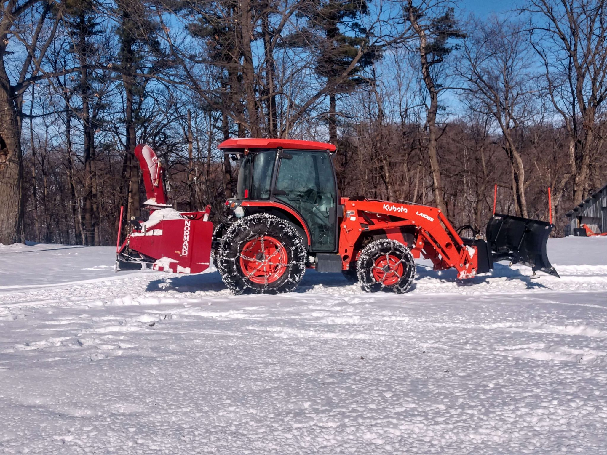

96" hydraulic angle blade on the front. The skid shoes do a good job of not letting it scape gravel...if I have the tilt, right.

For me, the first snow usually falls before the ground is frozen and the shoes just dig trenches while the blade pushes rocks.
