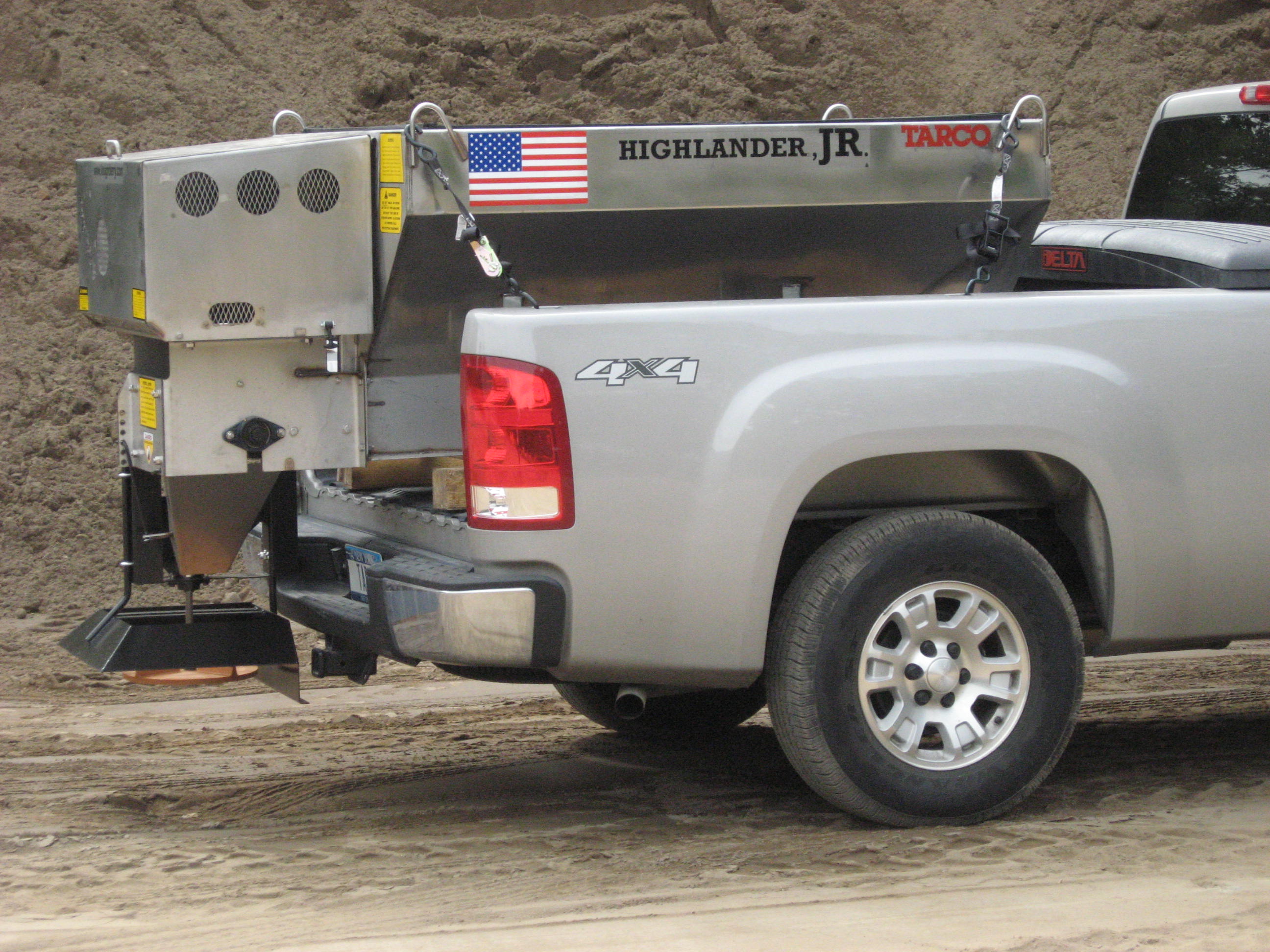

I use a conventional sand salt spreader;
like this one;
It works quite well.
I very seldom fill it till just before I load and use it.
I get it started and running to give it a visual once over,
then shutdown and load it.
When it's loaded and sits even just overnight the sand seems to settle and make it harder to get started unloading.
Also even with salt mixed in at times it can freeze into a big lump.
I am in the process of getting a trailer set up for my sander,
with tire chains and a brake controller otherwise with a yard of wet sand being 3300 pounds,
there is too much of a possibility of it trying to push or pass the tractor going down my driveway.
I've been using it on a truck but the cost of keeping insurance on the truck and keeping it in
decent running condition for 50-60 miles a year is ridiculous.
