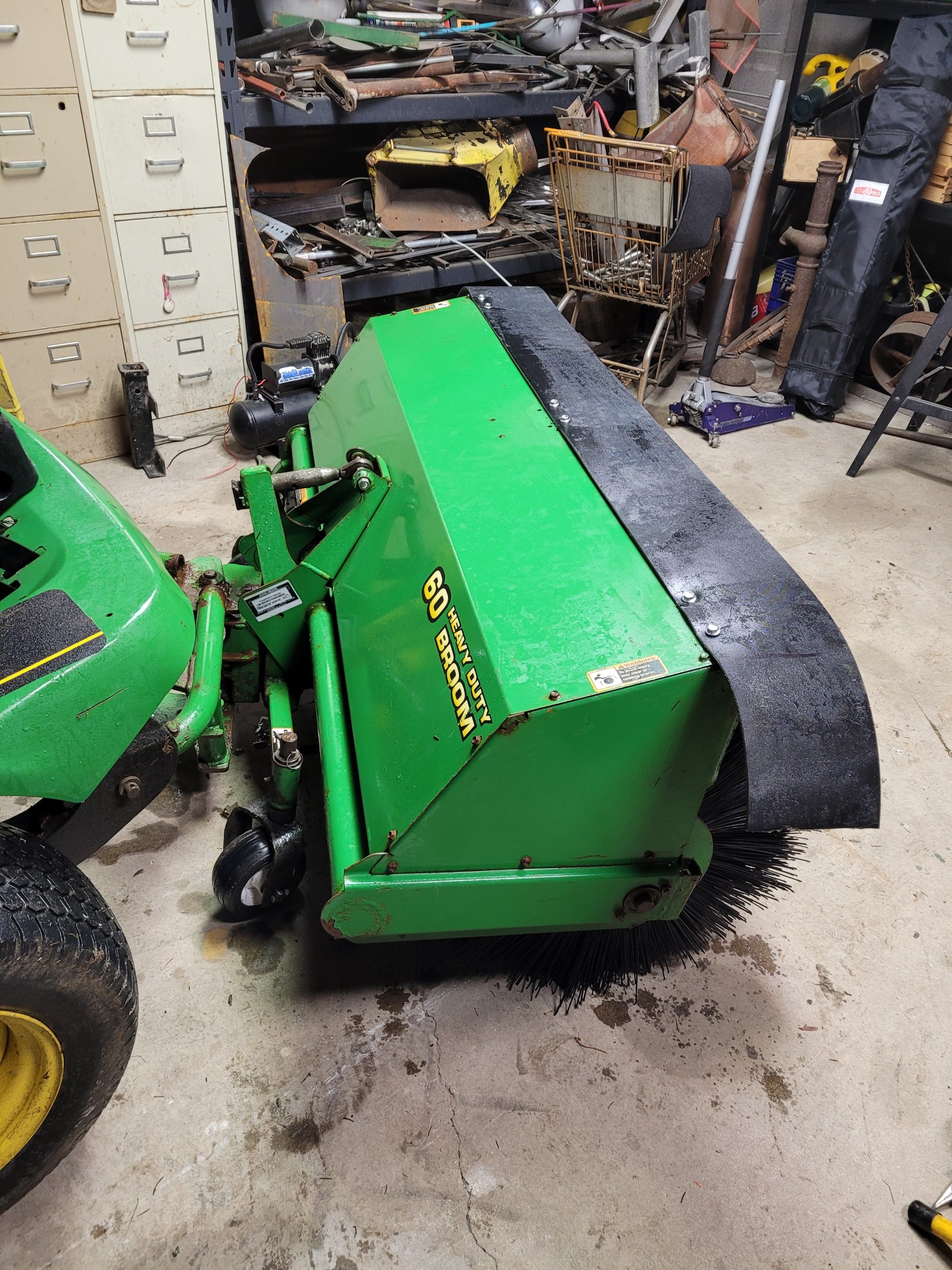

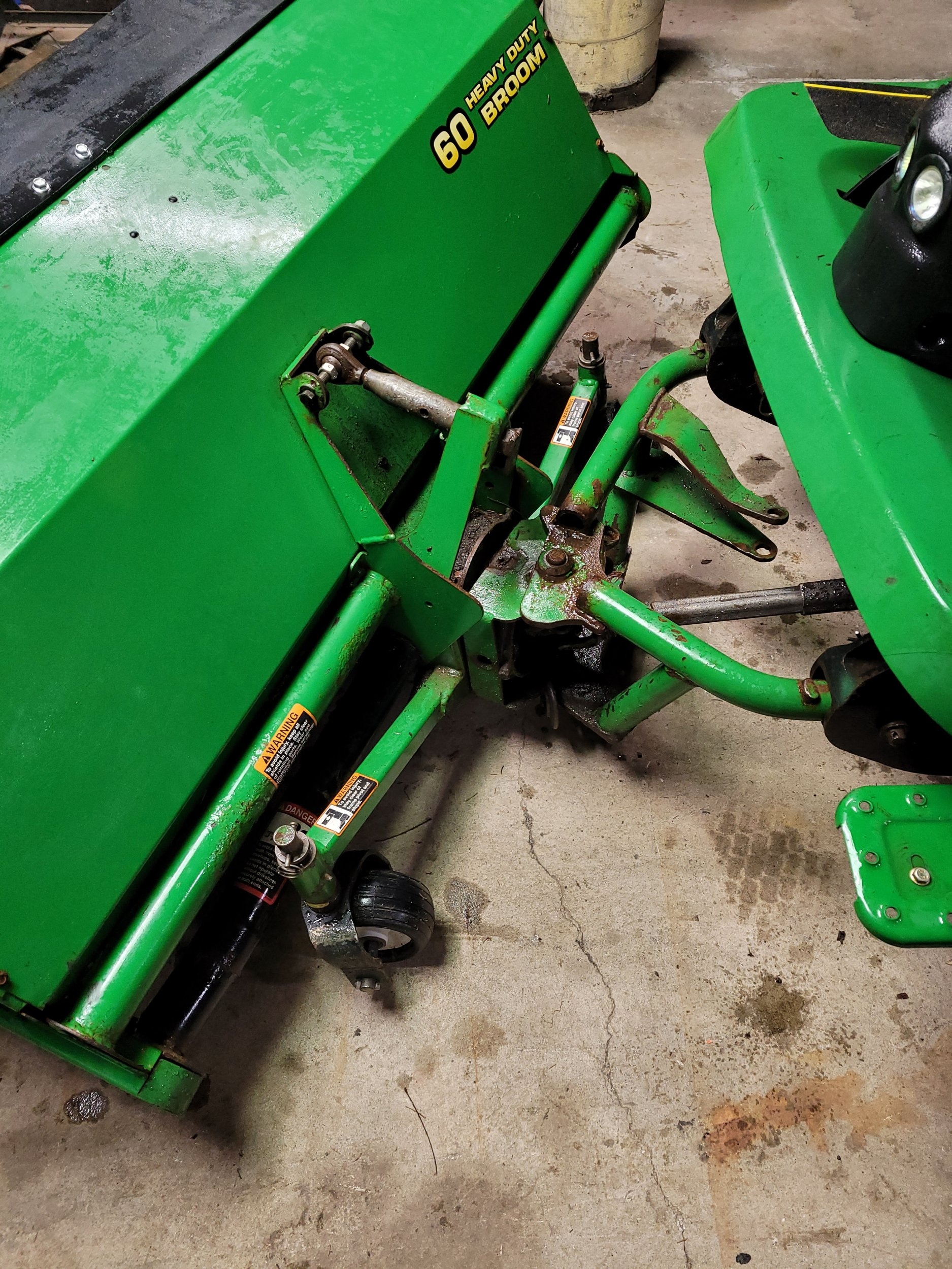

I just started using a 60" brush on my JD 1435 'mower'. I've tried a snow blower (too slow), On my JD1070, I made a QA loader frame to attach a 7-1/2' Western truck plow. To use it effectively you need a 3rd function for angle. I chose an electric push button switcher to set it. By far this is the best & fasted. My 800' concrete driveway is done in 2 passes and the engine hasn't even warmed up when I'm finished. I added a thick commercial truck plow rubber (not plastic) wiper at the edge to squeegee the concrete and it then dries fast. I'm also tempted to do the rest of my dirt road just because it goes so fast. I can run in high range & high gear.
Today I tried out the broom and it works great too in slushy snow under 4-6". The concrete looks brand new after a brushing. But i'm not going near the dirt/gravel road with it. The broom works year 'round for dirt, leaves, pine needles, snow, and dog toys.

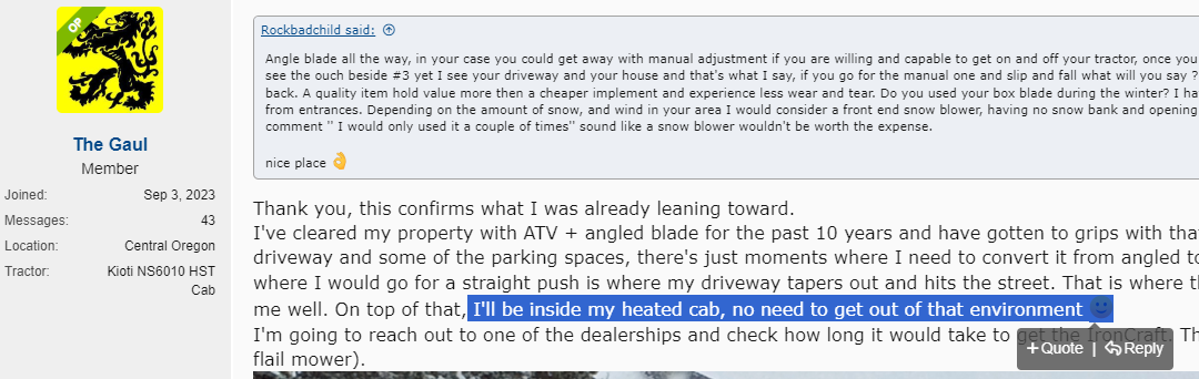

Do you have a cab on your Kioti? If yes I'd go with an inverted rear pull blower or a front blower. Move the snow once and be done with it. No damage to driveway. Plowing 4-6" is easy. Gets harder at 12-18". A blower on a big tractor like you have should have no problem. How much snow do you get per storm?

Yes, I do. I would say we get about 5" per storm, rather dry snow. The key is to get out and remove it before it has time to partially melt and then freeze over. Most of the contractors around here seem to use blades, some of them on skid steers. Snow pushers is more of a parking lot clean up thing around here.
Interesting, do you have a picture of your set-up ?

Broom pics.
BTW: Take a look at YouTube videos of front mounted rotary brooms used to clear snow.
