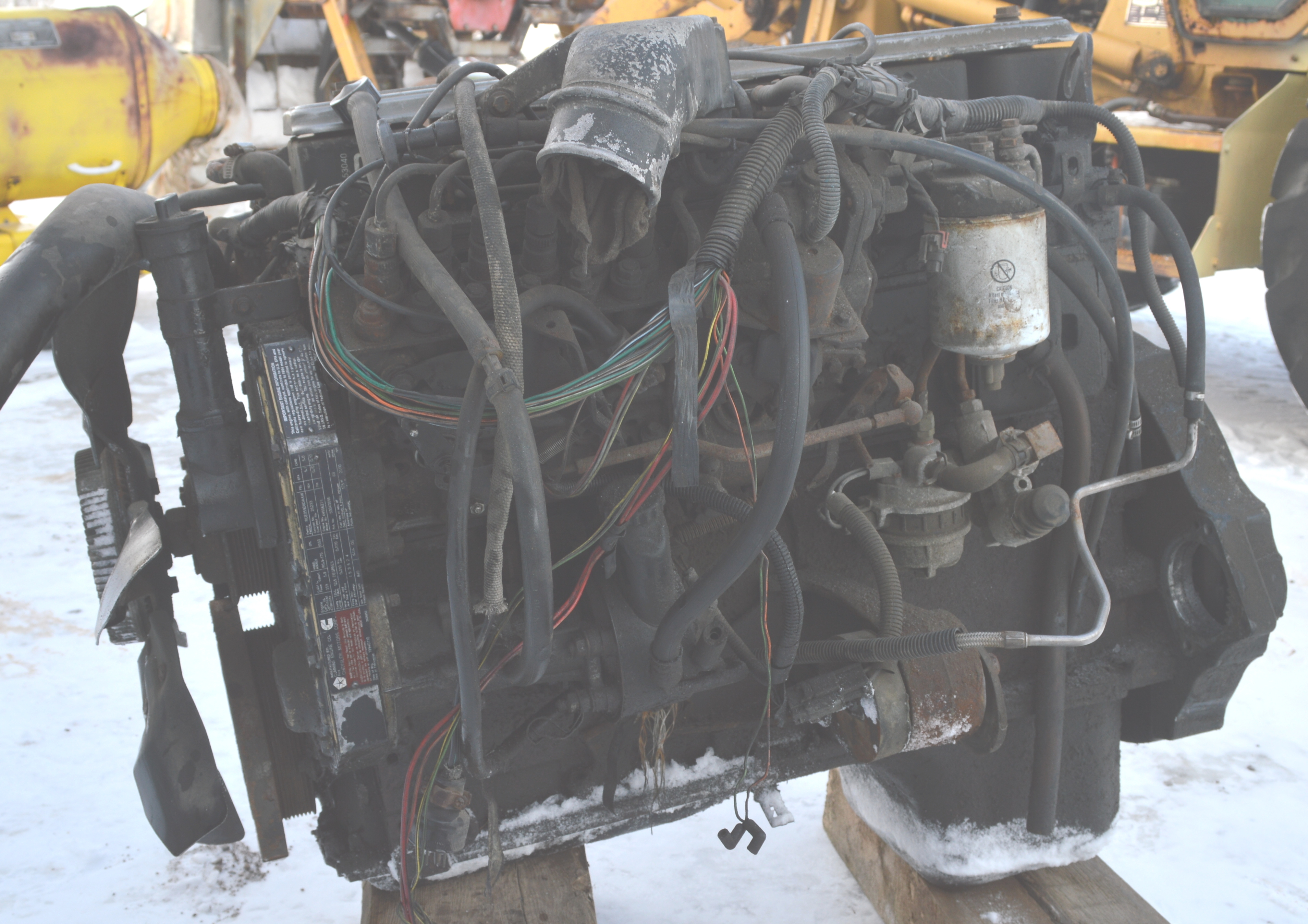

I bagged the engine yesterday, it's the 175hp version with 138 kiloclicks on it made for clutch-jobs. Apparently the automatics couldn't take 175 so their engines were detuned to 160. Sounds like a stretch but that's what the vendor told me. I would have thought he opposite, that since automatics are gentle on the piston rods you can turn more horses lose with them. Anyway, this part of the puzzle is solved, I'm very happy that I dumped the duramax idea. This thing will start with a booster cable and will never again know if there's a battery connected to it or not. ALL engines should be made like this :)
I will check to see if killer dowel pin is modded, then just test it as is.
I can vouch for the detuned engines on the early 2nd gen Dodges. I had a '95 with the auto. Corrected that with a '98 5-speed.
Did YOU notice a significant power increase from 160 to either 215 or 235?
As far as my use of a transmission might become a factor, that'll be if and when I morphe the machine into a truck hosted one, and then I would rather use an automatic with a transfer case which would give me some usable outshaft rpm options. A standard would give me those options too but if my wife clears the snow then a nice linear auto selector N-1-2/4Lo1-2 sortof thing would be much more practical. What I don't understand is why the engine needs to be throttled or derated when there are automatics handling 500hp. This one is over my head, what auto and tx-case could I use in such an eventuality after raising the HP to maybe 230-250?
There was absolutely a noticeable increase in power. A friend bought a '97 5-speed and that truck would run away from my '95 on big hills. My '98 that replaced the '95 pulled the same trailers better too. I know the later Dodges weren't derated with the automatics but I don't know what year or transmissions those were. Those RE transmissions are going to put you back into having to deal with electronic controls. They put Allison transmissions behind those engines in Ford's F750 trucks but I think those are also electronic controlled but would be another option. Those engines were in a lot of construction applications so there are probably other options too.
The aftermarket builders did a good job beefing up the Dodge autos so any of them could be made to work for you. I'm not sure what all was done to beef them up but I think the torque converters and clutch pressures were improved. I think some of the reasons Dodge derated the first years autos was because of the torquey characteristic and the low rpm that the Cummins makes that torque at was a challenge to make an auto live with. The v8s were a little smoother and made their power at higher rpms so it was a little easier for Ford and GM autos to cope with.
