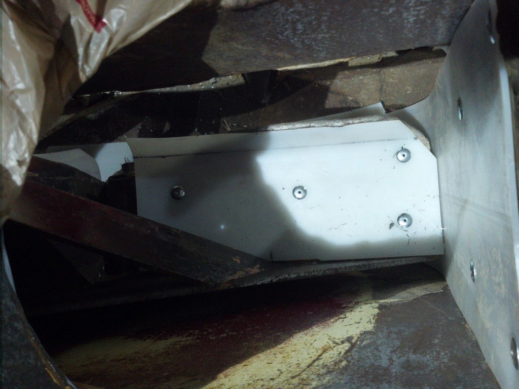

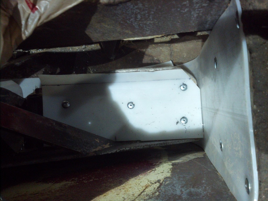

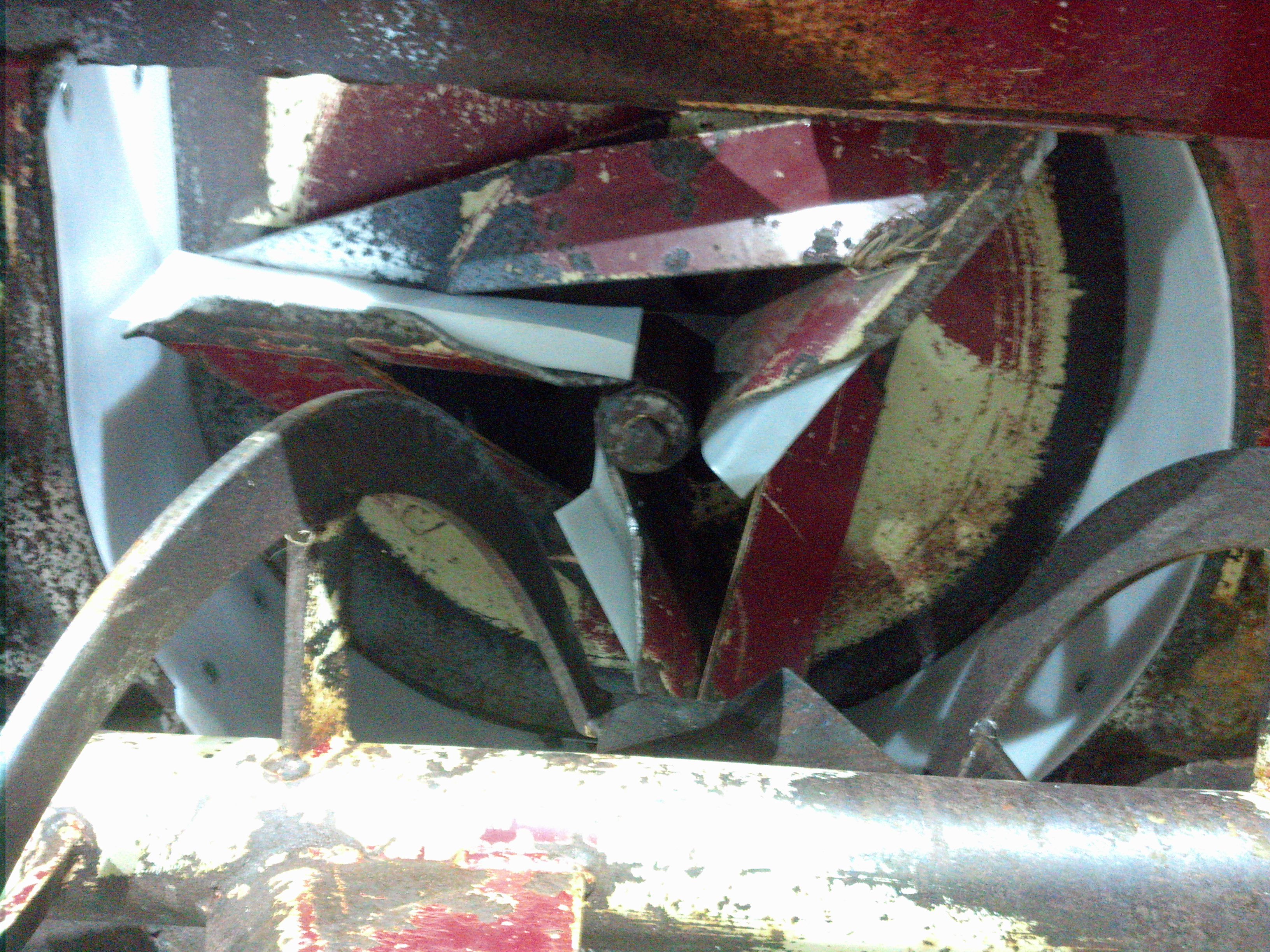

What is your current blower fan RPM? If you are using what used to be a 540RPM PTO blower, I would aim for 600-800RPM on the blower.
How much clearance is there between the fan and the outside of the fan housing? If there is more than 1/4", I would add HDPE sheets to close up the tolerances on the fan to the point where it will pickup a dime that you set in the bottom of the fan.
Here is what I did on our 7' Loftness blower (which runs on the front of the tractor from the rear PTO via a pair of gearboxes and a long PTO shaft):
View attachment 496602 View attachment 496603 View attachment 496604
At the closest point, the HDPE on the blower fins just brushes the HDPE that goes around the outside of the drum.
The other thing I would look into doing is to add a drum eject to your current snowblower such as this one ( http://www.tractorbynet.com/forums/snow-removal/332389-drum-eject-snow-blowers.html ):
They are supposed to be more efficient at throwing lots of snow out at the cost of only being able to blow it out to one side or the other.
Aaron Z
I've noticed those fan blade extenders myself, I made my own fan and I can make one again in any diameter, any depth any tolerance so aftermarket-like extensions would not be needed. The biggest part of ths is th eright steel AND getting out of town for balancing (that alone $300, they might double that for a 48"). and The present clearance is about 1/4" and I don't think I could easily build tighter than that with my tooling and resources, or want to for that matter. When ice forms in the bottom drum because I forgot topark it nos down and I have to break it up with a 10 pound sledgehammer then micro clearances and refined tip-decorations somehow fade in significance. The current rpm for my 36" fan is whatever I decide to give it but the engine being red-lined at 2700 I can't go much above 1000. This is already around limit (based on experience) for 36", but if for example I went to a smaller fan to save weight then I could increase it. Engine red-line is one limit, fan diameter another i.e. tip speed in mph above 100 starts becoming problematic AND more DANGEROUS.
/ Snow PUMP #24
I had almost 3/4" clearance in the bottom, so I needed it, but the HDPE also helps with letting the snow slide around the drum easier and off the paddles easier (which gives better throwing distance). With 1/4" clearance, you should be tight enough.
Do you have a drain hole in the back of the drum? Our Loftness has a ~1/4" hole in the back (just in front of the "back wall" of the drum) to let water drain out rather than freeze in the back.
