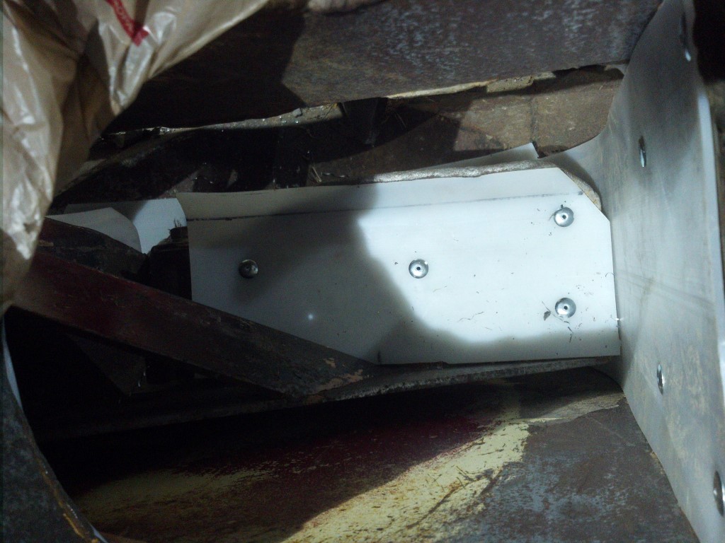

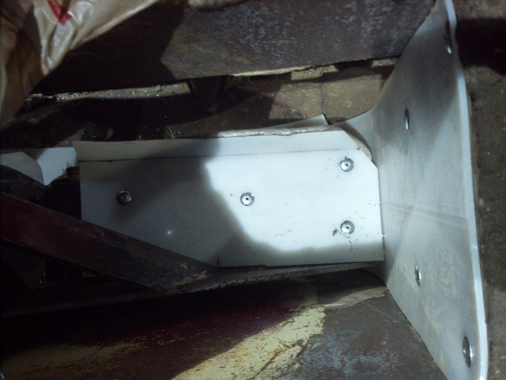

Just reading this all through for the first time. At least on this thread. Post #23 talked about balancing a fan assembly. I built a new fan for an IHC 80 snowblower using a Browning hub for the center as I knew it would tighten onto the shaft and still be easy to take off. It also made the fan easy to balance as all I had to do was take it to a tire shop and have them balance the fan on a tire balancer. The tire shop was so intrigued by what I had done they balanced the fan for free. I carefully cut and measured all my steel and made sure I used the same amount of welding rod on each "leg" of the fan and I only needed 1 ounce to balance the whole thing.
I would not be scared to use a 24 valve cummins. They are dead reliable as long as you don't let the fuel pressure into the injection fall below 5 psi. Put a chip in it and you'll easily get the hp you want. A 12 valve would work ok too. You just need to change the fuel plate. They are heavy though.
I'm enjoying this thread. I love building stuff like this.
