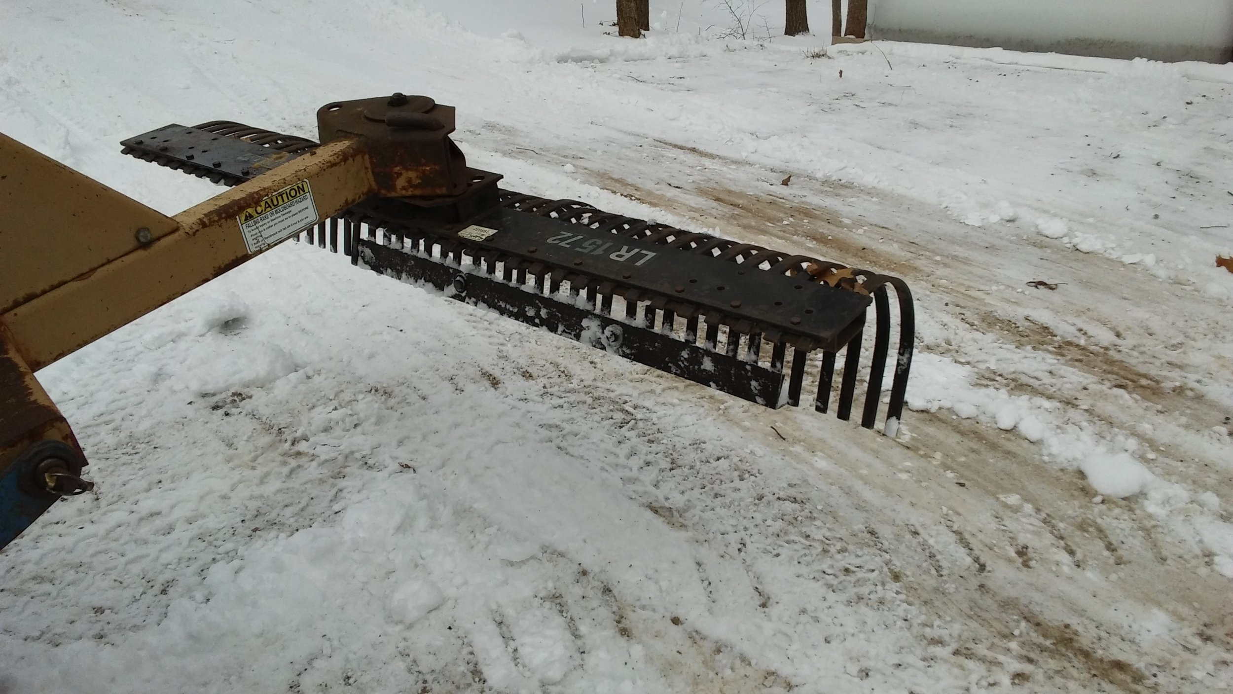

bought a used 7" landscape rake and added wheels. works great maintaining our gravel road and works well on snow removal as well
Easy to operate and no maintenance

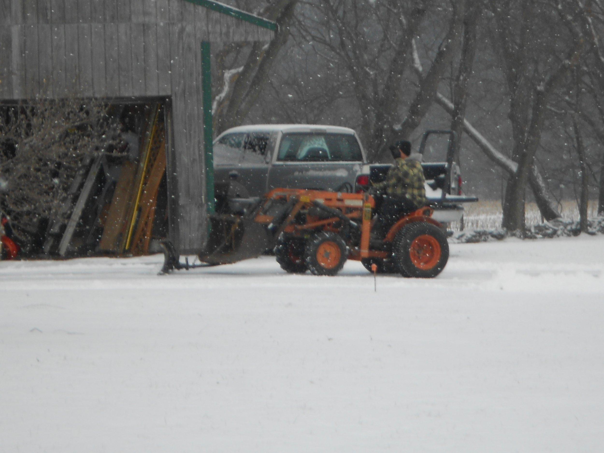

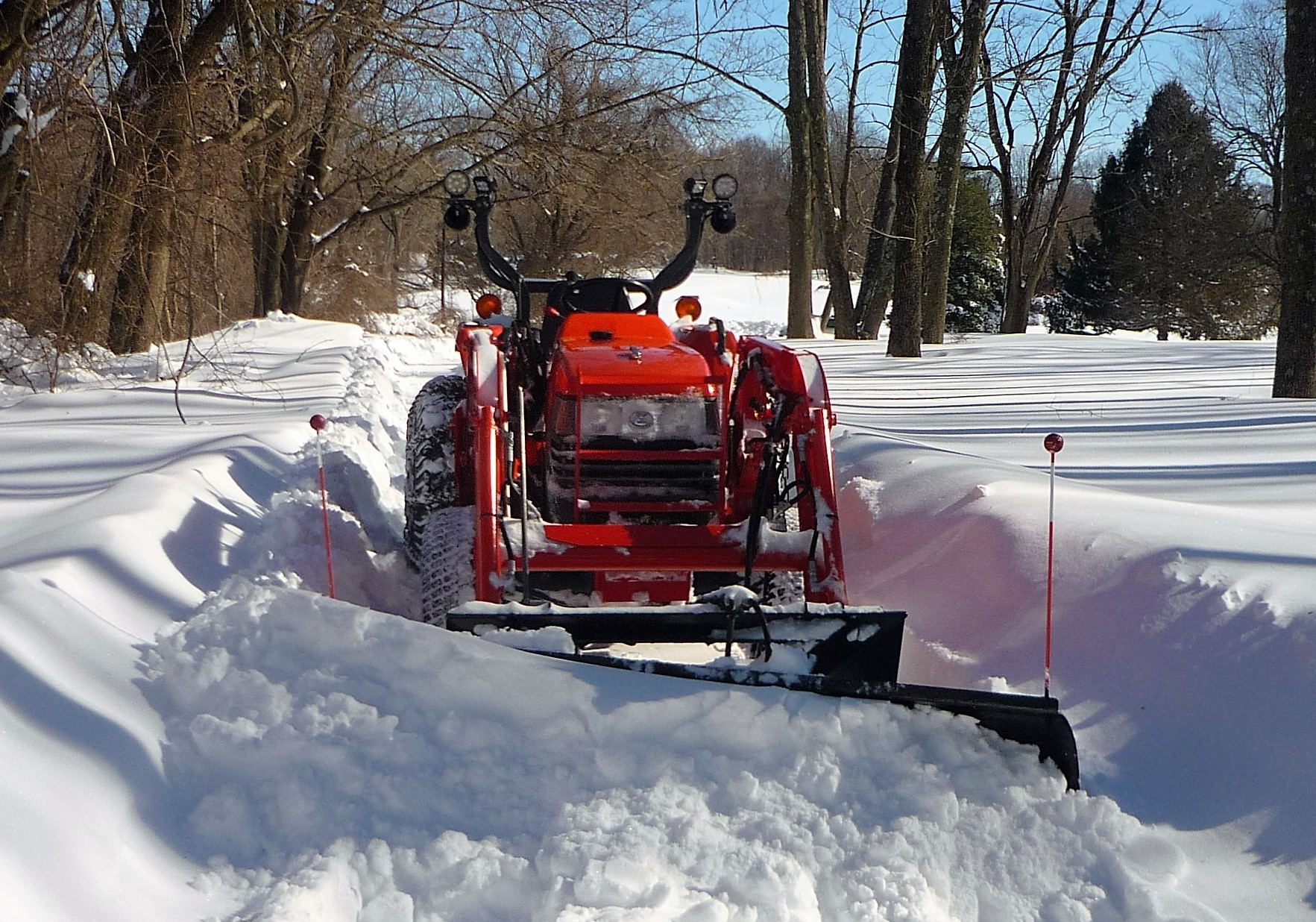

As you can see from my photo, I use a 78" HLA snow plow on my SSQA loader. I plowed a well-established gravel lane, about 1200' total, for years with it. Now, the lane is paved to our house, nobody lives beyond us, and best of all, the rich neighbor's groundskeeper runs his plow up to our house after it snows. Seems like the days of 30" snows are behind us, so I haven't even mounted the plow for 3-4 years, to clear our little drive and around the parking areas. But, the plow, with its shoes, didn't throw enough gravel to worry about. If the snow was really deep, I just plowed twice, first time half way down, then a finish pass. I found spreading the rear wheels 4" total helped with the tractor being pushed, and chains if things got really gnarly. A cab was the only thing I really lacked.

As you can see from my photo, I use a 78" HLA snow plow on my SSQA loader. I plowed a well-established gravel lane, about 1200' total, for years with it. Now, the lane is paved to our house, nobody lives beyond us, and best of all, the rich neighbor's groundskeeper runs his plow up to our house after it snows. Seems like the days of 30" snows are behind us, so I haven't even mounted the plow for 3-4 years, to clear our little drive and around the parking areas. But, the plow, with its shoes, didn't throw enough gravel to worry about. If the snow was really deep, I just plowed twice, first time half way down, then a finish pass. I found spreading the rear wheels 4" total helped with the tractor being pushed, and chains if things got really gnarly. A cab was the only thing I really lacked.View attachment 731742
Nice looking machine!

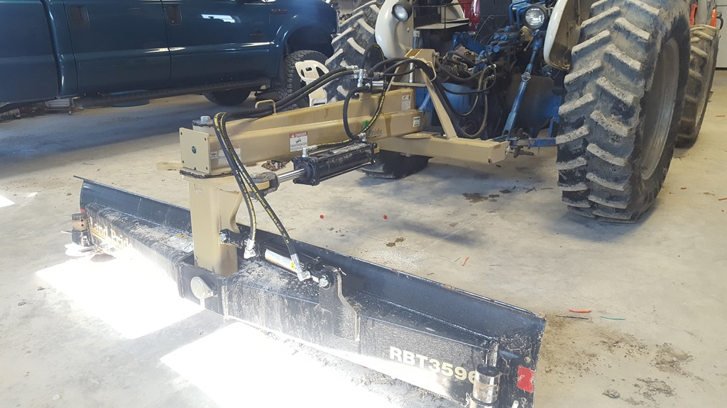

Buy a hydraulic angle rear blade. I paid $2,000 for this one. Has hydraulic angle and hydraulic tilt. I also have a hydraulic top link. Using a diverter valve to run 3 cylinders from 2 rear remotes. Has adjustable shoes to protect your gravel.

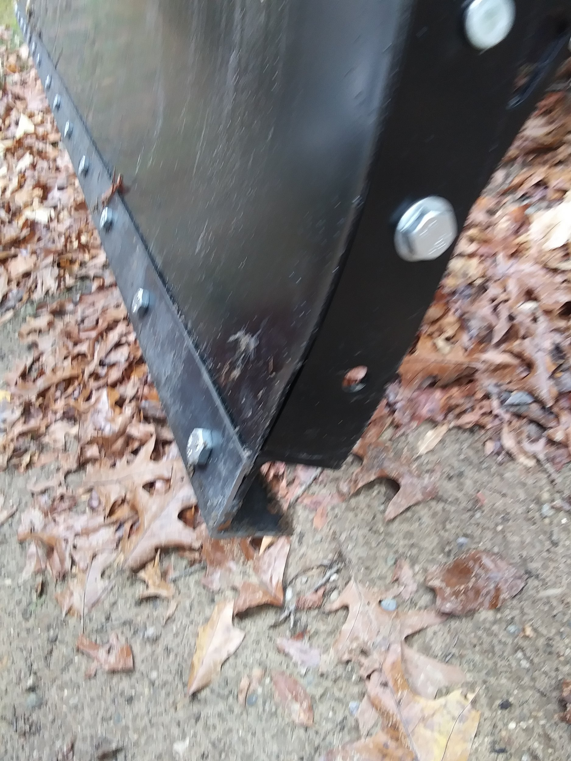

I do around a mile of private road & drive, all gravel.
The most heard complaint about plowing gravel is getting it into the grass.
I tried plow shoes, they just dug into the dirt as the ground isn't usually frozen the first couple and maybe the last couple times I have to plow.
PVC pipe was suggested, tried, it broke in cold weather.
Steel pipe is really hard to cut lengthwise and harder to attach.
Ended up using angle iron bolted to the cutting edge.
(In pic., bolted in place of cutting edge because holes were already there.)
Easy to attach & take off.
I can even plow paths in the yard with NO damage come spring.
2" x 1/8th" seems to be enough.
Works as well on front or back blades.
I even strap one on my york rake & use that to plow surprisingly well.
