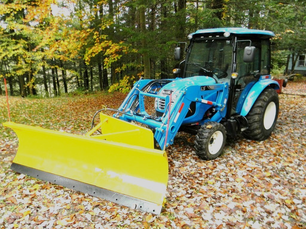

HLA Snow
This what I think is the best of both worlds.
I've worked for a municipality for 16 winters plowing roads and for a contractor plowing parking lots since then.
for the average person doing any stretch of road or driveway you need a plow. The pusher is for moving snow from here to there. The plow will windrow it off the side of your driveway. Think of it like the plow will just side shift it over one tractor width. You want the snow next to your road or drive not at the end of it. As someone said earlier the only place for a pusher is in a parking lot or at least a large area of asphalt.

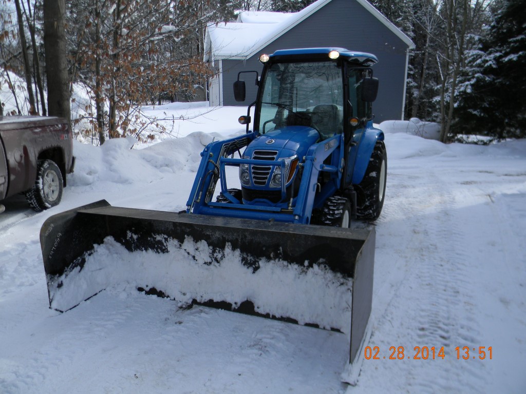

I have both a 7 ft plow and a 6 ft pusher, I also have a rear mounted blower all used with a TYM 453 cab tractor. This winter I have been using the pusher exclusively. The pusher is great for short runs around buildings and around my house, the best part about it is it does not tear up my lawn or driveway like the plow sometime does especially when the ground is not frozen. For long runs it is not as good as a power angle plow but being only 6 ft wide it does not bog down unless the snow is really deep, the trade off is I may have to make a few more passes but I will take it. When the snow is really deep I attack with it the 61/2 foot blower.
Bottom line for the pusher is if you have short runs and are plowing back snow over your lawn it works great.

I use an 8ft pusher and 86" snow blower. The blower works good but is slow and hard on fuel. The pusher is much faster and does a good job cleaning up. The blower is a must if you don't want high banks nearing the end of winter. I just added a back drag on the top of the pusher, should help cleaning up closer to any buildings and knocking down the high banks at driveway entrances.

You could do this and see for yourself if it works out for you. $40 is a cheap enough experiment. My bucket is 60" wide but this set up saved an hour off of a normally 3 hr snow plow job. I use a back blade for the long driveway parts and the blade acts like a bit of ballast. The rear scraper blade will not work in deep snow but a couple passes with the "pusher" gets it to where the back blade will do the job. A pusher gathers a lot of snow and as someone mentioned, a big pusher and a 4000 lb tractor may be nt a good mix in deep snow. A 22" snow storm did not stop the tractor once with the 60" pusher and saved from a third to half of he time with just the bucket depending on depth of snow event. I have an acre of "landing" area and the one 150' drive so a pusher works well for me.
If I had a long drive like a quarter mile or so, the snow plow wins the day.
