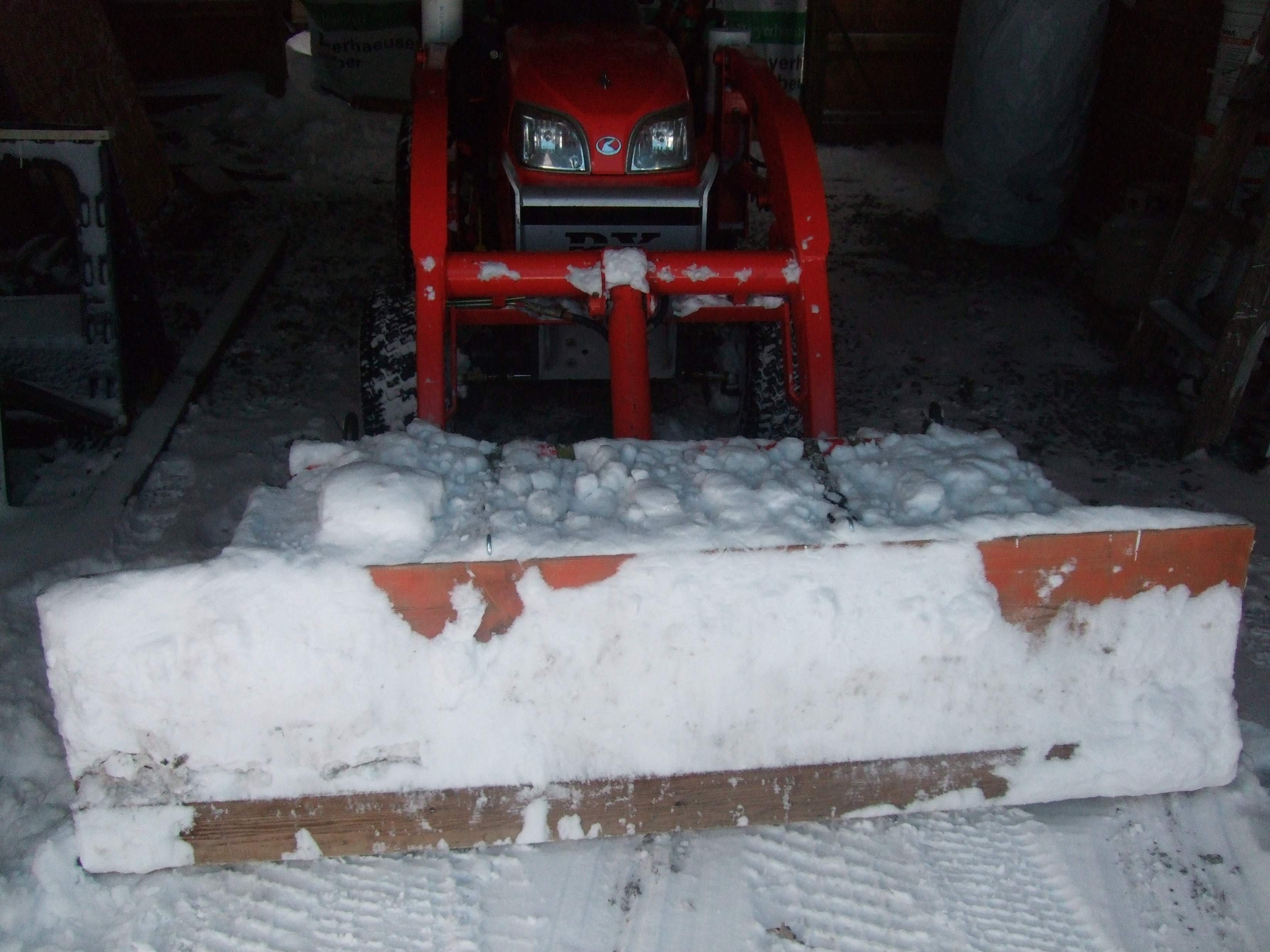

Well - I built a poorman's wooden snowpusher for my bucket on the kubota and used it for nearly 2 seasons. It works better then having bucket alone. It protected the driveway, and cleared more snow in a hurry. The way I made it was easy on and easy off and held by cheapo straps. The onloy drawback was it stops my kubota with wet snow and it only pushed straight ahead. I recently acquired a truck plow and took A frame off and mounted it directly to the FEL arms and it worked better then the wooden snowpusher, but the drawback was it acted liked a dozer blade so the lawn can suffer if I am not careful. I was able to move more snow and heavier snow since it rolls the snow. This summer I recently finished modifying the A frame to the FEL arms so I can angle the blade this time and this winter will be a good test for it. I suspect that since your koiti is nearly twice the size in wieght and power, you proabably could make it work with a pusher, but I suspect you would be happier with a real angled plow since you probably clear more snow then me ;).

RadioMan, any pictures of the pushers you mentioned? especially the wooden one, be interesting to see.
you asked- you shall receive. FYI - this is a very old pic that many tbn'ers proabably saw already. Its halfway covered with snow from being used. :rolleyes:
Anyway- I still have it and its just sitting waiting to be used again or taken apart for firewood. It didnt take me long to make it, probably a few hours and some screws.
very ingenious RadioMan. and if it didn't work all that well it is still pretty inexpensive to construct. long time ago when I actually had a concrete driveway I used a scrape piece of maybe 4X3 1/2 inch plywood as a snow pusher for those little 2 inch snowfalls. made quick work of cleaning the short drive. I had to keep it pretty clean as it was on the North side of house and had a pretty good incline. so it didn't melt well and if iced up made it a little harder to get up the drive.

Looks to me like you cut a 45 gallon drum in half to make your snowblade....very good idea....Ampa.........:)
