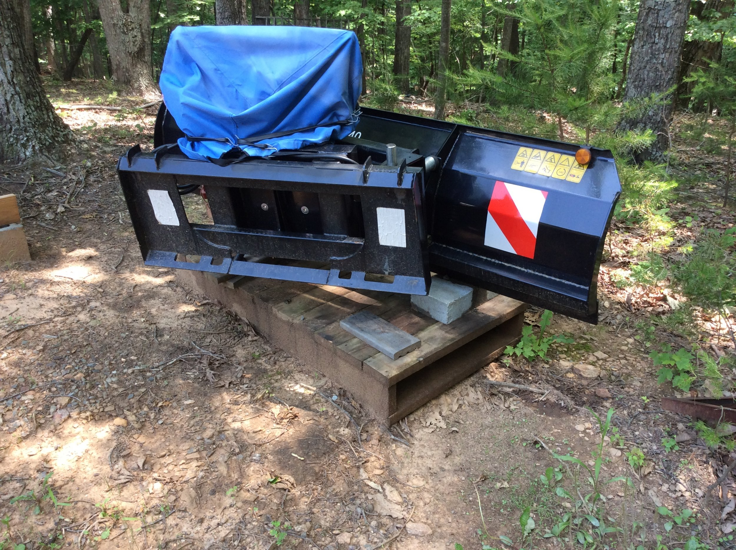

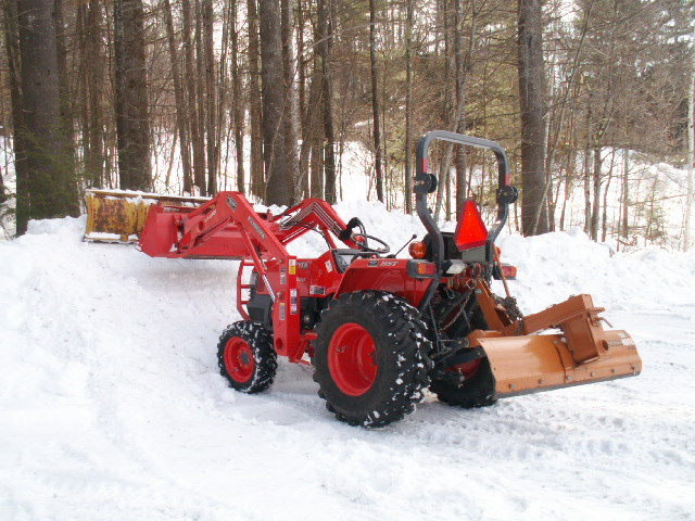

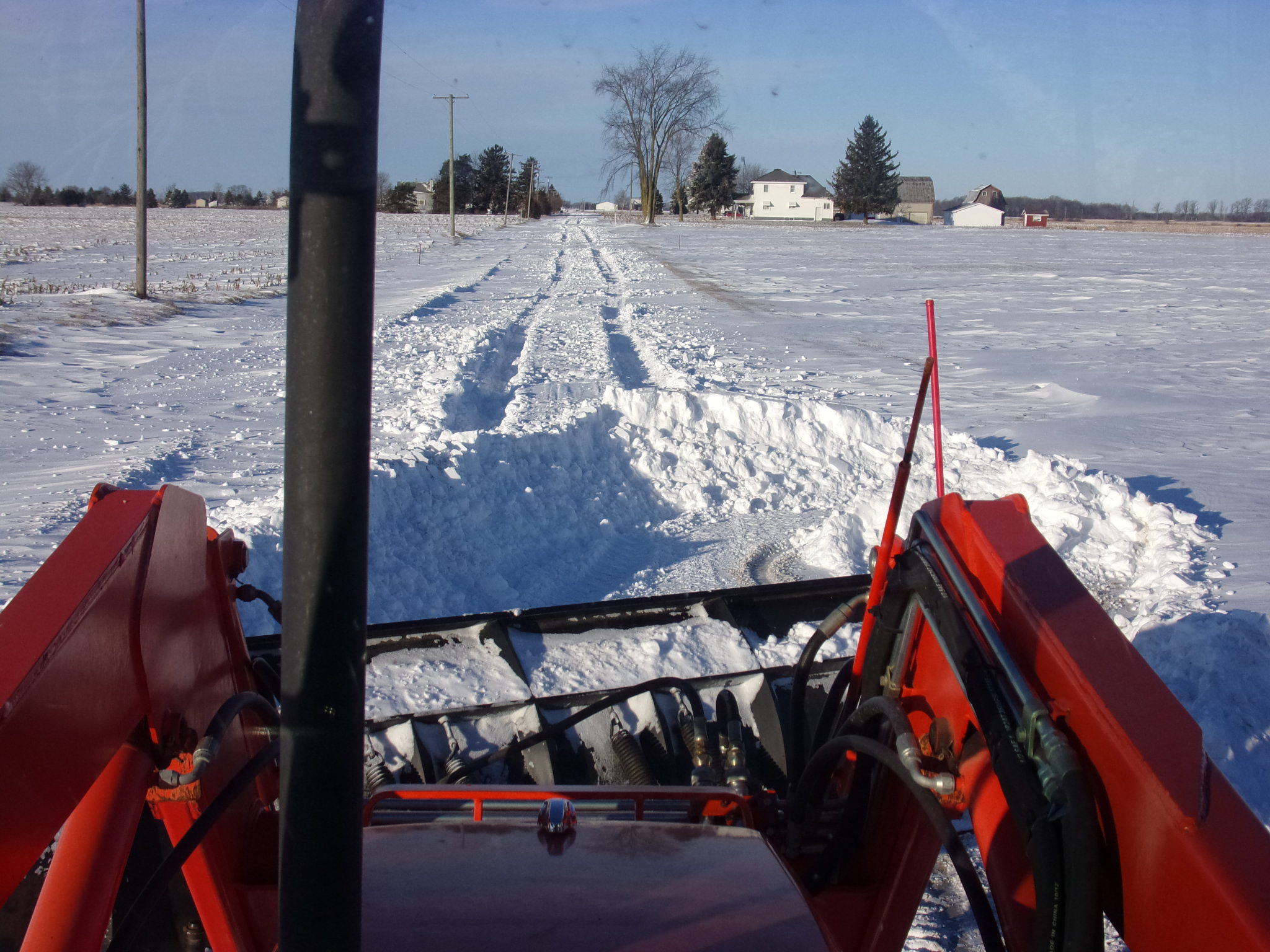

I have an old Meyer plow I converted to SSQA and use it on my tractor. Works great. The heavier the tractor the better it will plow. Mine is setup with a chain lift which allows the plow to float independently from the loader. View attachment 750681
Similar to BoylermanCT, my old half-ton plow is mounted with two receivers on the bottom of the bucket (just two pins to secure). These receivers allow the plow to move up and down considerably. Then a chain is used to allow the plow to hang with just the weight of the plow when touching the ground. This prevents the additional down pressure of the loader arms. I tried securing the plow with a solid link instead of the chain and the down pressure is way too high.

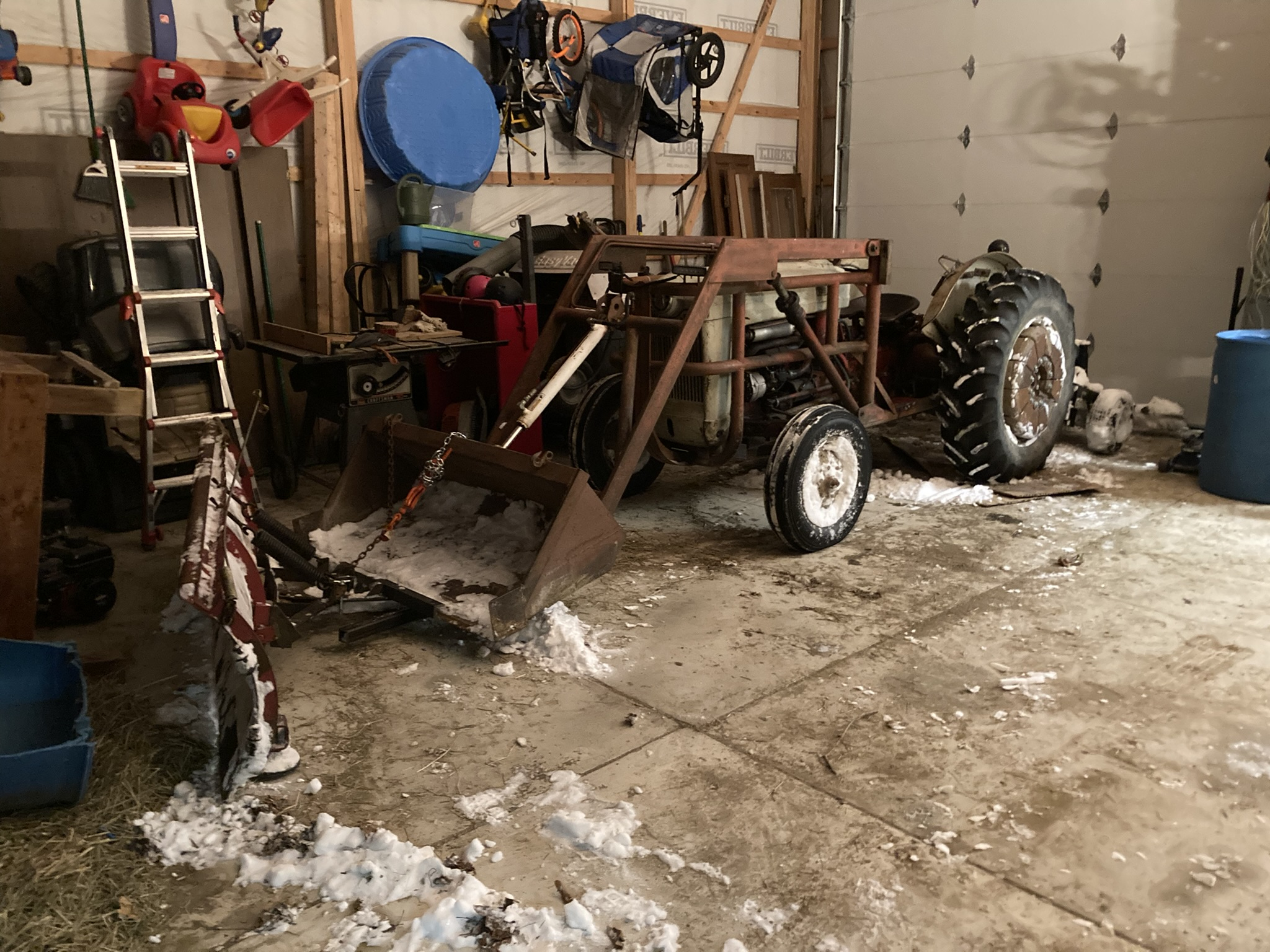

I built 2, one for my t250 bobcat and one for my LS 357, the tractor is way easier and more pleasant to use, the skid steer is too much power and weight, the plow blade wouldn't take it. You will want the 3rd function to be able to angle the blade. I helped a buddy put one on his Ford 1710, for a smaller tractor, 6ft of blade is about all you wantView attachment 750865

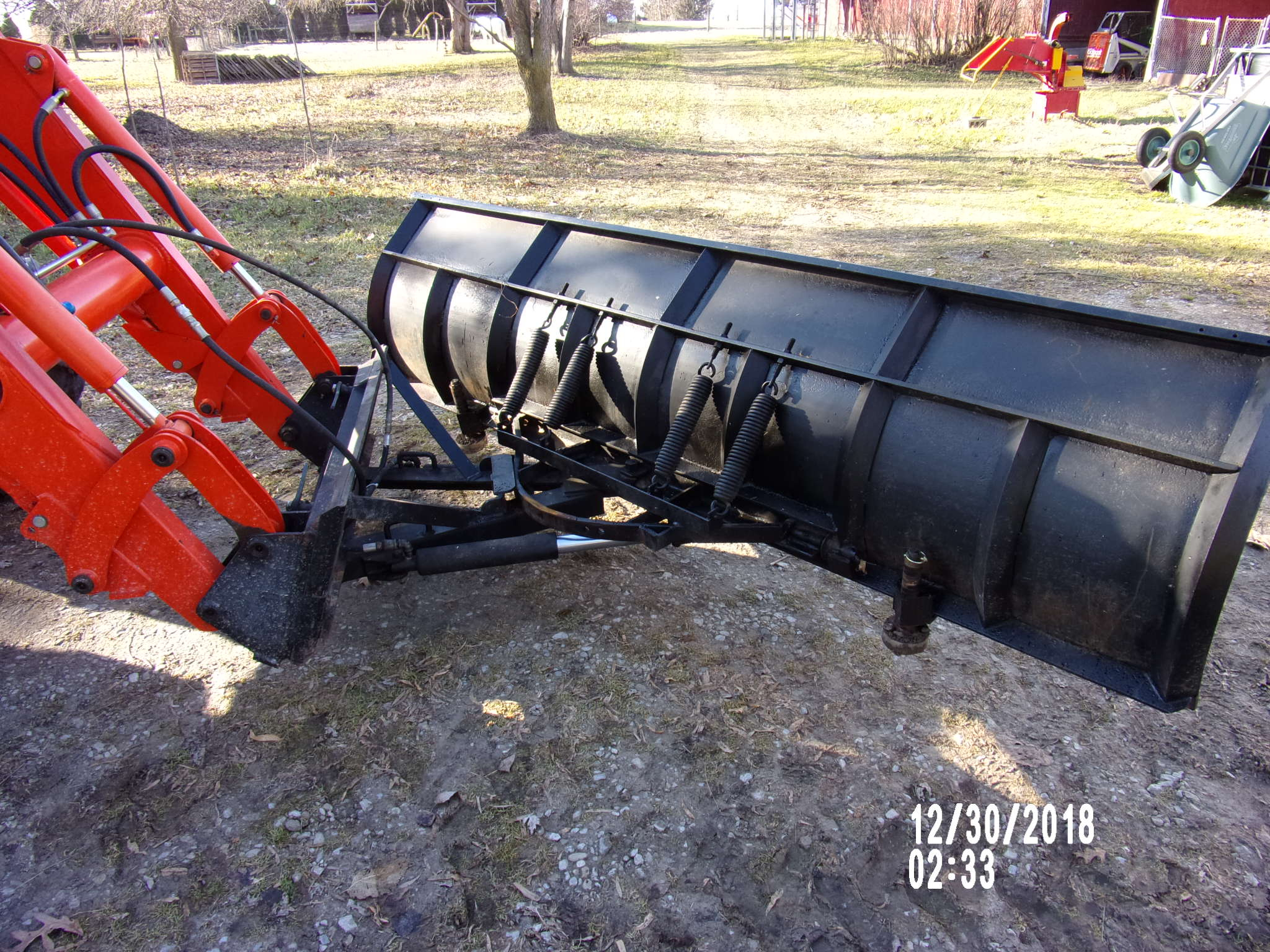

Built one last year for my neighbor - he luvs it and it is his primary snow removal device - minimal use of his blower except for paths thru the woods and across the field - it works very well.
Just started with making a quick attach bracket and kept going from there - used an old p/u truck plow as the basis of the finished product

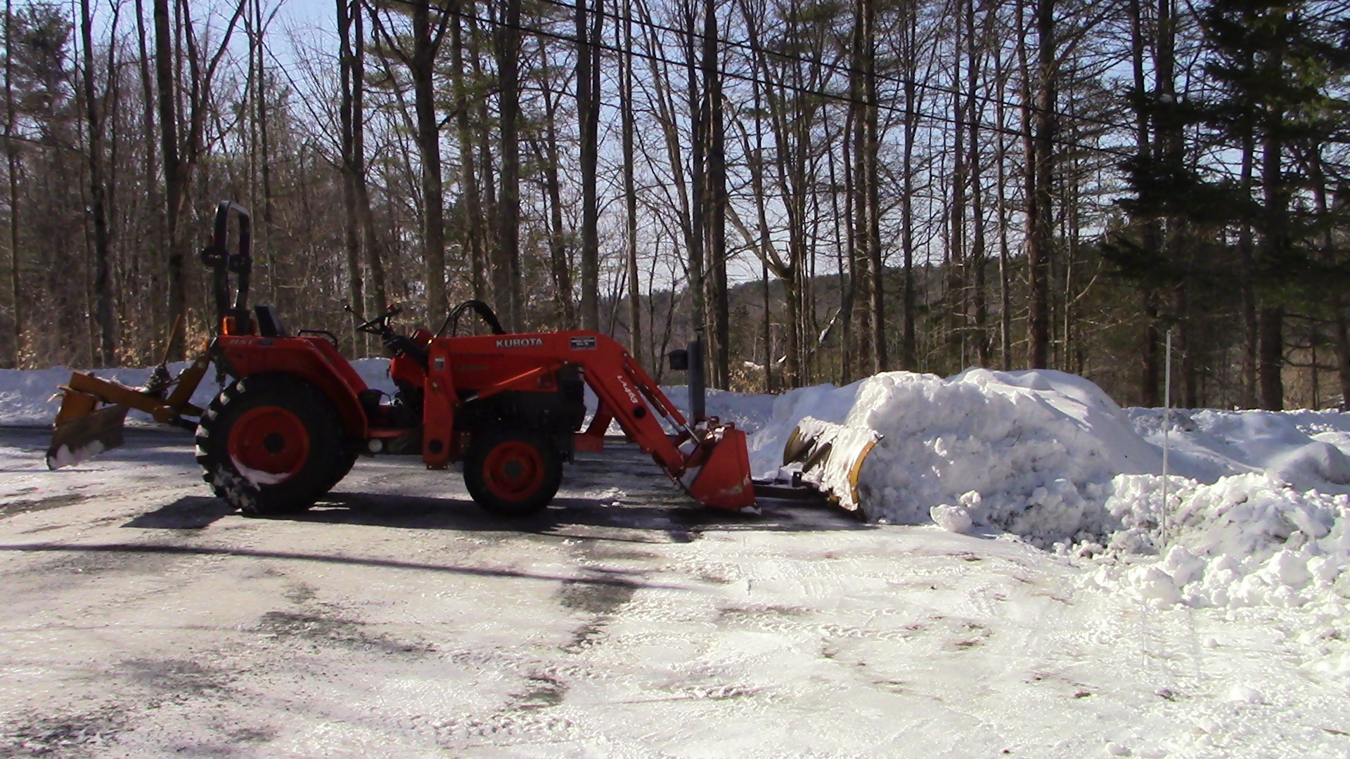

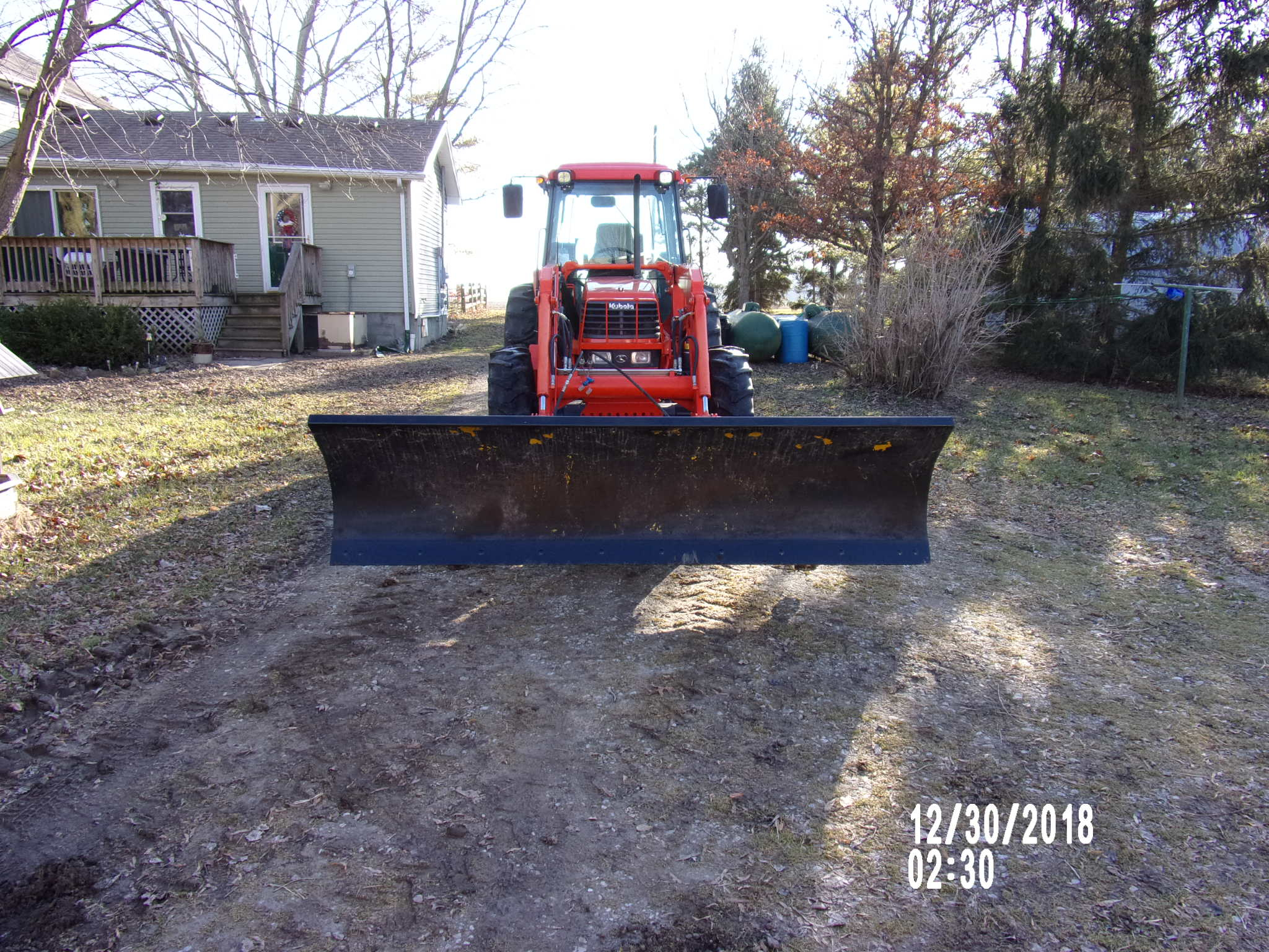

I run a 7' SSQA plow on my Kubota L4060. It does not float, but there is an inch or two of slop that allows me to put the blade on the pavement without floating the fel arms. The only time I float the fel is when there is a large dip in the pavement.
Last season I put an UHMW Polyethylene edge on the plow, and I really like it. Cuts very well, doesn't scrape the pavement, and it's wearing very well.

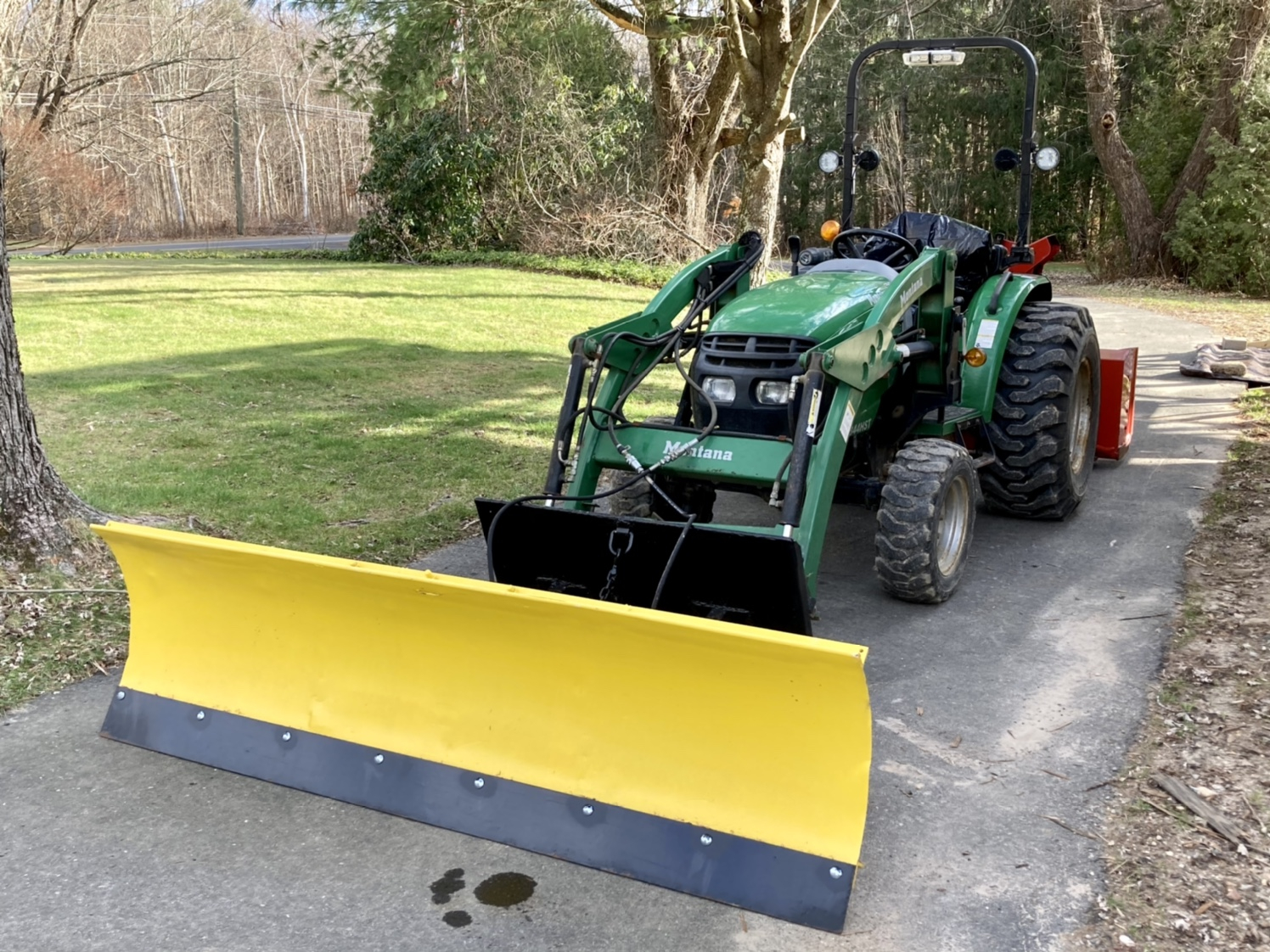

Works great on my little Deere 850
