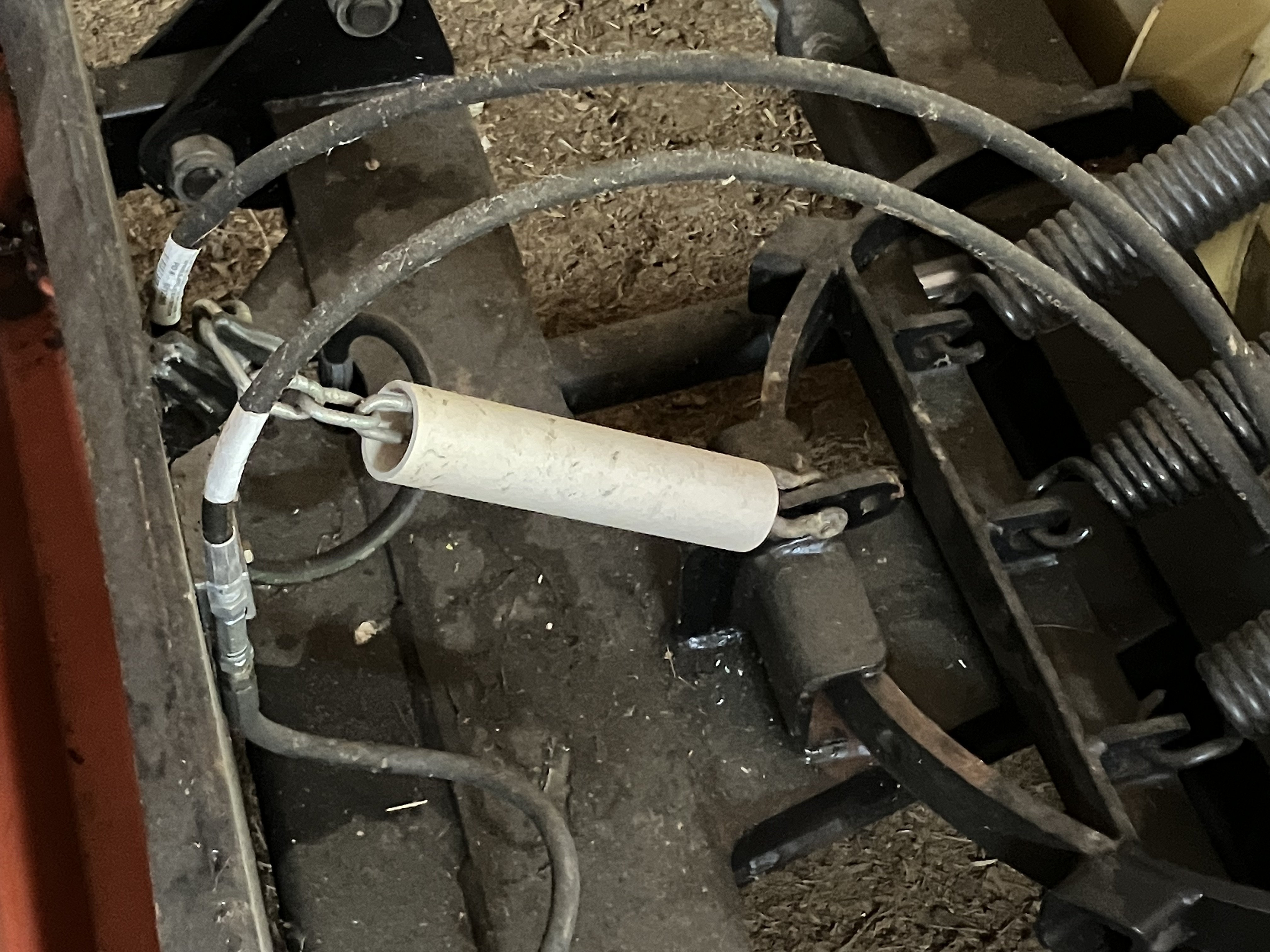

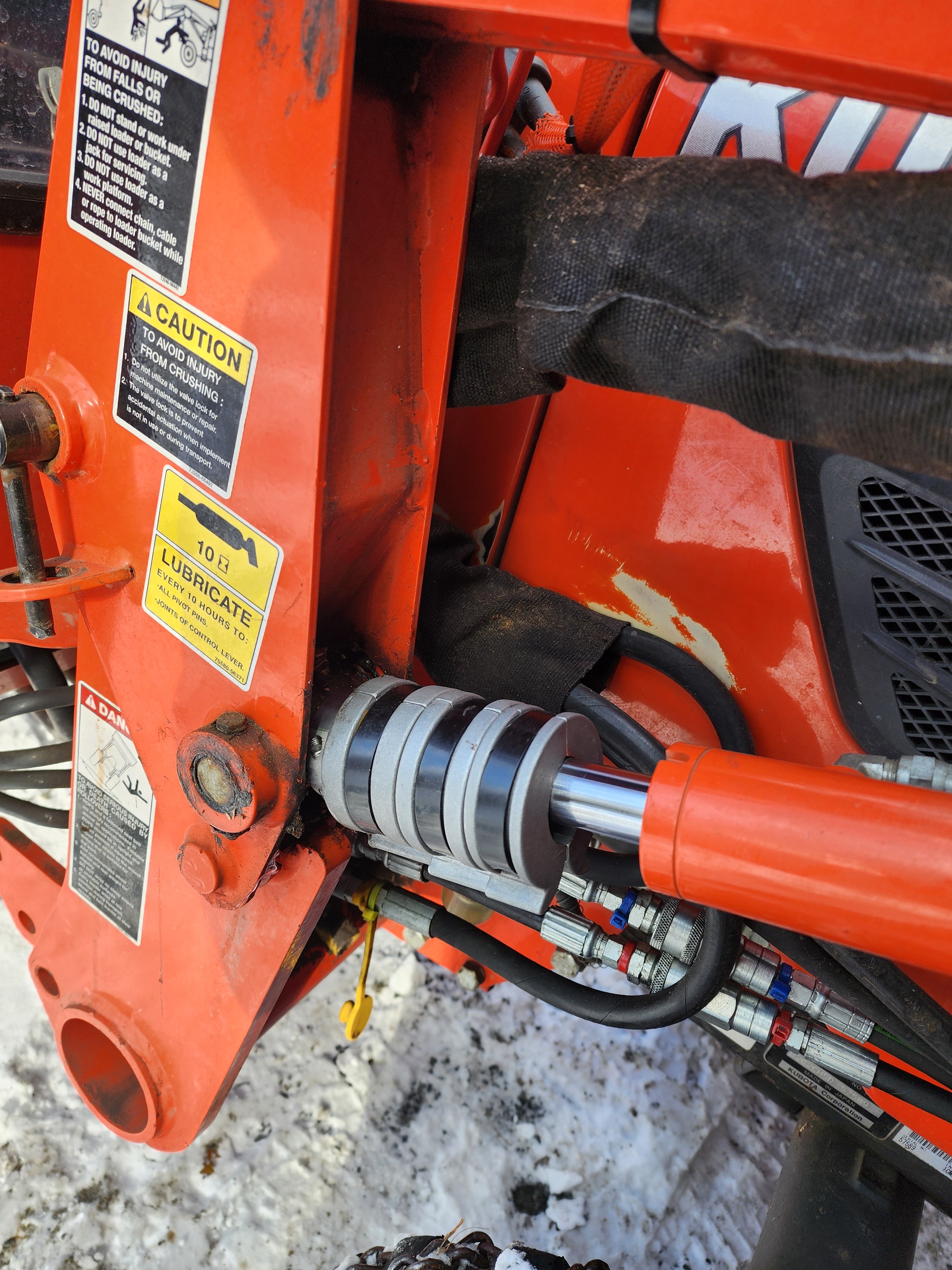

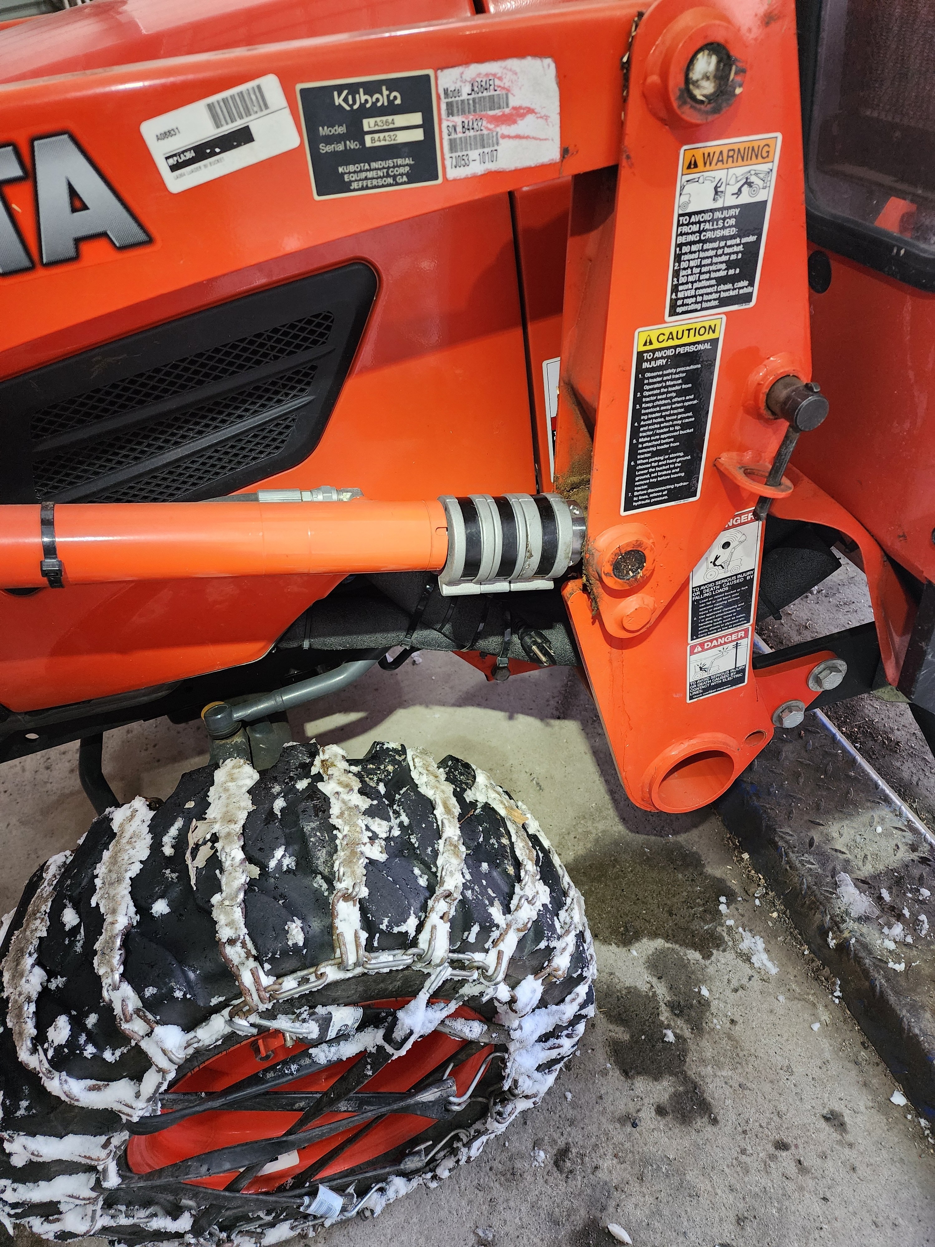

I'd like to add one thing. Not only do these stroke limiters prevent the front of the tractor from wanting to climb over the plow I also added a 2inch outside diameter schedule 80 pipe on the cutting edge. So now the float works on the soft ground we had in last weeks snowfall. I'm sure it will even be better on frozen earth. I'm plowing 1600 ft of driveway/road and it's just to difficult to do it in anything but float mode. Constantly feathering on the joy stick is just to difficult. So the aforementioned limiters and the pipe over the cutting edge are the ticket in my situation.

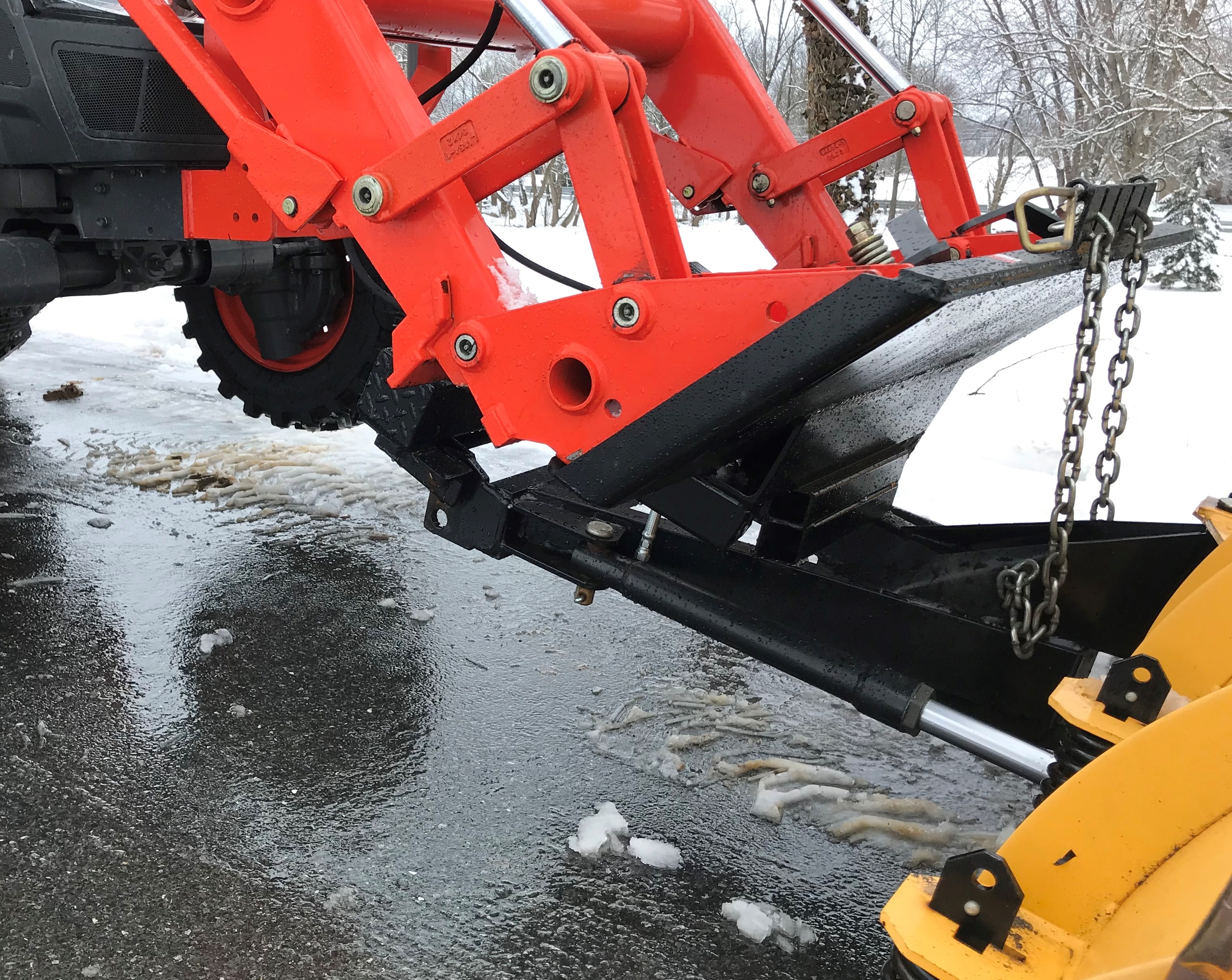

Same. Have shoes on & it still catches & tries to drive over the top of the blade. I've tried plastic pipe on the cutting edge & it doesn't last 50'. Haven't tried slitting steel pipe or welding tabs onto that yet. Although that trick is more for not digging into unfrozen gravel than float.

I have the same issues on my B26TLB with the plow on the loader arms. My drive is not straight flat along its length of 3/8's of a mile. Shoes just dig in from the weight of the setup. If the drive was continuously flat with no bumps, raising the plow a bit on the arms would work. But I hit a bump in the drive and the shoes dig in and the blade catches and either stops forward motion or tries to trip. Now if the gravel drive would freeze hard before snow came, that would help support the shoes. Jon

I have an l3301 with a heavy 7' blade /gravel driveway in the Catskills. I lift the loader until the blade just skims the surface. Also angle is important. blade wants to be perpendicular to the surface That's what works for me
