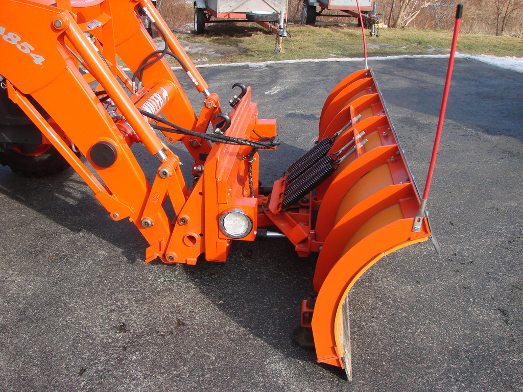

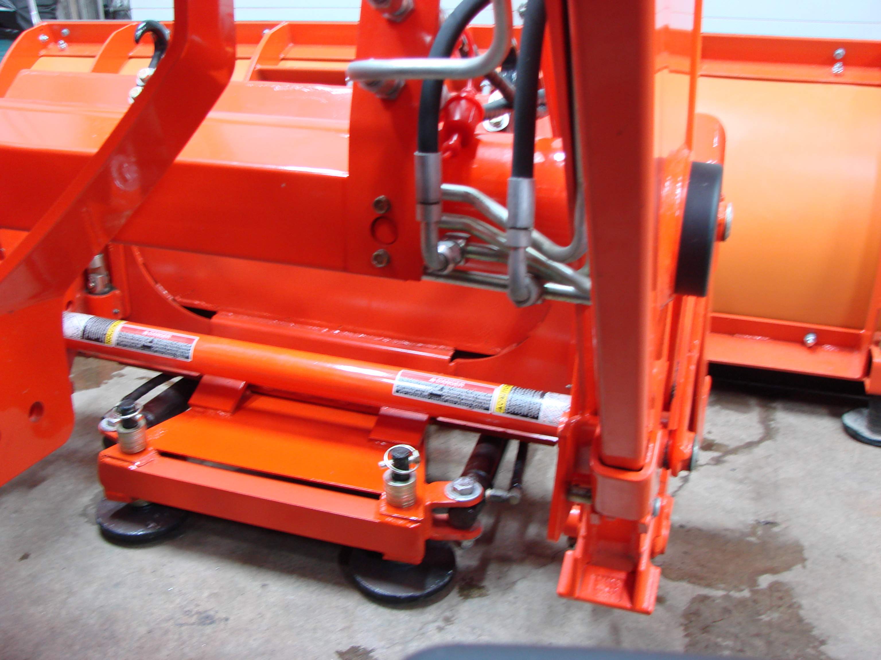

As some will know. I modified my loader attachment to adapt a plow that I used on my truck to fit my Kubota loader. I used it all last winter with very few problems. The only problems I had with mine was when I designed it I never added skids at the rear of the plow frame and when I was plowing snow I would have to be extra careful so the rear plow frame wouldn't did into the pavement. After I adapted the two rear pads it wasn't an issue anymore and was a pleasure to use.
I also added side mounted Super Nova led strobe lights to the plow because when I'm plowing a driveway on coming traffic can see me better. I do also use a rear mounted snow blower. I use it cleaning out parking compounds. Instead of just removing the snow with the bucket which takes up to 2.5 hours to do I pile up all the snow with the bucket in the middle of the compound and then back in and blow it over the fence which takes less than an hour and I get paid the full 2.5 for it so It was a good investment for me.
There will always be a debate over what works best on a tractor but I like the FEL mounted plow. I can pile up the snow mush higher then a frame mounted one. A front mounted blower wouldn't work for me. It's to slow compared to the angled blade and besides I would have no where to blow the snow in my case because there are lots all around me and I can't blow the snow on them.
During the winter when the snow starts to pile up I get paid extra to remove the snow and with the quick change attachment on the loader I just drop the blade and pick up the bucket and move the snow. My system won't work for everyone's needs but it sure works well for mine.
Here's the link to how I did mine:

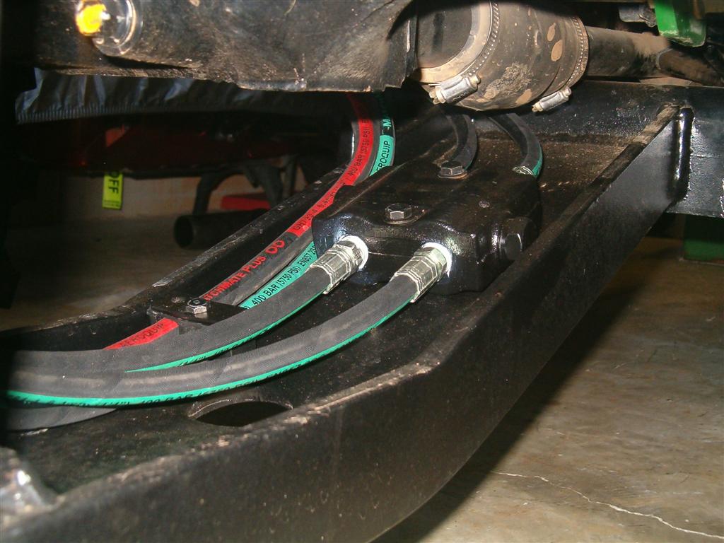

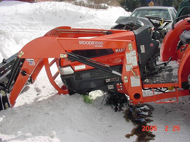

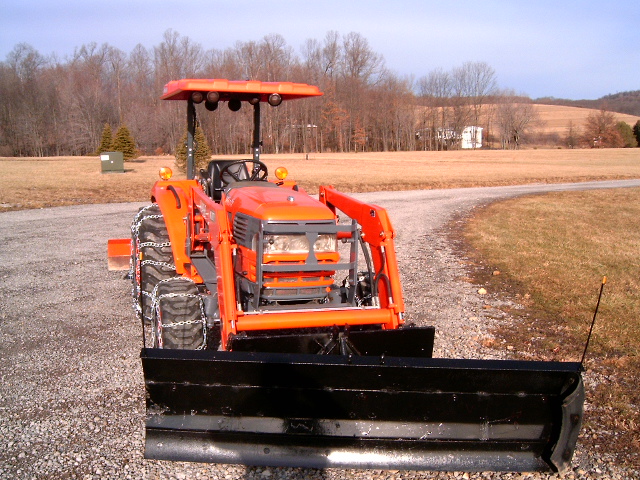

No FEL damage yet and I have a fairly light loader for my 3430 (woods 1009 in picture below on my last tractor)
I've been using a very heavy home made FEL mounted Fisher plow setup on my 3430 since I gave up on my last off road plow truck. I have a few horse shoe style drives that are very uneven. Sitting behind the wheel, I can see and feel the forces that could damage the FEL arms if I let them.
My strategy, which has worked so far, is to try and plow in low range most of the time. A few wide open areas I will run in mid range. I only put chains on the rears, preferring to see the front wheels side slide if the plow gets too heavily loaded while angle plowing.
For small storms I just use the bucket and rear blade. My wife does not like to use the Fisher because it hangs out so far in front of the tractor.
For larger cleanups, IMHO no plow beats the ability to plow snow into large piles than pushing show and lifting the FEL at the same time. (yes a blower would probably do more but I've got too much rock for that I think)

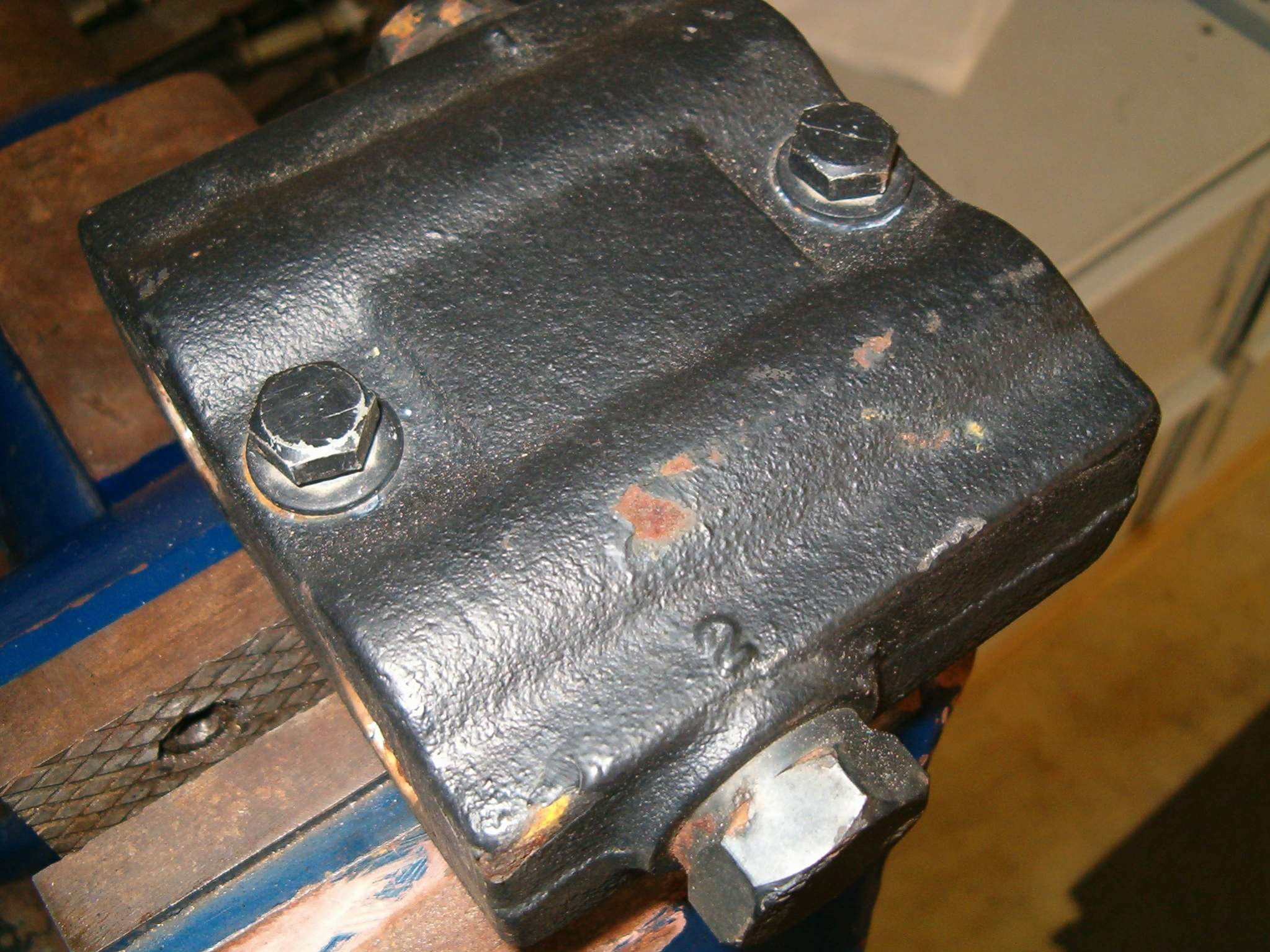

Given enough time, I want to pull the plow in closer to the FEL. I hope to use ideas that I see on 4shorts thread including TTTTTT's. I actually started to look for a QA plate this weekend for that project. I plan to start fresh as I have two old plow rigs to work with.
I like the cushion valve idea and will consider that for my setup.
The picture of my plow setup are pretty old. Since then I added a vertical member to the QA plate so the lift chain would pull more vertical. In the photo the QA plate is tipped forward to allow the plow to rest for these photos, normally the plate would be more vertical to keep the pivot points out of the ground.
The image of the wreck is my best side shot of the full loader before the sun turned the woods paint towards something that looks like a creamsicle. For those that don't recall, that tractor (RIP) had three hours on it when I got t-boned by the big Merc. Wow, this one will be 5y.o. next spring....
